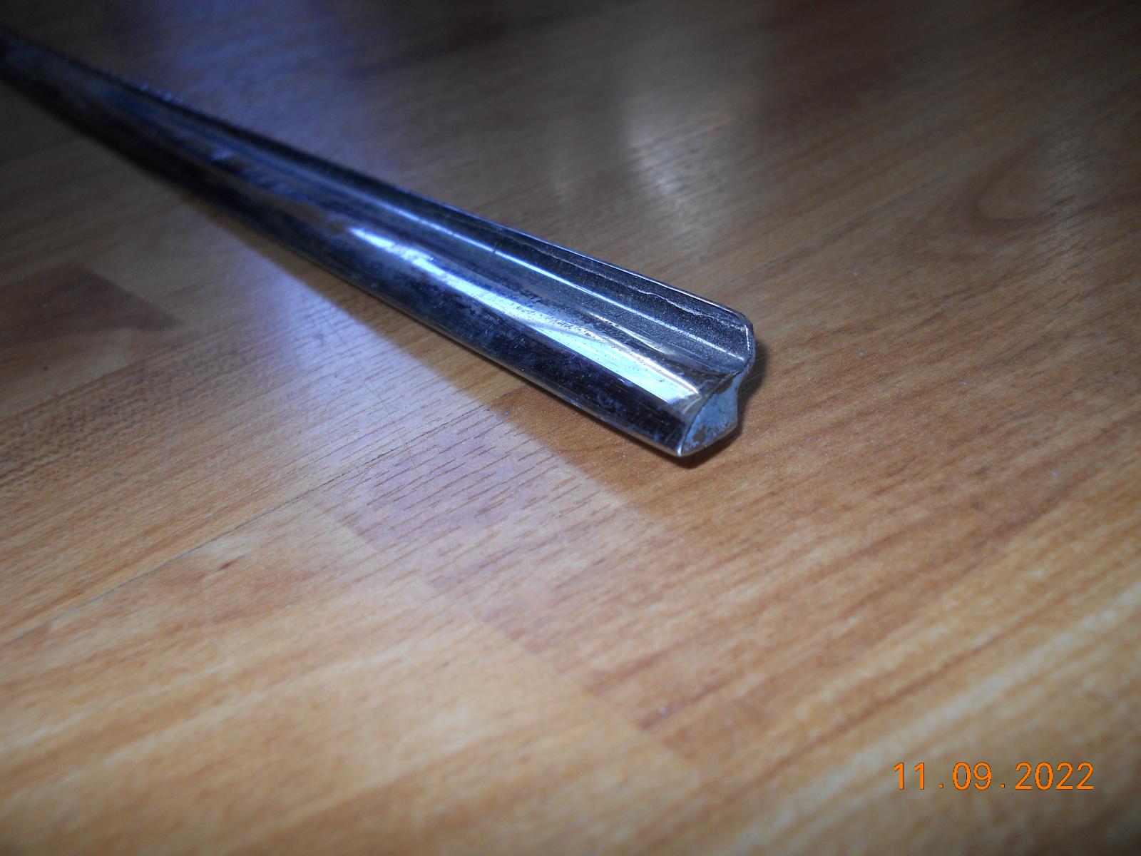

Next I started getting ready to install the window scraper seals and chrome moldings. Well, of course, it would have been an unusual day if I didn't get PO'd again. I'm sure it won't be the last time. Anyway, I had everything I needed, new seals, chrome moldings and clips, but I discovered that the chrome moldings I have are not for a 71. They were on the car when it arrived but they are for a different year.
The PO had done a crappy make shift installation. Due to rust, the metal support strips in the window opening were completely gone. Rather than repair the doors, (which I did) he put the seals on anyway with wrong parts and in the process butchered a brand new set of seals. I knew it was done incorrectly and had bought new seals a long time ago, but I didn't realize that the chrome moldings he put on the car were not correct. Nice set of moldings though, Very Happy but they have a short lip that curves upward to support a rubber scraper seal. I'm now on the hunt for the correct scraper moldings. Someone mentioned that they might be one year only moldings for the 1960 model Karmann Ghia, but I'm not sure.
If I was to do it all again, I would definitely get the job done in much less time. Adjusting the windows was actually much easier than I expected. It's a relief to finally see door handles on the door exterior. Even nicer to be able to open and close the door from inside and outside. Very Happy LOL.

Those are 60 only scrapers for sure. No one makes the correct rubber so a lot of guys use later scrapers unless they get lucky and find NOS.

How are window scrapers being installed on 1960 Ghias? I'm thinking the doors could be equipped with a metal strip as on the 61 and later cars in order to install the later seals with later chrome moldings???

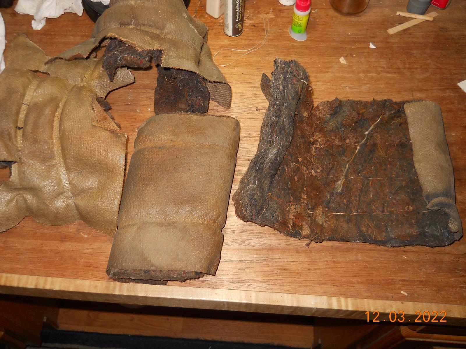

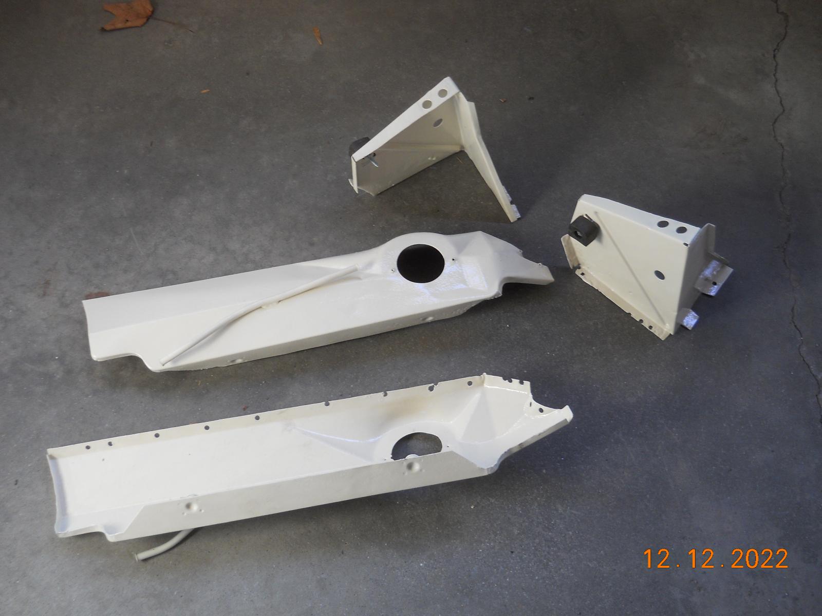

Working on the back seat area. When the car was stripped down 14 or so years ago, it was being converted to an electric car. The electric motor was already installed but the project hit a road block and the 1600DP engine was put back in the car. The back seat area however had been cut up for more battery space - the rear seat towers as well as the kick panels where the heat pipes open up into to the back seat were cut out and lost. New replacements were not easy to find, especially the rear seat towers which are usually rotted in that area, but I finally found everything I was missing.
I found some original heat pipe insulating material. Not all in great shape but useable. I installed them using black tie wraps in an effort to keep the car as original as I can.
I was fortunate enough to find an original set of floor tar boards as well as all the tar boards that go over the wheel humps and under the rear window. Even though several years all used the same parts, everything I found actually came from 71 parts cars.
Even was able to find the small card board pieces that go above the wheel wells, behind the sides of the head liner. Not sure what purpose these serve though?
Before anything else gets installed, the interior needs a serious vacuuming and cleaning.

I used bitumen to restore the original tar boards from my car. You can use a heat gun to melt the board into the right shape to conform with curved surfaces and the heat will soften the board so it kinda glues in place. it ends up looking nice and black, like new.
Wear gloves. Have a wet rag handy in case you have to douse any flames.

Super nice work Marc. The sound deadening looks factory.
The 1960 scrapers had one year only rubber seals that had a groove that fit in that raised lip. I don’t recall if they clipped in or slid over screw heads on the body.

Yes, all the tar boards are factory original. the set of 4 floor tar boards came out of a car in CT. The rest of the pieces are from a 1971 vert that is being parted out in Vermont. This poor car spent most of it's life in Massachusetts's and eventually got parked in a field to rot - and rot it did.
The 1960 window scrapers I have are exactly the same underneath. The same track for clips as the 61 to 71 have. When I got the car 3 years ago they were actually mounted on my doors using the same clips that is used on later cars so I wouldn't be surprised if the 1960 doors have the same holes.
Marc
Nicholas
Anyone have a good source for a product similar to what is over the center tube?
Marc
