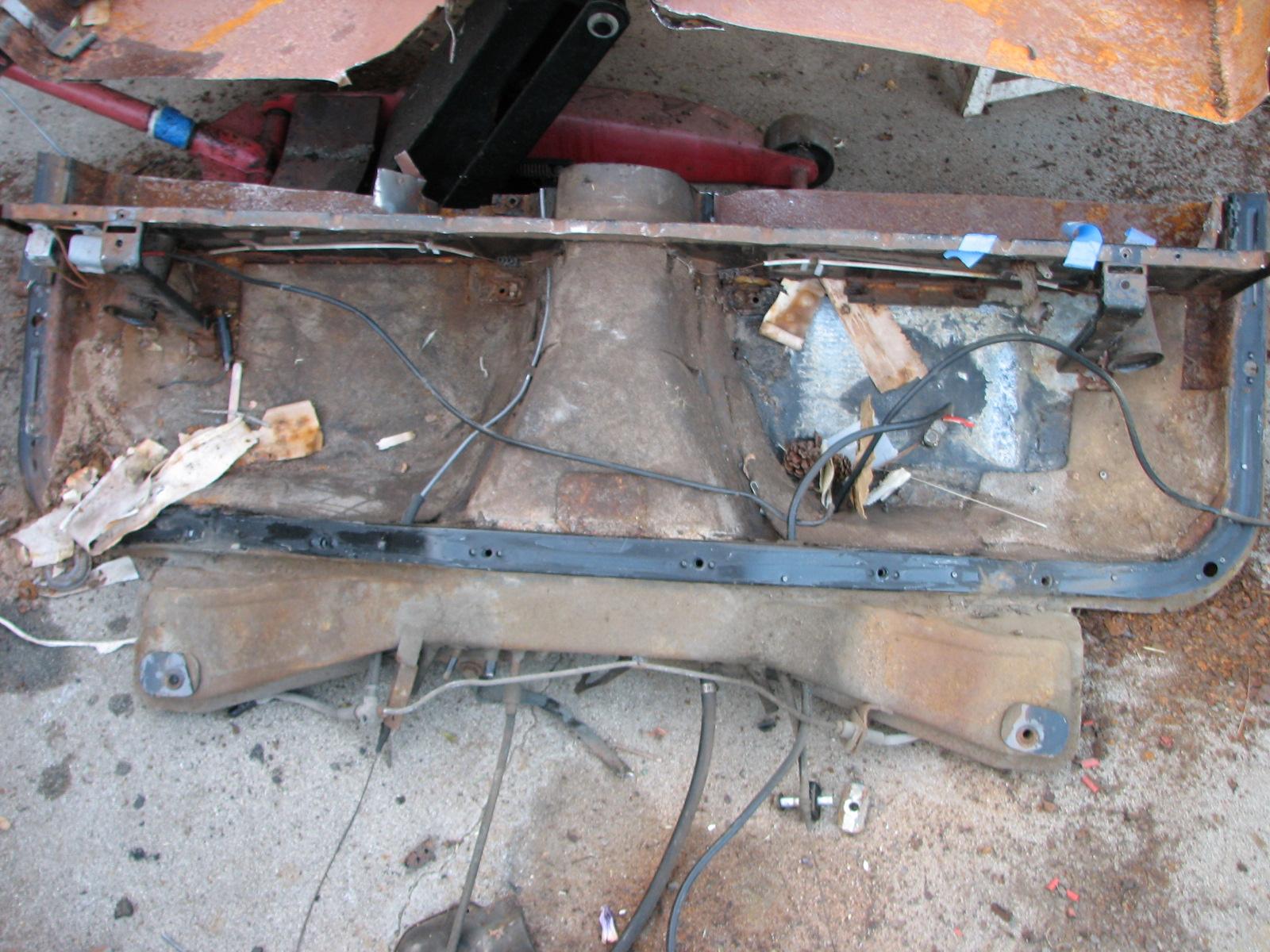

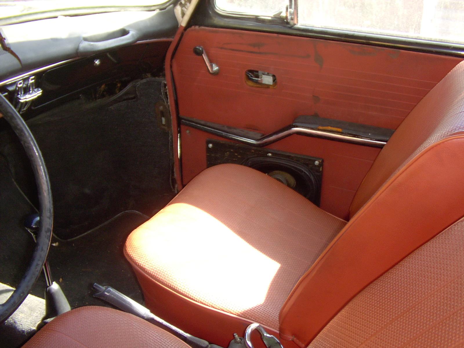

So, after getting it home, I gave it a good cleaning, and tried to find out just what i had.
Thing acually was rust-free for the most part, but needed gone through.

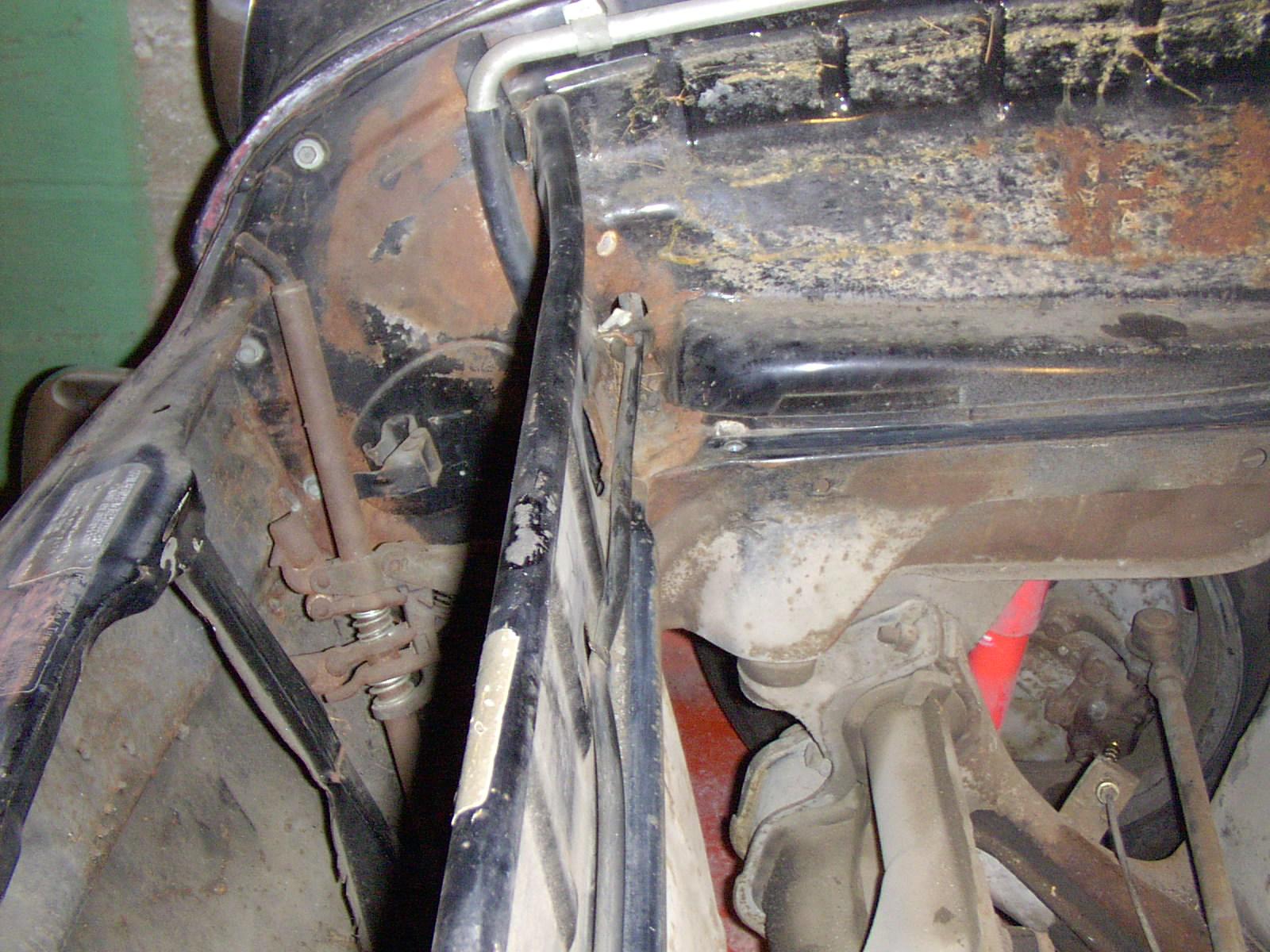

The first order of business was getting the wiring sorted, and that involved removing a hack-job alarm system and stereo.
My helpers were able to assist in the de-stereoization..
So after finding a bunch of brake parts under the back seat, an NOS master cylinder, and a few more whatnots, it was road ready.

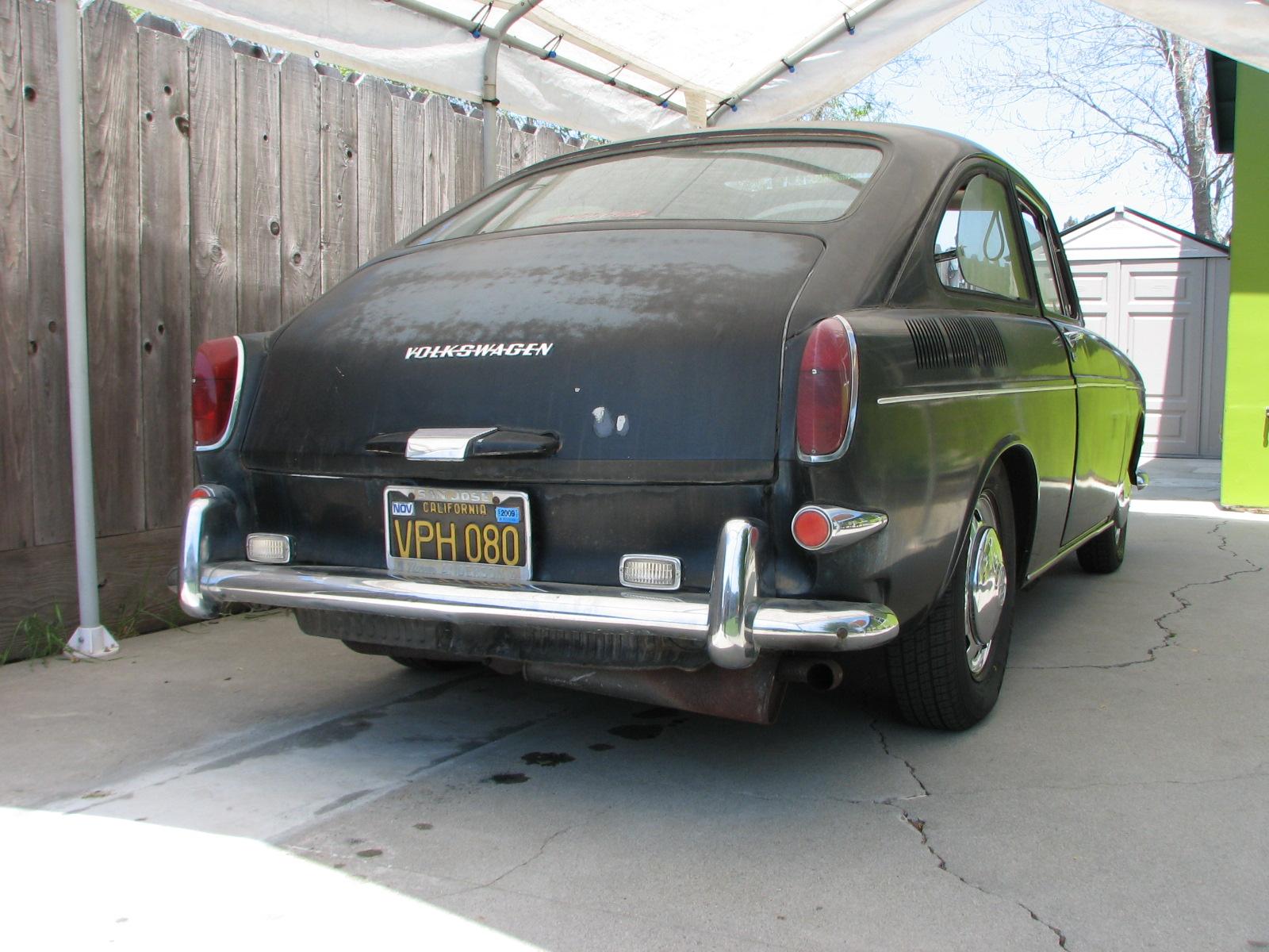

Lowered the front 1 click while i was at it, and drove it for a few years like that.
It was a rat, but had the patina, right?

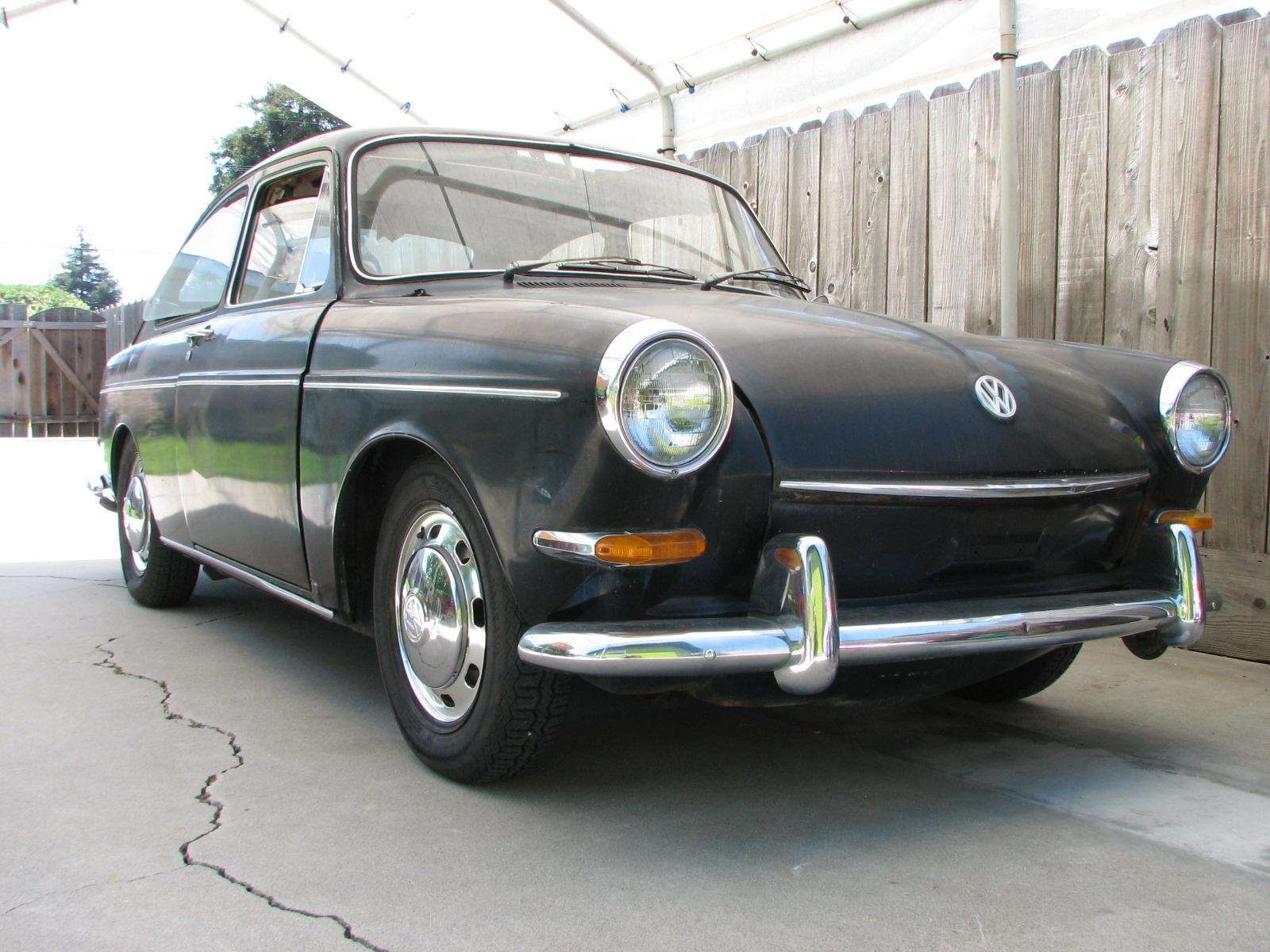

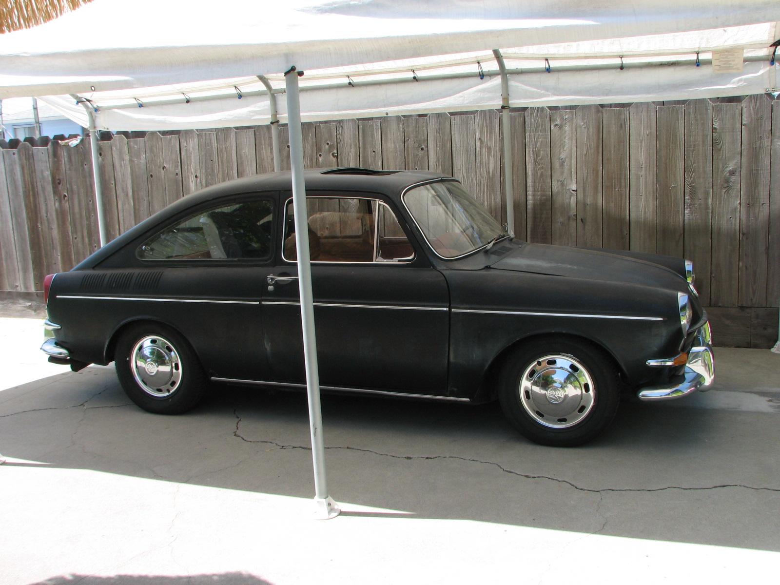

Here it is in my white-trash tarp garage.
White By Birth, Trash By Choice!
Not that I'm on crack, but it was fun to have a car that you don't need to worry about.
It did, however, make me feel like a crack-head to drive a total roach like this, so the resto plan slooooowly started to materialize.
If you look real close, you can see how it was in a nasty front-ender back in the day.
It was fixed, but definitely not right.
And, since it's a black car.... It's going to have to be straighter than straight if it's gonna be shiny....

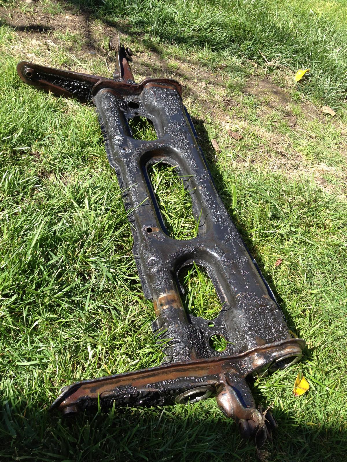

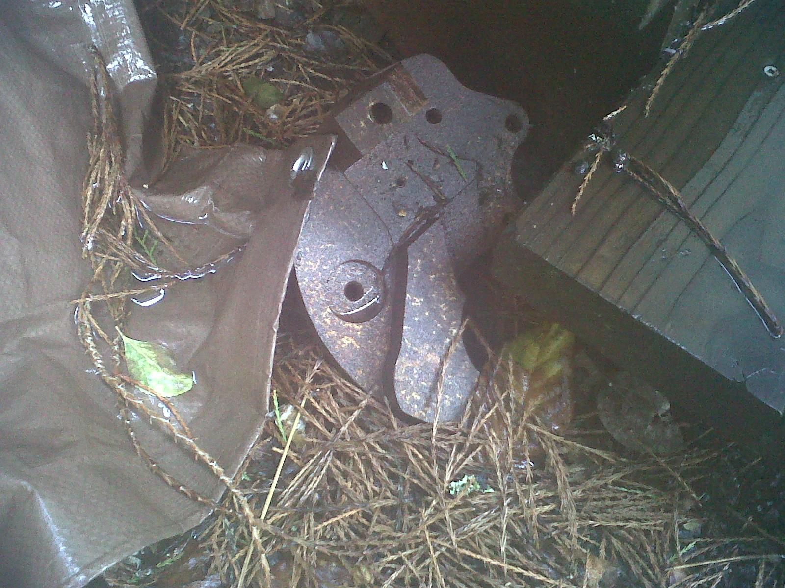

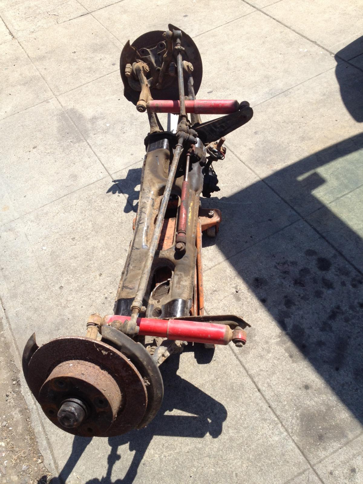

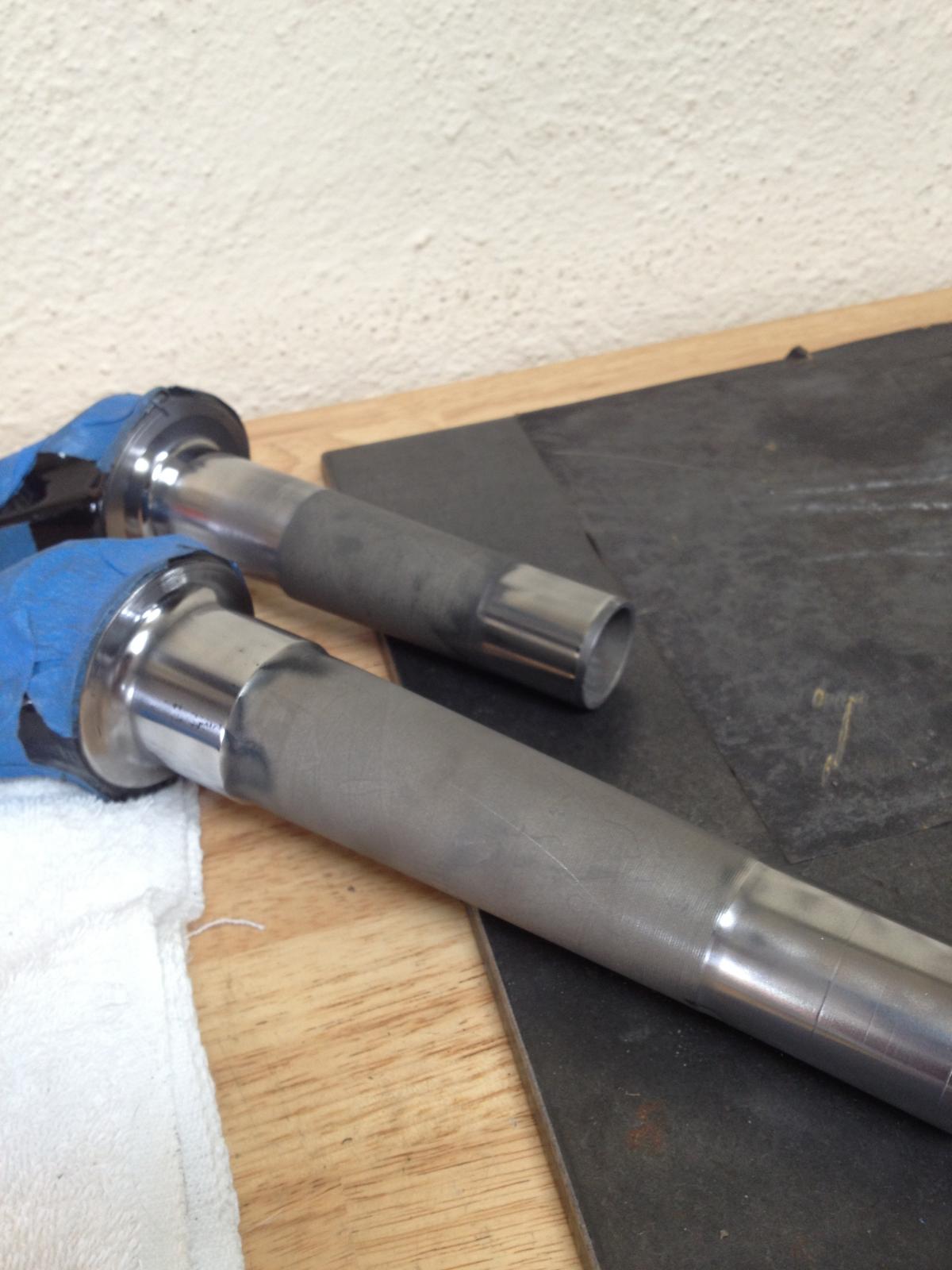

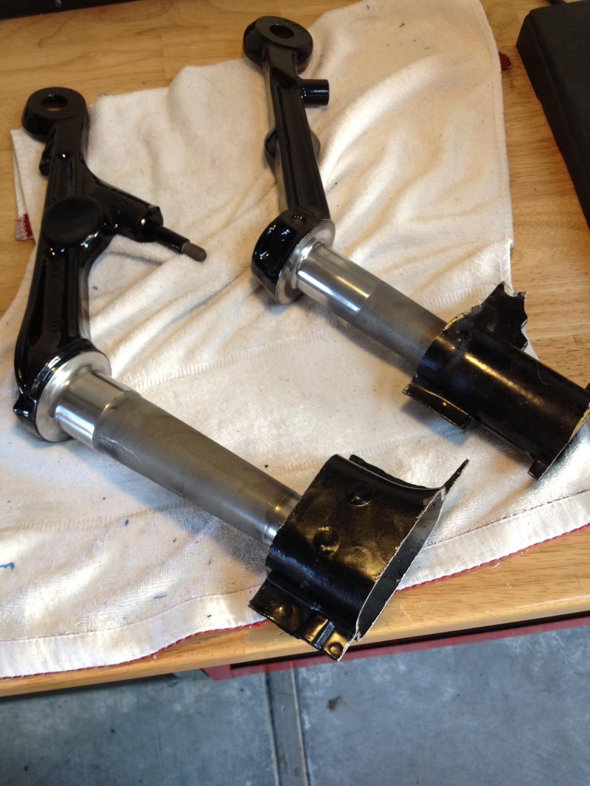

Here's a set of BerT3 spindles that i left out in the winter rains for a couple of years to get the matching patina just right...
So watch this space, we'll be making the ultimate crusty patina OG driver here...

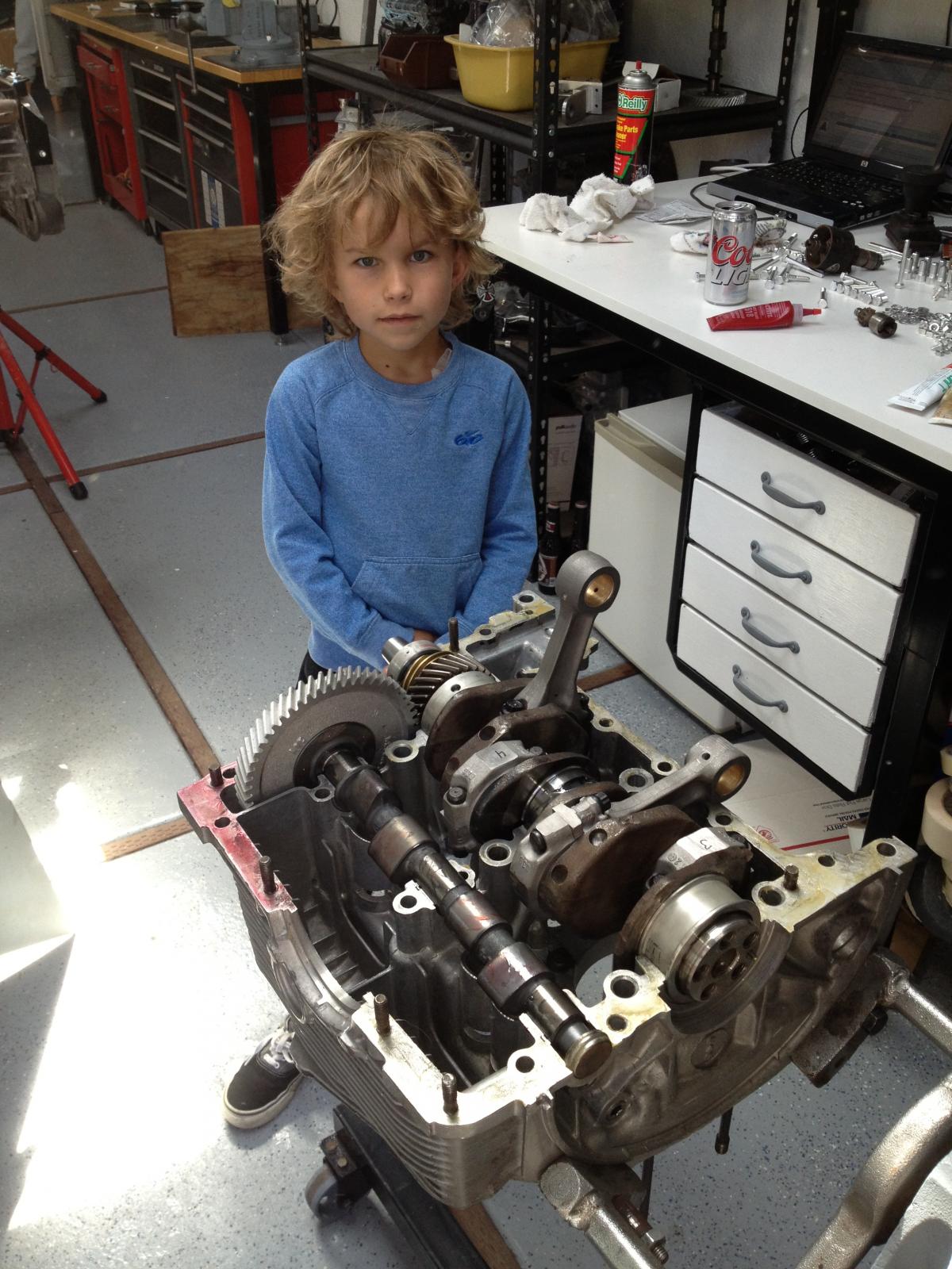

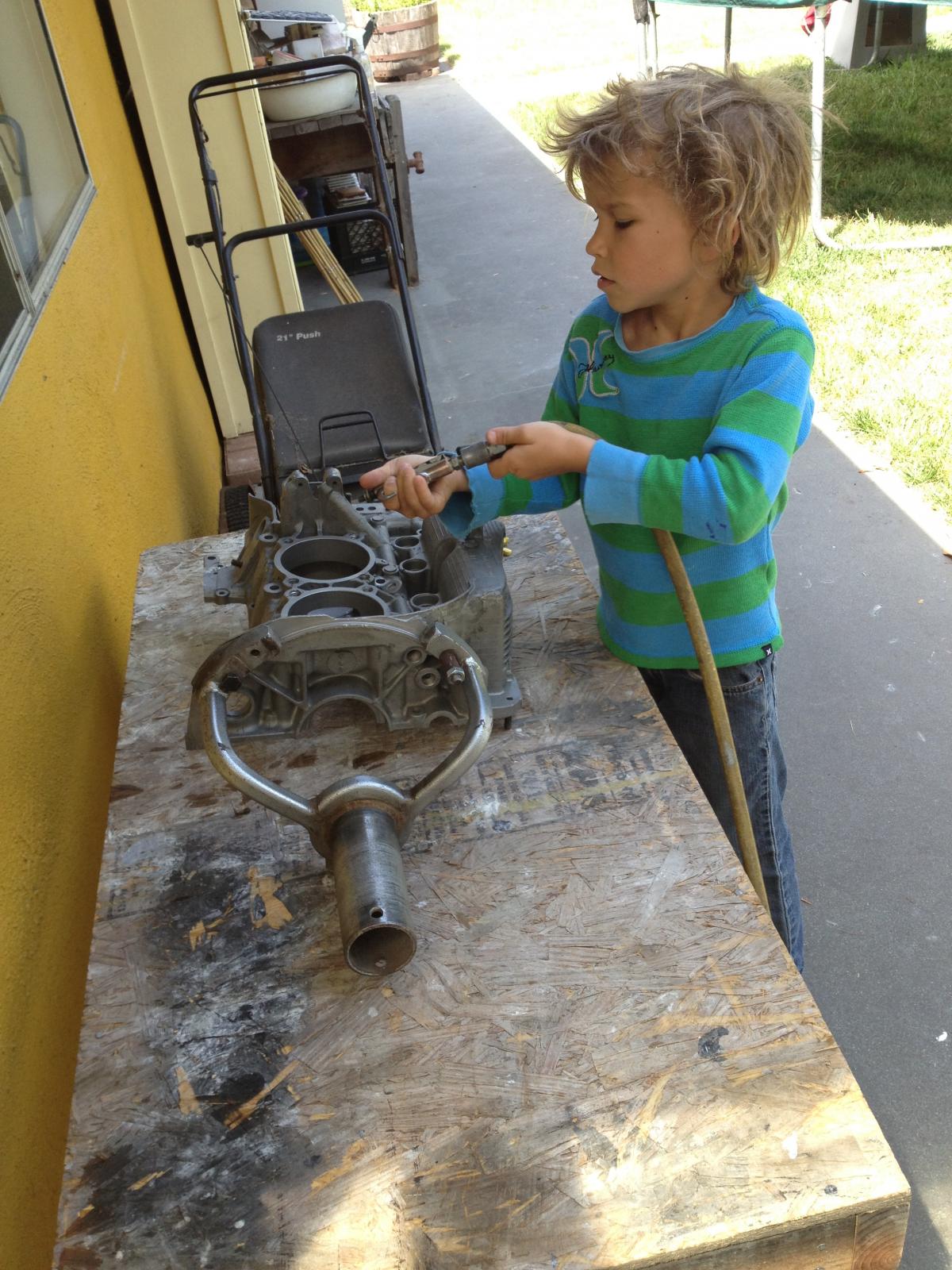

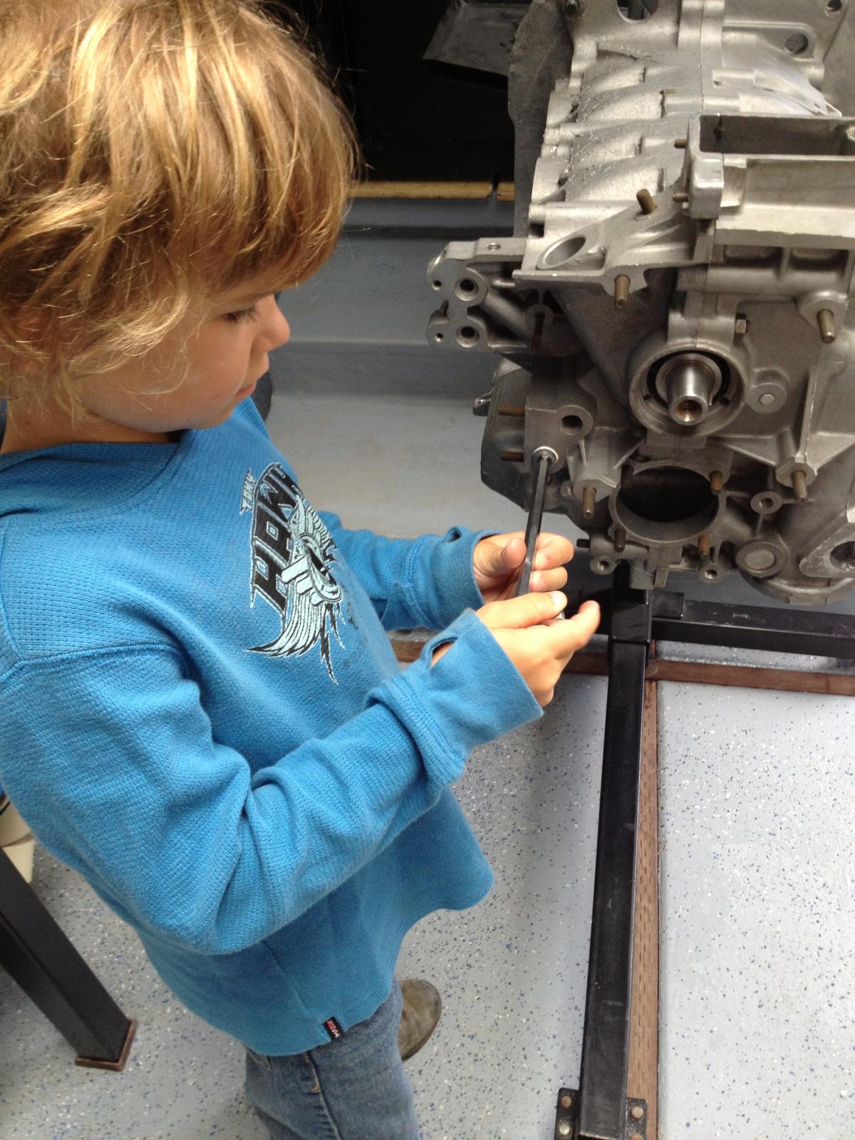

So the guys helped me get the case bolted up to the stand.

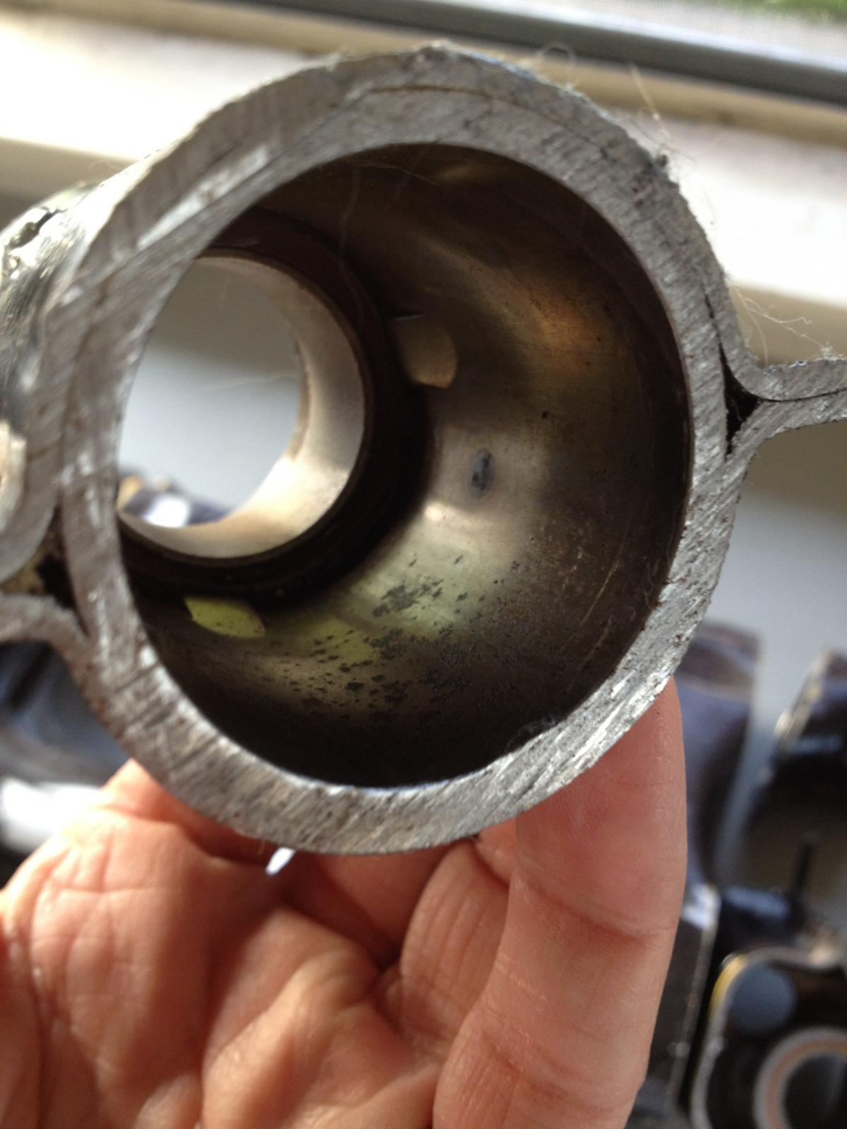

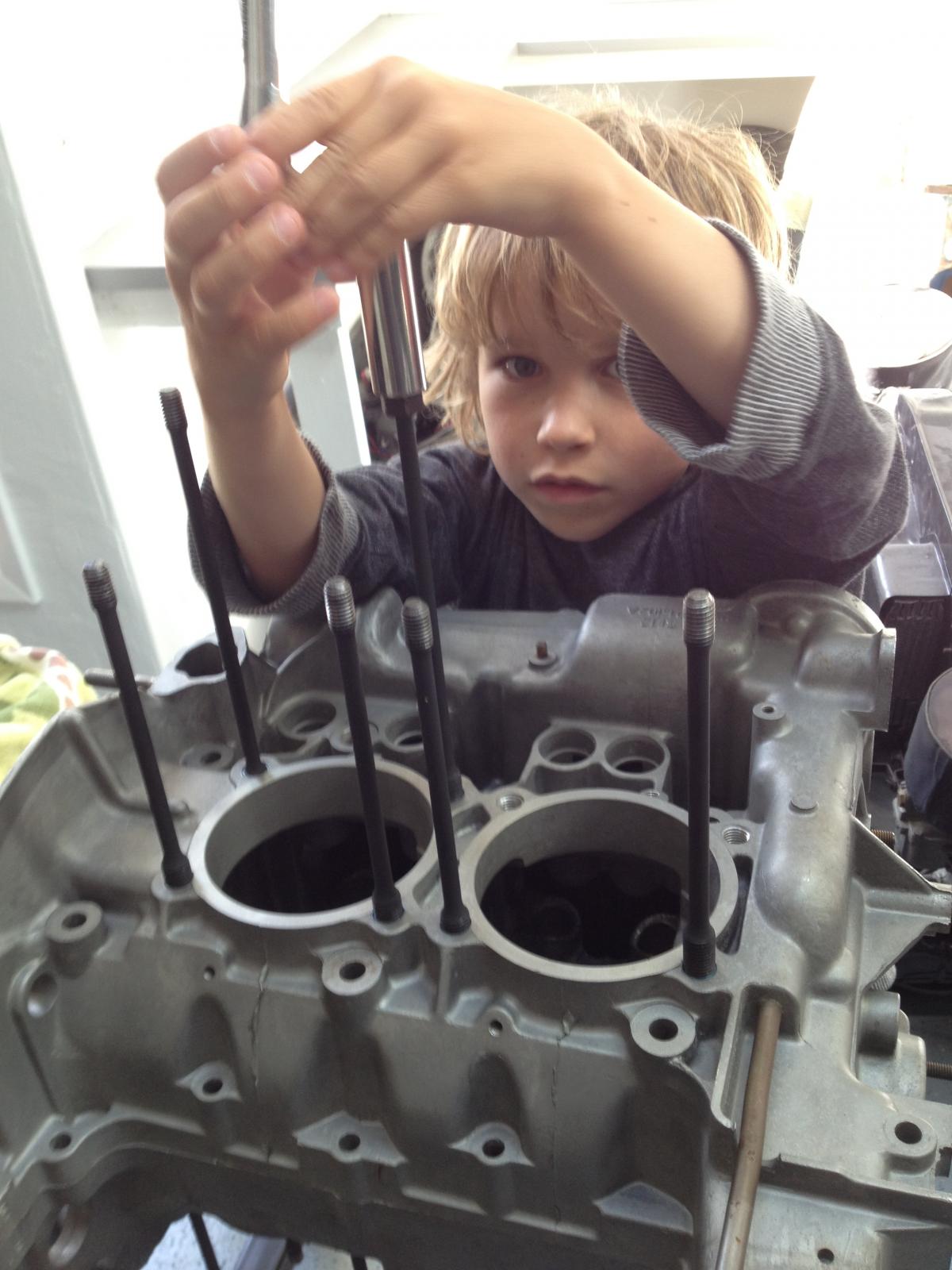

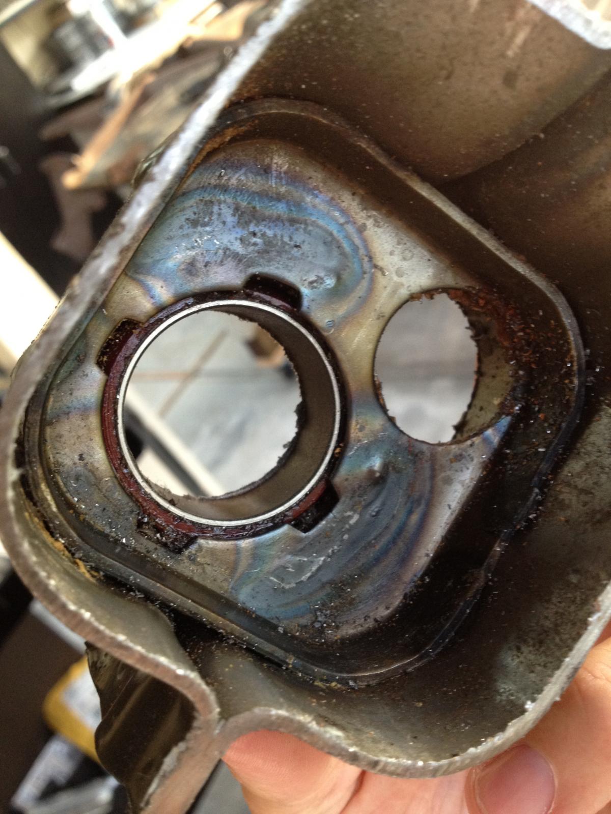

This motor was an experiment in "vapor blasting". It sat in my damp shop for two winters and got zero 'fuzz' on it, so something is right about it.
Had to clean out all the passages though...Perfect job for a little kid. they love compressed air.
Threaded galley plugs.

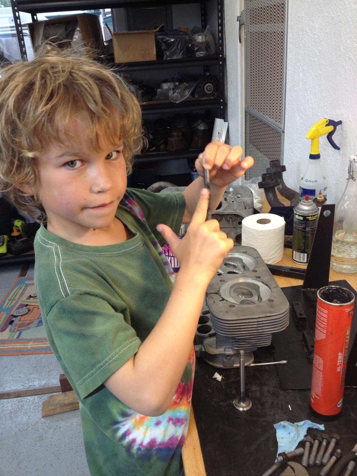

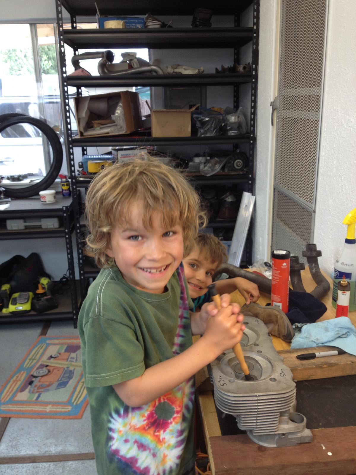

Lapping the valves in.
Don't forget to grease the stems.
Ended up using the thick shims on these ones.

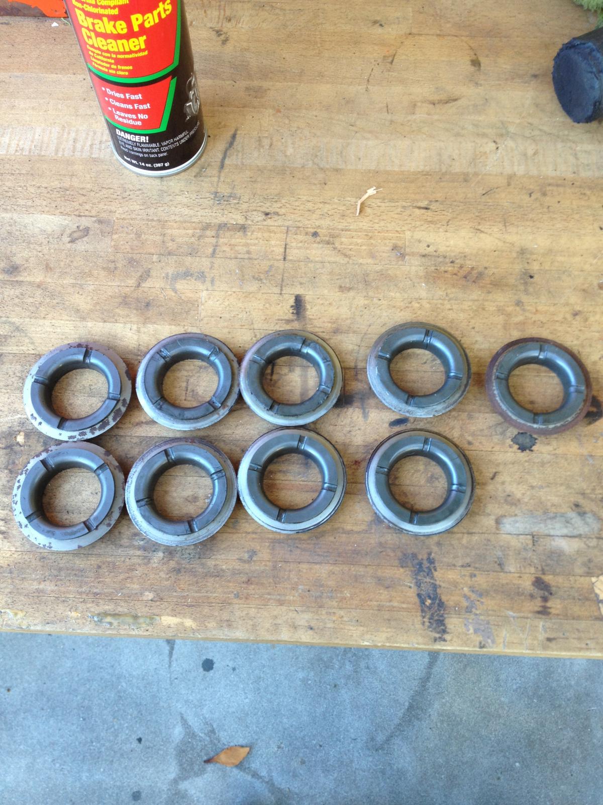

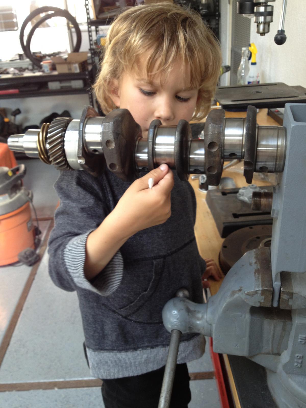

Once we got the gear on it needed a final clean.
Love the Q-tip cleaning - gets those passages.

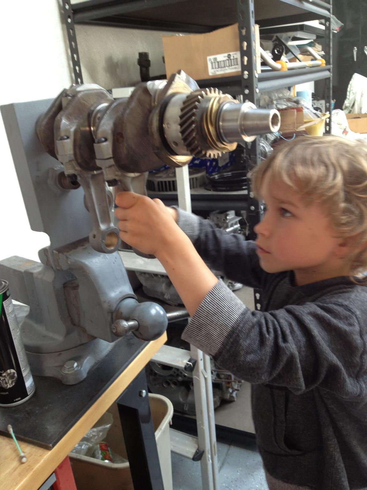

Assembling the rod bearings.
And hanging them on the crank.
This shows our little math lesson.

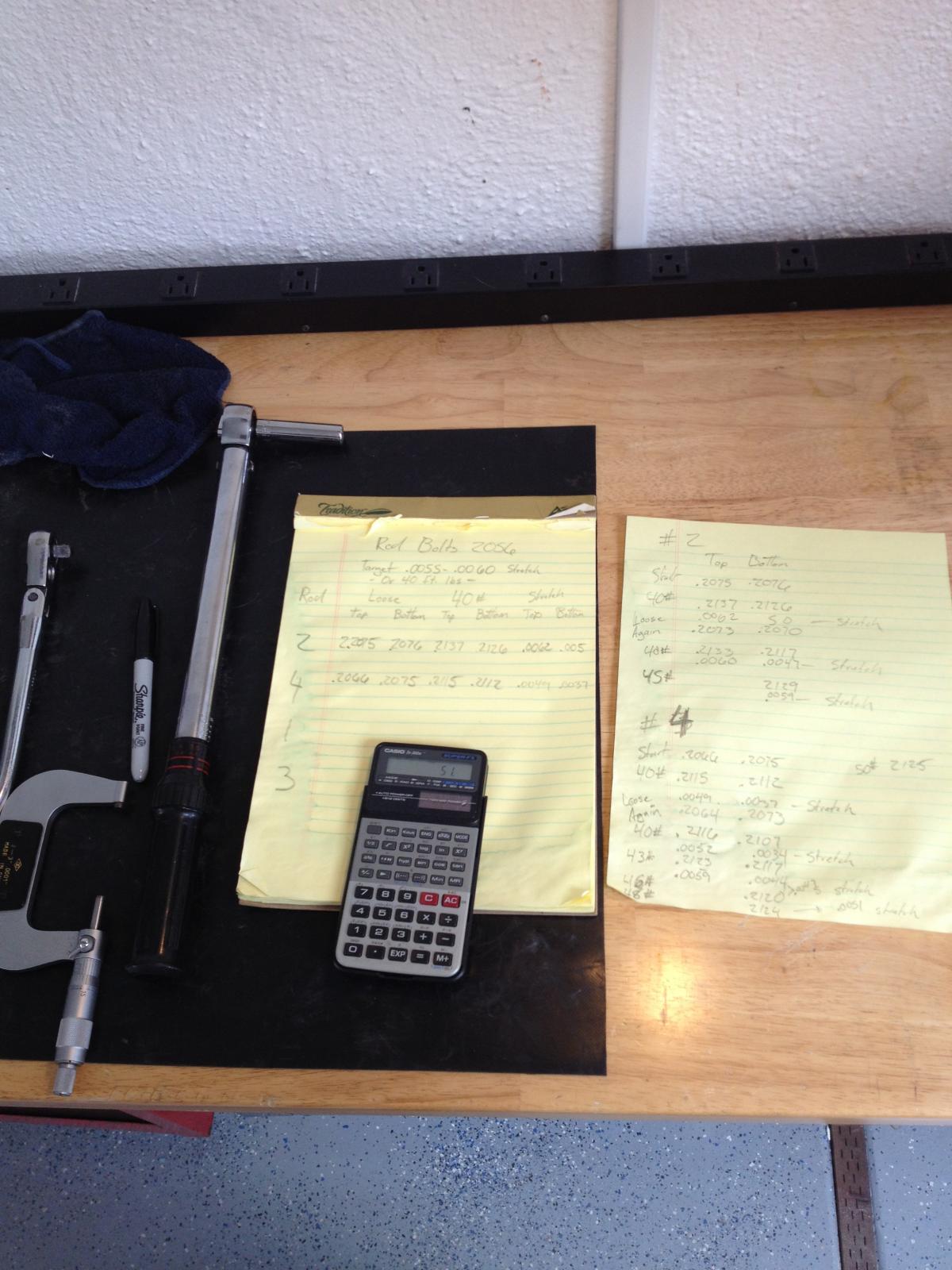

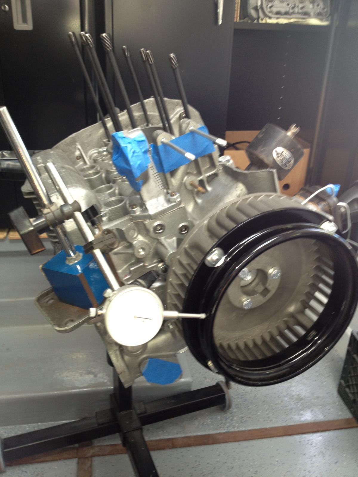

ARP rod bolts getting the stretch calculated along with the final torque.
Making sure the bolts stretch as much as they are supposed to at the specific torque.
Not having a real stretch gauge - want to have the numbers match by both measurements.

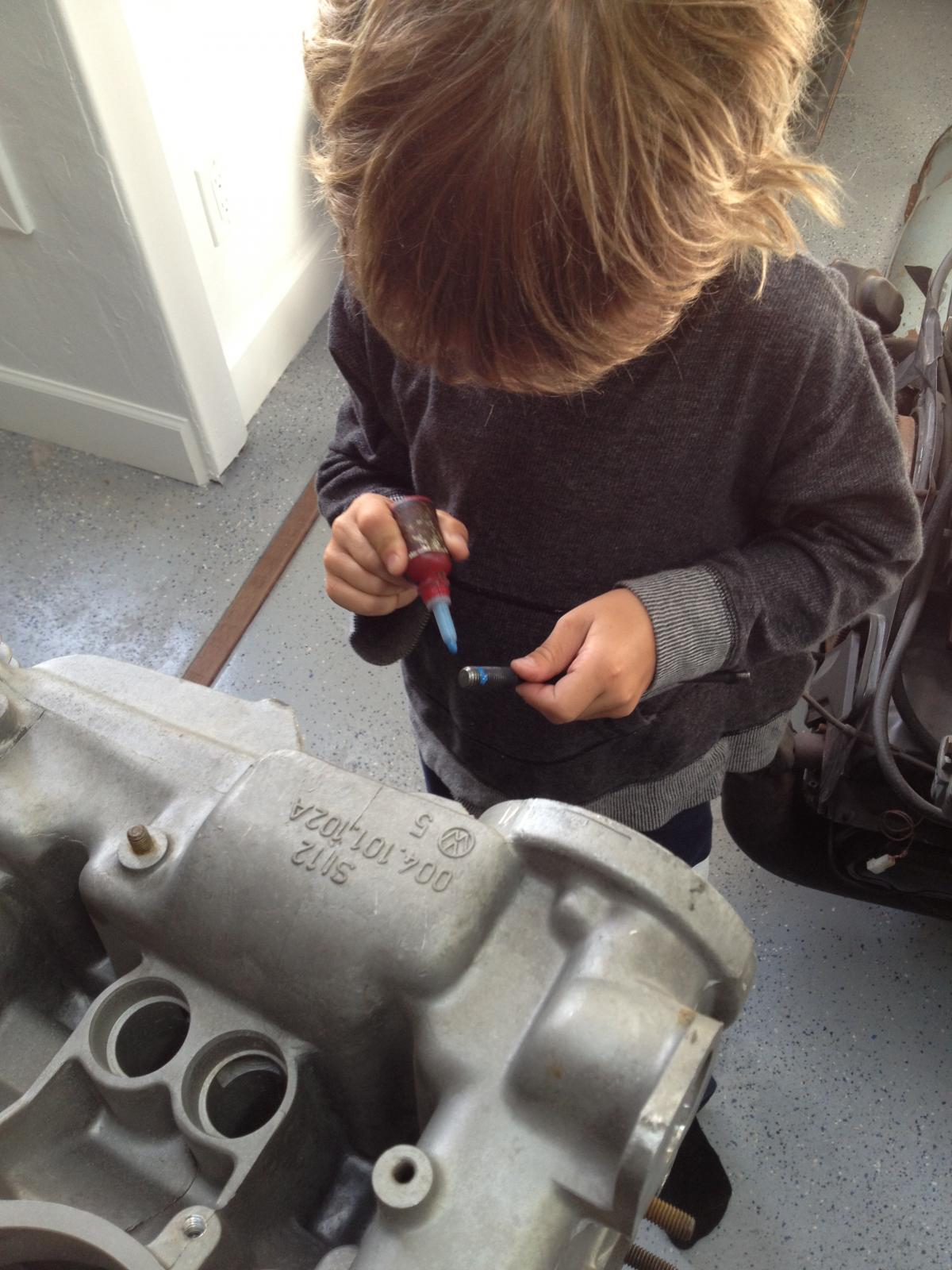

Head studs going in.

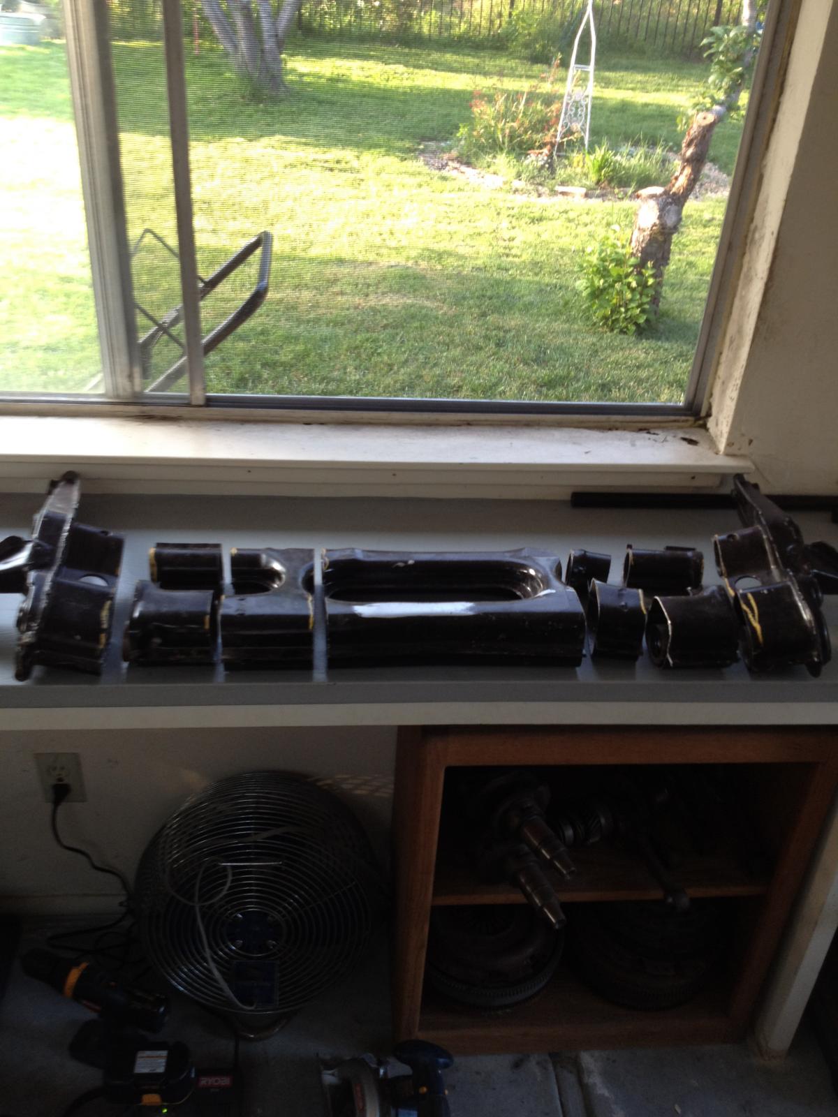

Like a bit of blue Lock-tite on them.

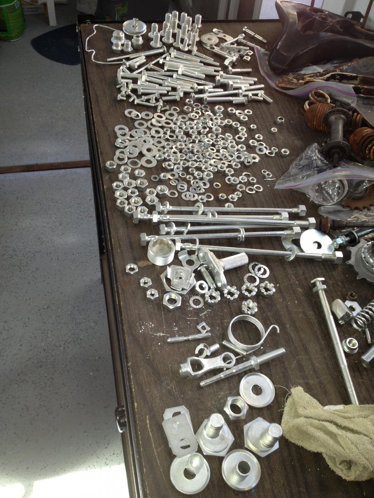

Fasteners were all done in white cad. Precision Metal Finishing in Canby, OR... Top shop.
Coming together!

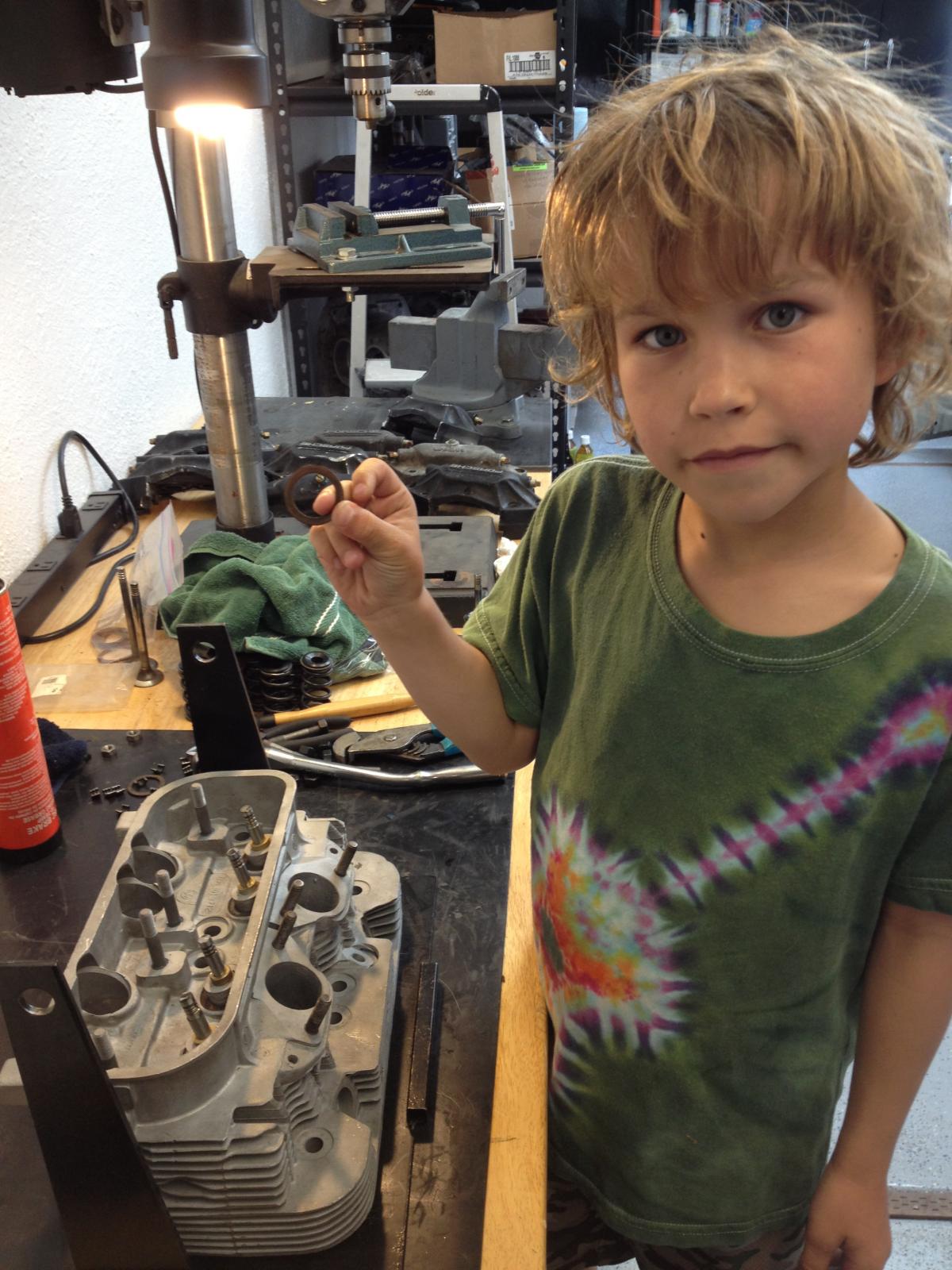

Wrist pins... Helps if you hold your mouth right!

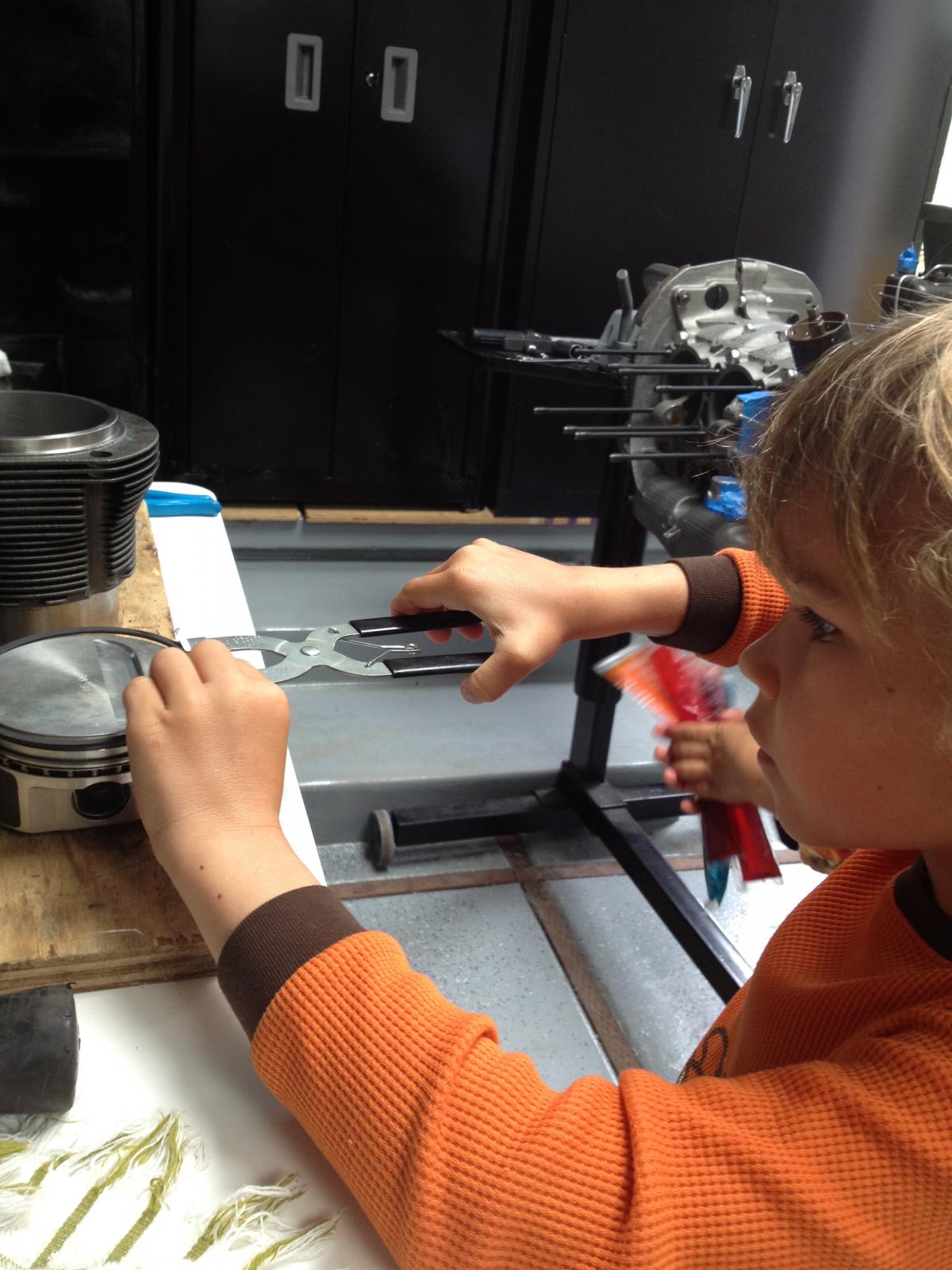

ANd rings...

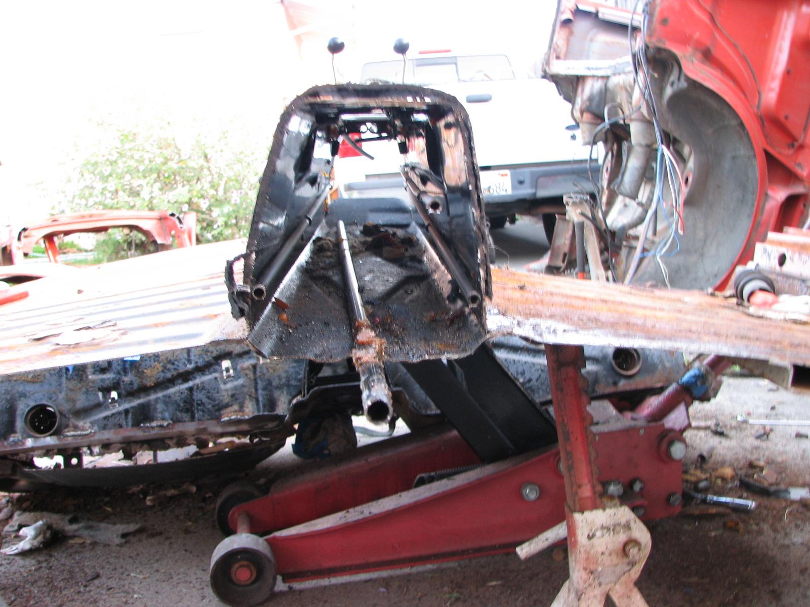

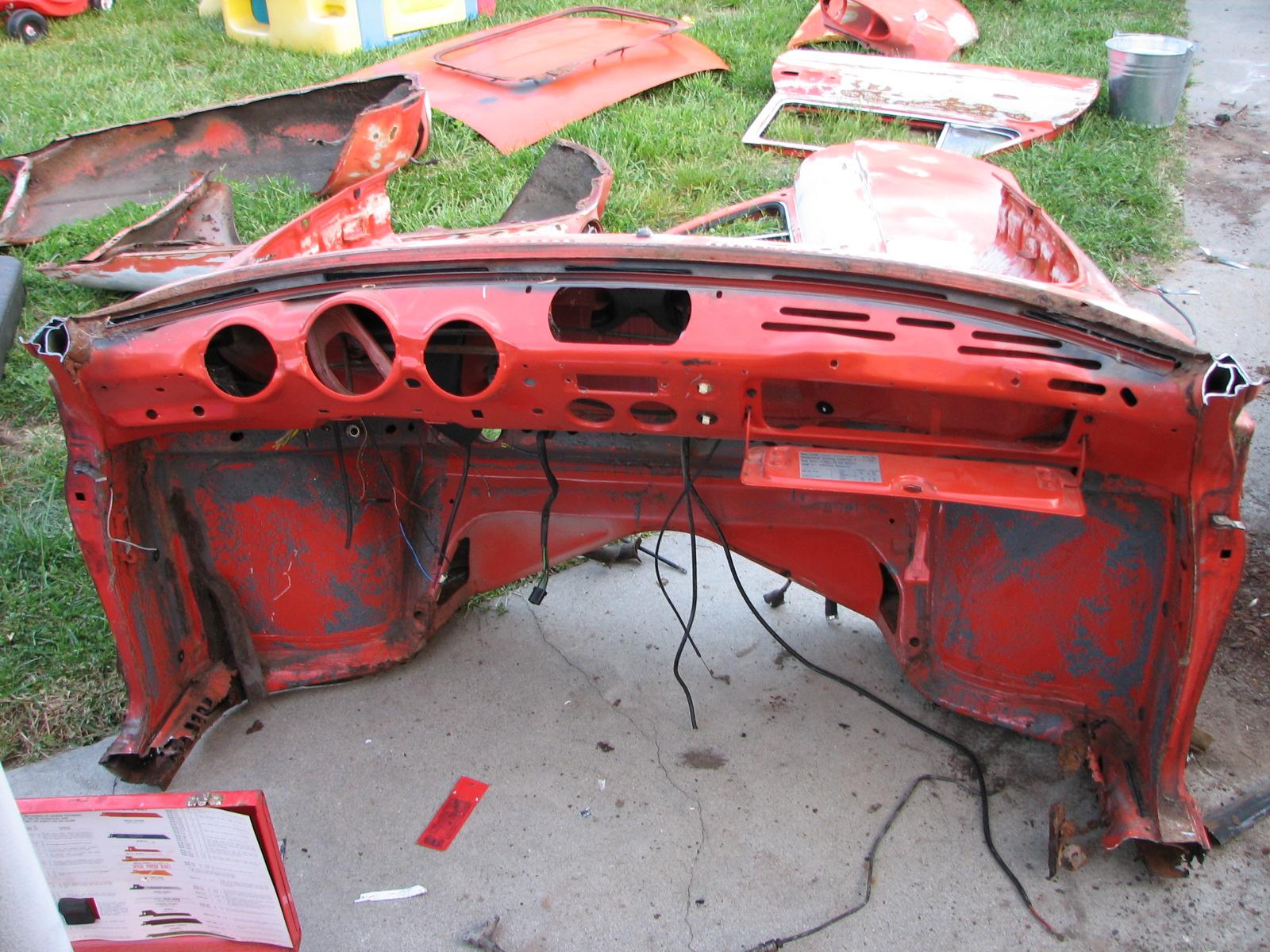

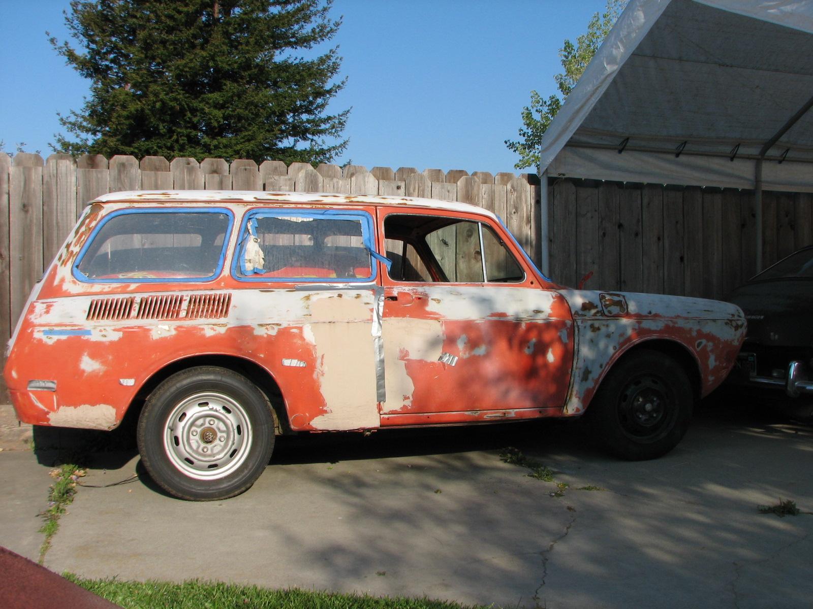

He has inspired me to take on a little side project; not just a square, but the late square he has been so instrumental in promoting.
Here it is when I got it home.
And the project is coming along...
Getting closer...
And almost done...
Once all of the parts were cut small enough, I fed them all to my pet snake Nagini.
That was fun and easy.
You can do a late Square in one day!
Will have to do another again soon.
Thanks again to Tram for all of his inspiration for this project.

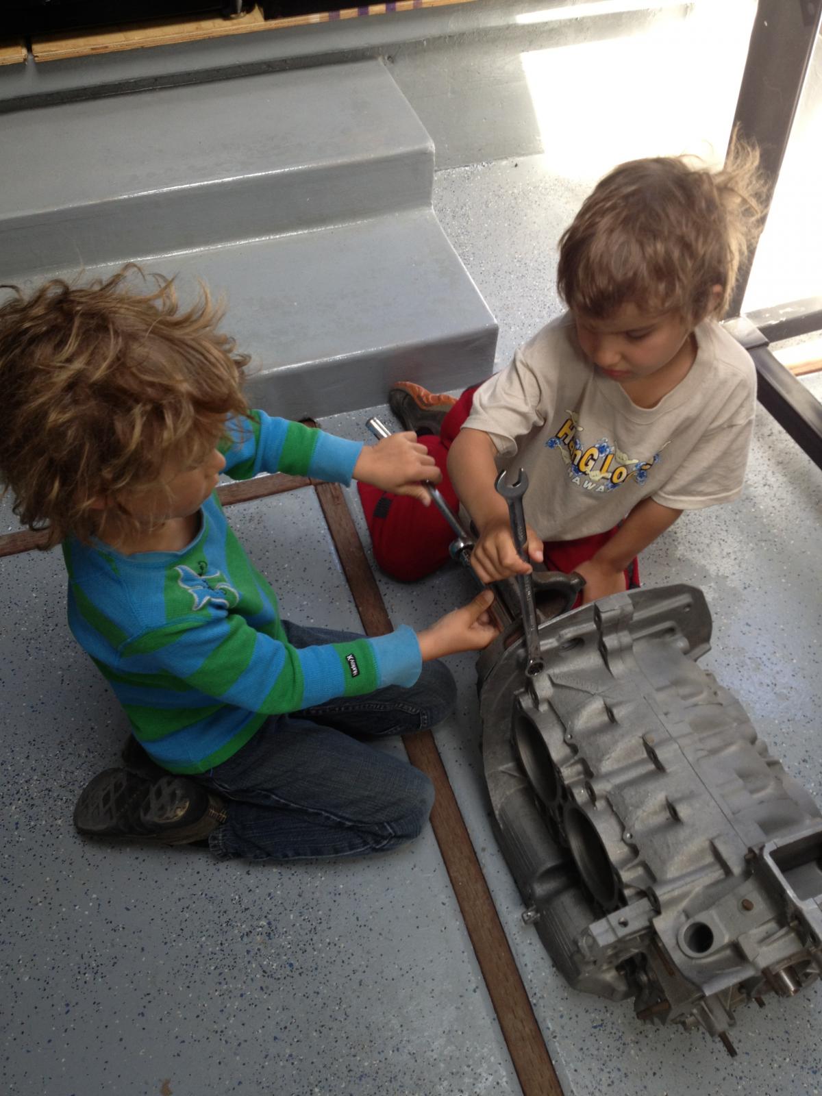

My son is helping teach me that top end parts are better assembled in your pajamas...
Since it's obvious that your son is doing all the hard work, I can safely assume that's his well earned Coors Light on the work bench too. . . Wink

Tram wrote:
Clatter- that was a Kasan Red '72, wasn't it? You sure know how to hurt a guy... Crying or Very sad No, seriously... try to find another one.
Sorry, but that was a complete utter dick move and post... Hitler was way more personable than I'll ever be for one, and I fail to see how this promotes the preservation of Type 3s for two.
Dag, could it be me, little old me, to get the great Rants Master's goat?
No snappy come-back?
Dag, I feel bad. (kinda).
That "car" was already gutted, rotten as a pear, had no paperwork, and was going to the crusher anyways.
Look again; it didn't even have a column...
I did put the very few parts that were any good here on this site and sold them to help others.
ANd totally lost my ass just having it hauled here.
Soooo....
Gotcha! Very Happy Very Happy Very Happy

With the cad plating, did they heat treat it too?

The fasteners didn't go out for heat treat. Just coating.

Alright, enough shenannigans,
I'll leave Tram alone (unless he starts in again)..
Here are some of the tribulations i went through to get a tight front beam.
The inner bushes are NLA, and a pretty significant wear point.
While you can get the needle rollers if you dig hard enough, however.
So, the only solution is to find a beam with good bushes.
In my case, I (foolishly) wanted to powder-coat the beam.
This will melt not the inner bushes, but the bakelite rings that support them.
Because removing the bakelite rings means destroying them, my answer was to cut up a beam and remove them, then installing after coating.
So we clean up yet another beam...
And cut it up.
Here are the uppers. You can see how they have tabs to bottom them in place when driven home.
The lowers have the same bottoming for the bakelite, but like the uppers, the bush itself does not have a shoulder to sit against. Another reason i like to drive them both in at once, to get them to sit home as a unit together... if that makes any sense.
Another stupid pet trick; polishing the surface the bush rides against. Maybe might lose a few tenths from this treatment, but would seem to make them last longer.
Makes it easy to get a feel for the fit if you have them free. Cut up a couple of beams and you will find a pretty good bit of variation here. Pays to get one that fits, right? If the rollers are out, only then will you get a feel for this fit. My seat-of-the-pants guess for a nice fit would be about 1/4" or 3/8" of lateral play clear out at the end of the arm by the ball joint, making about 1/8" or so total sideways movement at the seal surface/roller. At least that's the best i was getting on a used set after a few different beams got this exercise. FWIW..
After cutting a couple up and having them be rotten inside. (don't just lower your cars by splining them if you want the bushings to last, either. BTDT) Had to make a trip all the way up to Oaktown to get a complete from Chris Morrice. This one ended up being the prize.
ANd another part that is NLA, these thrust bushes... No matter the nice-ness of the beam, they are always at least a little cracked... Pick the best pair and stab them in...
In the end, my powder-coater was willing to try to work with the bakelite. After the fact, he tried to lower the temp of his oven and leave the stuff in for longer, and it flowed the powder on well and saved the bakelite at the same time. So, you don't have to be a Sawzall Samurai to powder-coat a beam, but do have to find a coater who cares...
So that's the beam itself, for now, we'll move on to other beam fun-ness in a future installment...
