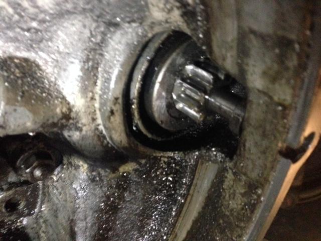

So I got some time to spend with the bus. Just wanted to try to get it running. Wouldn't start for nothing. I think this had something to do with it:
So I took the rotor off my 71 Ghia as well as a new distributor cap since the one on the bus was full of crud and it started right up! But with a very nasty rattle/grinding type sound.
Dropped the engine and found lots of shiny metal bits:
I'm guessing this is from the starter not disengaging? Here are some more shots:

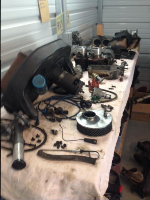

Here it is on the stand. I think I'll clean it up and replace the clutch and flywheel if you all think I should or do they look ok to you all? Is there an easy way to test the starter or do I just replace it?
I also killed two rats that had taken up residence. Definitely the hardest job all day.

This looks shinny. Is the flywheel hitting. What trans is that?

your circle is just a camera flash but all the silver points are bits of metal. As far as I know it is the transmission that's been on it for at least the past 10 years. The flywheel is chewed up a little but not too bad imho. Does the starter look ok to you all?

PostPosted: Wed Sep 21, 2016 12:27 pm    Post subject: Re: Byron's Bay Window Reply with quote
Use a magnet and see if the metal flakes are metal.
Some of the flywheel teeth look like they have been slammed into by the starter bendix (gear)
With the starter in the trans. Hook up jumper cables and test the starter.
The starter gear should twist slightly as it is coming out and not start spinning until it is almost all the way out.
The starter gear should completely retract every time you disconnect power from the starter.

Well I should listen to my elders. That wasn't just a camera flash; it was where the flywheel was rubbing. It was doing it in four places too.
Here is where I stand today:
I discovered that I have almost an eighth inch free play. Quite a bit more than .004, huh? So I'll be tearing into this case. Ordered my Tom Wilson book on rebuilding these things too. I'll let you all know how it goes; please offer comments or scathing criticism as I enter unknown territory. I can take it! My friend who has forgotten more about air cooled vw engines than I'll ever know said I'm probably looking at align-boring. I'll post pictures of what I find and wait for your advice.

This is extreme but will give you the idea of what is going on. Hopefully your case is not this bad.
Find a shop that specializes in VW's. I also recommend buying the bearings from the machine shop. That way they are sure to fit right.
Good luck

Why didn't I come in and read this first? So I'll be in the market for a new pulley. In my defense, I couldn't find a puller that would fit the inside holes and the pulley had a big crack in it anyway. So it took me and four of my best friends to get it out.
I'm sure you old hats have seen this many times before and are sitting there shaking your heads and laughing at me. Have mercy on a newby like me.
And what's up with these cylinder heads? Anyone recognize this? Any good or just throw them away?
I didn't clean that; it came off that clean.
Thanks for looking in and your comments are always welcome!
