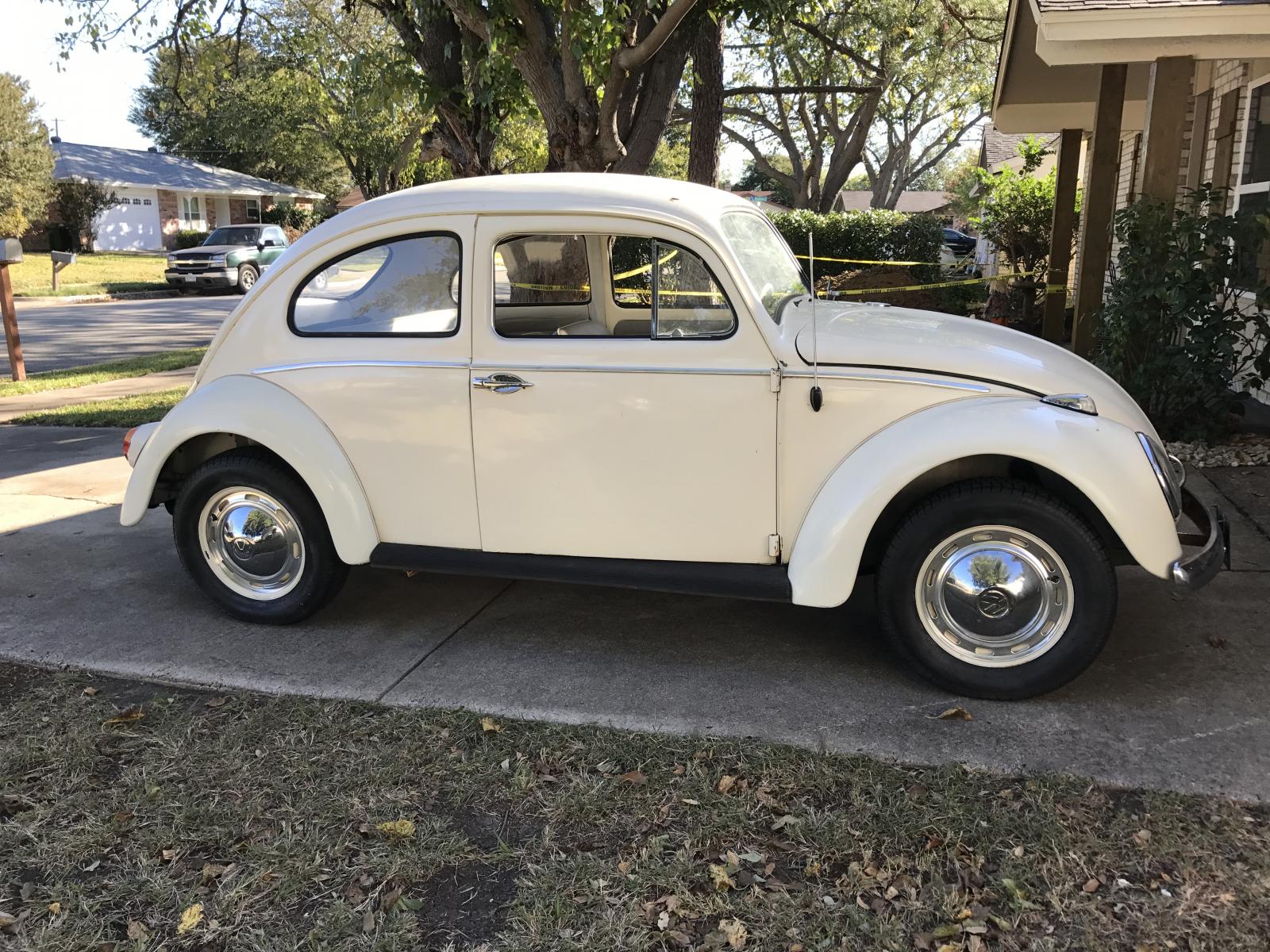

Hi guys/gals. I've been lurking here for a short time and picked up my first project. It's a 1964 Beetle that is in pretty good shape and will be the recipient of some TLC. My efforts will be focused on getting the car back to how it was when it left the factory.
The car was built in August of 1963 as serial 5748732.

Welcome! Post more pics, please!
Looks like it's sitting very high. Does it have a motor in it? Does it have an adjustable front end?

It does have a motor in it. I did notice it has had coil over shocks installed. I'm guessing that may be why it is sitting tall. I will also be looking for a buyer for this engine as I will be putting a 1200 back in.
I'll post more pics to keep the thread lively.

Don't drive the car much with the engine in it's current condition. You're missing the engine seal and added to the chrome tin, you're cooking that engine with all the heat.

Engine and bay needs a bit of work!
Those chrome tins mean you have no heater, and generally rust and fit poorly. Looks like you have a header system, probably no heater boxes. Stock tins and heat exchangers will work out well if you can find them cheap in the classifieds.
That power pulley will make it run hot (slower fan), and the lack of engine bay seals will make that worse.
I'd look for a stock air cleaner as well, for many reasons.
But first, do a compression test and check oil pressure and screen to size up the motor condition, before worrying about all the accessories. If your engine is toast, a complete used running motor may be a better bargain.
Coil overs are unnecessary in a Bug and can break shock mounts. I wonder why the PO installed them?

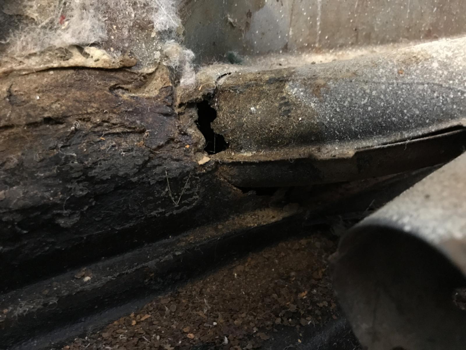

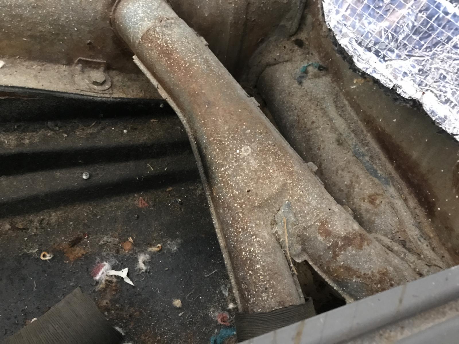

Channels and the rest of the body appears to be all original metal. I did find one small hole where the passenger side "Y" joins the heater channel under the rear seat.
I'm sure someone knows, but is the angle that is on the forward passenger floor board supposed to lie there freely or were they originally attached somehow?

PostPosted: Fri Nov 03, 2017 12:59 pm    Post subject: Re: My First Beetle Project- 1964 Reply with quote
The floor mat, and gravity, holds the footrest down.

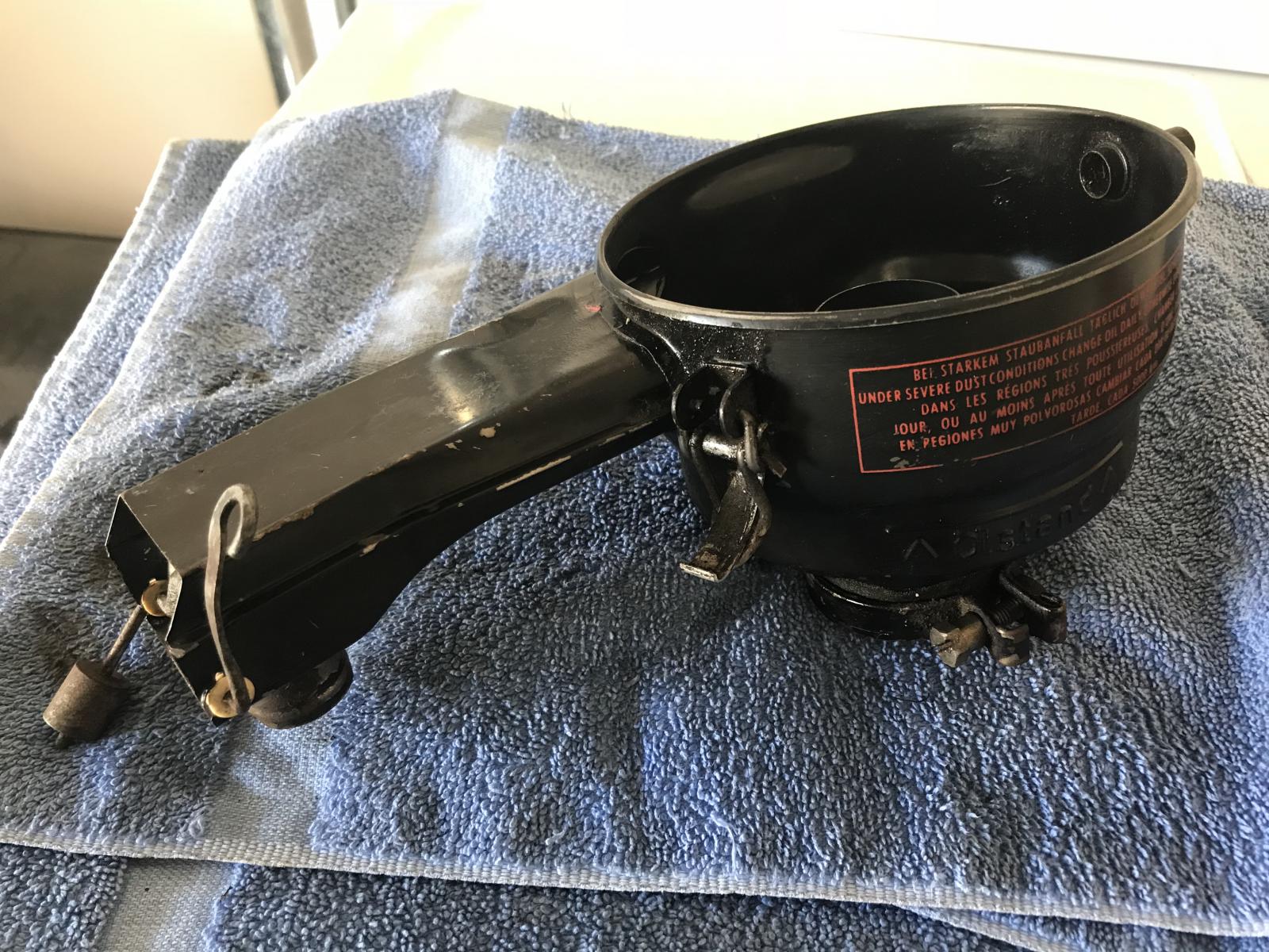

During a visit with family in Oklahoma I picked up a few parts that were listed nearby that I will need for the project. I found an original oil bath in decent condition. The top has a pretty big dent in it so I am on the hunt for a better top. I also picked up a few rebuildable Pierburg fuel pumps, a 6V generator/fan, and an original shroud with flaps.
A local VW guy had a rebuild kit so I built the assembly jig and worked on putting one of the pumps back together after a thorough cleaning. The kit didn't come with a new screen so I ordered a screen/gasket set from Doug, 56 Beetle. The pump won't look as nice as the more expensive rebuilds that are available, but it should do the trick. I am contemplating getting the cover and screws re-plated to look a little nicer, but the not-so-perfect look has some appeal to me.
Be sure to check your pump pressure. Most rebuild kits available today are notorious for producing too much pressure because of the main spring. Best to use an original spring.
