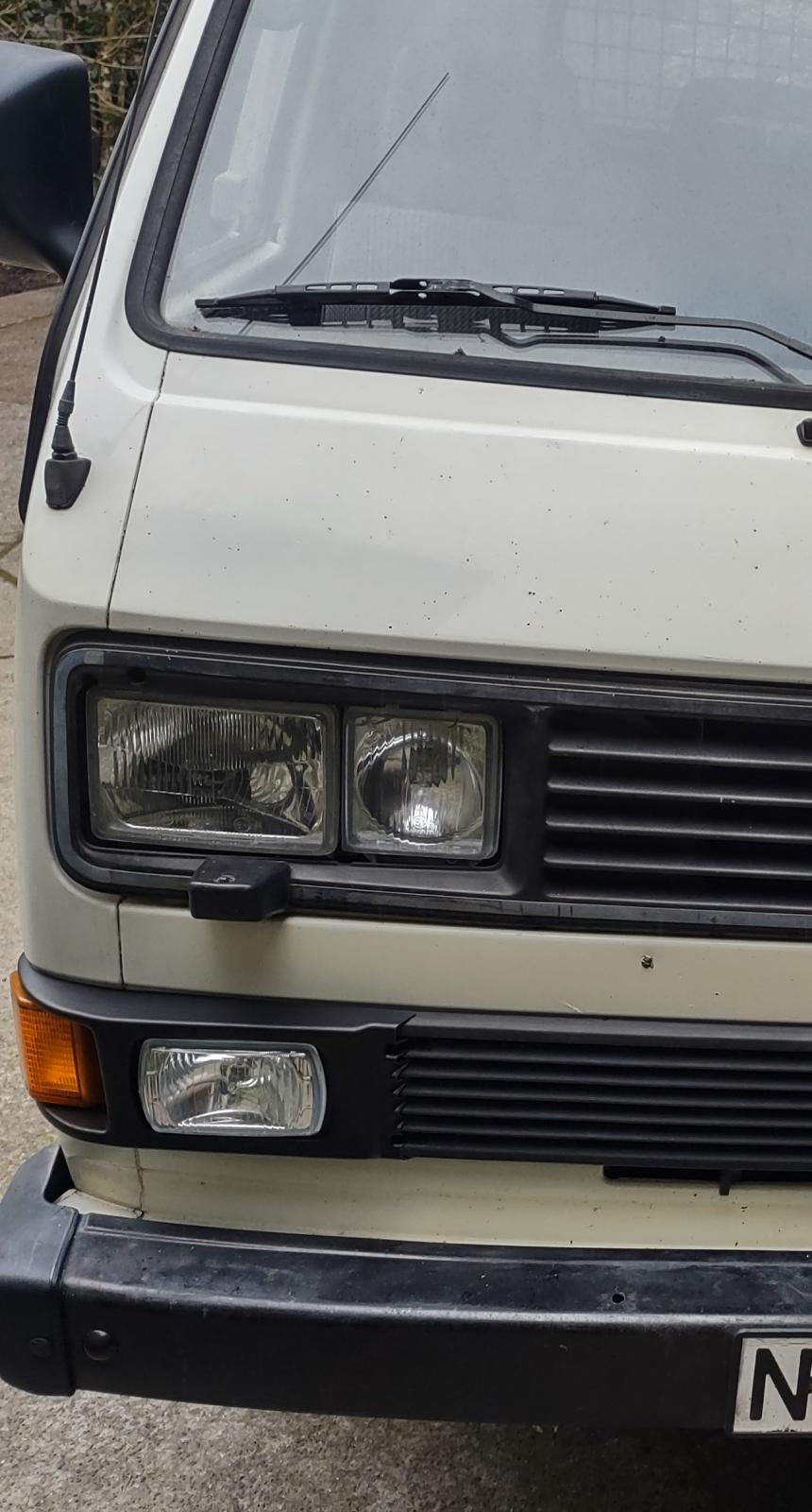

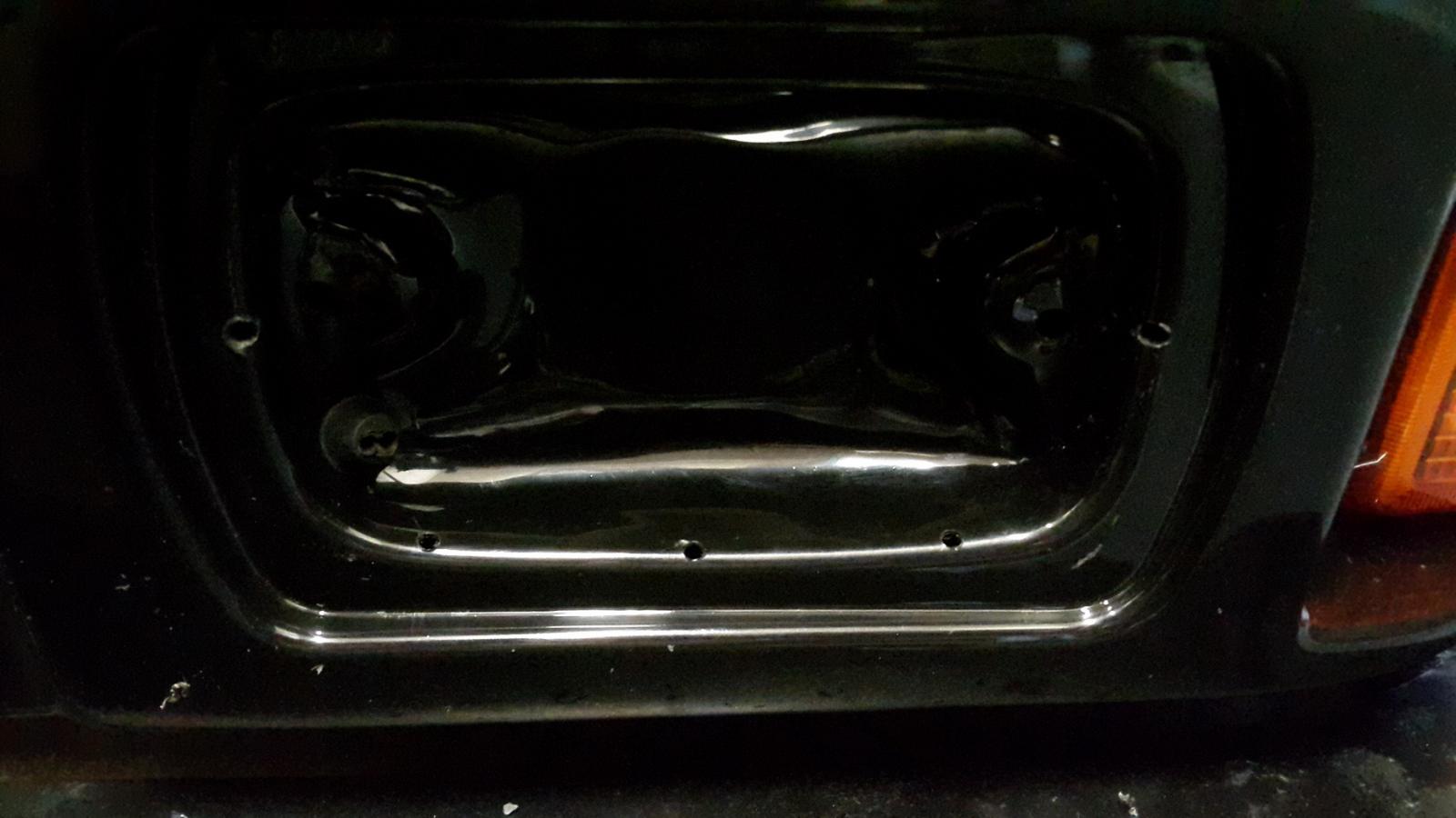

I mounted the MMT3 lights yesterday. One of the upper tabs broke off when mounting, kind of disapointing.
I'll email the MMT3 shop and see what they say. Probably would have been best to warm them up in the hot sun when mounting. The plastic is rather thin where it pulled through.
I'll probably call Terrawagen about their lights. They're in town here in Portland and it looks like a well thought out solution.
https://www.terrawagen.com/products/terrapodz-v2
Here are the MMT3 version

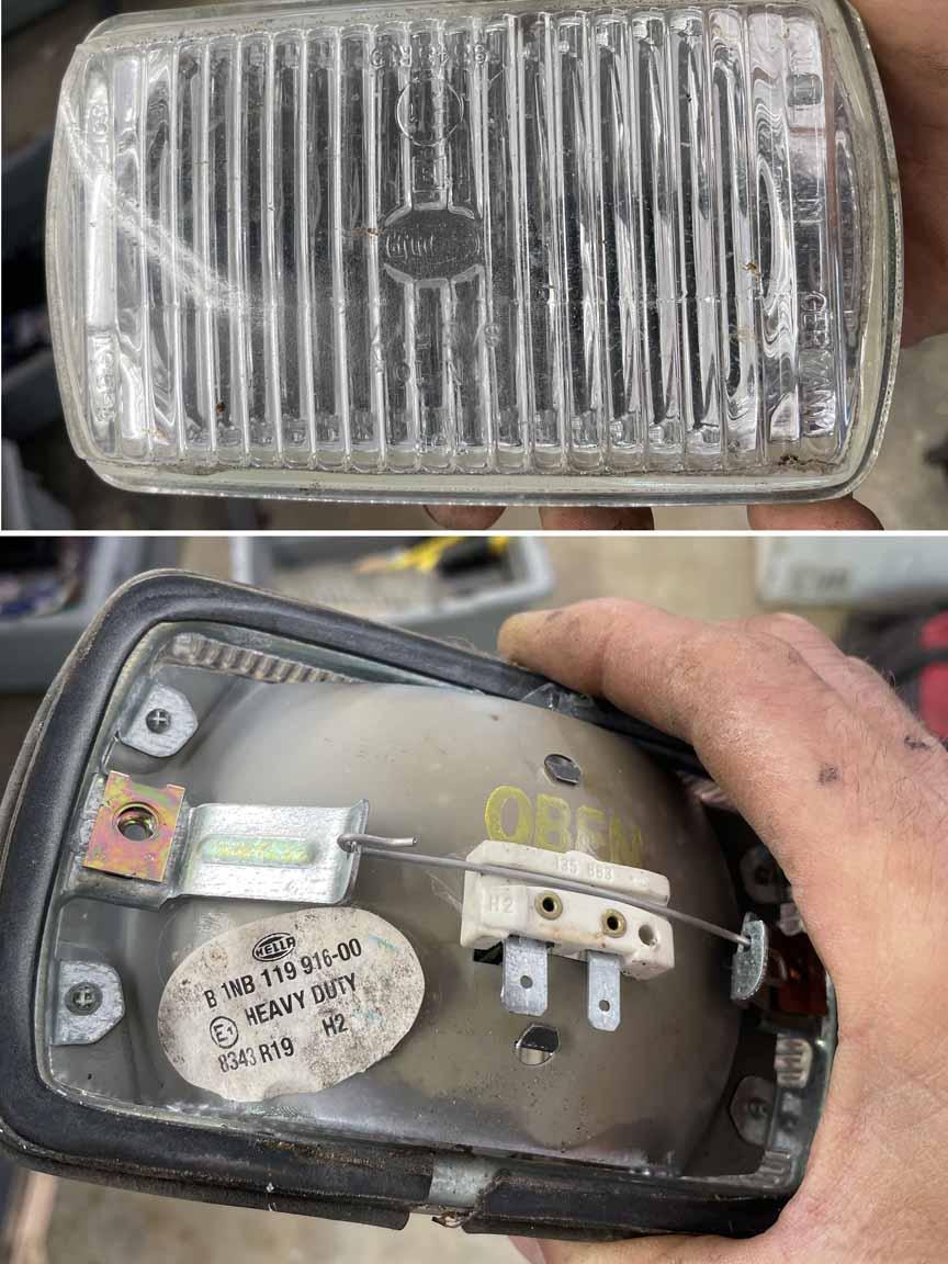

Sodo - I think those are original Projek lenses you have. I've been trying to find a LED replacement bulb without success for years.
I used to have that 3M clear plastic lens cover on mine but the light would get real hot and I didn't want to go cutting vents in the back of $$$ original Projektzwos!

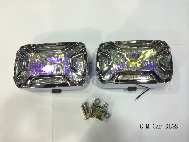

The ones from Allexpress look great except there seems to be an external mounting loop on the lens case -- can't tell if it's removable (to fit the projektzwo housing) or if it needs to be filed off or something to fit ?
Well, it does look like the lens itself will fit if removed and placed in the old lens case.

Please post when you receive the new light. I would like to have one or two spare lights on hand that fit the Projektzwos. There is a thread here where a guy was talking about having an exact replica made of the glass. At the same time if I remember correctly an exact Chinese replica was being offered for super cheap.
Just read back in this thread a little and I guess this is/was the thread I was talking about.

Im a curious about the light pattern on those FX lights. They have very clear glass compressor to the original Projekt Zwo lights.
The original Projekt Zwo lights are actually Hella 155 fog lights. They pop up on eBay now and then. Also original on Jaguar XJS. They were available in clear or yellow fog and clear driving light pattern.

My original Projektzwo fog lights glass bezel (lens) was seriously cracked. I ordered an FX1155 from aliexpress in the past and it fit perfectly into my Projektzwo housing. I did need to customized the wiring as it comes with pigtails not a plug. That link is dead now, but here's an active link I found, just ordered one today.
https://www.aliexpress.com/item/1-pair-12v-55w-Hal...12804.html
Here's some useful keywords for searching for this particular lens:
https://www.google.com/search?q=+"PB055"+fog
https://www.google.com/search?q="PB055"+"FX1155"
FX1155
EL055
PB055
