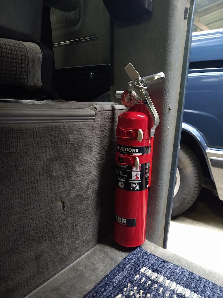

90Doka_Guy wrote:
Inspired by Vanuber on the previous page, I decided to purchase the ABC version of his extinguisher. Wanting to mount it in the stock location without drilling holes, I decided to 3D print an adaptor. Happy to send over an STL file if you would like to print one for yourself. This is the MX250 extinguisher, from the looks of it the HalGuard version cradle appears the same.
Looks nice... but is that 3D printed piece strong enough to keep that extinguisher from breaking it apart and punching a rear passenger in the chest/face in the event of a collision from the rear?

Didn't know that. With the name Halguard I just assumed it was Halon. Edited my post.

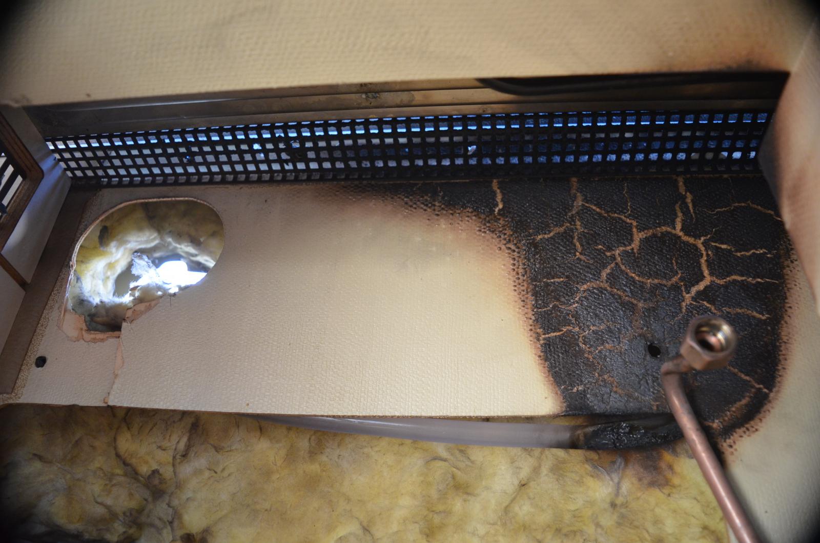

PostPosted: Sun Feb 16, 2020 10:55 am    Post subject: Re: Westy Fire Extinguisher Reply with quote
When you smell gas, turn off the gas! I once had to shut off a flaming Silane 300 cu ft cylinder. Regulator ruptured, and silane is pyrophoric, so the only way to stop the flames, and prevent the cylinder fitting from melting and causing a big kaboom is to shut off the cylinder. Singed my hand, but saved the gas cylinder room, which was loaded with a lot more dangerous stuff than silane. 13 fire trucks arrived and near 1000 people evacuated from the building, I had only been on the job several months. They told me I probably should have ran away, but thanked me for saving the building.
Glad no one was harmed in the van, smart wife to suggest shut off the gas!

Yikes! Blowing the canvas off is impressive...and scary.
- Jim
Butcher wrote:
Guilty as charged.

PostPosted: Sun Feb 16, 2020 7:44 am    Post subject: Re: Westy Fire Extinguisher Reply with quote
Last week we woke up at the first campground of a 10-day trip and started to make breakfast. My wife tried to light the burner, but I hadn't opened the tank valve yet. She wanted to know exactly where the valve is, so we went outside and I showed her where to open it. When we got back in I smelled gas. I said she must have left the burner valve open. She said she hadn't. I checked each valve and sure enough both were closed. While this was sinking in, my wife opened a valve and clicked the lighter. There was a big Whoosh! and the van was engulfed in flames, then went out. A roll of paper towels on the table was on fire. I grabbed it, threw it outside, then jumped out and stomped the fire out. My wife screamed “It's on FIRE!” I turned to see flames shooting out from behind the stove. I went for the fire extinguisher, and, after what seemed like forever, figured out how to get it off the bracket. I discharged it behind the stove and put out the flames. I couldn't figure out what had happened. I started to assess the damage. For some reason, I opened the refrigerator door. Another Whoosh! and the van was engulfed in flames again, then they were gone. There were no flames behind the stove this time, but I discharged the fire extinguisher under the refrigerator. My wife jumped out of the van and said she was going to turn off the gas. Oh, yeah. Good idea!
After calming down, I looked around the van. The curtains, curtain retaining cord, and window screen above the stove were melted. The stove cover had clumps of melted plastic (the curtains) on it. The cover over a LED light above the stove was melted. The pop-top roof vent was blown off the skylight flex arm and flipped over. The metal strip above the sliding door that holds down the tent was pulled up, ripping some screws out of their hole and tearing the heads off of others. Other than a singed eyebrow and slight redness on the side of my hand, we were unhurt.
I realized the gas had to come from behind the stove. A few weeks before I pulled the refrigerator to replace the fan. I somehow forgot to reattach the gas line. I have a small computer fan inside the refrigerator to circulate the air inside. As soon as I opened the door, it must have reignited the gas.
At my age, every brain fart raises the fear of Alzheimer's. This one was scary. I already automatically get my camera whenever I do something on the van. I'll have to document more. Or retire from Vanagon maintenance altogether.
Years ago, when the bracket broke on my van's original fire extinguisher, I just put the extinguisher in the small cabinet next to the refrigerator, where it slowly worked it's way beneath everything else in there. Only after reading this thread did I go ahead and buy a new one and mount it where the original was located, inside the sliding door. If I hadn't done that, the delay in digging my fire extinguisher out of the cabinet could have made this a lot worse. Time to donate to TheSamba.com again.
1985 Westfalia 15 degree EA288 Boxeer
