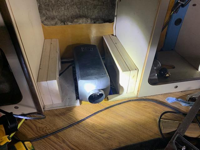

PostPosted: Tue Nov 11, 2025 9:59 pm    Post subject: Re: The official Chinese Diesel Heater thread (Webasto Knockoff) Reply with quote
dhaavers wrote:
nilbog wrote:
I mounted my newly installed CDH directly on the westy wood in my rear bench, with a 4" hole drilled straight through to underside . Should I go back and remove all the wood around the furnace ...
I can’t imagine that the CDH outer case gets hot enough to be a concern, even mounted directly on the wood. I’d think you’re ok, but bonus points if the exhaust pipe is centered in the 4” hole. Intake pipe at ambient temperature can be off to the side, even right up against the wood.
Having said all that, I’ve never actually measured the case or exhaust pipe temp… maybe someone has & can report in.
Anyone?
- Dave
PS: Welcome to Samba, nilbog!
Thanks so much! Glad to be here. I've got a new to me 1986 full camper with a bright orange pop top tent in Southern California.
I should have also mentioned, the heater is mounted with a metal turret mount from the amazon jungle so all these posts make me worry a lot less.
thanks

PostPosted: Tue Nov 11, 2025 4:40 pm    Post subject: Re: The official Chinese Diesel Heater thread (Webasto Knockoff) Reply with quote
dhaavers wrote:
Anyone?
- Dave
The heater casing doesn't get hot, you can touch it while the heater is running and faintly feel warmth on the casing.
The concern is the exhaust pipe does indeed get very hot. I have on in my bug and another portable heater for my EV.
On the portable heater, I place it on a small table with a metal plate under the heater exhaust.
The first time I used that heater last winter, the the exhaust made a burn mark through the metal plate into the top of the table.
I need to rethink that setup before the next time I use it.

PostPosted: Tue Nov 11, 2025 9:42 am    Post subject: Re: The official Chinese Diesel Heater thread (Webasto Knockoff) Reply with quote
I think probably yes ...

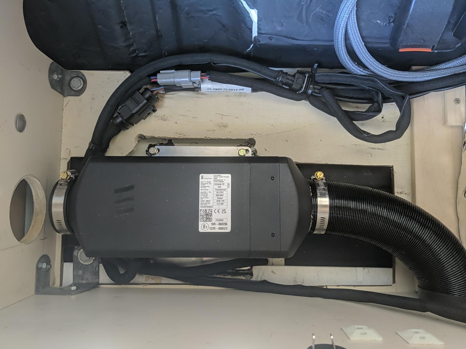

PostPosted: Wed Sep 03, 2025 5:57 am    Post subject: Re: The official Chinese Diesel Heater thread (Webasto Knockoff) Reply with quote
You definitely need to mount it flat to a flat surface to get a good seal, and yes- that section of the furnace gets VERY hot. It's not allowed to be in contact with wood, and I think the design specs for that particular espar are something like 1'' in all direction from the closes piece of wood.
I've installed them on the floor, and done so by cutting a piece of floor out bigger then the heater and grafting in a flat plate of metal, sealing that securely to the ridges of the floor, and then just securing the furnace to the flat plate as designed.
http://www.thesamba.com/vw/forum/viewtopic.php?t=559766&highlight=winter+rust

PostPosted: Tue Sep 02, 2025 2:08 pm    Post subject: Re: The official Chinese Diesel Heater thread (Webasto Knockoff) Reply with quote
the_benjamin_effect wrote:
I was going to use a turret for my installation in the same exact place as in this pic. But why is there a bunch of wood cut out of the base of the rear seat to fit the shape of the heater and turret? I thought that even if I needed longer studs on the heater to reach through the wood that I could just mount the turret on the wood floor since it’ll never get hot enough to be a problem.
Am I missing something real obvious about why I shouldn’t do that?

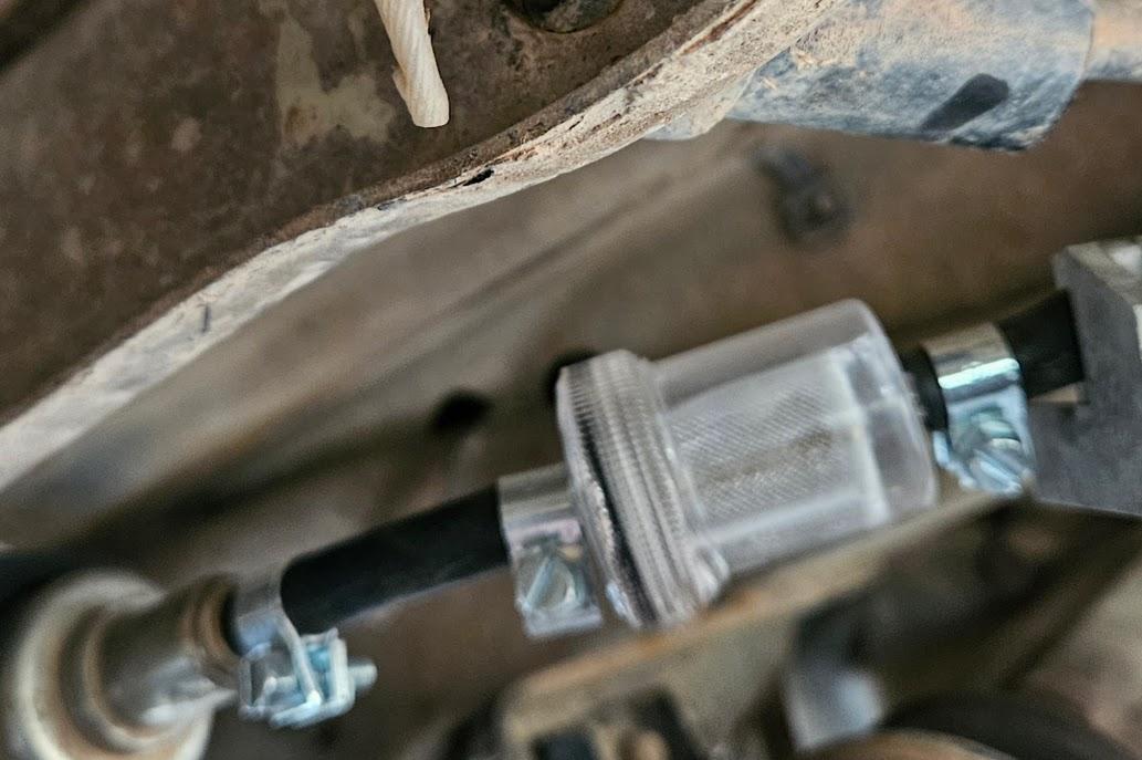

PostPosted: Tue Feb 04, 2025 9:48 am    Post subject: Re: The official Chinese Diesel Heater thread (Webasto Knockoff) Reply with quote
Friendly reminder that these filters are garbage. My heater wasn't firing because there was a huge crack in this new one and kerosene was pouring out of it. And down my arm, of course. (I use Klean Heat Kerosene instead of diesel. Expensive, but it makes my van smell like bygone days at my grandparent's house on Cotile Lake, Lousiana.)
Another friendly reminder, hoarding is good for you. I found a brand-new Eberspacher filter in my box o' heater parts. Thanks, Four Years Ago Joe, for hooking me up.
Five year-old $120 heater is back in business, doing its thing.
