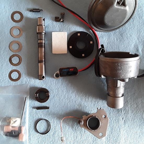

Follow up:
The Compu-Fire # 21101 doesn't fit my 205 M, as in, no way no how. It went back together nicely though. I had to re-use the shim under the breaker plate because I forgot to order one. Re-used a couple other shims too because they were fine. I still need to get points and condenser from VWNOS though. The Compu-Fire is being returned. I'll just stick with points. It's what I know anyway.
