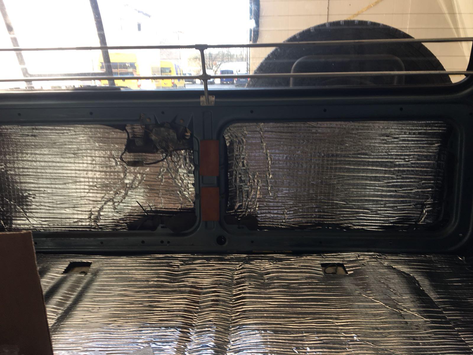

Full interior was insulated and rear heater delete was performed as the RnR bed from M1 campers has inbuilt seat belts, but it is not as big as westy bed.

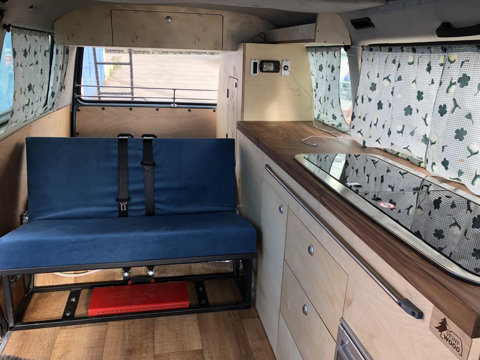

Plywood was used for cabinets and walnut for top.

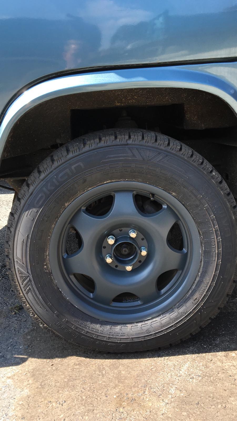

- I managed to get CLKs and they are powder coated now. I have chosen Nokian Rotiiva A/T 215/70 R16

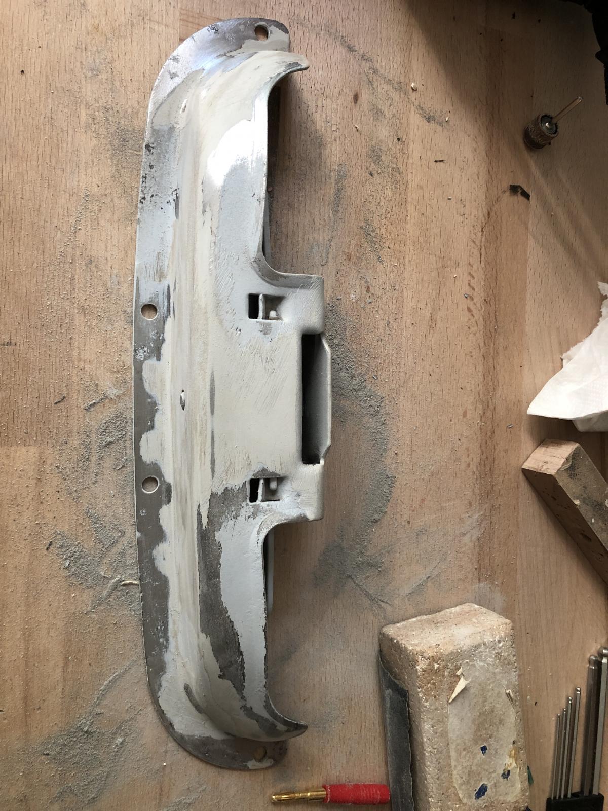

Easy stuff was painting the gas filler housing. Primer for plastic and black paint in the spray can made large difference. Looks almost like new.
Pop top got attention too: cleaning, rust removal and painting

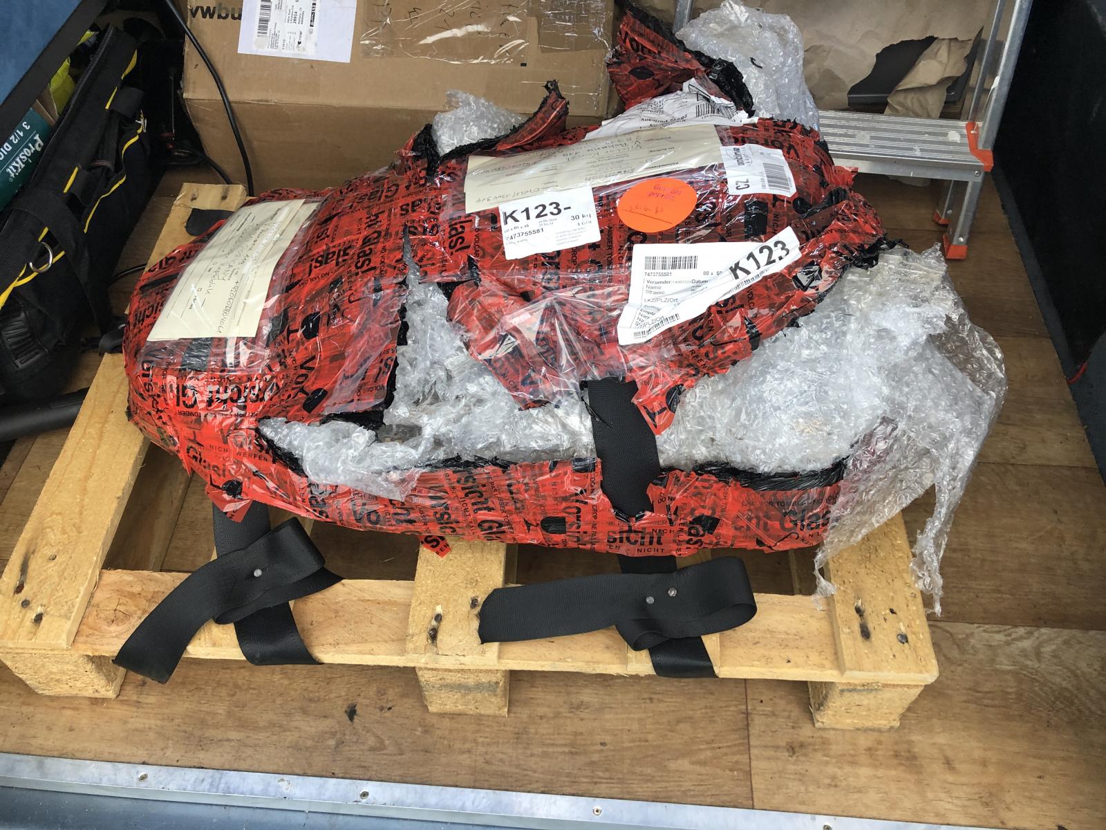

But much more interesting item has been delivered from Germany today - ADH front diff (with locker). Price was really good - seller had wrong description on the item. Taking in consideration that locker alone is €800... Only I have to wait till end of the month to have it installed as local specialist has vacation. AND my bus has 6N which means different final drive so they will have to take final drive from my old one to the ¨new¨ one + few bits and bobs.

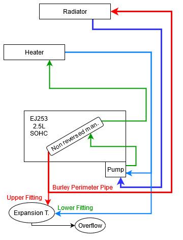

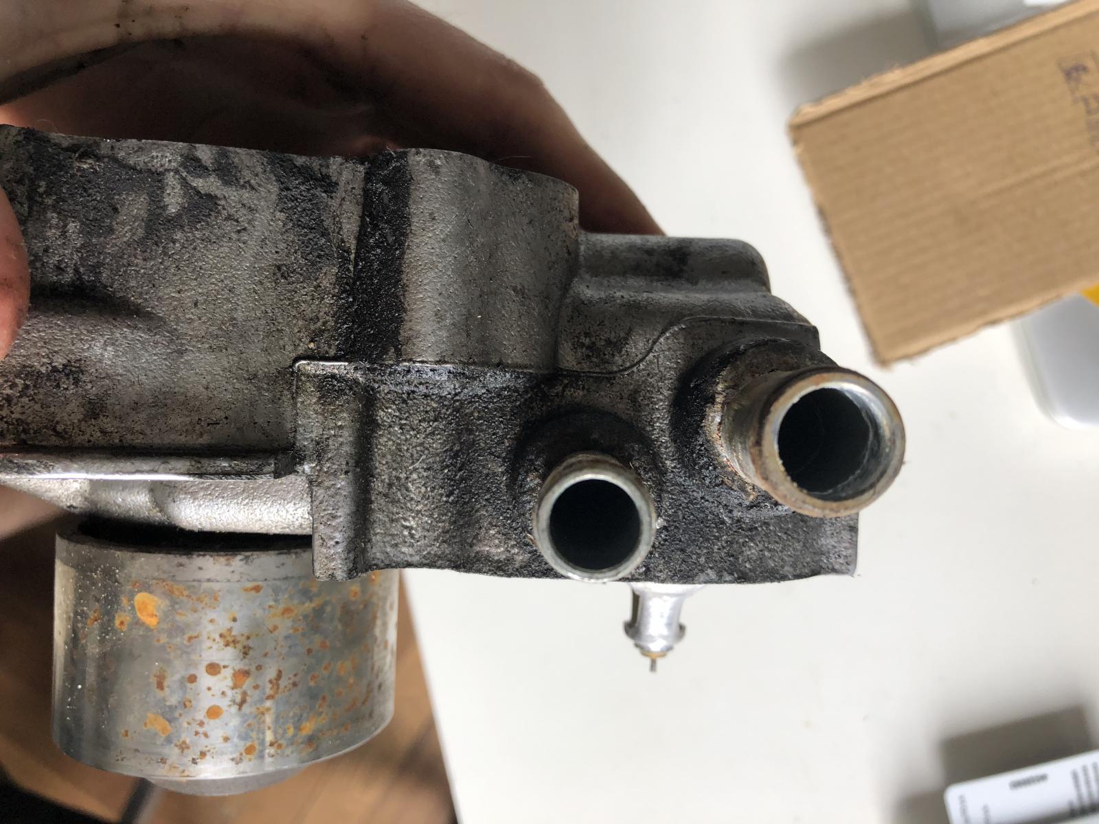

Hi I might need some help here...
My bus seems to run tad hot based on the gauge.
- I installed new radiator baffles
- Soldered new 28Ohm resistor
- founded out that PO made interesting wiring nest in place of the foil + strange wire is hooked to the yellor/red wire for the temperature gauge (need to investigate that further).
- I do run Burley cooling pipes and non reversed manifold
- My engine is EJ253 which has different water pump:
- I can not see any bypass for heater installed

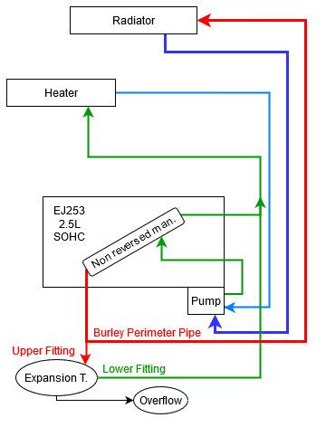

Diagram how the cooling system is in place:
Comparing with Burley one
seems to me that lower exit of the expansion tank shall meet with return from the heater and merge before the Subaru bypass tube and not to be connected to the "hot" side of the heater circuit.
Shall it modified like this:
Or am I wrong?
Thank you

Who did your cabinets?

Hi Zoti,
They are custom made by this company: http://vejnywood.cz/
It is one of their earlier jobs, so I find it rough around edges here and there. Roughly Oct. I will install original Westy bed in the back thus have to cut few cm off the units Crying or Very sad

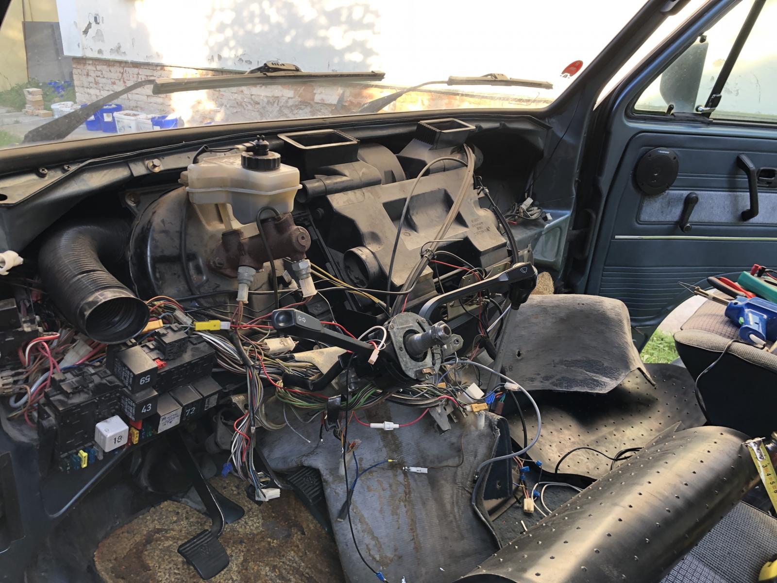

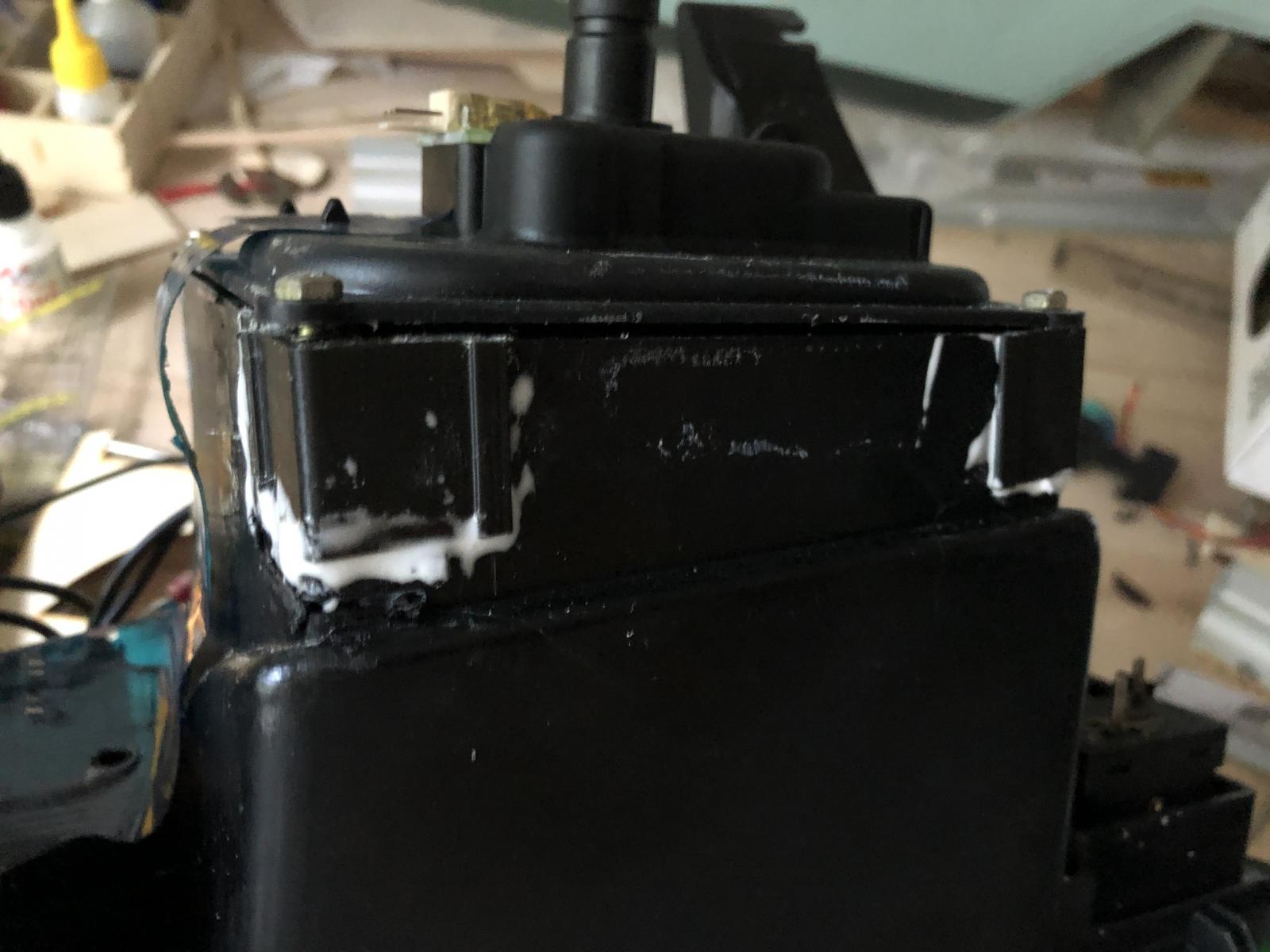

- Instrument cluster repaired. I printed out new edges to fit the new cut outs and glued everything together with mix of epoxy and microbaloons. So far it looks ok. Not the best job though. Thank you Samba -> I found inspiration in one of the older threads here.
Heater core is ready to be taken out and lets hope I will start to put it back together on Sat. The BMW brake booster will probably stay in a box this time. As much as I would like to have it installed some safety margin on time is better for me at the moment.

Vik, do you have any more information about the rear bench (manufacturer, how to obtain it, how it was installed) ?
It has the integrated shoulder belts attached to the bench, which will eliminate the need of cutting a slot on the rear cabinet (which the GW instructions ask you to do to use their kit with the rear mounting points).
