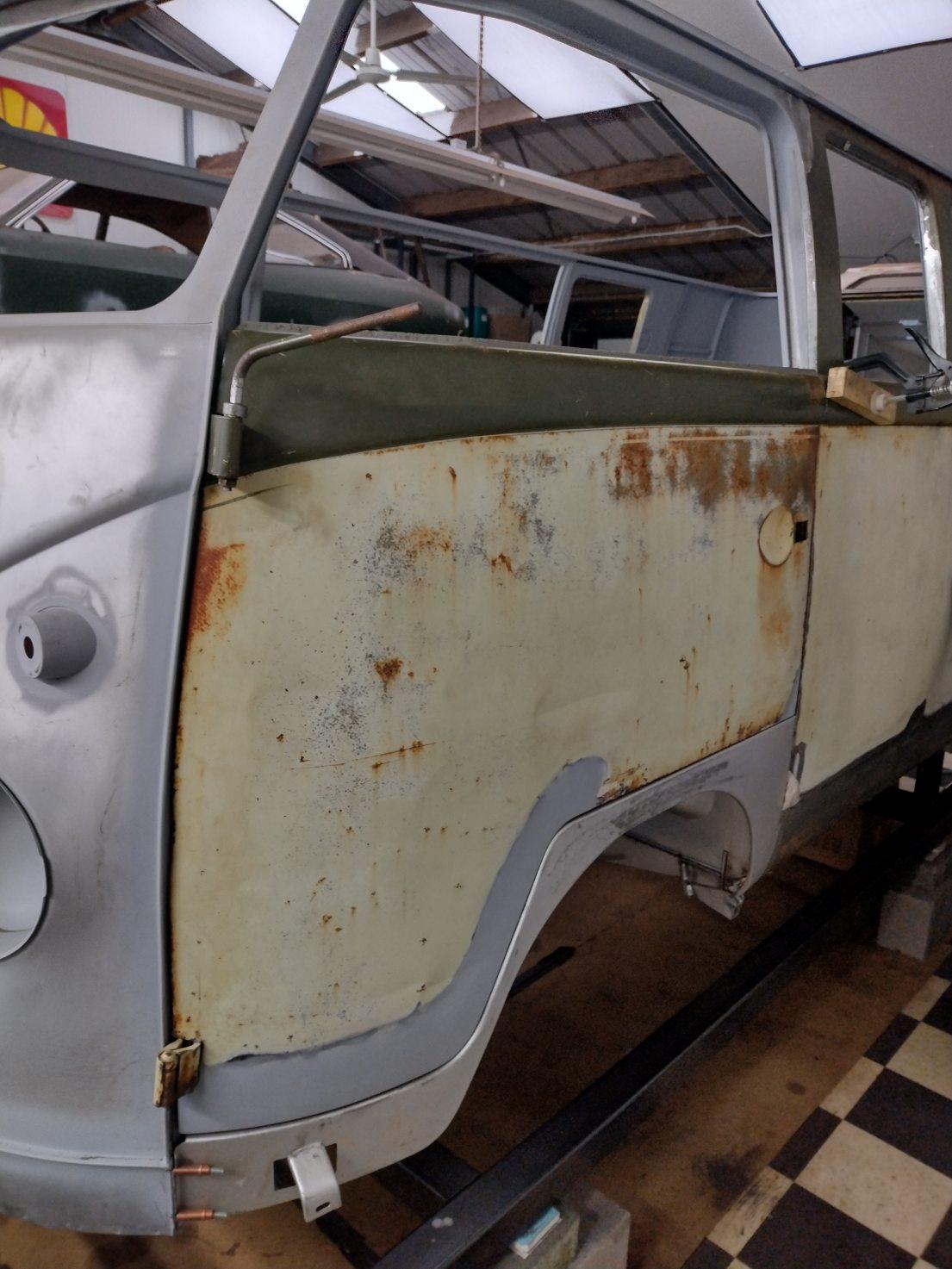

I now have the bolts for the upper hinges and have welded on the first mirror arm. Now I can align the door exactly and fit the dogleg

Fat base mirror arms are a important detail on that early splits!
Good work man!

Thanks,
Yes. I definitely didn't want stainless steel repro arms. Also, the bolt had to be thicker because the hinge had a lot of play

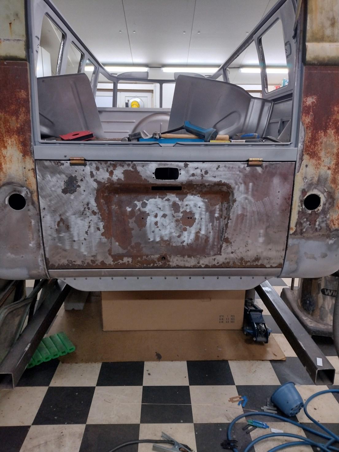

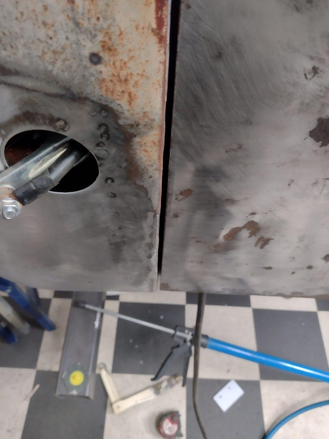

Hello everyone,
less happens in winter. It's too cold for me in the workshop. Everything you touch is freezing cold. Also had a job on another car in a smaller garage, not quite as cold.

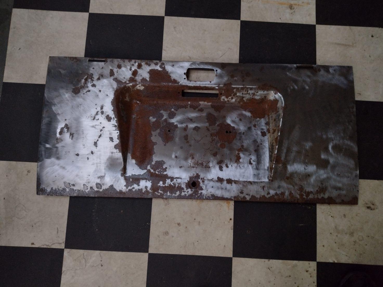

I've managed something but haven't posted it yet. I found an engine lid in the summer. I was missing it.
I removed the blue paint and repaired a piece for the bracket.
I welded in the holder for the engine lid in the engine compartment.
I had to adjust the bottom left corner again. A bit of welding and it warps a little. Since I didn't have an engine lid, I didn't notice it

Ring-Free wrote:
Thank you.

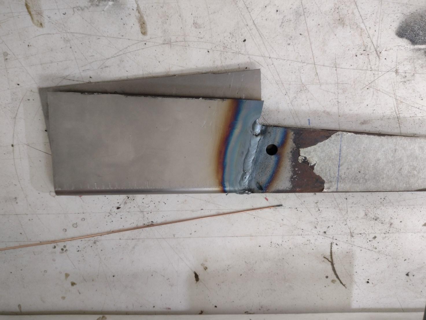

I assume you turned these on a lathe and weld them to your original arms.
Did you heat treat them? Curious why the one is purple/blue.

Ring-Free
Joined: April 22, 2023
Posts: 159
Location: Belgium / Germany
Ring-Free is offline
PostPosted: Thu Jan 23, 2025 10:35 am    Post subject: Re: "Ring frei" for Ring-Free 1957 Reply with quote
Yes, I have hardened the lower part. I don't know if it does any good, but it can't do any harm either. The edge was also not yet rounded

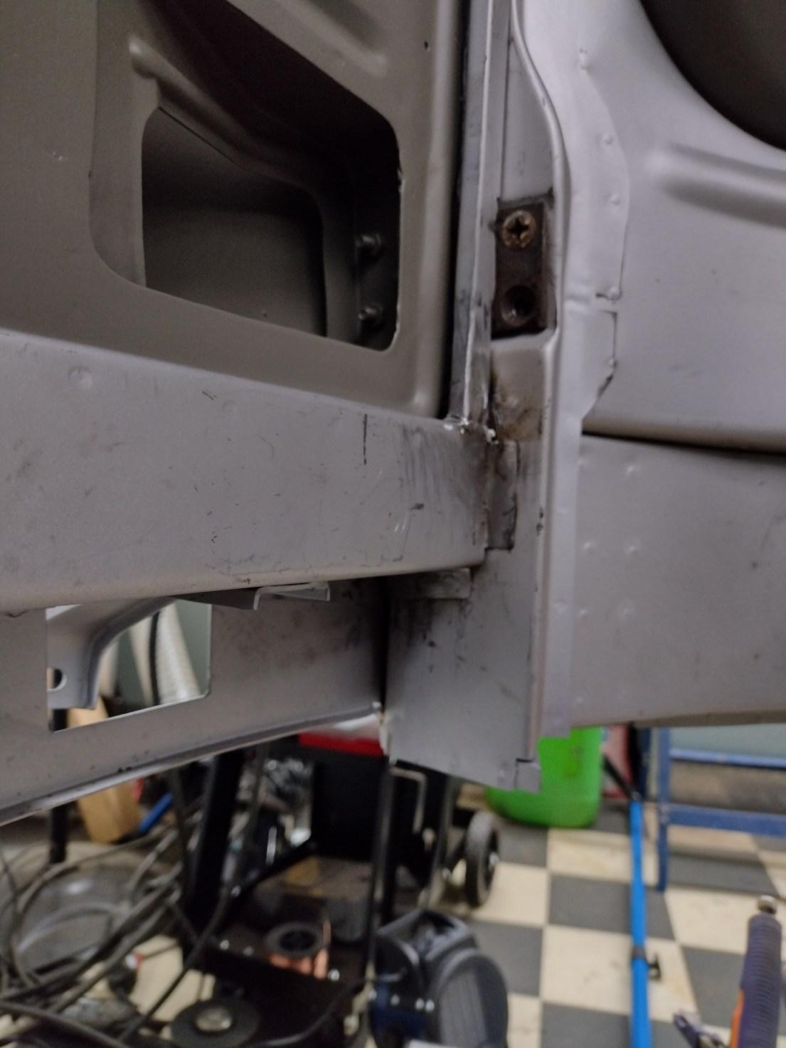

PostPosted: Sun Feb 16, 2025 3:32 am    Post subject: Re: "Ring frei" for Ring-Free 1957 PGSG Reply with quote
I welded in the first dogleg. It took quite a beating. It's too round. d'oh! But it now fits the character of the bus.
There was a missing material on the inside and the sealing bed was too short, so I put in a few patches.
The passenger side still needs more beating Twisted Evil

PostPosted: Sun Mar 02, 2025 11:01 am    Post subject: Re: "Ring frei" for Ring-Free 1957 Reply with quote

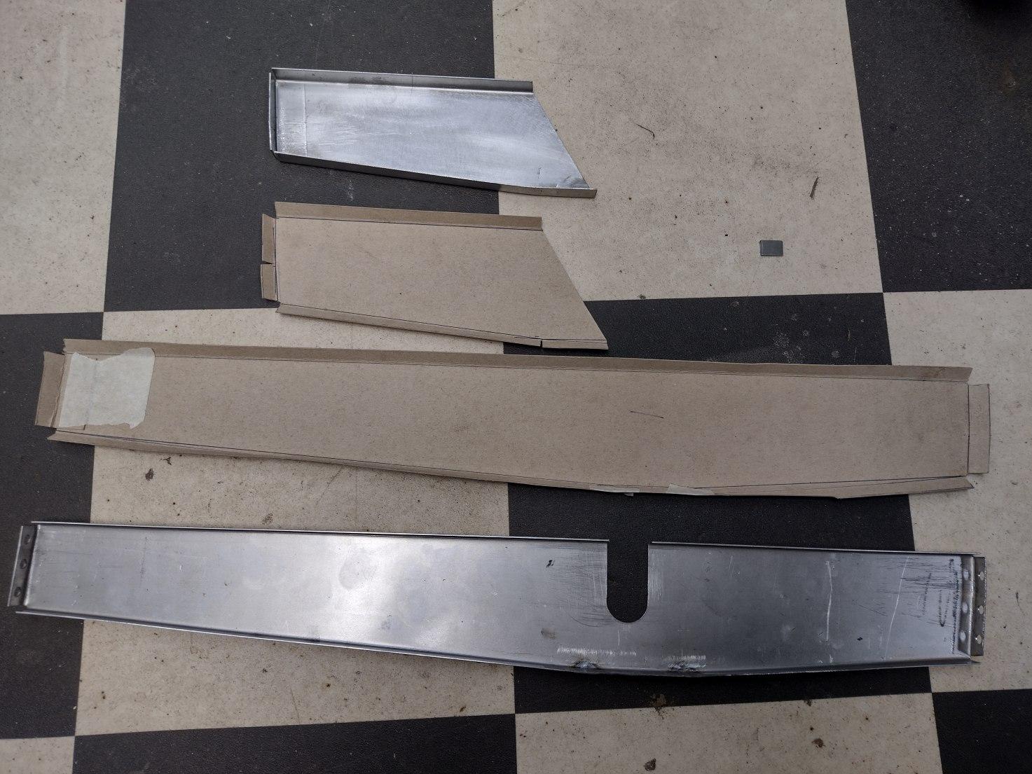

Next I made 2 plates that still belong to the front frame. The deflection for the gas cable will come later. Now the holder for the handbrake has to be fitted and the heating pipes can go back in place
Can anyone confirm that the bracket is welded from above at the marked points?
