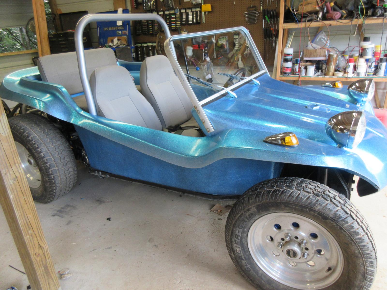

I finally mustered up and went downtown to get my tag and insurance. Took it out for a short ride. I still need to replace my rear tires but it was a nice ride. Any recommendations which ones in 275/60/15?

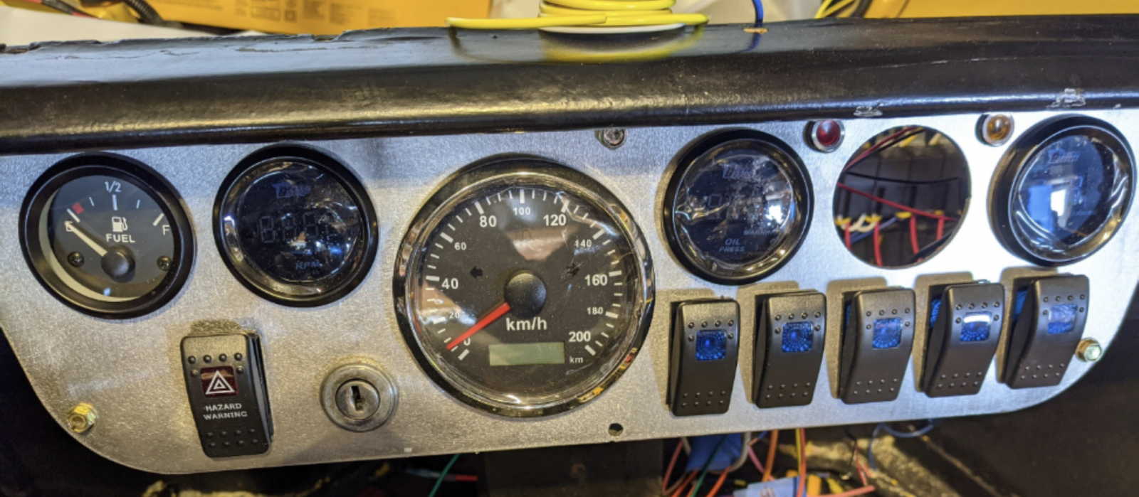

Got my dash plate cut from stainless on a plasma cnc, missing a gauge but it should be soon. Installed it, now the fun of wiring everything up.

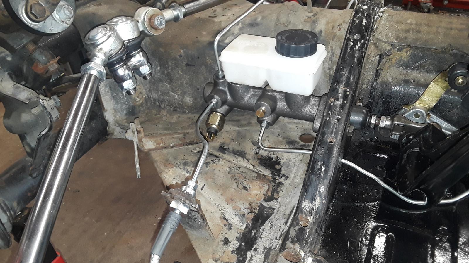

Received front end/steering/suspension/brakes parts. It's about to get serious.

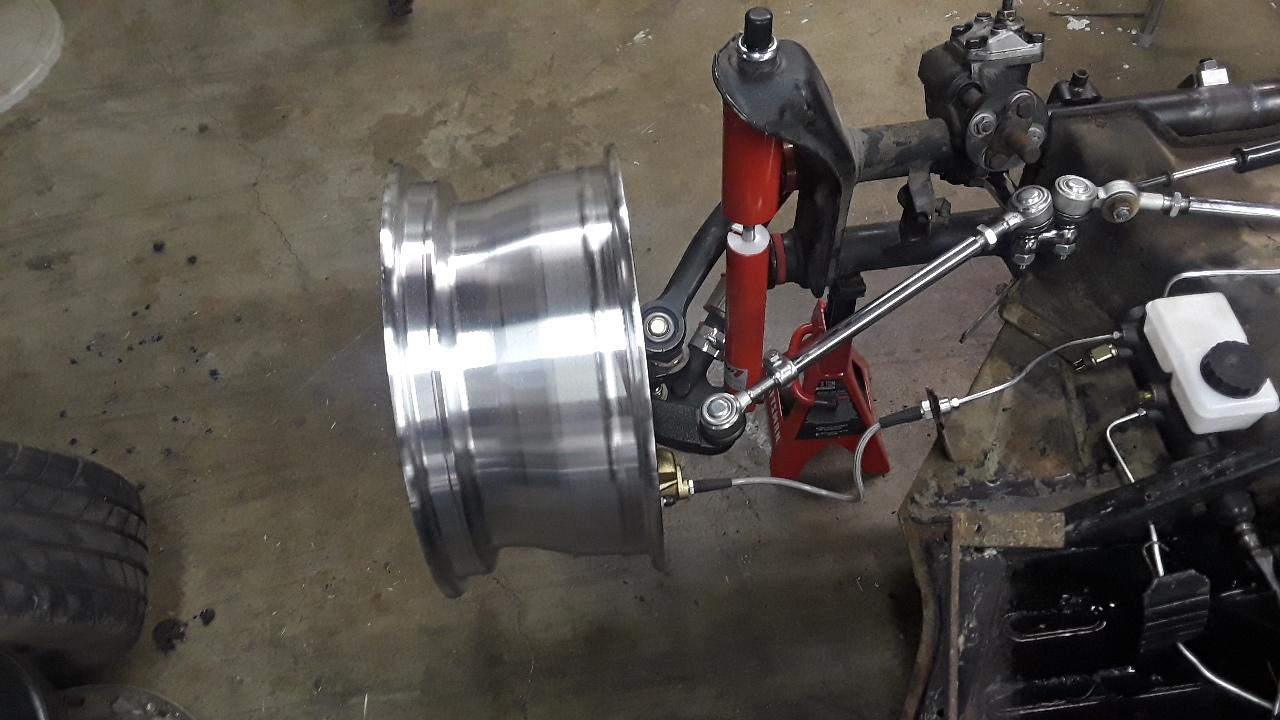

Front beam has been rebuilt with new leaf springs & seals, 2.5" drop spindles, new ball joints top & bottom, new tie rods with tie rod ends, new pitman arm and beam adjusters, new drilled & slotted rotors, bearings etc and new calipers. Also removed the transaxle for delivery to the local trans shop.

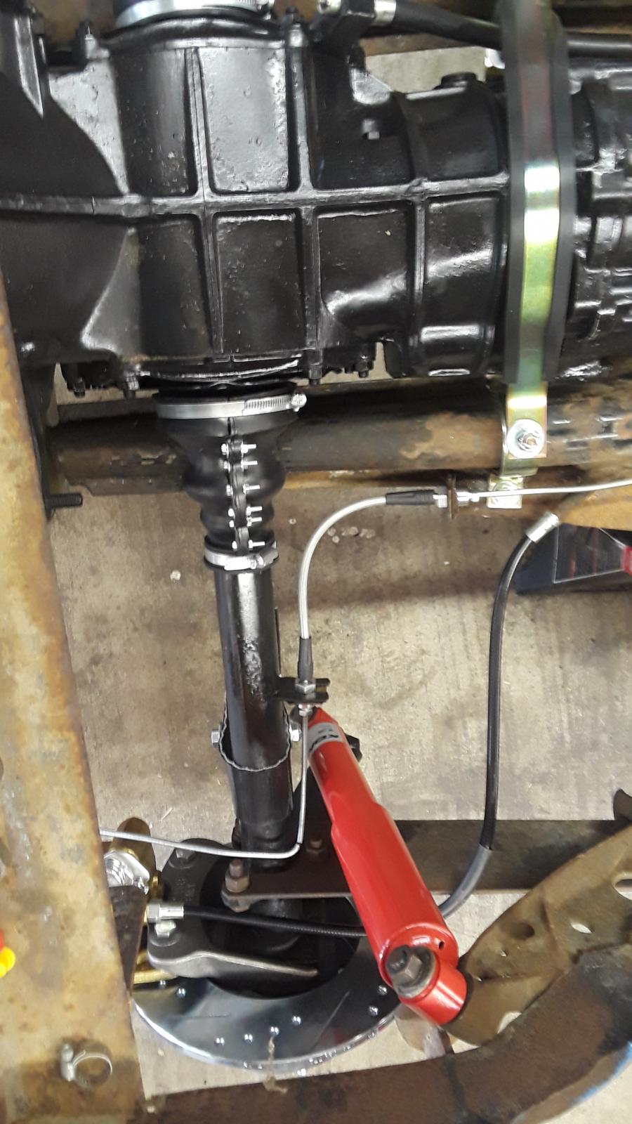

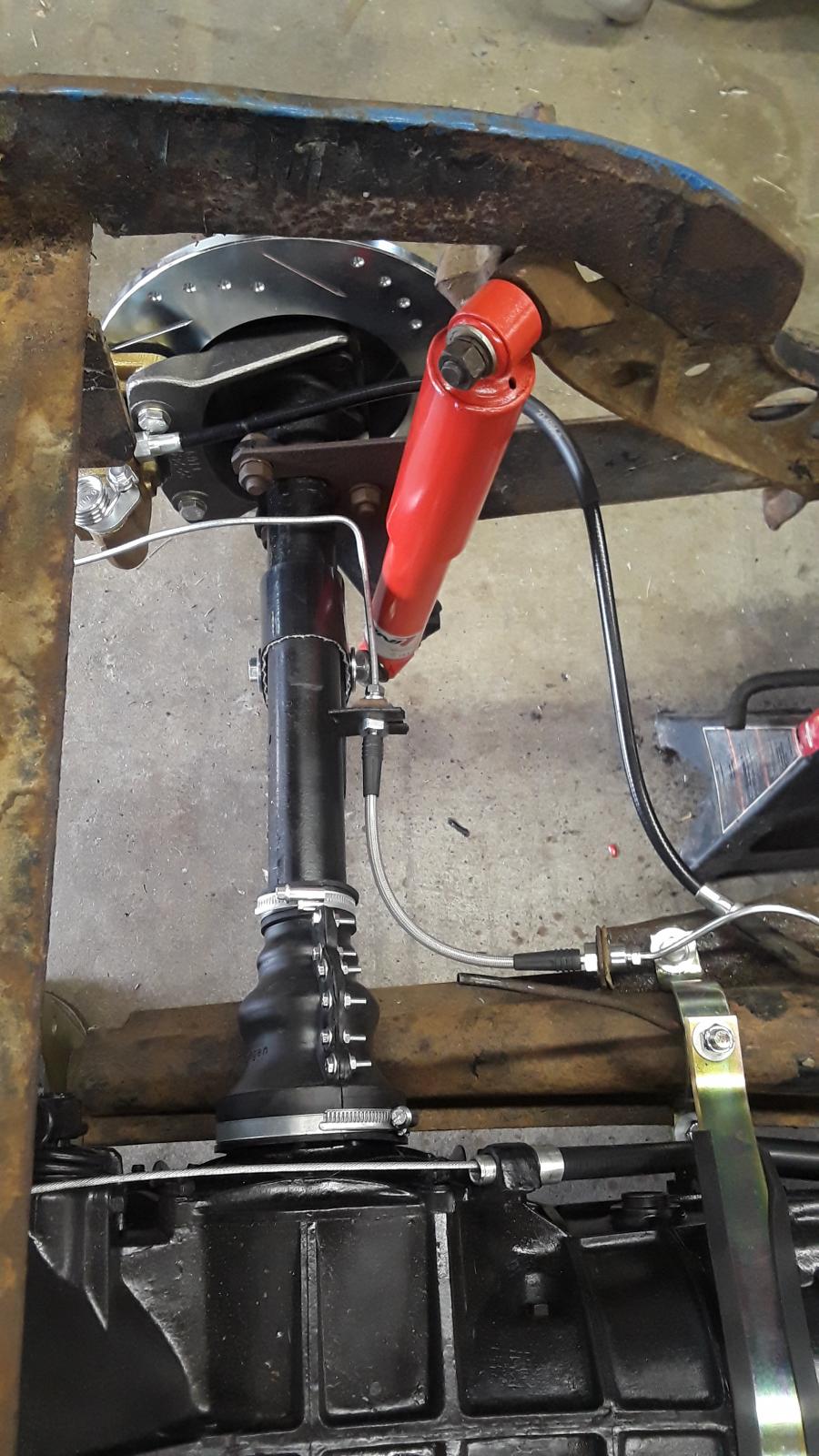

slayer61
Joined: June 01, 2021
Posts: 1248
Location: TX
slayer61 is offline
PostPosted: Mon Aug 23, 2021 11:31 am    Post subject: Re: What did you do yesterday on your buggy? Reply with quote
Front end done and awaiting tires
Rear end is done and awaiting tires
Brakes are done, but I'm not sure I won't take them apart for something else, so no fluid yet.

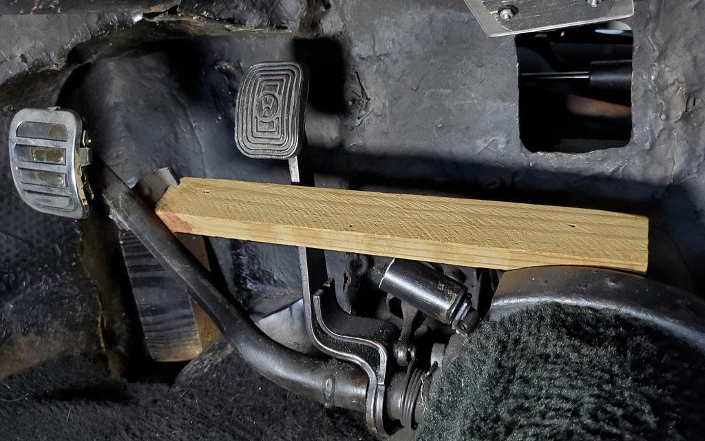

I blew out my original German brake light switch, and replaced it with a motorcycle part.
As another Samba member said, "You're never too old to learn something the hard way." Do NOT connect brake lights wire to one terminal of brake light switch while +12 volts is connected to the other terminal when there's pressure in master cylinder. (I had the pedal prop'd.)
First thought for a fix was to go with the slick pedal switch kit by Gearhead Keith. But it won't work for my buggy, 'cuz its location is where my foot needs to be in order to use accelerator pedal.
https://www.thesamba.com/vw/classifieds/detail.php?id=2140061
Searching Samba, I found this thread by @toxicavenger with a post by @sjbartnik that gave me the Harley switch idea.
https://www.thesamba.com/vw/forum/viewtopic.php?p=9319372
Now that I have a more sensitive (i.e. quicker) brake light switch, I'ma make it even quicker by replacing incandescent bulbs with LEDs. I already have an LED, but currently only in my high center 3rd brake light which is shown here:
https://www.thesamba.com/vw/forum/viewtopic.php?p=9448122
MrGoodtunes
Joined: May 14, 2012
Posts: 1042
Location: South Florida
MrGoodtunes is offline
PostPosted: Wed Oct 20, 2021 6:44 pm    Post subject: Re: What did you do yesterday on your buggy? Reply with quote
Searching Samba, I found this thread by @toxicavenger70 with a post by @sjbartnik that gave me the Harley switch idea.
Now that I have a more sensitive (i.e. quicker) brake light switch, I'ma make it even quicker by replacing incandescent bulbs with LEDs. I already have an LED, but currently only in my high center 3rd brake light, shown here:

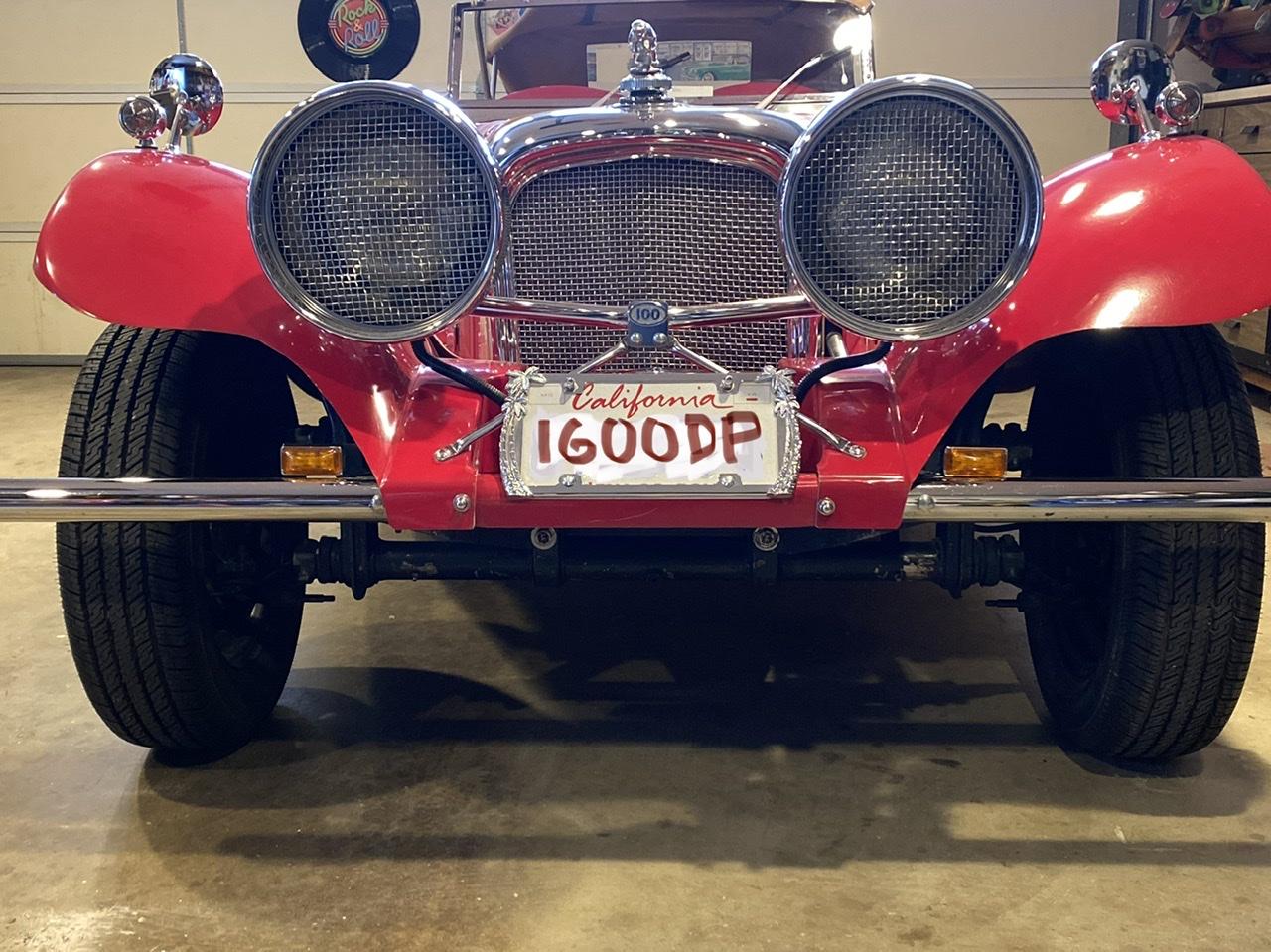

So here’s what I did yesterday. I put on the new front plate with a glitzy chrome frame and acorn nuts.
I trimmed off the ugly mismatched fender tips on the front of my car with a cut off wheel and then sanded them smooth with a long board-sander, so everything looks straight now.
Before the trim, I marked the ugliness with blue tape and a sharpie.
After, it’ so much straighter!
I also broke out a little brush & did touchup painting where the fiberglass was chipped here and there. I was very lucky that I didn’t make a bunch of new chips in the gelcoat as I was trimming the fiberglass, but it was not all luck. I went at it very carefully.
