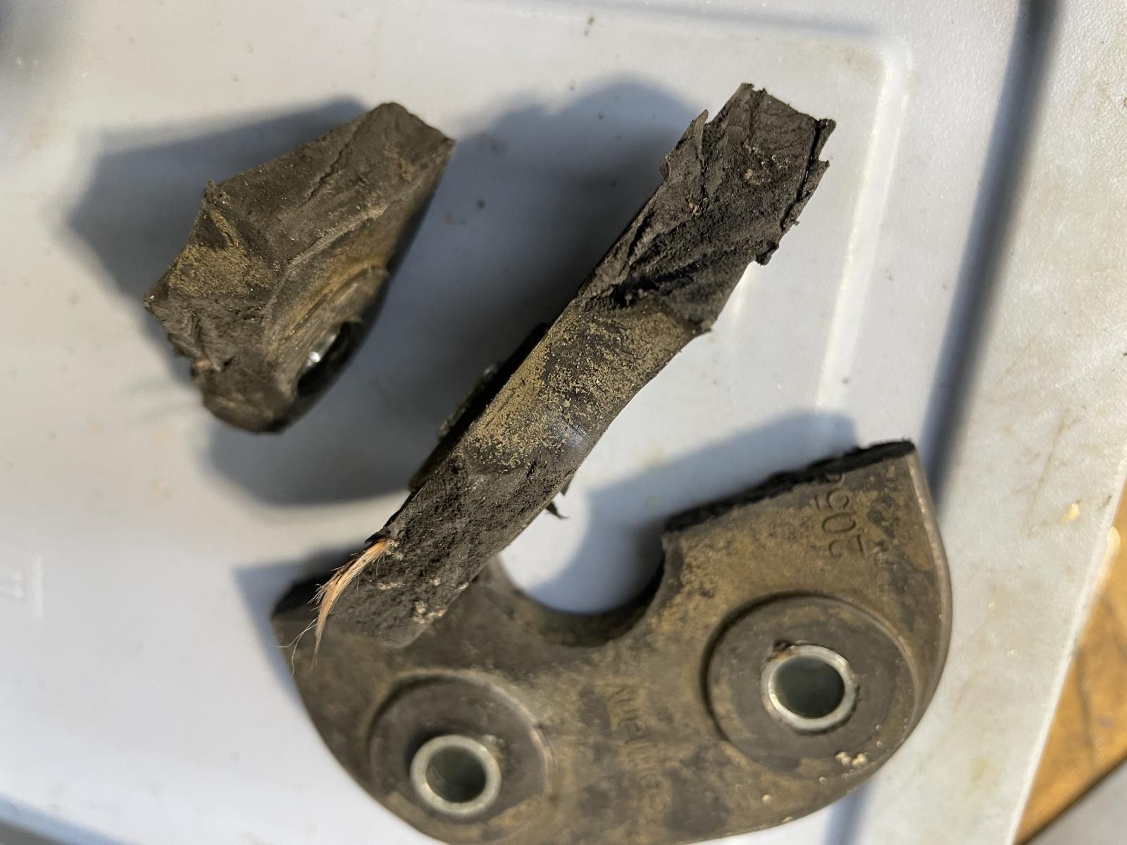

I would have to sacrifice a coupler from CIP1 and cut it open myself to see if there is sufficient cord in the joint before I would be willing to try one. Too much of what little I have ever bought from them included what they claimed was a high quality steering coupler has been junk.

PostPosted: Tue Feb 18, 2025 7:43 pm    Post subject: Re: Steering Coupling Disc 211415417 (coupler) Reply with quote
I used a cheap meter for this, I have a nicer one that is auto-ranging but this one allowed selecting the range so the numbers make more sense without having to read the little letters after the number. On this meter “1“ is infinity.
VEWIB: ~650ohm (others will know better, but I think it's OK in a 12v circuit?)
VEWIB - Note scale on meter is now 200 Ohm
The rest of the “good“ ones are infinity Ohm.
Original
OEM Germany (SGF Brand - was available from VW until ~10 years ago)
Kafer Brand is bad, almost 0 Ohm
SL
