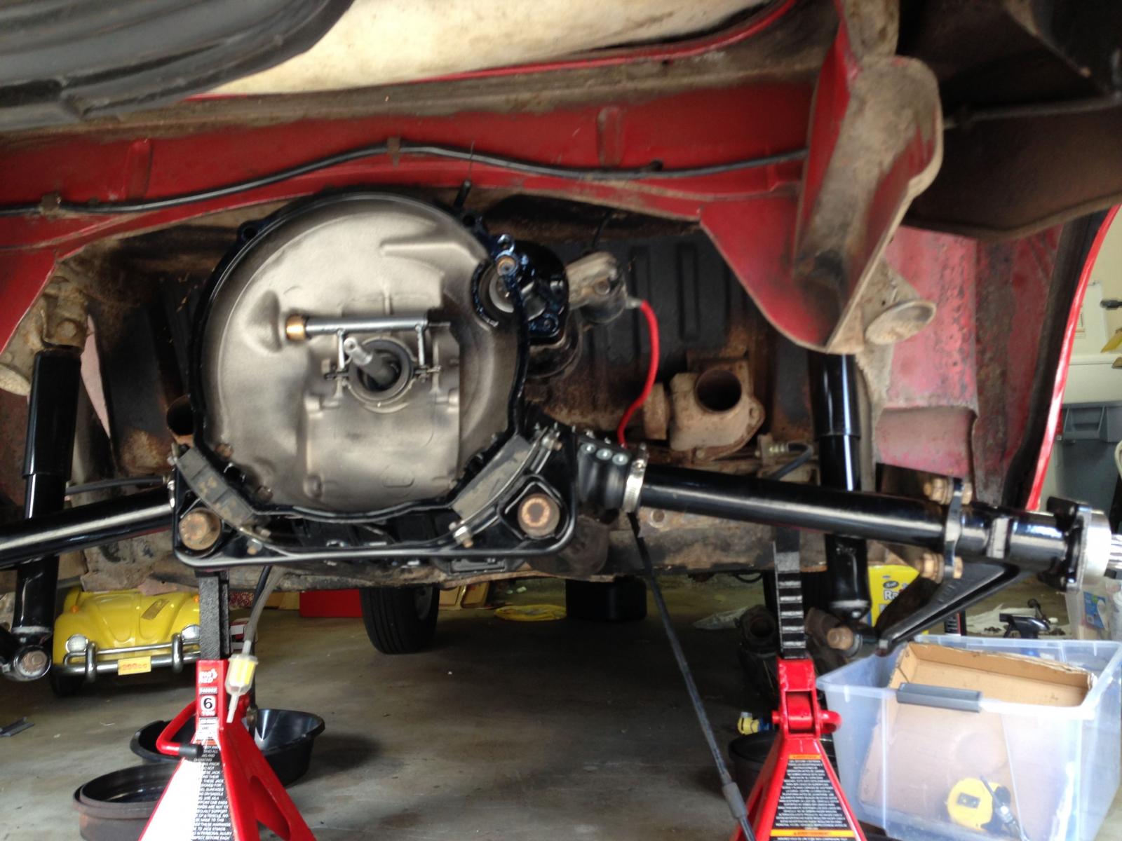

So as an update... The engine on this car started a pretty bad rod knocking sound. It was spewing out a huge cloud of blueish smoke on startup (oil). So to do the car right, I had Brother's Machine Shop build me a brand new 1600cc single port motor, in a new case. I paid a little extra to have it balanced with the new clutch. Half the tin was powdercoated and the other half wasn't so I did a powder coat run to finish off the other half of the tin.
Since I was doing the engine, the tranny had always been kinda bad in the car. It would pop out of first if I accelerated too hard. I had Rancho build me a new one.
And new rear brakes. (not pinwheel, 64+)

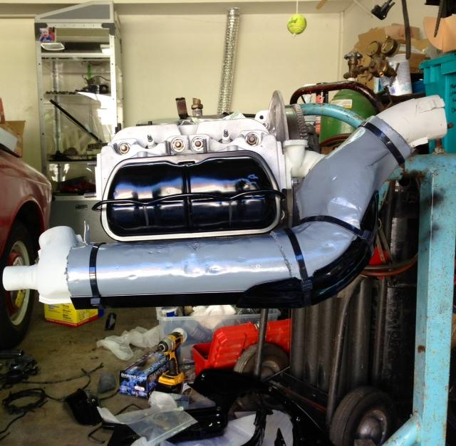

Also, I took the exhaust with the correct heater boxes down to the ceramic coater. Tom mentioned a page back that he was going to do that but got impatient. But since I didn't make the classic and I've got the tranny to put back together etc, I decided to have it done.
There has been some controversy over the early heater boxes... Apparently, really early ones had no wraps? I talked to Alex at ISP West and he said they all had wraps, always. I talked to my buddy Joe (M113) and he says the early ones don't have wraps. I started digging and found that mid 63' they started wrapping the heater boxes. But my car is technically mid 63... It's late may of 63. So, now I don't know if this car came with wraps or not. Does anyone know the crossover VIN? Or does anyone have a way to find out?
- Chris

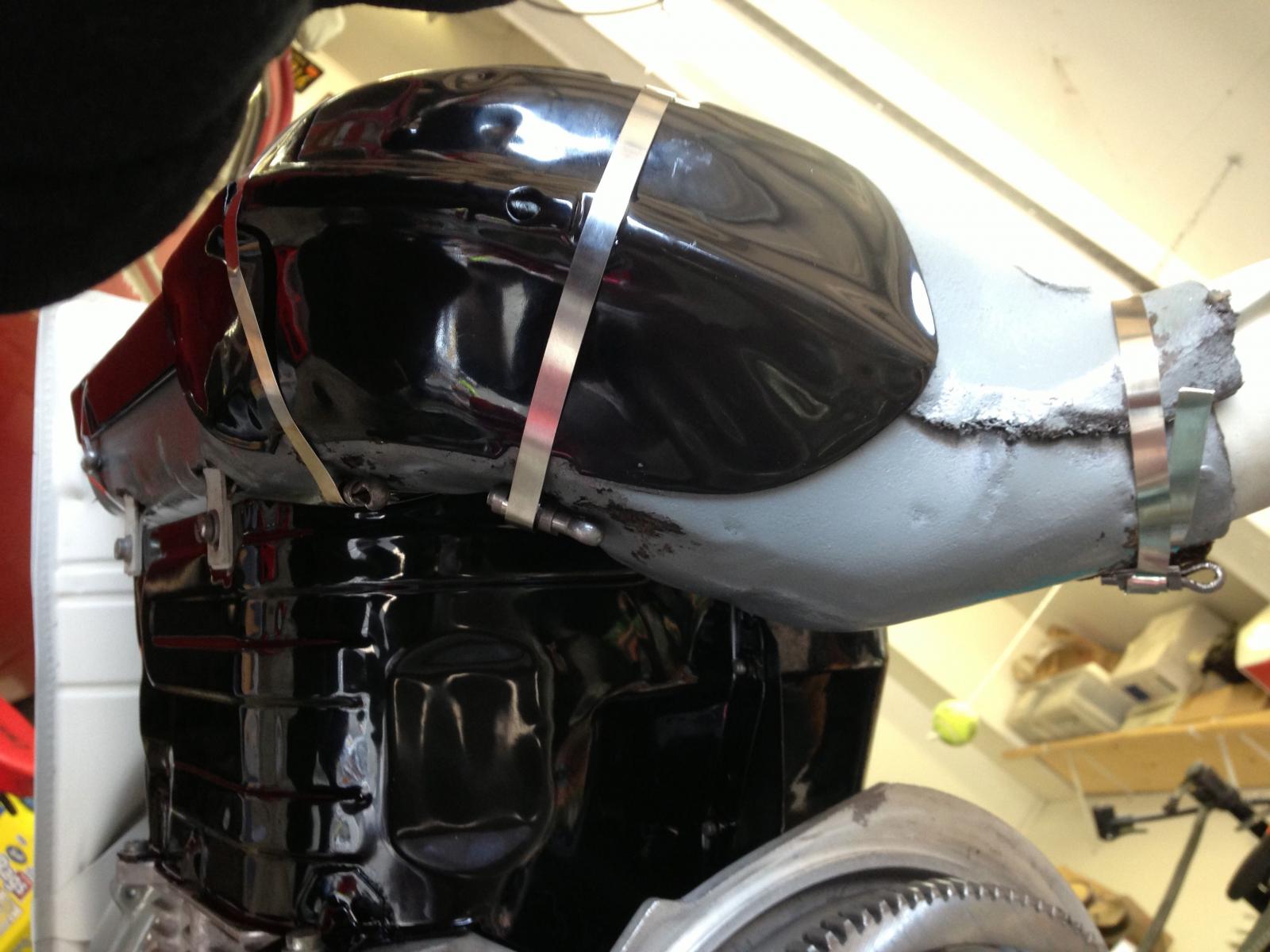

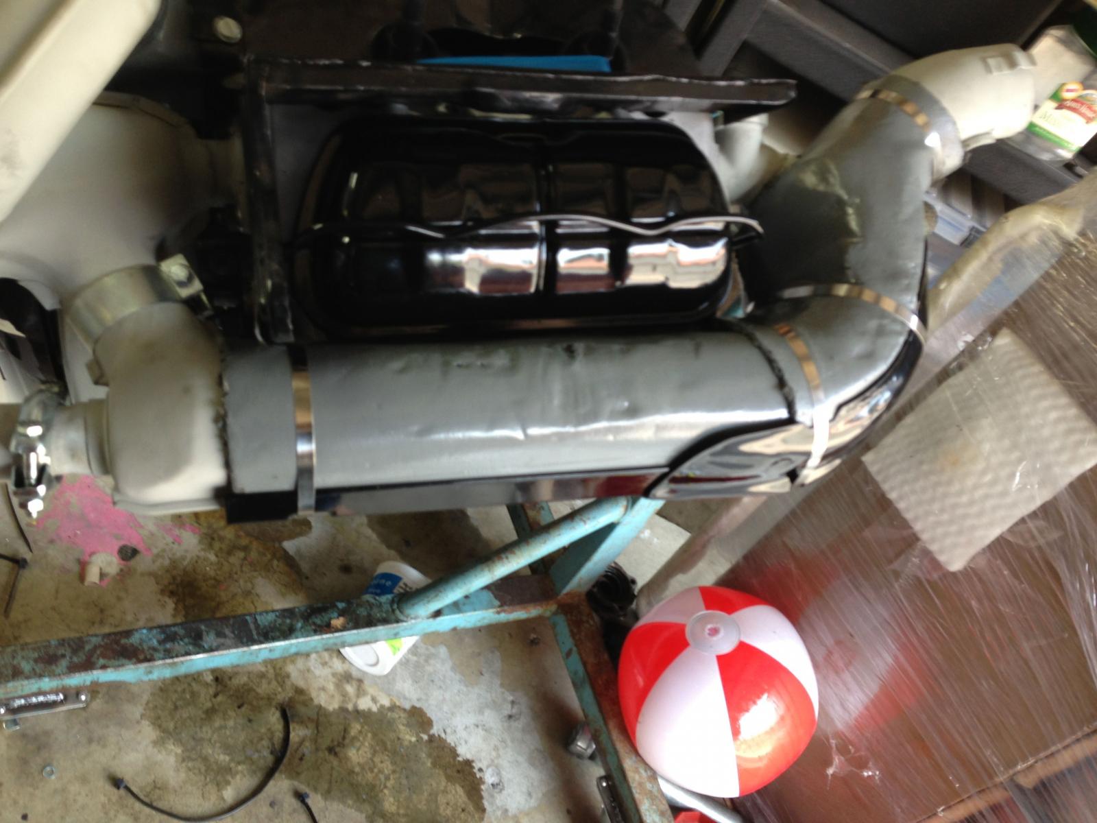

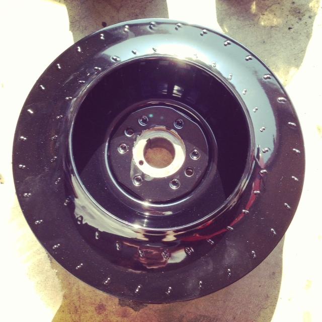

Had the fan powder coated.
And I did the heater wraps... man that took a long time. I zip tied them for the moment:
But I bought some steel bands and am going through and putting these on as the originals:
Getting there slowly...

PostPosted: Fri Jul 12, 2013 10:58 pm    Post subject: Reply with quote
Those wraps and trans came out really nice. Truly is coming out nicely. Look forward to the next installment.

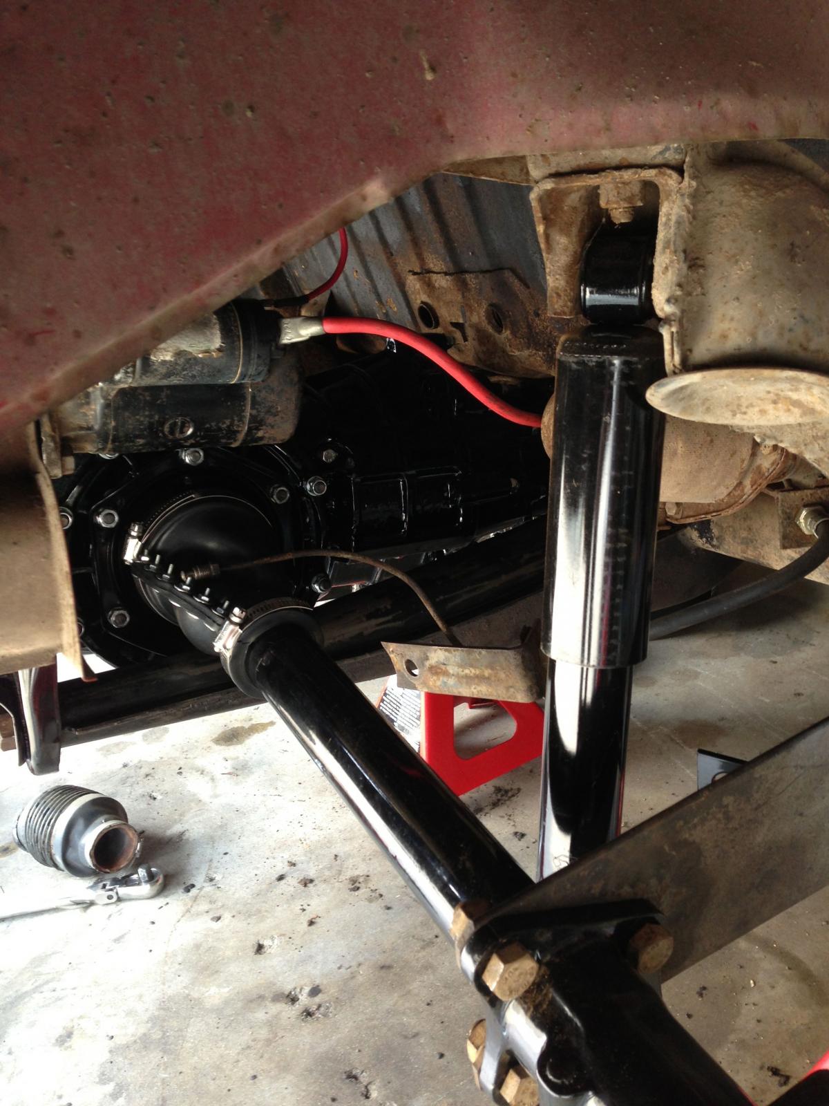

More Awesome... I got the tranny installed today. This was the first time I had every done the axles myself. The first time I did it, I didn't get the axle into the fulcrum plate correctly and it was off... Then the second time I put the tubes on the wrong sides, and the third time I nailed it!
Also got me some new shocks

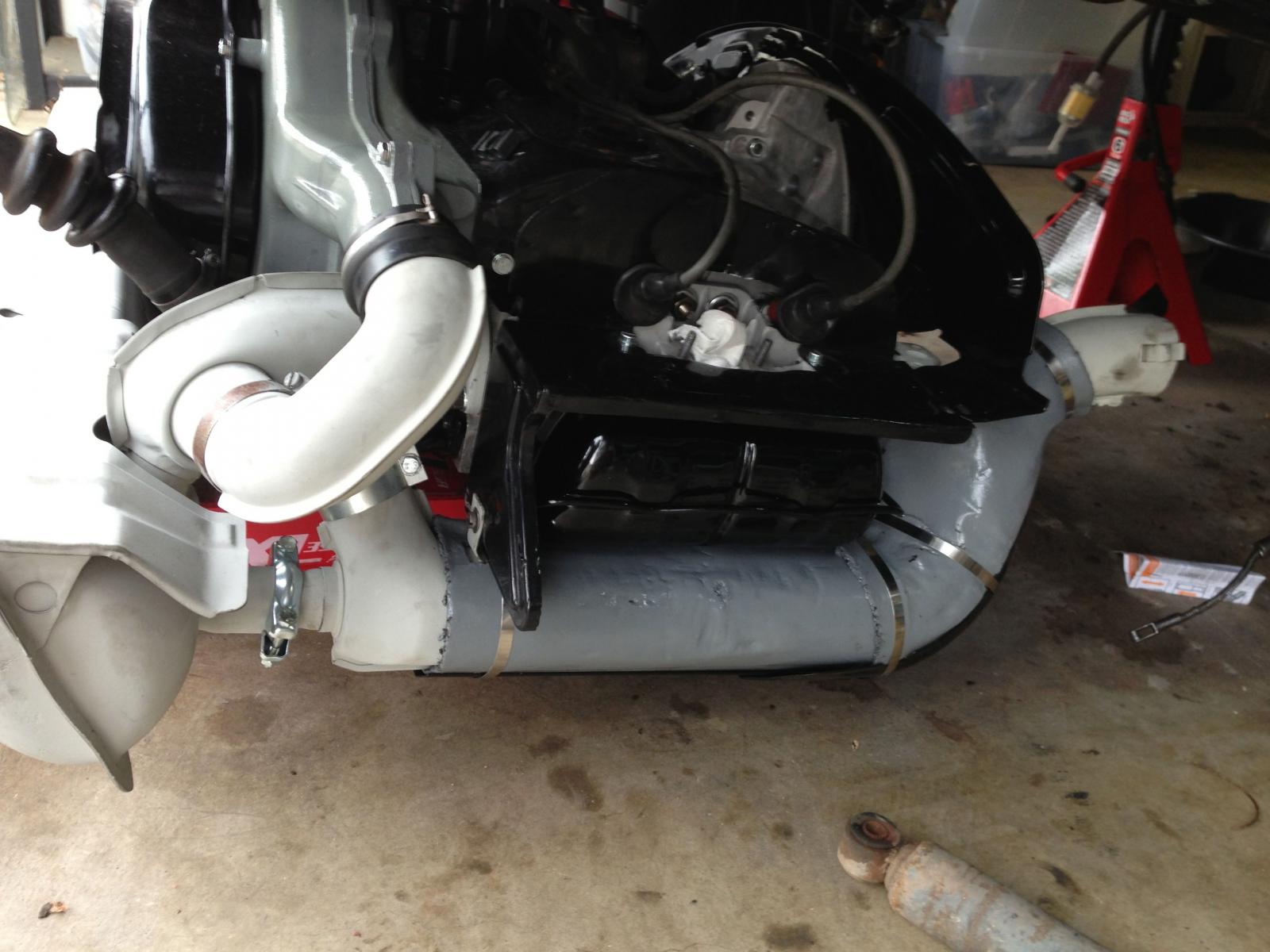

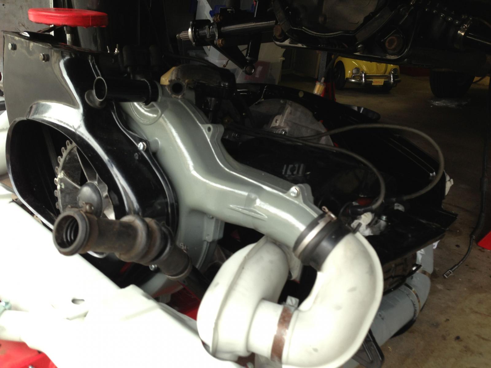

Finished putting my heater box stainless steel tie bands with the original cotter pin roller clamps back on
I think the engine is looking pretty good Smile

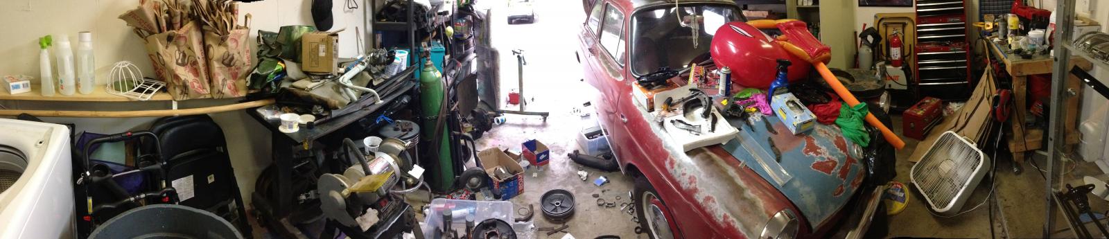

My Garage on the other hand!
