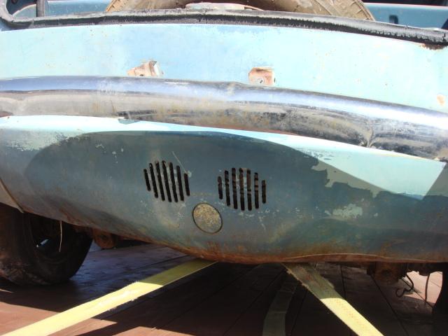

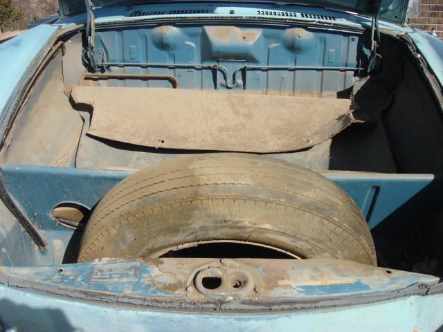

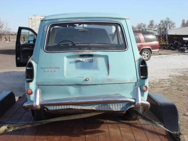

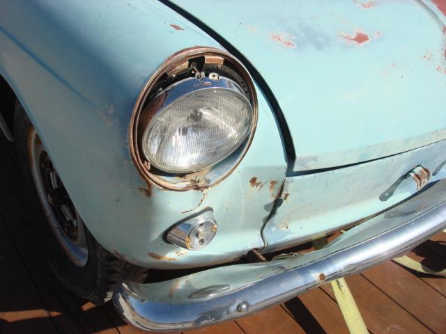

For the past few weeks I had been contemplating getting this square. I had pulled some parts off of it and sold them without realizing that at some point I was going pick this car up. My initial intent was to part this car out but after reading other threads and looking over pics or other members starting point, I re-thought the parting out part adn more on saving the car. Today I made a trip to get a some parts and with trailer in tow, pick up the square at the same time. Last time I was out, I failed to get the VIN number off this car. This time, my first stop was to get the VIN and try to determine the age of this car. I knew Squares weren't made until 1963 but the VIN number stumped me as I had to call my friend for help. I checked the body VIN against the pan, 0187041. I didn't see any number on the engine case but it's dirty. It's got dual port heads on it and as it was pointed out if this is an early square, it would have had a side single draft carb (I think that's what it's called) setup. Maybe the PO changed the heads out? Not sure but will be looking for the VIN in the AM.
The car has been repainted as the original color seems to be sea Blue. Not usre about the red though, maybe factory primer? The underside of the hood is the same color as the other areas inside the car. I'll take the shop vac to it as well as put the pieces I took off of it back on. I feel bad I sold off a few pieces but that's ok, lesson learned. I'm not ready to deal with this square just yet as I'm working on the 67 so It's going into storage. I'll post more pics but with the ones I have here, A few for now...
I'd appreciate any info you can pass along regarding the age, etc.

VIN indicates a very early May, 1963 build date. This would have been a single side draft 1500 car. The dual carb cars didn't start until 1964, and Type 3s got a bigger engine compartment to accommodate the twin carb engine, so don't be surprised to find some hackery in there.
Dual port didn't start till 1967, so it's likely got a later engine.
No Sea Blue until 1964 model year, so it was likely a Gulf Blue car. Interior would have been salt 'n' pepper.
No beak trim, no beltline trim, high mounted side markers, bullet turn sigs and reflectors painted body color are all pre '64 attributes. taillight lenses should be the flat ones. Post 1963 "S" and "Deluxe" cars got the common ones you always see.
The '1500' on the hatch indicates North American delivery, as they weren't allowed to call them 'Variant' because of the Plymouth Valiant in North America. It was likely delivered in Canada, which tells me the original taillight lenses were flat, all red.
Wheels look correct! Beginning in '64, they were "smoothies" until 4 lug with front disc in '66.

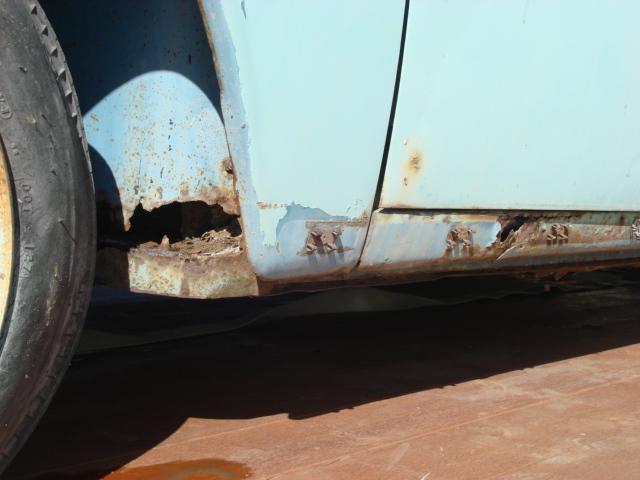

It's pretty much covered above so:
Yes, it's a '63.
Yes, Gulf Blue.
Yes, it should have a single side-draft motor.
The engine # should be in the top center of the engine.
1962 but any 62-63 is uncommon.
I'm interested in interior photos please.
Post a photo of the engine too, we can provide some engine feedback.
It looks pretty good, how are the floorpans?

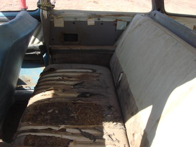

Here are some interior pics. Not much to see.

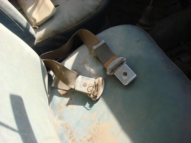

These seat belts look incomplete. There's the inside tunnel piece and a piece that's bolted to the lower pillar (sp?)

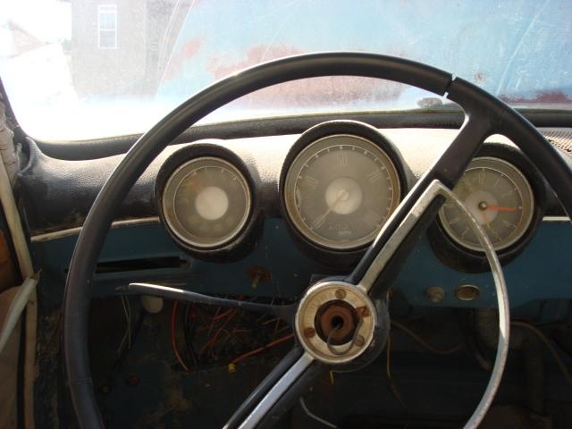

My guess is these gauges may not be original, or at least one. Any thoughts or insight? Not sure about the toggle and push button. I guess since it didn't have the ignition, maybe power and push-button start?

Rear seat material is the original.
Euro cars got a two point shoulder belt with no lap belt, and I think those were acceptable in Canada also. USA mandated lap belts only until 1968- then 3 point shoulder/lap belts with high back seats.
