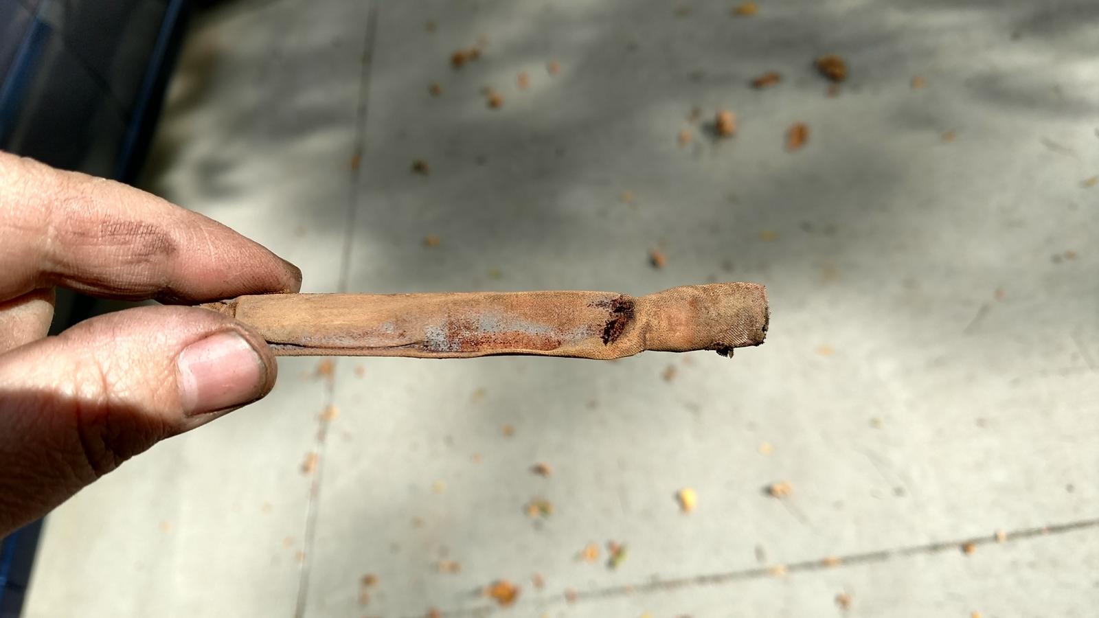

Thought I would share some nightmarish shots of how my tank cleaning is going:
The collapsed and suction-melded to the input tube brass sock/screen:
The chunky layer of rust that happened on some previously unknown tank sealing. Assuming that either the rust wasn't first removed, or the sealant started to separate and rust set in behind it:

That tank actually cleaned up fairly well, considering. Took some 5 hours of work to get all the loose old coating out of it, but the acid cleaned the rust out nicely. I put in a new screen, gasket, and did some fun hose routing (that is for another post regarding fuel pumps) Now the gas flows clean and freely, no more cavitation, Happy car. Smile
