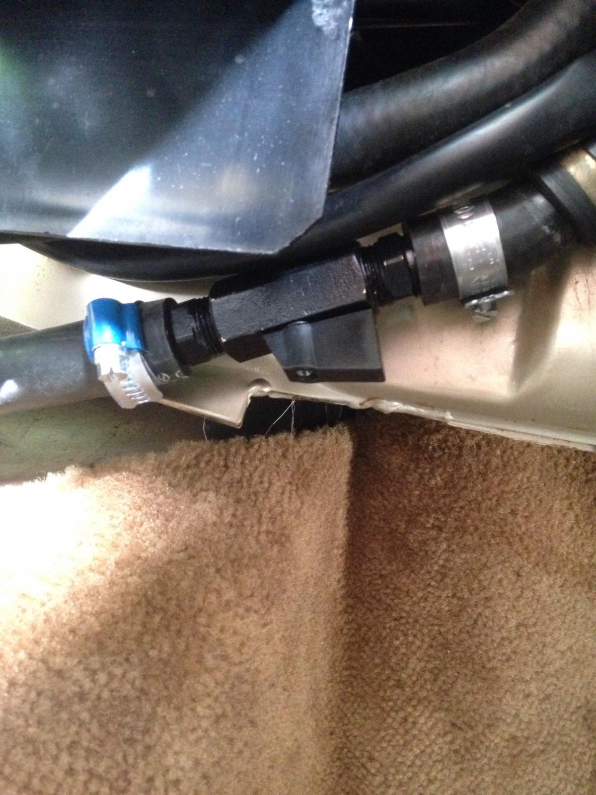

PostPosted: Sat Jun 13, 2015 12:36 pm    Post subject: Reply with quote
TK's valve is great!
Just installed one.
With center dash cover removed......
With cover installed, easy to access....
I also upgraded to the Ford cable control valve as well so I can dead nuts turn off the heater core!
