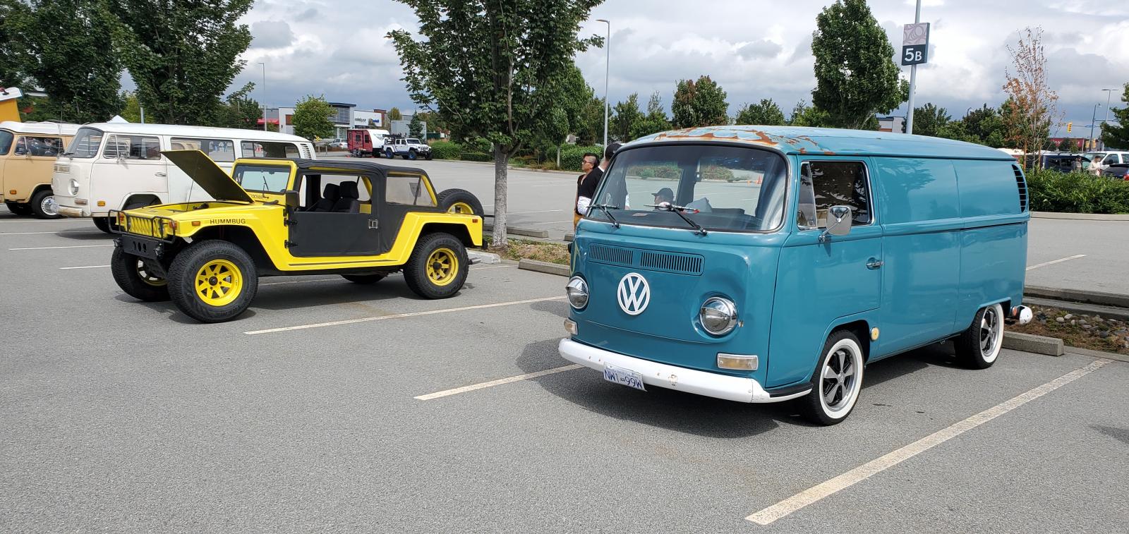

PostPosted: Thu Nov 13, 2025 7:50 pm    Post subject: Re: Buggeee's Boogie Bus 1971 Panel Reply with quote
Excellent!
Panels are out there.
Previous 1973 Panel Bus:
Click to view image

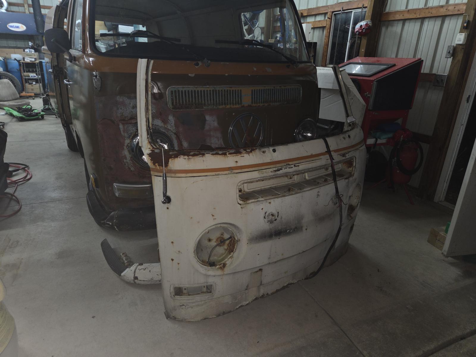

PostPosted: Thu Nov 13, 2025 8:06 pm    Post subject: Re: Buggeee's Boogie Bus 1971 Panel Reply with quote
The next weekend I drove 4 hours to grab this front clip with a-pillars for 200 bucks, also scored some floor material and a spare tire cover, and grabbed a clean straight front bumper from a buddy on the way home.

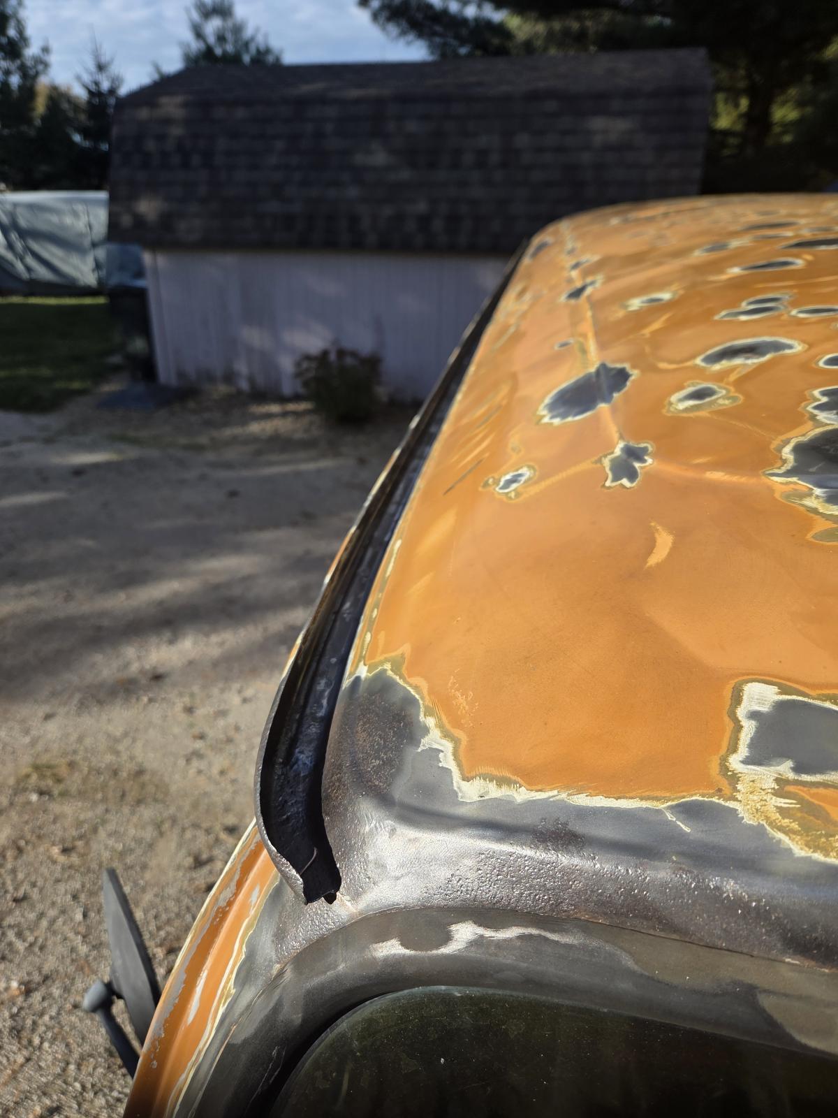

PostPosted: Thu Nov 13, 2025 8:18 pm    Post subject: Re: Buggeee's Boogie Bus 1971 Panel Reply with quote
To strip the roof I tried the Citrus, and it worked well. It was in the 50s, so cold for the chemical process. I covered the stripper with plastic, reapplied the next day, then three days later pulled off the plastic and it was ready for the putty knife, a bath with Dawn dish soap, and a soaking in phosphoric metal prep.

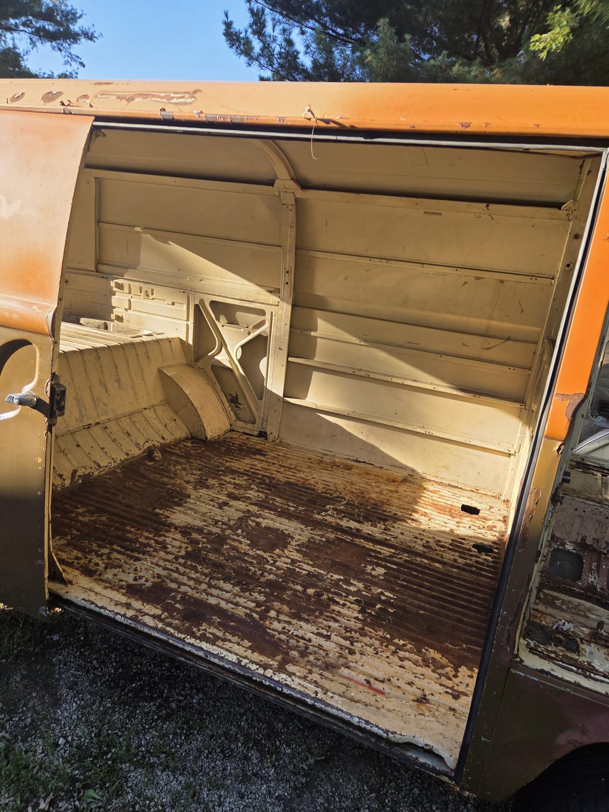

PostPosted: Thu Nov 13, 2025 8:24 pm    Post subject: Re: Buggeee's Boogie Bus 1971 Panel Reply with quote
The floor is super solid, but patina badly as can be seen here. I debrided with the wire cup and treated it with the Xion Labs converter primer, which I have been in love with ever since the Krankenwagen build.

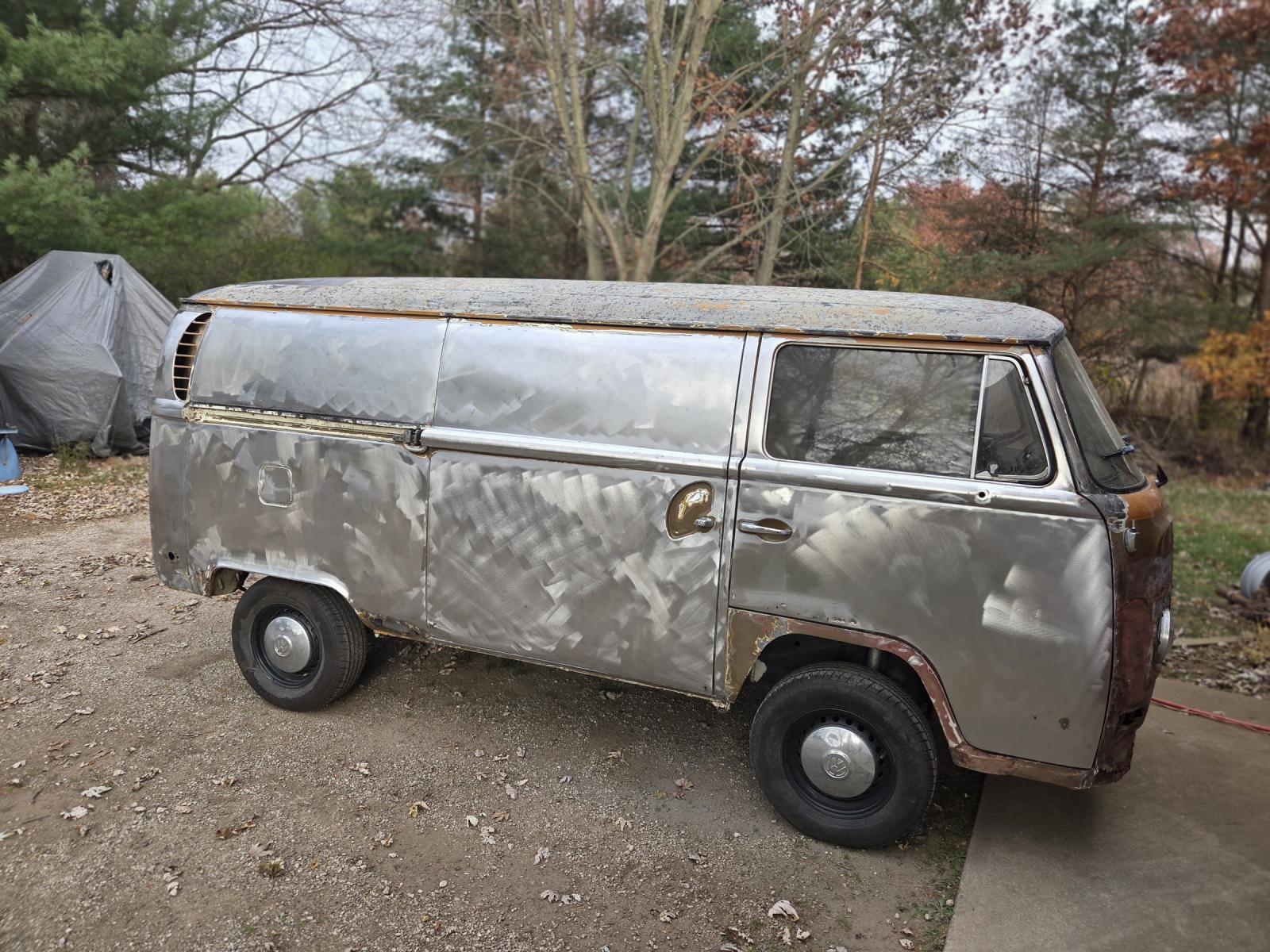

PostPosted: Sat Nov 15, 2025 4:49 pm    Post subject: Re: Buggeee's Boogie Bus 1971 Panel Reply with quote
I saw this tool at Harbor Freight. Two pads and ten hours later... She's Naked!

PostPosted: Thu Nov 20, 2025 9:49 pm    Post subject: Re: Buggeee's Boogie Bus 1971 Panel Reply with quote
Wow, that did a spectacular job of striping off the paint.

PostPosted: Sun Nov 23, 2025 5:31 pm    Post subject: Re: Buggeee's Boogie Bus 1971 Panel Reply with quote
That HF strip tool looks to be damn handy.

PostPosted: Mon Nov 24, 2025 1:48 pm    Post subject: Re: Buggeee's Boogie Bus 1971 Panel Reply with quote
Ya, it really is the cat's meow. and it leaves a nice finish ready for the primer to bite. It's not smooth like the wire cup leaves it, but its not tore up like a grinder does. It's called a metal conditioning tool, and that's what it does. It plows through filler just as easily as a few coats of paint, creating a real dust storm as it leaves clean metal in its wake. The consumable disc I am using is labeled 40 grit, and it tears through the coatings like a 40 grit, but it leaves a finish on the metal like an 80 grit. And, best of all, its a one step process, whereas the chemical striper needs all the secondary clean up. I consumed two discs at $40 each, so $80 to strip the bus. I had spent $50 on the citrus just to do the roof panel with chemical, so its a better deal too.

PostPosted: Mon Nov 24, 2025 1:50 pm    Post subject: Re: Buggeee's Boogie Bus 1971 Panel Reply with quote
I did not strip the nose or the passenger dog leg because I'm replacing those altogether.

PostPosted: Tue Nov 25, 2025 11:33 am    Post subject: Re: Buggeee's Boogie Bus 1971 Panel Reply with quote
Awesome, yeah that's pretty quick for stripping a bus that well. I just bought an eastwood sct for other work I'm doing. I look forward to trying it on body work. Did you check to see if you were creating much heat?

PostPosted: Wed Nov 26, 2025 8:43 am    Post subject: Re: Buggeee's Boogie Bus 1971 Panel Reply with quote
My hands were gloved but I did check a couple times and heat did not seem to be an issue at all. At times, pressing it would push the flat metal in as I went along and it would pop back out behind as I passed through, and it seemed that was due to my pressing on a large flat sheet area rather than heat. Afterwards, everything is as flat as when I started. I feel like removing the old coatings with the wire cup on the angle grinder makes it warmer than this did. I really did not monitor that issue closely though.
