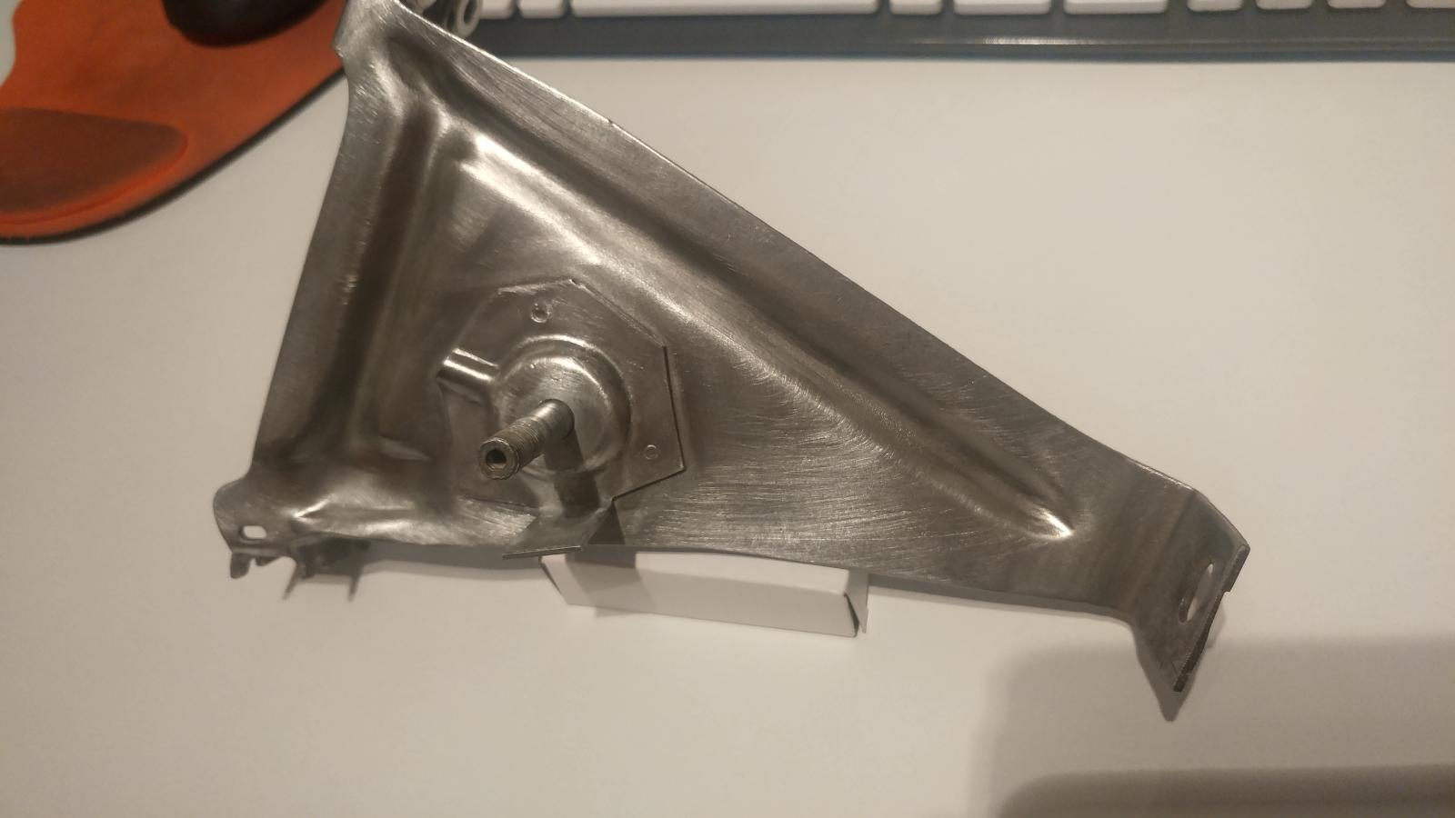

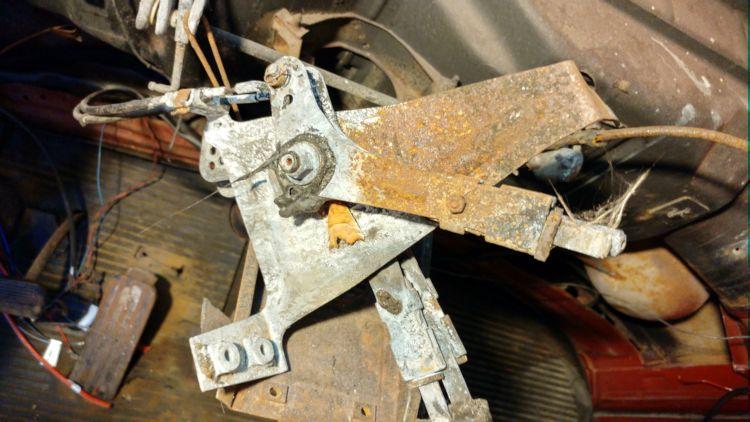

I'm looking for some advice regarding the cleaning of metal work. Take for example the heating mechanism, see my before and after photos:
I used a wire brush drill bit to clean it up but has this process removed any protective coating making it more susceptible to rusting in the future? Or is is it fine to be re-assembled and put into the bus. There are some rust prevention treastments but it seems a shame to cover up the shiny metal work.
Any thoughts?
TY.
Bob.

PostPosted: Tue Feb 21, 2017 12:16 pm    Post subject: Re: Cleaning Oxidized Metal Work Reply with quote
Bob,
I don't have an answer to your question but the After product looks fantastic, and I agree that covering something so perdy would be a shame.

PostPosted: Tue Feb 21, 2017 12:28 pm    Post subject: Re: Cleaning Oxidized Metal Work Reply with quote
Could clear coat it, wax it,oil it,cold galvanize it,chrome it,power coat it or paint it,then install it where it won't be seen for a long time.
Nice job cleaning it.

PostPosted: Tue Feb 21, 2017 12:46 pm    Post subject: Re: Cleaning Oxidized Metal Work Reply with quote
Thanks - it was a surprisngly easy job. The drill bit was super inexpensive and although I had to finish some of the tight spots with sand paper the drill took care of most of the work. Quite please to be honest considering this is my first attempt at anything like this!

PostPosted: Tue Feb 21, 2017 12:56 pm    Post subject: Re: Cleaning Oxidized Metal Work Reply with quote
Impressive. Dancing
Why not just paint it black?

PostPosted: Tue Feb 21, 2017 2:01 pm    Post subject: Re: Cleaning Oxidized Metal Work Reply with quote
I would just put a couple of coats of Gibbs Lubricant on it.

PostPosted: Tue Feb 21, 2017 2:02 pm    Post subject: Re: Cleaning Oxidized Metal Work Reply with quote
Does look nice, but yes it'll probably rust again.
I'd probably just hit it with some paint. Maybe a gray or silver color to get a close approximation of the color if that is your preference.

PostPosted: Tue Feb 21, 2017 2:23 pm    Post subject: Re: Cleaning Oxidized Metal Work Reply with quote
It will definitely, 100% rust if you don't finish it. Clear paint isn't intended to seal the metal, you will still get rust under it unless you use something like this - https://www.kbs-coatings.com/DiamondFinish-Clear.html
If you spray it with this http://www.gibbsbrandlubricant.com/ it will fight off most of the rust for awhile but your best bet is to prime with this https://www.rustoleum.com/product-catalog/consumer-brands/stops-rust/rusty-metal-primer-spray and finish with this http://www.rustoleum.com/product-catalog/consumer-brands/specialty/high-heat-ultra/

PostPosted: Tue Feb 21, 2017 2:26 pm    Post subject: Re: Cleaning Oxidized Metal Work Reply with quote
Just bought some of this:
https://www.amazon.com/RPM-Rust-Prevention-Magic-oz/dp/B00ITVG8IK
I'm yet to try it out. However, I've seen others use it with good results. I will be using it on sliding door pieces and parts.
Hope this proves useful! Cool

PostPosted: Tue Feb 21, 2017 2:30 pm    Post subject: Re: Cleaning Oxidized Metal Work Reply with quote
http://search.eastwood.com/search?w=zinc%20plating%20kit
Buy this. It works really good. Your goal is to protect it from future corrosion. You can zinc coat it and then reinstall it looking dull but protected or invest some elbow grease after zinc coating it and polish the zinc. I zinc plate lots of old bolts and misc items after removing the dirt and rust.
It works really well.

PostPosted: Tue Feb 21, 2017 3:08 pm    Post subject: Re: Cleaning Oxidized Metal Work Reply with quote
I guess this would be suitable - and it's clear:
https://www.amazon.co.uk/Hammerite-HAM6710013-400m...prevention

PostPosted: Tue Feb 21, 2017 8:44 pm    Post subject: Re: Cleaning Oxidized Metal Work Reply with quote
What little of the plating that was left has now been removed. So you have bare steel. Acid wash, prime and paint.

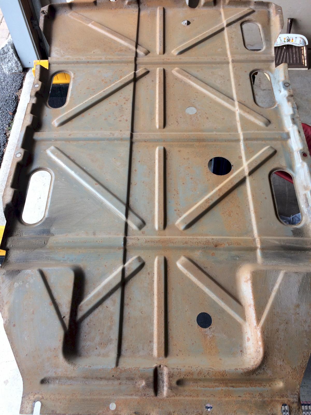

Could I ask for some suggestions on cleaning up this BA6 belly pan here? Cool
It's got a lot of paint still on it, but plenty of rust. I removed the peeling Ziebart undercoating from the bottom, it left some tar residue.
Should it be stripped to bare metal/sandblasted? Or keep cleaning it up and deal with the rusty spots? What tools could I use to speed the cleanup? Lots of nooks and crannies... Thanks for any suggestions. I'd like to learn to do this stuff correctly and figure this is a good piece to start with Laughing

PostPosted: Wed Feb 22, 2017 10:19 am    Post subject: Re: Cleaning Oxidized Metal Work Reply with quote
Looks like a bead blast job to me but I don't know the dimensions. It would need to fit inside the cabinet. If it's too big you could have it professionally sand blasted. If it doesn't get hot you could have it powder coated.

PostPosted: Wed Feb 22, 2017 10:30 am    Post subject: Re: Cleaning Oxidized Metal Work Reply with quote
Too big for a blast cabinet, that doesn't look too bad from here, I'd consider a wire wheel in a grinder followed by phosphoric acid and finish with tremclad/rustoleum.

PostPosted: Wed Feb 22, 2017 5:27 pm    Post subject: Re: Cleaning Oxidized Metal Work Reply with quote
Suggestion....take it over to the sandblaster guy I referred to you and then either POR 15 it or use the KBS stuff. Be done with it.
