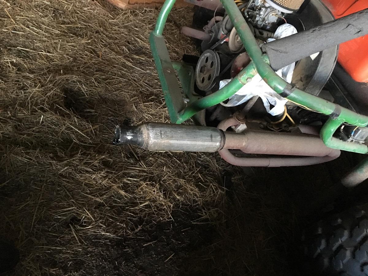

I’m running a stock engine (no clue what year) with dual bazooka Glasspack exhaust on my 66 fiberglass body buggy, while there great on the road. They get a little annoying in the parades. Any advice on what I could get to quite her down to a reasonable volume for under 200 bucks. Doesn’t have to be all pretty our anything, just good at its job. Thanks!

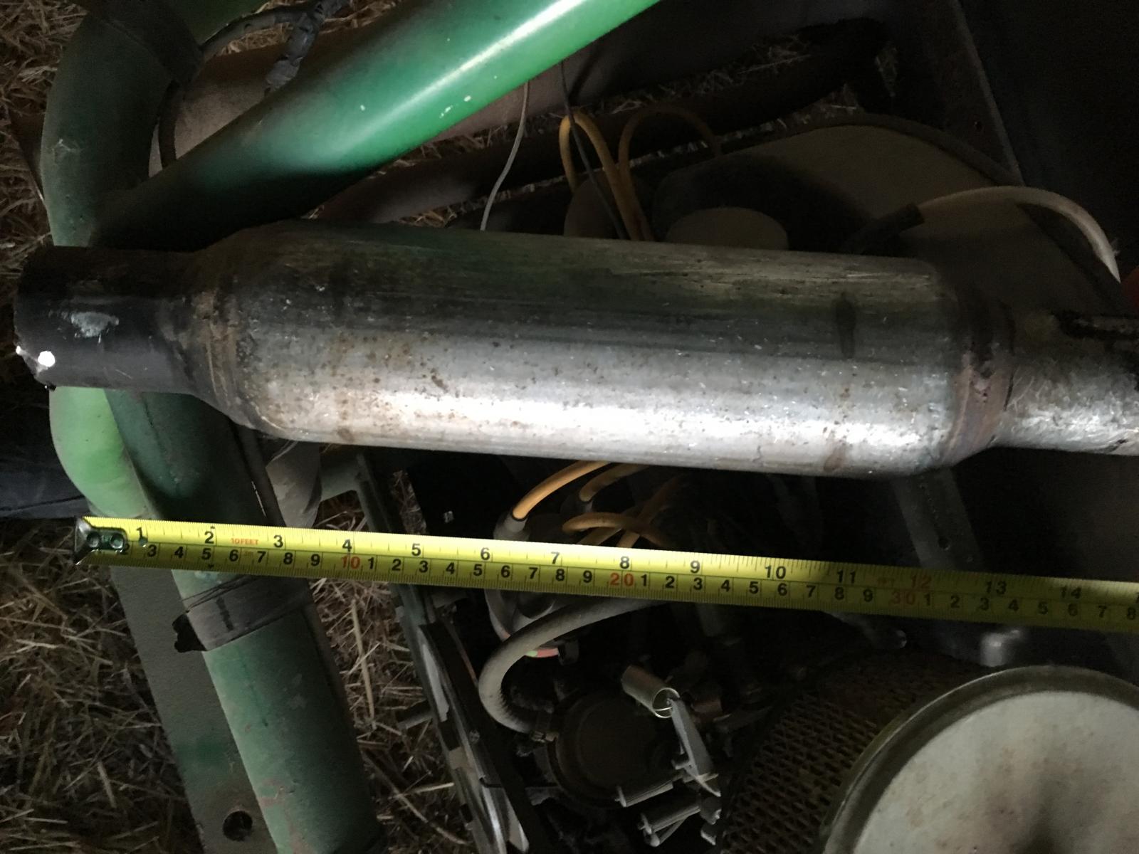

I like the idea of being able to switch quickly. What I’m running right now has a roughly 1-1.5 inch inner diameter at its smallest point, do you think they make a Glasspack that would slide into something that small? I tried the inserts from j-bugs and they where to big.

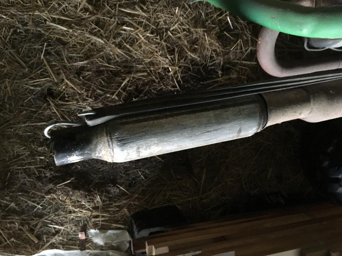

PostPosted: Wed Jun 26, 2019 5:54 pm    Post subject: Re: Exhaust advice Reply with quote
Here are some old picks of what’s on the car now, they weren’t taken with this purpose in mind, so sorry about the crummy angles.

I would look at the intake manifold. If the ends go strait down into the head you have a 40 horse engine. If they go in at an angle it is a 1300/1500/1600 engine. The ends of the 40 horse intake are part of the manifold, braised to it. The end parts of the later intake manifolds pushed down on the ends, but is a stamped part that is separate from the intake and loose when the manifold is removed (but captive, it cannot be removed from the manifold without cutting it apart.) Good advice is easier to give it when the engine is known. Question

Now that I look at these mufflers I think they are actually resonators because you cannot see straight through them like a glass pack.
The problem I see is they might stick out too far. My engine cage goes back further than yours but there may be shorter ones available.
The bungie cord is a bit crude, split washers welded to both and springs would be neater and still be quick to remove.

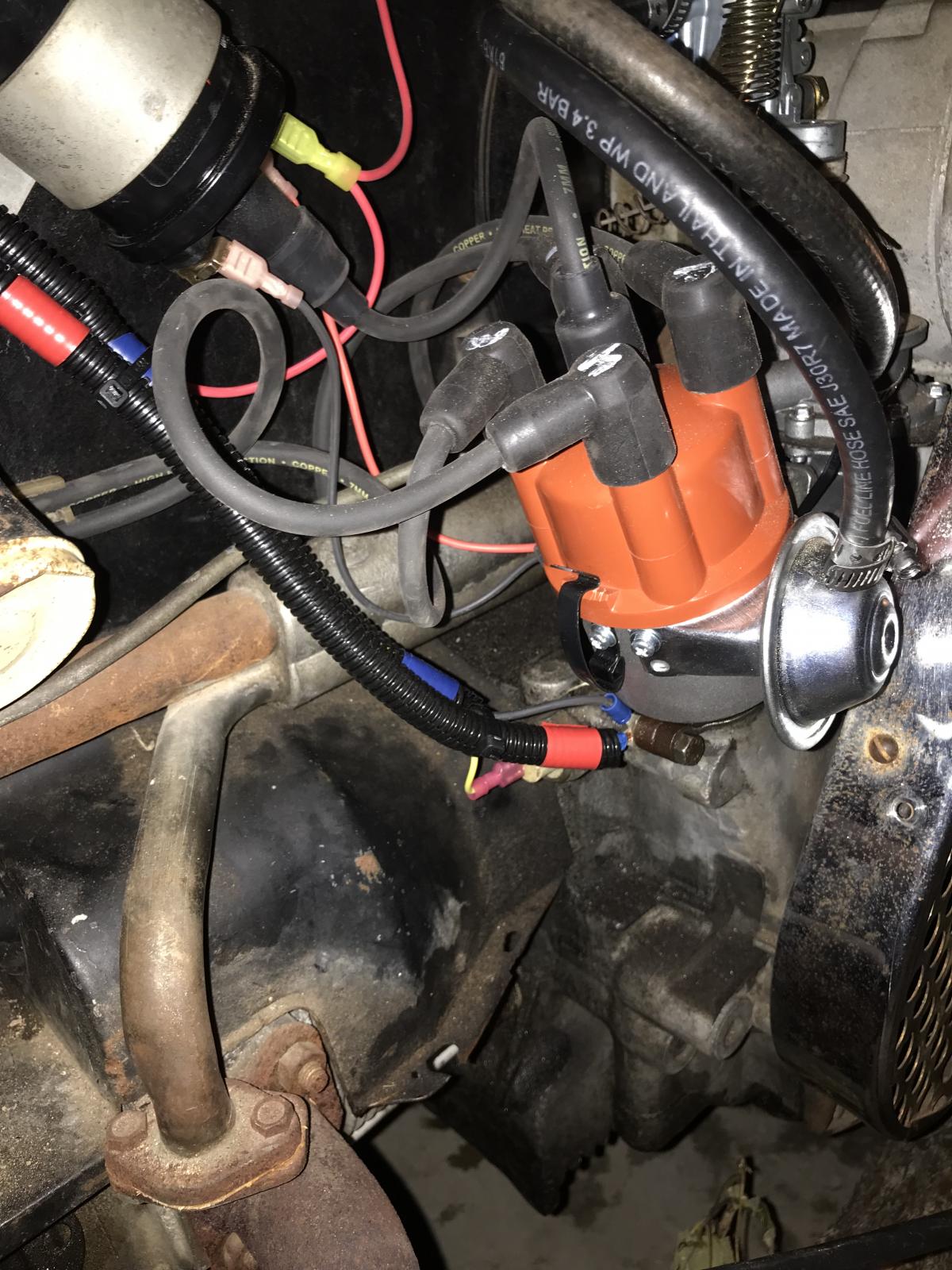

Thanks for the resonator idea, looks like a really good cheap but effective idea. I took some pictures of the intake, it’s a single port and I’m guessing it’s not a 40 based off of what EVfun said. I also took a pick down the Glasspack just to give and idea of what I have now. I’ll try and get the pilot cover off today if I have time, so I can get the block code. But it’s looking less and less likely.

That's a 40 horse engine probably a 64, it would be these: http://vwparts.aircooled.net/category-s/736.htm?se...amp;page=2

Those are 40hp heads, so you need an exhaust that is made for a 40hp 1200cc, because of the width.
