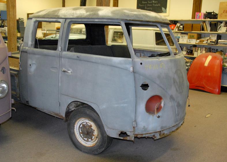

I picked up a 66 DC a while ago (about 4 years now), but due to other obligations, I haven't been able to work on it at all. Some of my time is starting to free up, I'm going to get going on putting this old girl back on the road. Here's a picture of the day I got it:
It looks almost exactly the same today. Since I know it will need some major metal work that I can't handle right now (no welder, yet), I am starting with some of the more manageable bits. The first on my list is the front window frames. Problem already.
It looks like the hole was drilled in the screws and probably messed up the thread. Either way, neither screw will budge, even after two weeks of soaking with pb blaster and some heat occasionally.

PostPosted: Sat Dec 03, 2016 11:04 am    Post subject: Re: Slow moving resto of 66 DC Reply with quote
... just think, it's appreciating, in value, just leaving it alone, till you get to it... you could let it sit another 10 years and sell... better than money in the bank... no rush

PostPosted: Sat Dec 03, 2016 11:08 am    Post subject: Re: Slow moving resto of 66 DC Reply with quote
That would suck. I want to drive it!
