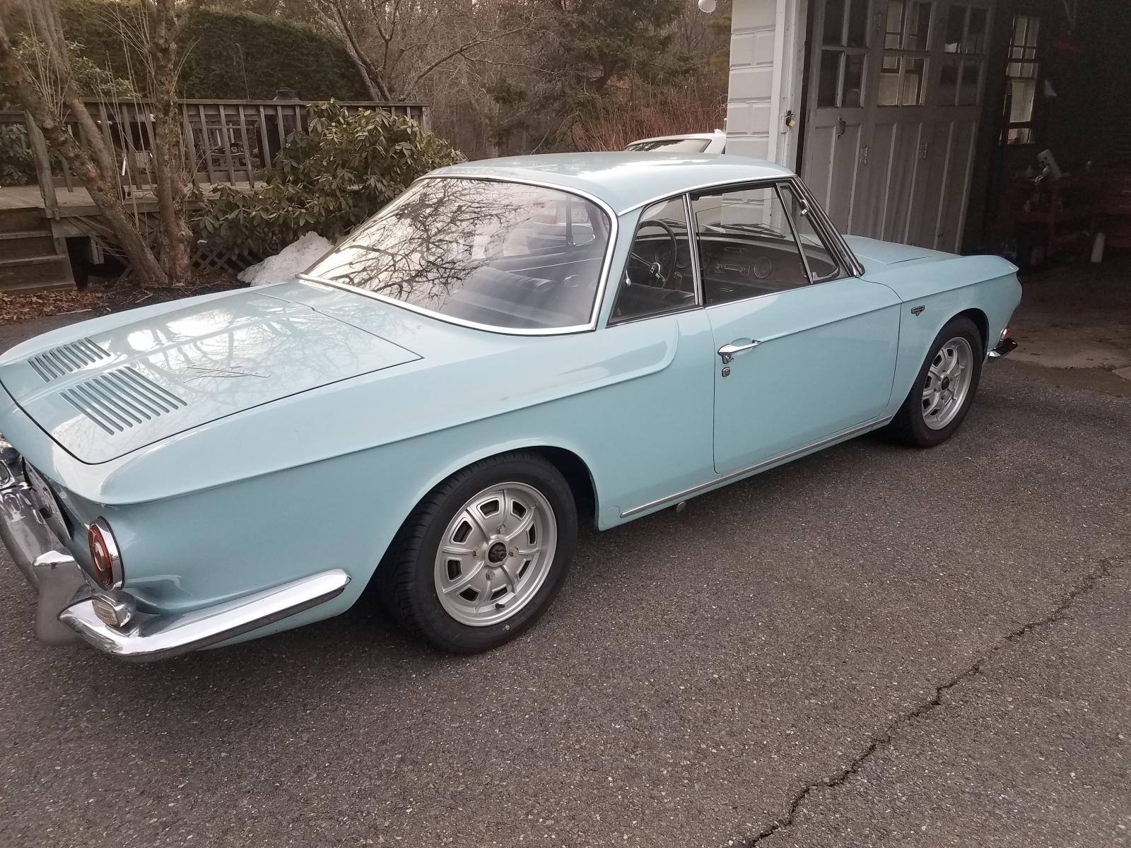

Posted: Fri Mar 31, 2017 8:25 am Post subject: Re: 1969 L51K Chrome Blue Type 34 |
Been doing very routine things on the car so far while I wait for this winter to finally go away.
Going through and made a list of small parts and things to fix. I am fortunate enough to already have much of the 'common' type 3 maintenance parts
Did a basic tune up ( this engine has an 009 distributor that will be going soon) Actually the entire motor will be swapped out with a fresh one I already have and I will freshen this one up. It has no Tstat and is just filthy.
Replaced fuel hose with modern type
Got 3d printed sun visor clips as they were held on by safety wire
Got a 1600 L bage for the rear to replace the incorrect one added at some point
Got some rubber bits and new carb linkages from ISP as those were really worn
Swapped out the severely dry rotted white walls with some Pedrini wheels I had in storage. I will use these till I get new 3/4 " WW and fresh caps and embellishers

Posted: Fri Mar 31, 2017 9:09 am Post subject: Re: 1969 L51K Chrome Blue Type 34 |
Thanks Erik I actually like how they look too. Pedrini's are the best looking 914 wheel and the silver powder goes will with this light blue. I do like how a 195 tire feels as well
In other news the scar on the left rear quarter has no filler and maybe just a result of poor prep when it had a respray which I believe happened in the 80's. still going to get it looked at and fixed. _________________ 1964 Notchback

Bobnotch Samba Member
Joined: July 06, 2003 Posts: 23347 Location: Kimball, Mi
Posted: Mon Apr 03, 2017 8:49 am Post subject: Re: 1969 L51K Chrome Blue Type 34 |
Erik G wrote: |
Yeah, I think I would run them too. It just looks right |
Agreed. Looks better with them. _________________ Bob 65 Notch S with Sunroof

EasternNotch Samba Member
Joined: January 19, 2006 Posts: 638 Location: Boston Metro West
Posted: Mon Apr 03, 2017 10:58 am Post subject: Re: 1969 L51K Chrome Blue Type 34 |
Bobnotch wrote: |
Erik G wrote: |
Agreed. Looks better with them. |
Yeah nothing too wild for sure. Now to just figure out how to get the rear center caps to clear without using wheel spacers. You'd think someone would have come up with a center cap that looks like the 914 caps but is a 1/4" deeper for type 3 rear axles. Fronts are on now and look good! _________________ 1964 Notchback
Posted: Mon May 01, 2017 6:45 pm Post subject: Re: 1969 L51K Chrome Blue Type 34 |
Been picking away at small maintenance stuff
-replaced shocks
-replaced fuel hoses with barricade, moved plastic filter out of engine bay
-one of the fuel inlet tubes pulled right out while doing this so those will be getting tapped for barb fittings like my other 2 type 3's.
- replaced steering damper lubed beam and adjusted torsion play
- replaced brakes all around- did not do rubber hoses yet but will be doing that soon.
-swapped the 009 distributor for a 123 ignition unit VW-R-V. The 123 is pricey but well built and has 16 advance curves. Glad I pulled the 009 as it didn't even have the o-ring on the shaft and now of course I have vacuum back . I had to heat the end of the vacuum tube to fit on the port of the 123 ignition but it worked out OK. Only thing that drives me mad about the unit is the switch for advance curves is located underneath and you must pull the unit to switch it which is a PIA. I want to try a couple other curves
Things I am planning next are ;
track down odd squeak from under the dash- when I hit a bump I hear it and can't quite figure out what it is. Wiper assembly perhaps??
Remove repair glove box which has a fist sized hole in the left side
take the car by a shop I found a couple towns over from me to look at spot on left rear, inner tire well respray and both hoods underneath have been painted black which I don't like.
Before long this motor will come out and be swapped with one I have that is ready to go. Its a 1600 with CW crank and ported heads _________________ 1964 Notchback
