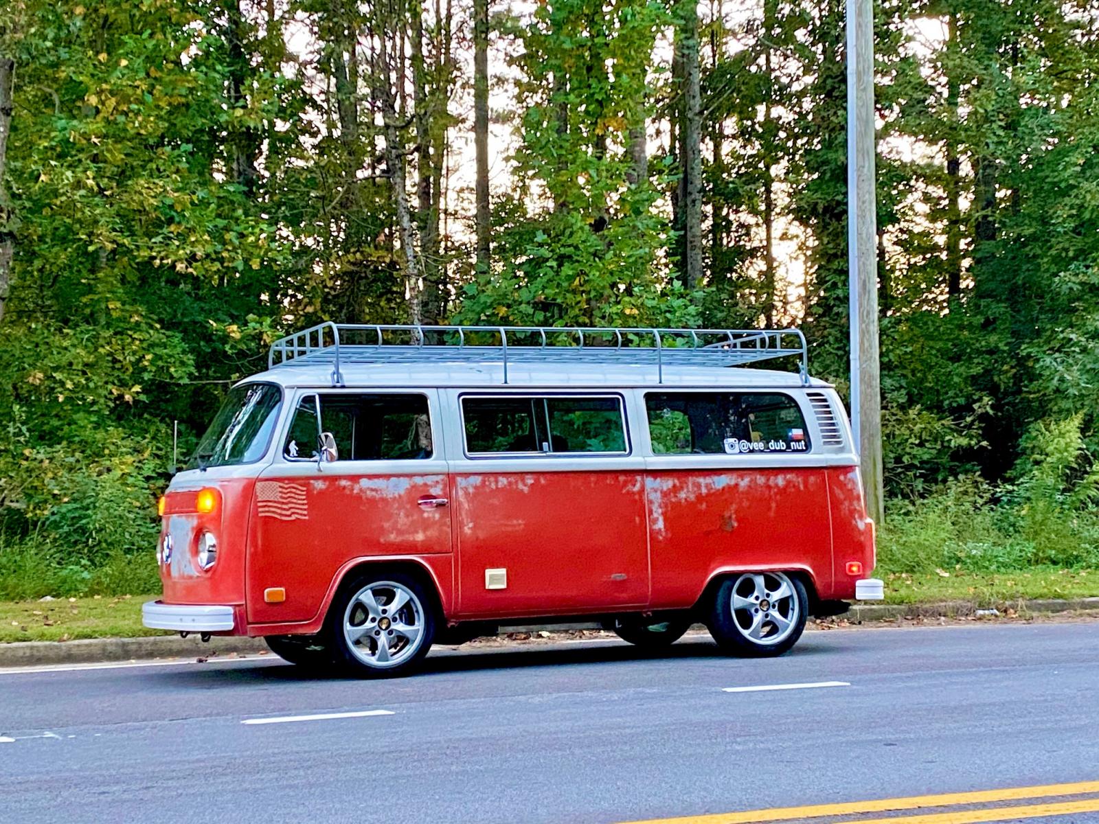

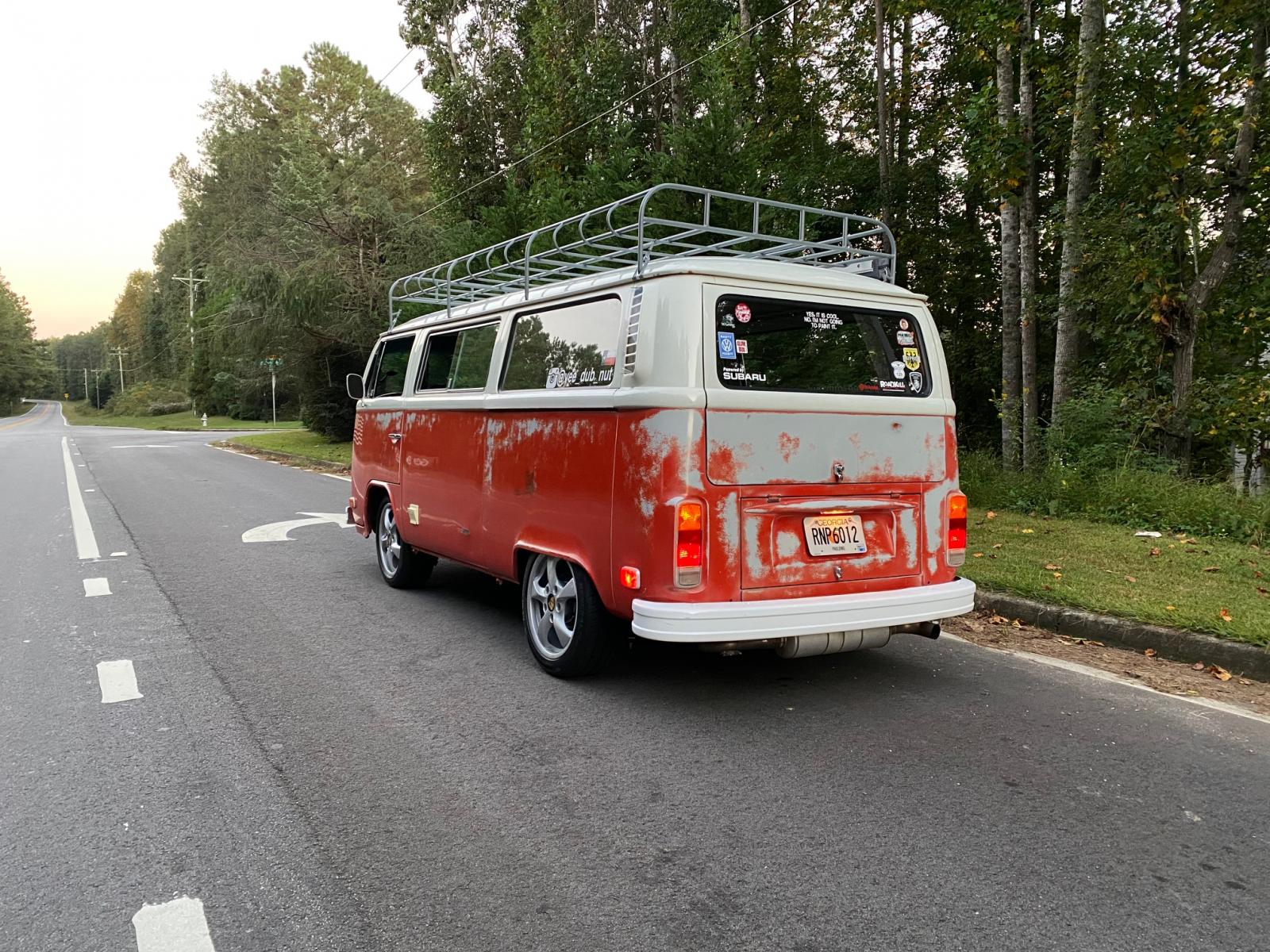

Did a little cruising around this afternoon. This was the real test of the adjustments made in the rear after my initial rubbing issues (i.e. redrill and spacers vs adaptors). Happy to report that everything in the rear is tucking well and has no clearance issues. Also getting the front brakes bedded in, and they are GOOOOOOOOOOOOOOOOD Twisted Evil

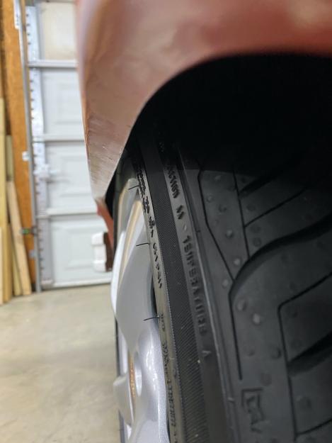

I grabbed this one before moving the little tikes slide over to grandma's house. I've hauled all sorts of junk on this rack since I got it. Just super handy. Let me tell you, if you don't think you get enough looks driving a Bus around in general, strap a kids slide to the top Laughing Basically EVERYONE was giving us the WTF look as we drove across town.
From the local ATL VOLKS Vintage VW meetup this morning. Had about 30 cars show up. Awesome weather today, and we had a cool backdrop for pics.
And lastly, just a cool angle I grabbed in the shop. Like I said, not everyones cup of tea, but I love the way this thing has come out. We enjoy the heck out of it.

Do you plan to upgrade the rear as well?
I know the original brakes are amazing on the bus, but sometimes the way we drive those nowadays, I won’t be unhappy to put discs in place of drums one day with this kind of engine and mountain driving.

PostPosted: Mon Oct 19, 2020 9:16 am    Post subject: Re: Vee Dub Nut's 74 Bay Transporter (& Subaru EJ25 Swap) Reply with quote
richparker wrote:
Personally I like the ride the Gas-A-Justs offer on a Westy, especially a fully loaded one. I liked them so much I even put a set on my Nissan pickup this winter.
Bus looks great, I’m gonna repost the mural pic on my Bays and Murals thread.
Thanks Rich!
As far as the Gas-Adjusts, I've got no complaints on the ones in the rear of my Bus. I would imagine the extra weight of a Bus would help make them have a softer feel than they did on my Beetle.
