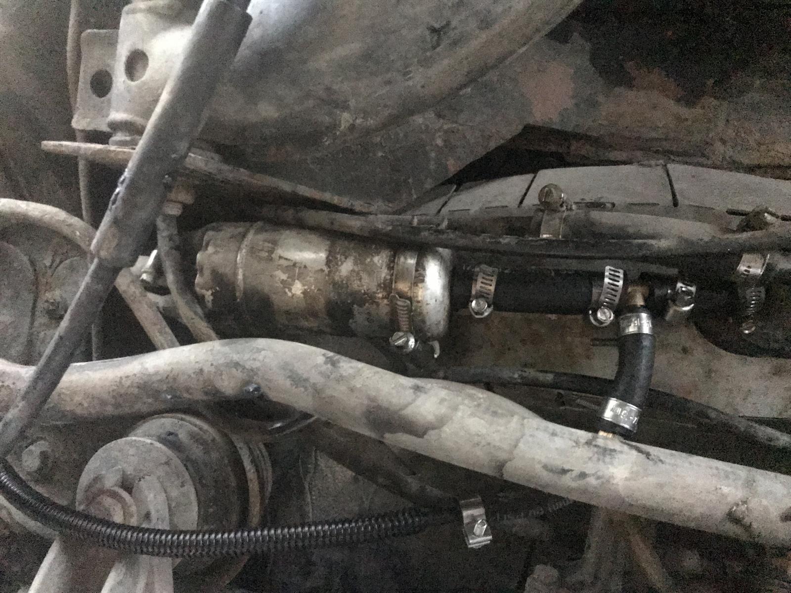

I have been trying to figure out how to tie the 2- 2.5mm I.D. diesel pump fuel line into my 5/16” nominal (3/8” I.D.) vitron fuel line.
I have searched for a tee fitting or even a hose barb reduction mender that might get me close. 2 mil is tiny! I’ve tried to build all manner of hardware store brass fittings to cobble together some kind of Frankenstein 3/8”x3/8”x2mm tee fitting.
I’m stumped. How are others tying into their existing fuel lines? Anyone know of a means todo this?

What if you just used a non reducing T. Then get a straight reducer off the T.

Brass barb fittings worked for my fuel line splice going to an Espar B4 pump.
-1x 1/2 x 5/16 x 1/2 Tee
-1x 5/16 x 5/32 reducer
- 5/16 & 5/32 fuel hose, good clamps
The B4 came with a thicker black plastic fuel line that slid into the 5/32 hose and into the fuel hose connecting to the heater fuel pump. Then, the even smaller white plastic fuel line from the pump to heater uses two rubber hoses sections that came with the Espar unit.
I love my B4 and only managing one primary fuel source.
Hope this helps.

I need to mic the plastic fuel hose to rubber hose transition.

Yeah not a fan of that witchcraft myself. I plan to use only one size tubing for the setup.

I guess I don't know what size fuel inlet there is for the heater pump, but you only need to use that small diameter, hard plastic fuel line between the pump and heater. You should be able to feed the pump with rubber hose.
But however you get fuel TO the pump, you NEED to use the plastic line between the pump and heater. That is how it pulses fuel into the heater; rubber would absorb the pulses too easily and it wouldn't meter properly.
Great point! Thanks.

And to add to that a little, you just use small bits of the rubber hose to join the plastic hose to the pump and heater. You should shove them all together so there is little to no space between the plastic and heater/fuel pump nipples, then clamp down on the rubber to join it all together.
Gonna bump this again cause I thought the plastic hose setup was a nightmare waiting to happen so I have been thinking about how to all this without it. Thanks again.
Great note.
