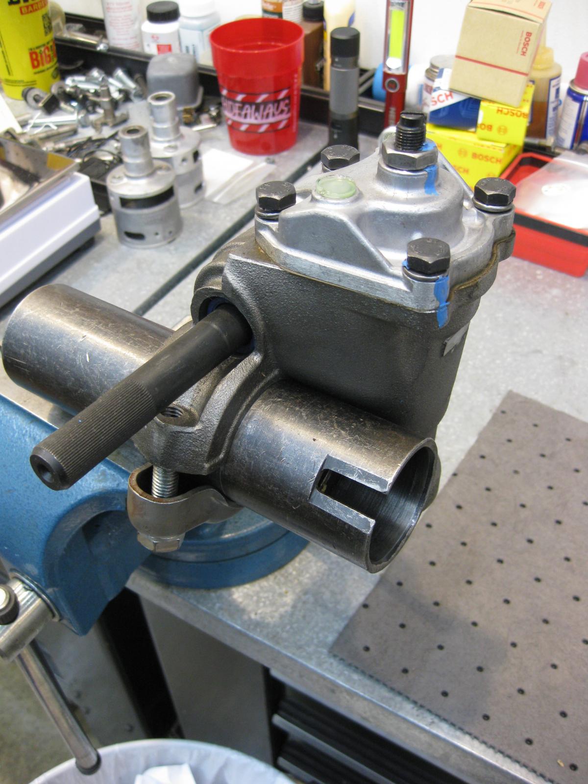

So here is a picture of labeled steering boxes.
They were also willing to sell the individual components, so as shown by the unit in the far right of the picture; it is now possible to completely rebuild an original VW unit retaining only the original housing. I.E. all of the other parts are brand new. So if you have an original VW housing with a good lower bushing; then you can accomplish this. However, if you are considering the economics, then I would just purchase the complete unit.
So here is a look at the unit.

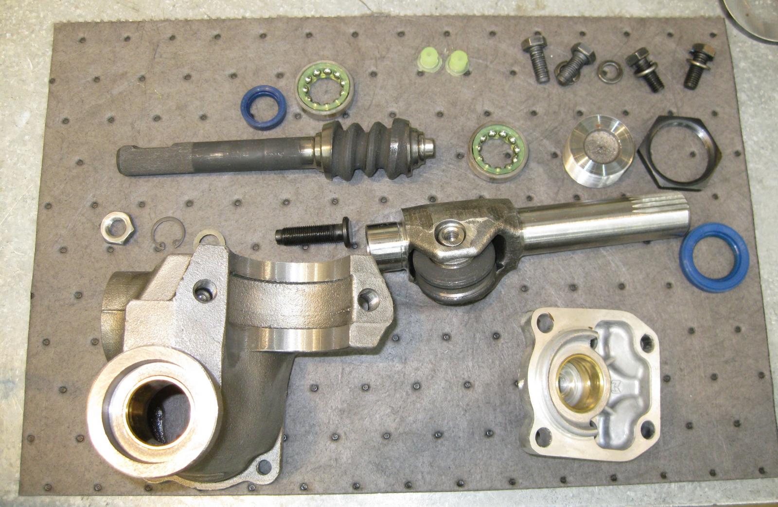

Initial disassembly
Notice the attention to detail. They are putting thread sealant on the two bolts that go through the top cover into the interior of the housing. There is also thread sealant on the big adjuster nut. The top cover gasket was attached with gasket sealant. These are assembly items that work to keep the grease inside where it belongs.
After cleaning up:
The bearings are of the style that uses a plastic cage. I can understand. That is just the way the bearing world has gone. Nothing to be done about it. From our discussions with the manufacturer, I am assured that the bearings are a quality item. The seals are still single lip, but the sealing surface is improved by being slightly softer (less hard) than the original TRW ones. The hardness level is similar to the double lip seals that I use in my rebuilds.

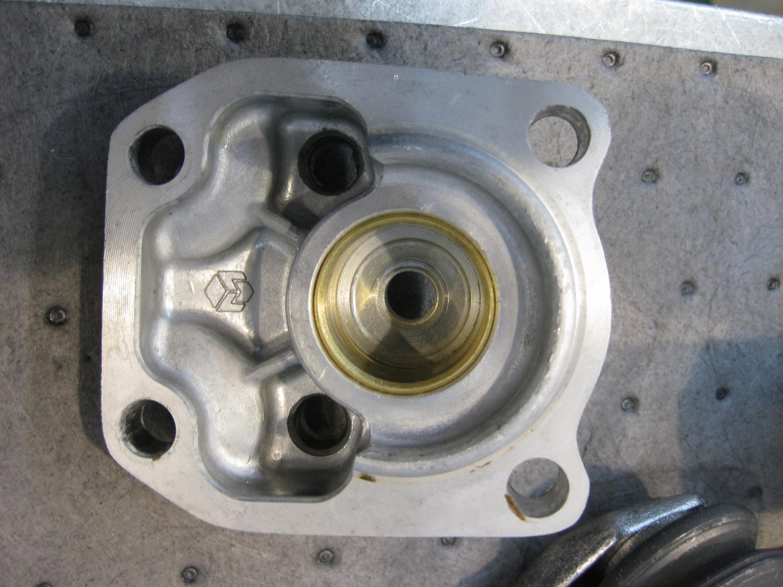

Looking at the top cover, I am really pleased to see that they have pressed in a brass bushing.
All of the machining is clean and precise. Note, don’t be fooled by the interior logo, this logo goes back to the TRW castings. The important improvement is the use of a brass bushing.

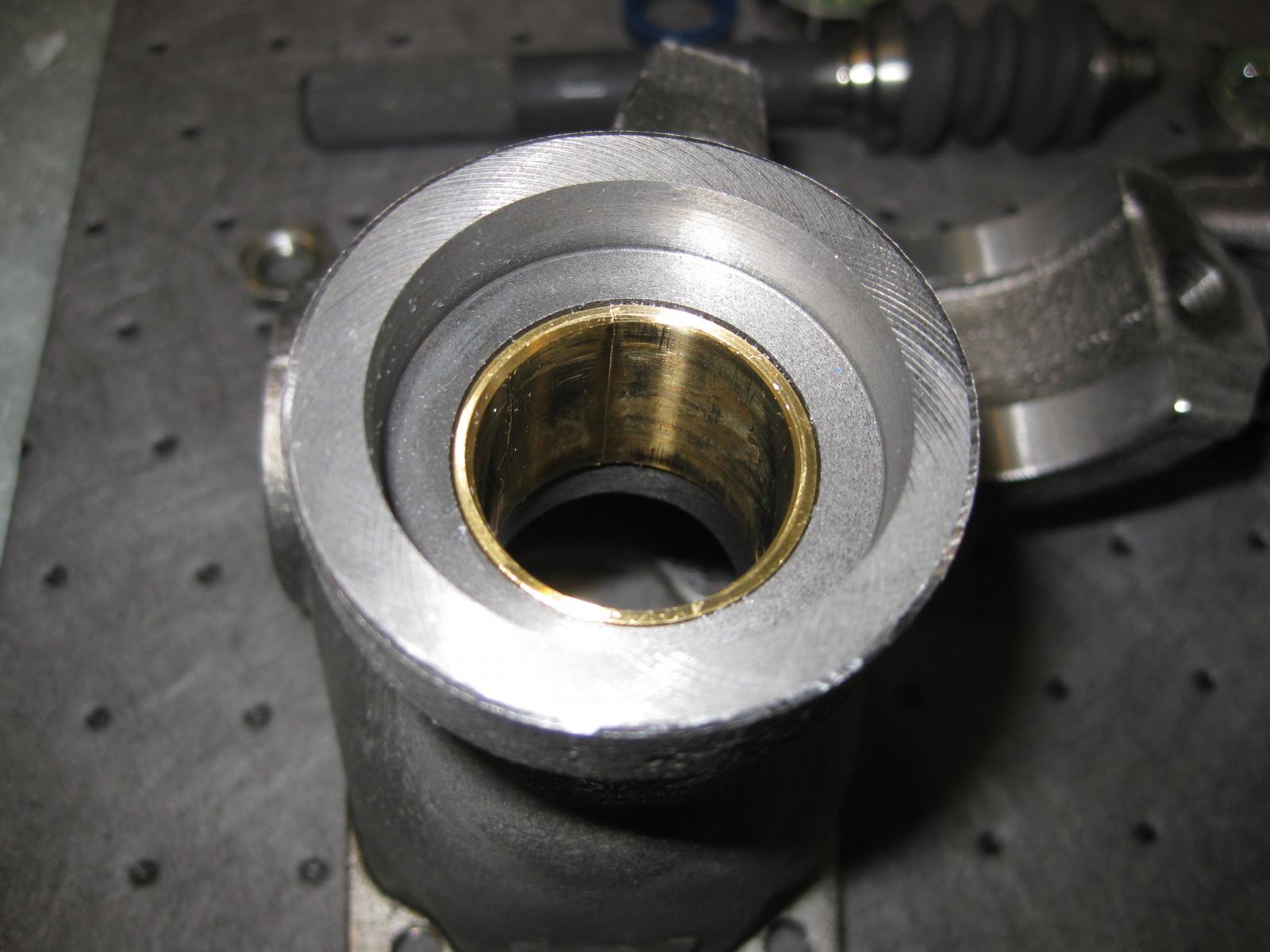

Looking at the lower housing, Again a pressed in brass bushing.

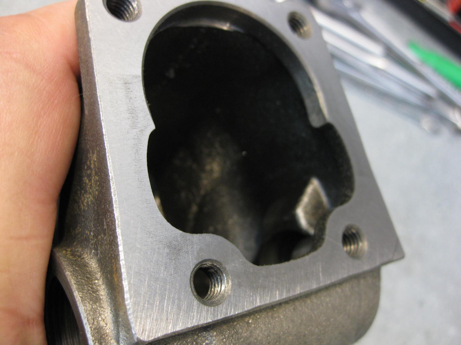

The machined surface of the top of the housing appears to be flat
And a couple passes on the surface plate proved that it really was flat. No high or low spots.
The non-flatness of the housing to has been a problem all the way back to the first VW units: The top of the original housing was never machined perfectly flat. Thus, there had always been a leak point at the top side of the housing.

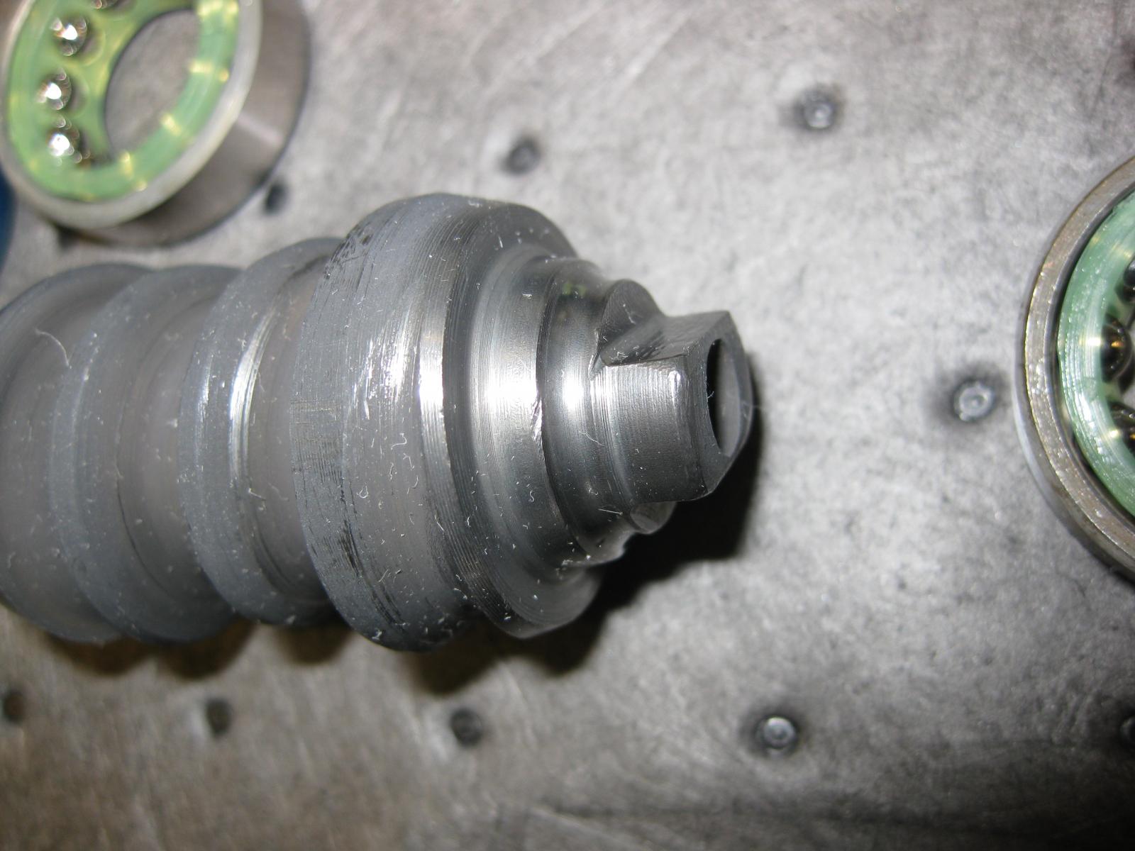

The worm shaft has undergone final machining so the bearings fit in the races as they should
The fit and finish of the roller shaft is proper, including a better finish on the pocket where the top (small) adjusting screw rides
AND, the surface of the adjuster screw has been properly machined.
One of my pet peeves. This surface has continual pressure and wear on it. Every time you turn the steering wheel, the surface of the adjuster screw rides against the surface of the pocket with pressure. This pressure is what adjusts the no-play zone. So a rough fit and finish here leads to early wear and a narrowing of the no-play zone. I.E. making the steering play at the steering wheel grow sooner. They accepted my recommendation and improved this manufacturing step.
