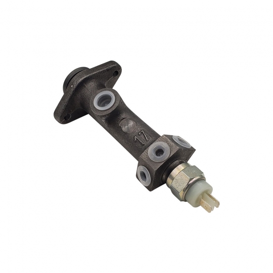

Mine does not look like that. It is for a dual master cyl reservoir and has 5 ports. A quick search shows I probably have one for a super beetle with 4 wheel disc brakes, 20.6 mm. EMPI 2-2808.

I also have that master.
Yes the TWO downward angled holes are for the two brake light switches.

PostPosted: Sun Mar 19, 2023 9:30 am    Post subject: Re: Brake Switch Reply with quote
Do you mean this one...
IF so it takes dual switches if used in standard application...

Dale M. wrote:
Do you meaqn this one...
Yes!

PostPosted: Sun Mar 19, 2023 12:17 pm    Post subject: Re: Brake Switch Reply with quote
Yes you can plug one. Empi does have a 10 x 1 plug for that.
That being said.....I have not had much luck with the plug.. ..I had a two pack and neither seated and sealed right (leaked).
I wound up putting the second switch in the hole and bam.....no problems.
All depending on your electrical needs....warning lights ect.....you can choose a two pole or three pole.
I did not make an alarm light.....so two of the two poles to wire in parallel, so that either one can make the brake light circuit.

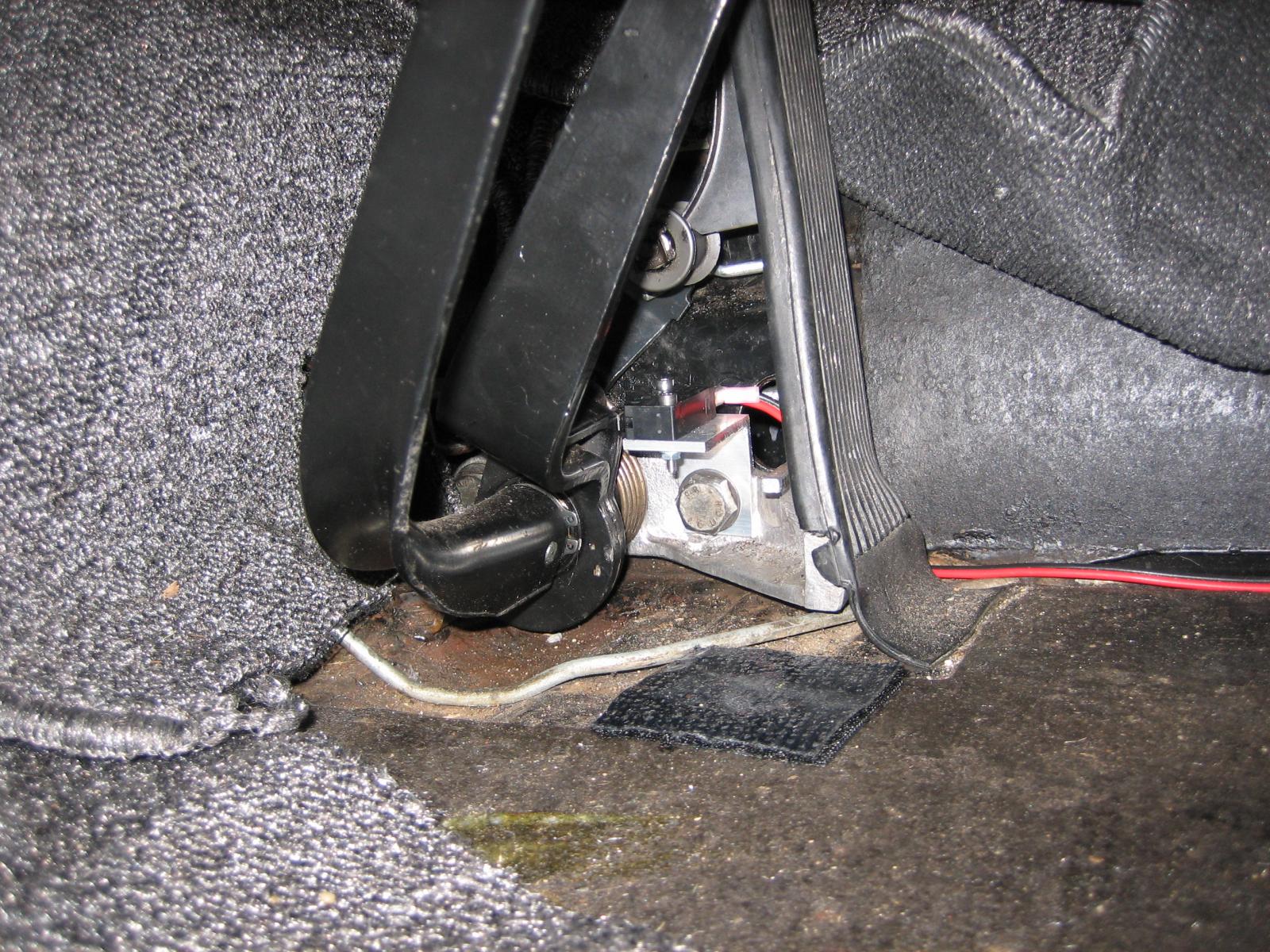

PostPosted: Mon Mar 20, 2023 8:39 pm    Post subject: Re: Brake Switch Reply with quote
This is the plug I used. I actually used 3 of them, one on each brake switch plug and one on the top outlet of the dual circuit master cylinder. The brake switch ones because I installed a mechanical switch on the pedal arm. The upper one so I could mount the Volvo master cylinder reservoir "backwards" with the side flat toward the firewall, because it's a bit shapely forward.
I see that number is out of stock now, you might be able to use BQ19, it is in stock and 3/8-24, that size *almost* interchanges with M10, but you cannot torque it too much or it strips.
