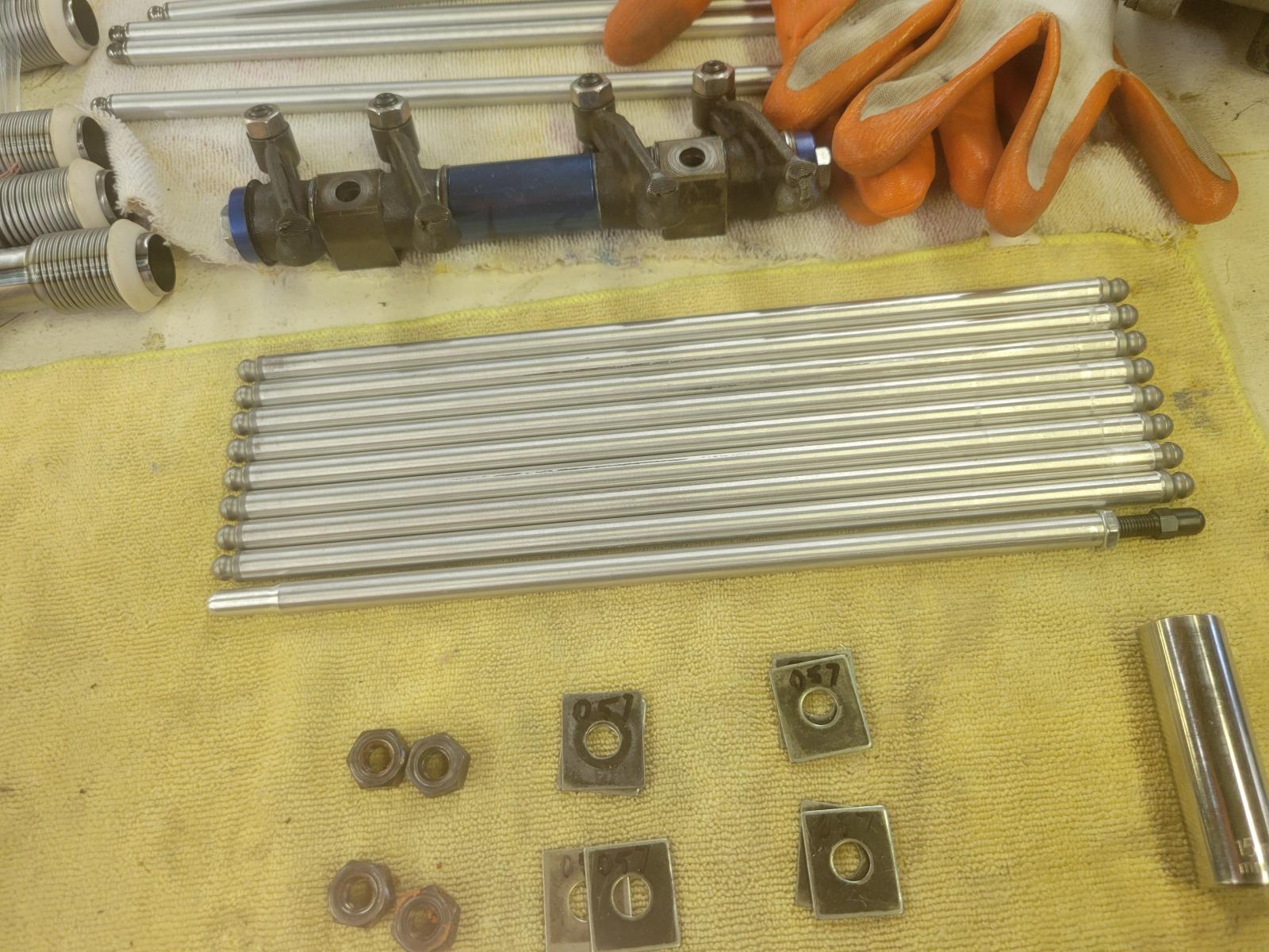

The new pushrods and the seal for the transmission input shaft came in. The sleeve is on the transmission and I have worked out the new valve train geometry.
All of my shims measured and sorted.
New pushrod marked:
Pushrods cut.
