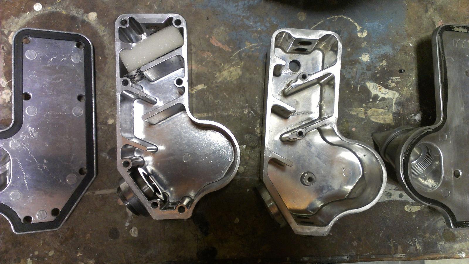

So that others can learn from my mistakes:
1. If you are building a bigger motor or will turn high rpm's, make sure to vent the extra crankcase pressure. I thought I could get away with it because of the C-channel seals on my valve covers but the oil just leaked out from behind the pulley instead.
2. Seal your case inserts if you have them and they are open to the inside of the case, like when machining is done to make room for a longer stroke crank. Do this even if the case is new and you trust the person that did the machining.
My question is how much venting is enough. I plan to vent the valve covers to the air cleaners. I also plan to pull the motor, heads, and back out the inserts to put some sealer on them, then screw them back in. I'm hoping this can be done by double nutting a case stud.
Thanks.
You can probably get by with a cheapie breather box. If you do, throw the foam away & put a stainless steel or copper pot scrubbie in there. The oil mist should have a place to collect & then drip down. If a piece of copper scrubbie made it's way to the engine... it's softer than stainless.
I think venting direct to carbs isn't advised. Hopefully someone will back me up on this. You might draw too much oil in.... lower octane rating... make it lean.
I understand you don't want to puke oil out of the crank seal & probably don't like the oil mist settling on your engine compartment.
I'm getting a similar engine built, running a breather box and venting to the original down draft tube spot on the right side of the pulley (right near the case). The breather box I'm going to use is the EMPI one that stands up tall at the filler neck area & will put copper scrubbie in there. I like the EMPI one more than the CB one because it has more bolts (on the left in the pic below). I think they're kinda ugly... but oh well.
I've read on here the 3/4 side gets lots of oil & only vent the 1/2 side when needed. Also crank case breathing is preferred to valve cover breathing. You already have a big hole at the alternator stand/filler neck.
You can see below where you could take the plate from under the foam and put it down lower over the main hole...add four copper scrubbie pads in the cavities. Plug the lower fitting ports and one of the top ones & then use the available top / back one to vent to atmosphere down by the pulley, to below the bus. If more breathing is needed, uncap one of the other lower plugged holes, vent the 1/2 valve cover & maybe route another hose down somewhere else or join the two hoses into a 'Y' and a bigger down tube. The area of two 3/8" circles is less than the area of one 5/8" circle. I'm getting at the point... you don't need a much bigger line to equal the size of two smaller lines. Don't forget to add a oil breather draft tube boot: http://vwparts.aircooled.net/Oil-Breather-Draft-Tube-40hp-1600cc-311-115-541-p/311-115-541.htm
