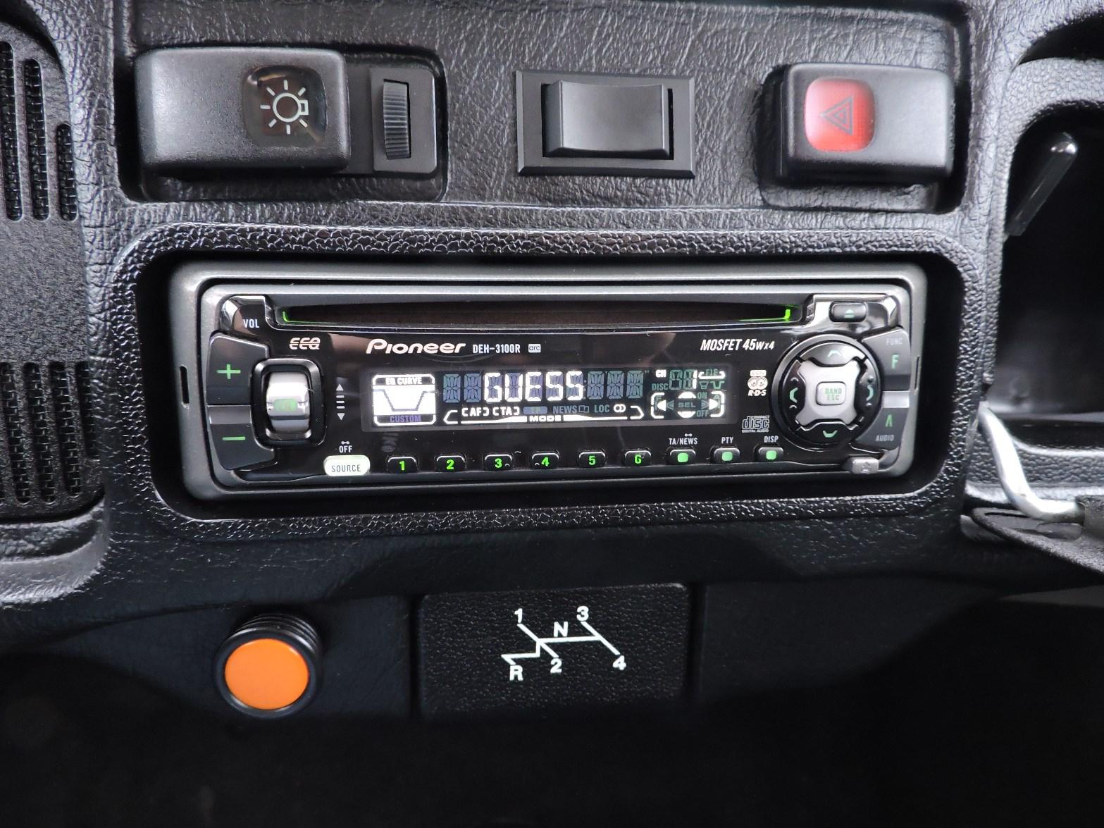

So, as some of you may remember, my mexi bug came with a early '90s pioneer stereo, the kind you were supposed to pull out of the car and bring along with you as you left the vehicle unattended.
now, even though I had cleaned and refurbished it and it worked pretty good, I still was unsatisfied. not with the head unit itself, rather with the fact that I only had one speaker, mounted in the stock location on the left of the steering wheel. So my stereo actually was a mono, and I often found myself listening just to the left channel of a song.
I ruled out early the option of installing a proper set of speakers as the car is totally unmolested and even drilling little holes for speaker wires bothered me.

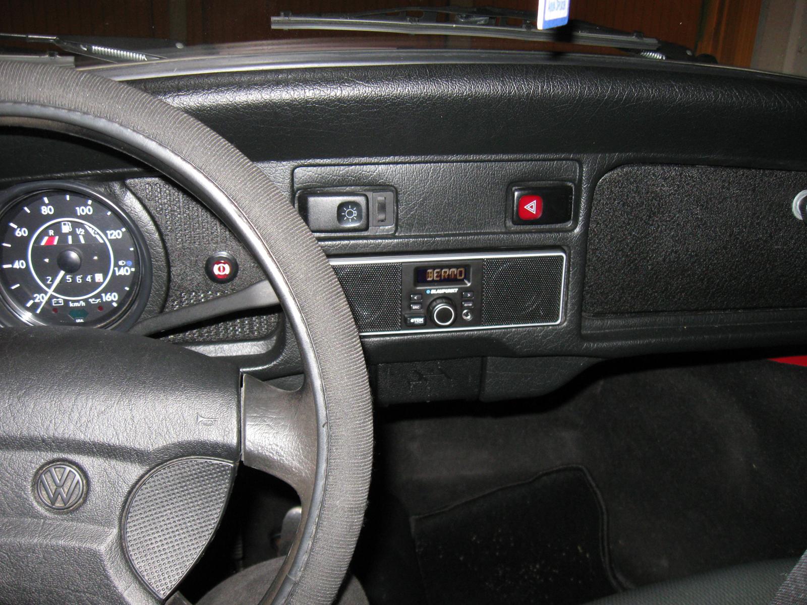

So I was about to buy the retrosound twin-coil speaker... then I saw the light while casually browsing the net.
...enter the blaupunkt casablanca 2012:
a din-sized head unit with AM-FM tuner, usb and aux in... with built in (albeit low power) stereo speakers.
the unit itself is not that much expensive, and more importantly it allows for the cleanest radio install ever. It mounts using a din cage (I'm still going to build some rear support for it just to avoid the risk of having it bouncing around), and it just has four wires to connect: battery positive, ignition, ground and powered antenna, of which of course I only needed the first three.
(the antenna cable needs a jack-to-iso adaptor)

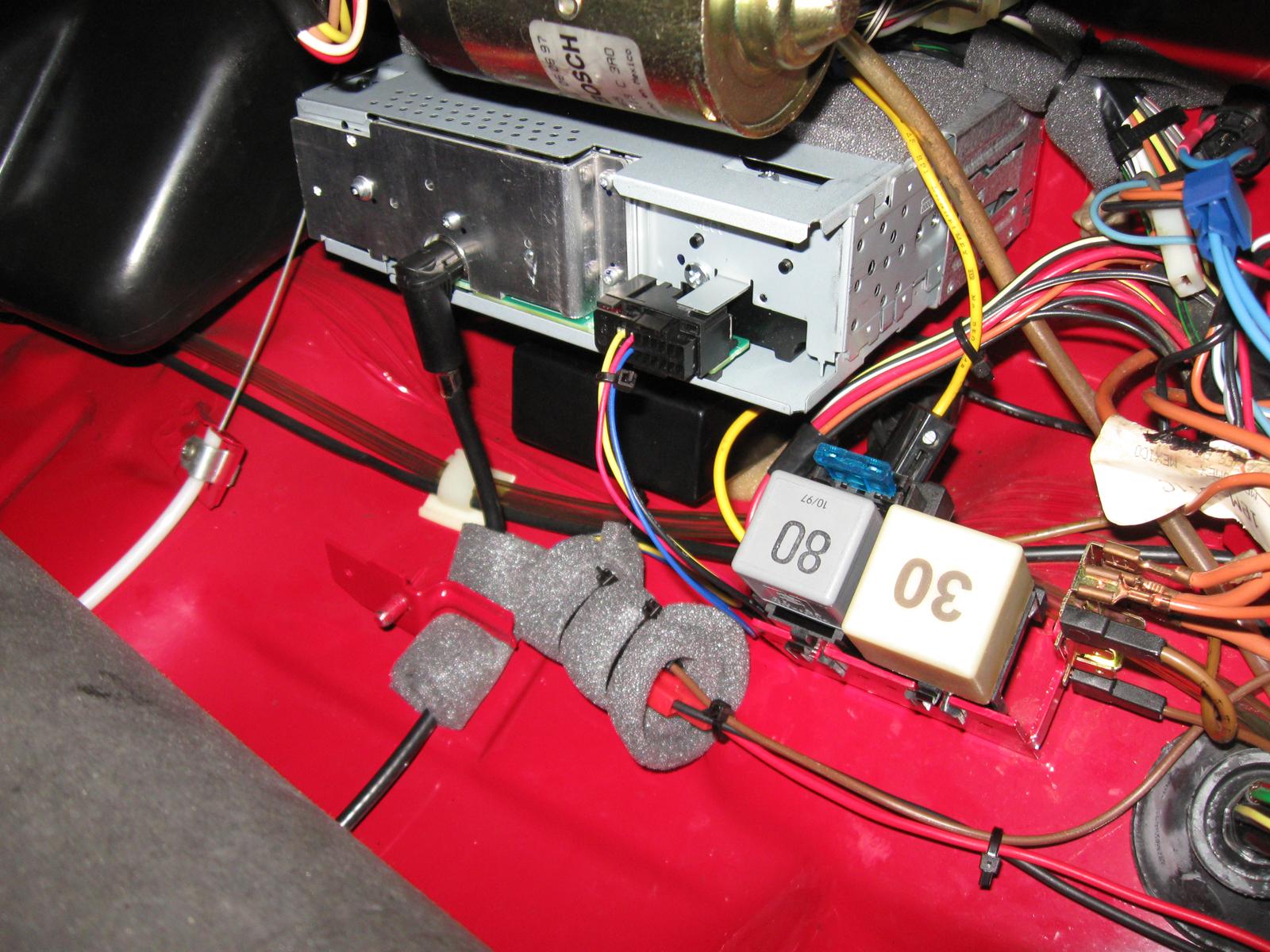

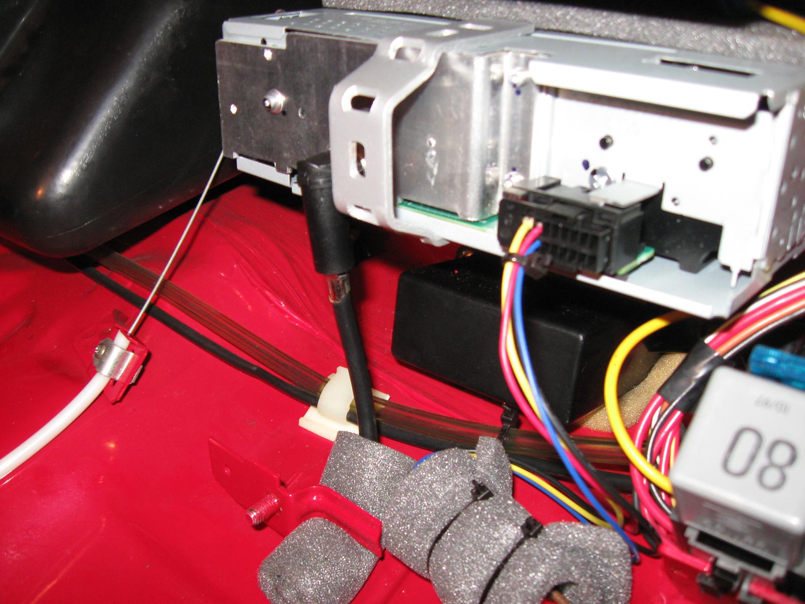

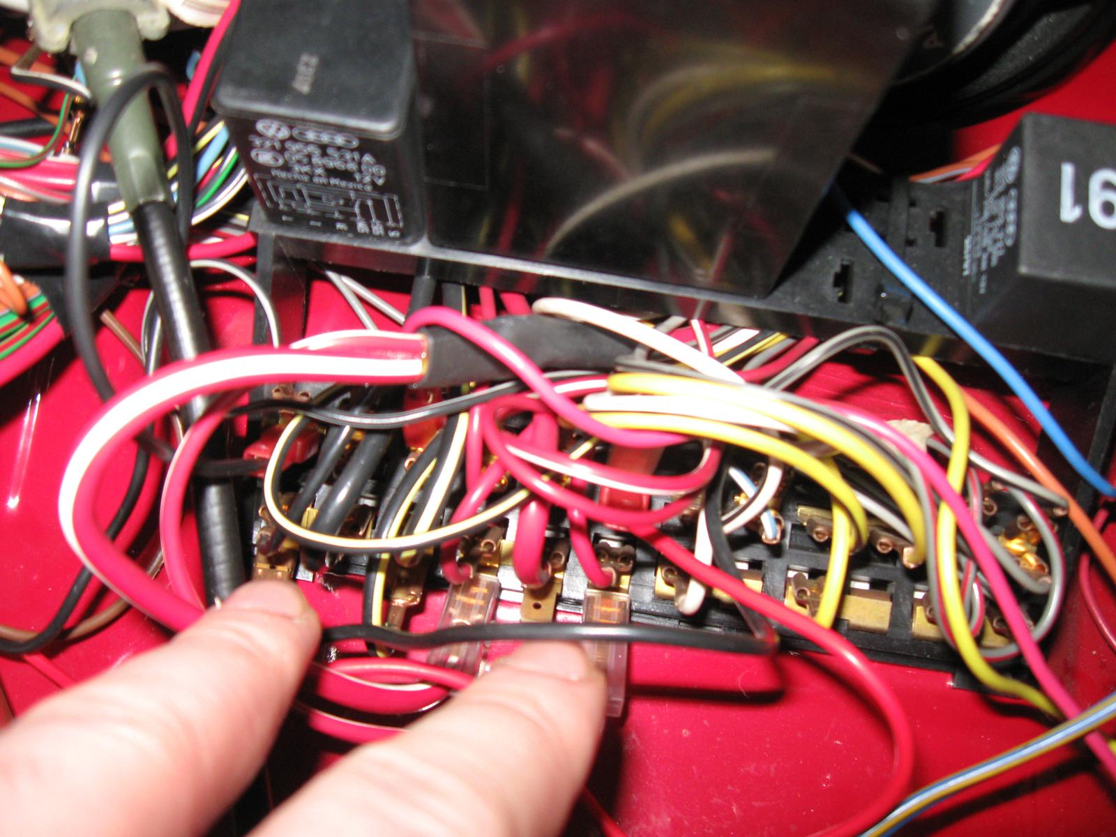

I made some extension leads using vw colour coded wires (red, black and brown), then I hooked them to fuses #7 and #12 and to the front ground point as per mexi beetle radio wiring specifications.
Put in a low-profile usb drive and... bang! good stereo sound in 30 minutes of work (most of them spent making and neatly rounting the leads). It even could pick up FM stations while parked in the garage at the 5th underground floor.
Now, this is not going to satisfy lovers of hi-fidelity sound, but it is enough to allow me to properly listen to my tunes without having to use the cassette adapter to plug in a digital player and with no signal loss, and it requires literally no modifications at all to the car.
one last shot of it in the dash playing some '80s italian music Cool :

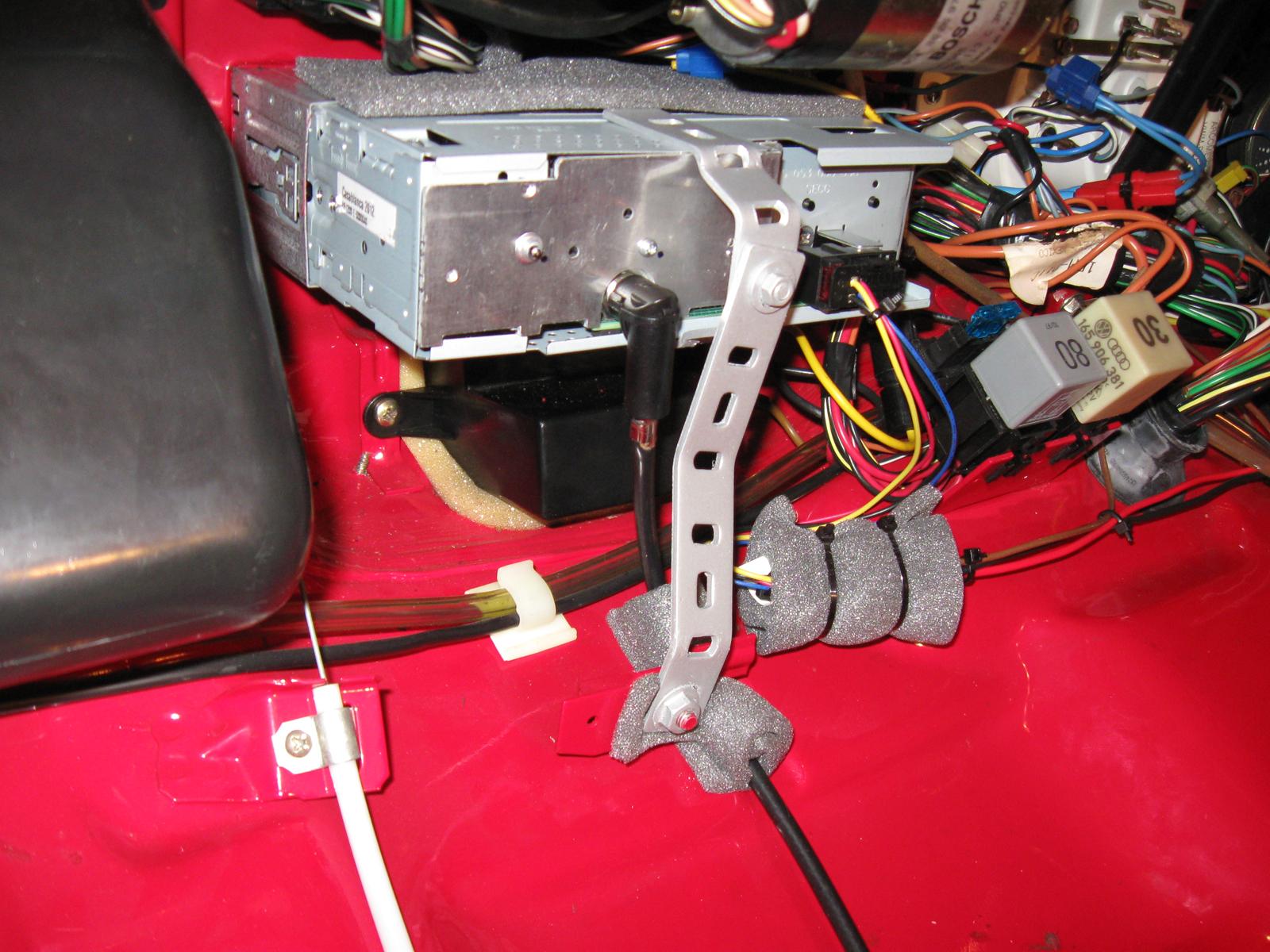

in the first post I pointed out how this stereo does not come with the usual screw/post at the back of the unit used to secure it.
Once installed using the din cage the unit felt robust, but I did not want to risk having it bouncing when driving and putting stress on the dash sheet metal only.
so I bought a couple of perforated steel bars, took some measurements and came up with this:
that's a "u" clamp that slides over the unit providing a mount at the back.
then took some more measurements, and made this other piece:
(the bars were nickel plated but the bending took away the plating so I painted them and all the associated hardware with some zinc primer)
aand... job done. now the stereo is supported at the back just as the old head unit was.

To wrap the thread, I've finally ventured on the autostrada and I can say that at 120 km/h with the window open you can quite clearly listen to the radio even without turning the volume up to max. Actually, the listening is better than my previous set up since the speaker on the left of the wheel got quite disturbed by the airflow from the window or quarter vent at speed.
