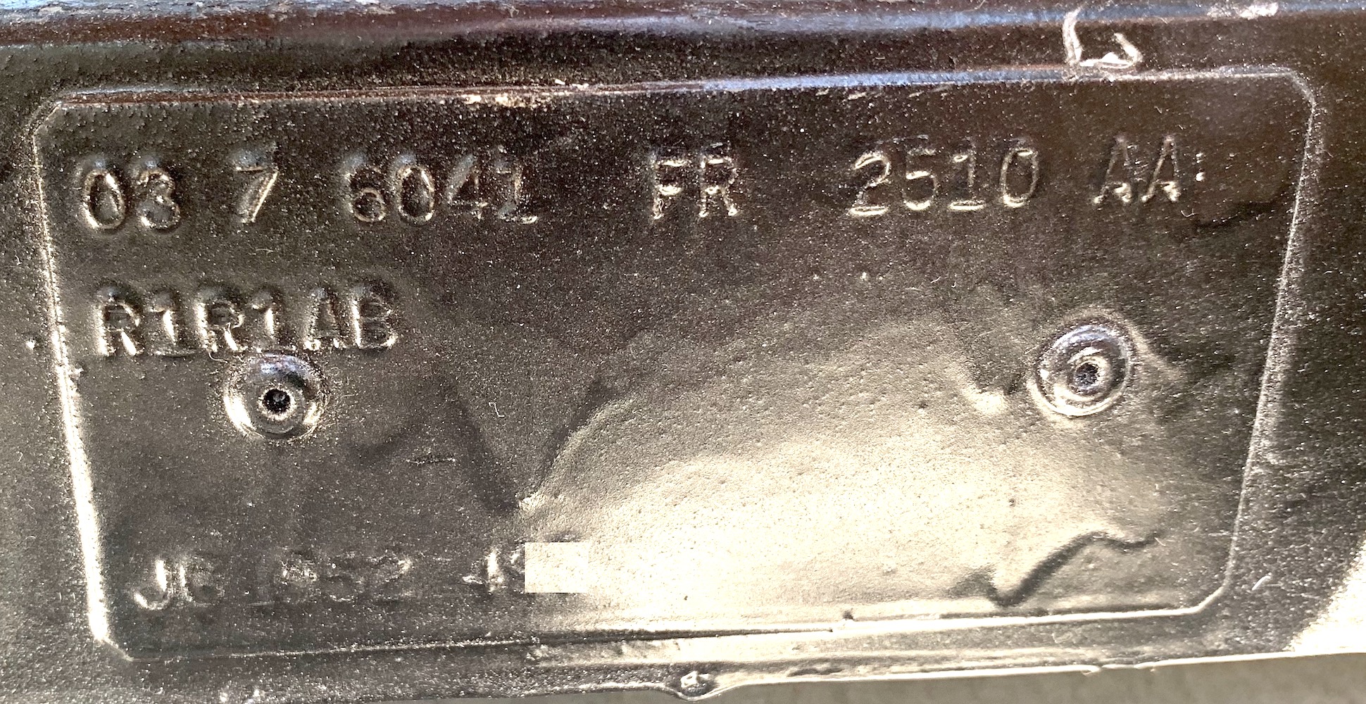

Mine looks like this.
So... Mine should be from the third week in production year J?
So third week counted from the 1st of August 1980. So that would mean in the week of 22 of August 1987.
But that does not comply with many serial registrations that put my car made between 31st December 1987 and 31st January 1988.

If I where to look at the sticker;
And compare it to the plate;
Type is 251 0AA - I need to search some more which kind of types there were...
And indeed, here you find the M-codes, so the sticker would be the "M-plate".

...registrations that put my car made between 31st December 1987 and 31st January 1988.
The 03 indicates the 3rd week in the calendar year 1988, which is indeed January (January 24, 1988 to be specific).
Beakerflo wrote:
R1R1 is white, but what codes are used for other colours?
You'll find that info in the paint code topic: https://www.thesamba.com/vw/forum/viewtopic.php?t=527875 . Wink
Beakerflo wrote:
If I look at the TS he/she has a colour code S8S8
So it would be;
LC7W, S8S8 Butterfly Silver Pearl
Than.... this is a list that could be used?
https://www.automotivetouchup.com/touch-up-paint/volkswagen/2006/all-models/
S8 is the color's sales code for its era. S8S8 for a T3 is Savanna Beige Metallic (LH1V).

PostPosted: Thu May 28, 2020 1:55 am    Post subject: Re: M plate de-code Reply with quote
Thanks! Much appreciated. The rest of your post as well of course.
I did some more digging...
Ausstattungsaufkleber - equipment sticker found under the dash, under the fuse-box contains the following;
- the FIN, Fahrzeugidentifizierungsnummer or in English; vehicle identifying number
- the VIN
- the order key
- the engine code
- the gearbox letters
- the color codes
- the interior color (interior / upholstery codes)
- the additional equipment the so called m-codes
* The FIN in my example is 3863 03-7-6041 995 FR
I can not really decode this yet.
* The VIN starts with WV2 etc.
* The order key in my example is 251 0AA
which basically means; Kastenwagen (panelvan), with 2 seats in front and no more, DJ engine with syncro gearbox for 16" drive terrain.
The way it is built is, first 3 characters;
- 245 = Pritschenwagen - pick-up
- 247 = Doppelkabine - pick-up with double cab
- 251 = Kastenwagen - panel van
- 253 = Kombi ohne Kombi L - Station Wagon
- 255 = Caravelle ,Kombi L - Passenger van
The 4th character;
- 0 = Seating arrangement 2-0-0 (also with Joker with high roof, with pick-up it is always three people in the front)
- 1 = Seating arrangement 2-2-0
- 2 = Seating arrangement 2-0-3
- 3 = Seating arrangement 2-3-0
- 4 = Seating arrangement 2-2-3
- 5 = Seating arrangement 2-3-3
- 6 = Ambulance
- 7 = Ambulance
- 9 = Joker with pop-top
The 5th character, engine;
- 1 = 1.6 liter gas-cooled CT with 37 kW / 50 PS
- 2 = 2.0 l gasoline engine, air-cooled CU with 51 kW / 70 PS
- 3 = 2.0 l petrol air-cooled CV with 51 kW / 70 PS
- 4 = 1.6 l Diesel CS with 37 kW / 50 PS
- 5 = 1.9 l petrol DF with 44 kW / 60PS
- 6 = 1.9 l petrol DG with 57 kW / 78 kW (SP for Switzerland)
- 7 = 1.9 l petrol engine DH with 60 kW / 82 PS
- 8 = 1.9 l petrol engine GW with 66 kW / 90 PS
- 9 = 1.6 l JX turbo diesel with 51 kW / 70 PS
- A = 2.1 l petrol DJ with Digijet injection
- B = 1.7 l diesel KY with 42 kW / 57 PS
- C = 2.1 l petrol engine MV, SS, SR with Digifant injection
The 6th character, gearbox;
- 1 = 4-speed gearbox
- 2 = 5-speed gearbox
- 3 = automatic transmission
- S = automatic gearbox on the DJ
- 5 = 4 + G gearbox with 205 R 14 tires
- 7 = 4 + G gearbox on 251 and 253 type with 185R14C tires, on 255 with 205/70R14 tires
- A = 4 + G gearbox with 195R16 tires
* the engine code and the gearbox letters look self explanatory.
In my example its, DJ engine and ALK gearbox.
* Paint number is L90D and inside AB
And the m-codes are here at M.-Ausst./Options.
I have not found an explanation yet for BZL, CS8, IBE
The rest is;
M124 Headlamp Bulbs, Yellow Light (F) (245-256)
M398 Exterior Mirror (Flat) Heated and Electrically Operated
M430 Wind Shield Glass - Laminated - Green (251-256)
M561 Vent Wings (245-256)
M571 Rear Fog Lamp (245-256)
M651 Windows Lifter, Electrically Operated
More M-codes to be found in this topic; https://www.thesamba.com/vw/forum/viewtopic.php?t=341506
Source for this information, in German;
http://www.t3-pedia.de/index.php?title=Ausstattungsaufkleber
regards,
Floris van Enter
http://beakerbus.nl (Dutch)
Beakerflo
Joined: March 03, 2015
Posts: 40
Location: Langedijk, Netherlands
Beakerflo is offline
PostPosted: Thu May 28, 2020 2:07 am    Post subject: Re: M plate de-code Reply with quote
So to get back to topic.
My explanation of the plate is;
Hopefully it helps decoding the original topic starter (if he is still around) or others.
regards,
Floris van Enter
