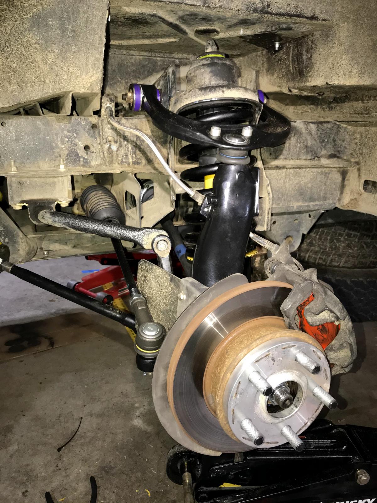

Agreed, I seem to remember something like that too about tightening and loosening torques, which is why doing 2 clicks on a torque wrench is useless... but I figured the experiment would be fun.
At this point, here’s what we know:
- the wheel hubs heat up quickly and the right side is consistently 20° warmer than the left.
- I unnecessarily overpacked the outer part of the bearings with grease, especially the right side one.
- When the wheels are in the air and spun by hand, the left wheel stops within 2 seconds, the right one within 1 second.
- Taking the brake calipers doesn’t change the wheel spin resistance.
- The axle nuts where theoretically torqued to 246lb/ft or less on the left side and 292lb/ft or less on the right side.
- A loose axle nut, regardless of how loose, doesn’t change the wheel spin resistance.
Other details:
- The outer CV joints are not new but were swapped from side to side.
- The outer CV joints were most likely reassembled with the inner races and outer races clocked differently than when removed.
- The van has a lift and the fender to axle dimension was about 20.5” before a single mile was put on the front end rebuild and 19.75 after 120miles of driving (including lots of off-roading).
At this point, I’m not sure re-torquing the axle nuts and driving it around will create different results, unless it was indeed the brakes dragging. I haven’t decided if I’m going to put it back together to do that test yet or not or just commit to replacing the bearings and not adding grease.

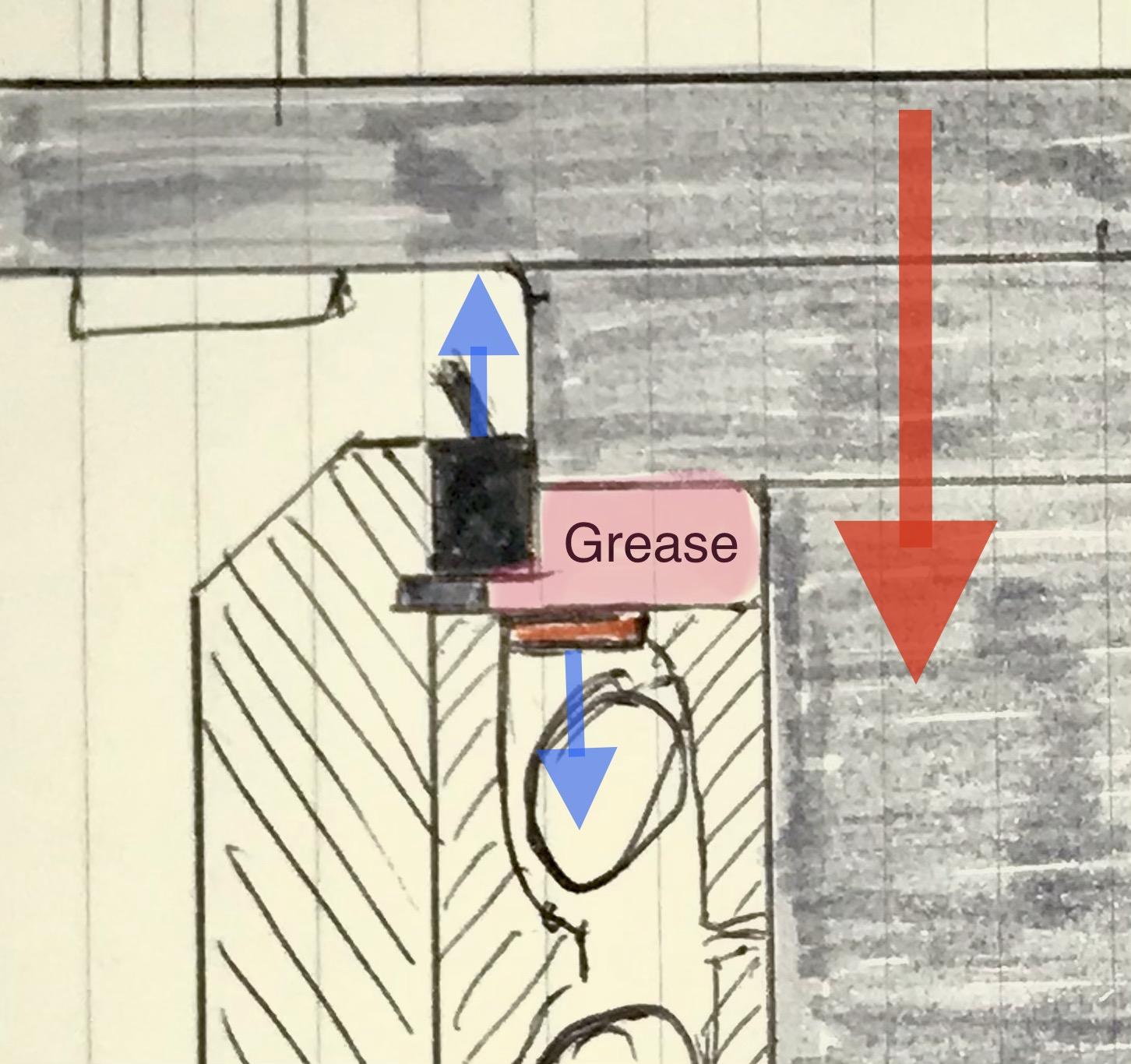

I cannot understand how too much grease is really going to cause this system to overheat.

PostPosted: Sun Jan 17, 2021 9:40 pm    Post subject: Re: Hot lug nuts and hub after Syncro front end rebuild Reply with quote
I’m thinking the excessive grease on the outside of the bearing was getting pushed around when pressing the wheel hub into place. I suspect the grease pushed the outer seal outward ever so slightly as the hub kept moving inward. The wheel hub eventually met the bearing seal, which is pretty stiff and I believe has an internal metal ring. Then it became a fight between the metal wheel hub pushing onto the bearing seal and the plastic protection on the side of the bearing itself resisting. As more pressure was applied with the press, I bet the outer seal and its internal metal ring won the strength fight and was able to keep the grease inside the assembly. Since the grease itself can’t compress and probably wouldn’t seep out of the seal while the hub could still move inward, the outer plastic cage of the bearing itself was the next weak link and got pushed against the bearing balls.
At least that’s what I’ve been thinking since I first remembered I put grease in there, especially when it was pointed out that the grease was unnecessary. Here are drawings I made that might illustrate this:

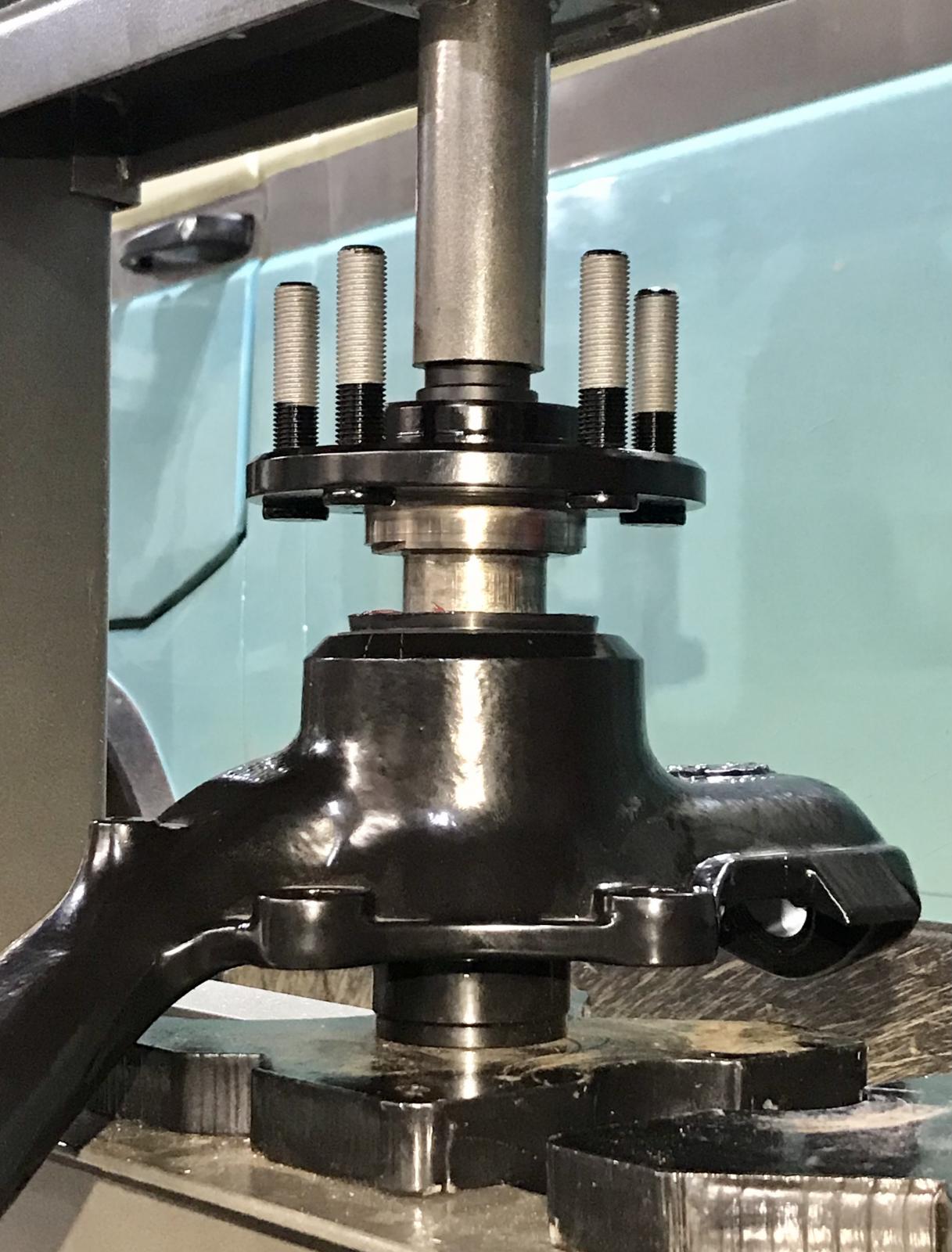

Good shop practice demands that the part of the bearing you are pressing be supported.
When you press the bearing into the knuckle, you are clearly pressing the outside large diameter edge as you do so...... BRAVO! Excellent job!
You then show pressing the hub into the center of the bearing, and here is my question, on the backside, down against the table do you have a pipe, a block, a something that supports the inner race as the hub is pressed down into it?
If yes, I'll shut up, fold my hands and continue to watch this riddle get solved.
If no, then I'll say that this assembly mistake probably is not your friction but I will say you damaged your bearing during assembly.
Look up BRINELLING in bearings, not usually immediate bearing death but......
The possibility also exists something may have chipped or cracked with the extreme unsupported stresses incurred.
Thanks Dave! Yes the inner race of the bearing was supported when I pressed the hub back into the steering knuckle. As a matter of fact, it was challenging to find the right combo of tubes and blocks to support it! I’m glad we got all the adapters from harbor freight!
I’ll look into brinelling and see how that could apply here. I think it’s what’s happening to our outer CV joints but not sure about a new bearing.

In that photo before you press the hub into the bearing, the entire outer bore seems to be filled with grease. Seeing a part pressed into a fixed volume with all that grease makes me wonder if its possible that when you pressed the hub in all the extra grease had no where to go and took out the bearing seals. I know that ball bearings are sensitive to lubrication and its possible that with a damaged seal the bearing could overheat.
Disclaimer: I havent gotten around to reassembling my bearings yet so i am not sure how much room there is in there for that grease.
I am impressed with how deep you have dug into this issue, Personally i would dissemble and put new bearings in without all that grease. Syncro hubs are exponentially more expensive than the bearings and if a shop did this work you would probably expect them to replace. Hopefully disassembly will reveal the "smoking gun"
