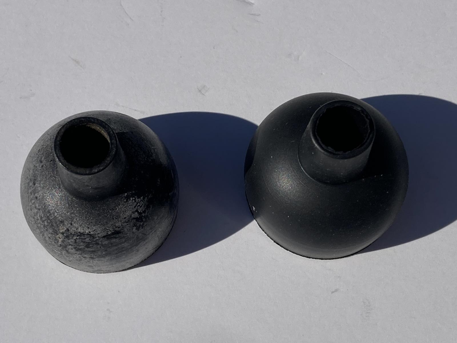

Question about this small rubber boot in the passenger lower front fender area behind the splash guard where the wire harness comes out of the tube in the heater channel and runs up the fender behind the splash guard and into the front trunk area. Didn't see this rubber noted in the Ghia diagrams and have not seen it in any parts list for my car. Any idea where to find it and if there is a part number for it that I can't find? It's for a 63 Ghia vert and I'm running a new wire harness for it. Found all the other grommets, but can't seem to find this small rubber boot. Appreciate any help you can provide.

The part number is 141 971 909
You will find it in the 58 low light parts book page 139 item 41
Grommet lower main harness
I looked at the more exotic supplier and none of them had it. It is a hard to find Ghia only part. I’d perfer to be wrong about that

You're not the only person looking for them..
https://www.thesamba.com/vw/classifieds/detail.php?id=2427346
You should contact Tylon and exchange notes on the topic

Trylon posted this as an option for the boot grommet for the wiring harness
Shifter boot
https://www.thesamba.com/vw/gallery/pix/2152186.jpg

A late style shift boot still seems to have the closest look.
I did just try on a 1966 vw bus shift rod boot and it fits nice.
I also tried on a boot from the vw aircooled master cylinder and it fit snug as well.
https://www.wolfsburgwest.com/cart/DetailsList.cfm?ID=211711183B

I have temporarily lost my original one. I think they were mouse grey in color
I did find something that looks very very similar when looking at my Porsche 911 from underneath. I have not ordered it yet, waiting to place an order for 356 parts. If anyone beats me to it, please let me know what you discover
Porsche Rubber Cable Boot Sleeve - 356BT6/356C/911/912 62-83 911-611-921-00 | Sierra Madre Collection | Porsche Parts and Accessories
https://share.google/AmWyzhlp7U7FeJn5j

That Porsche boot looks really close. I'm curious about the size too. Maybe I will order one to see. I have a good original one (I don't know how pliable it is though) in one of my parts boxes. I will try to find it in the next week or two. They were just black rubber.

There is also this Porsche boot that looks the same as the one you posted. It is cheaper and for the starter cable sleeve. Wish they posted dimensions

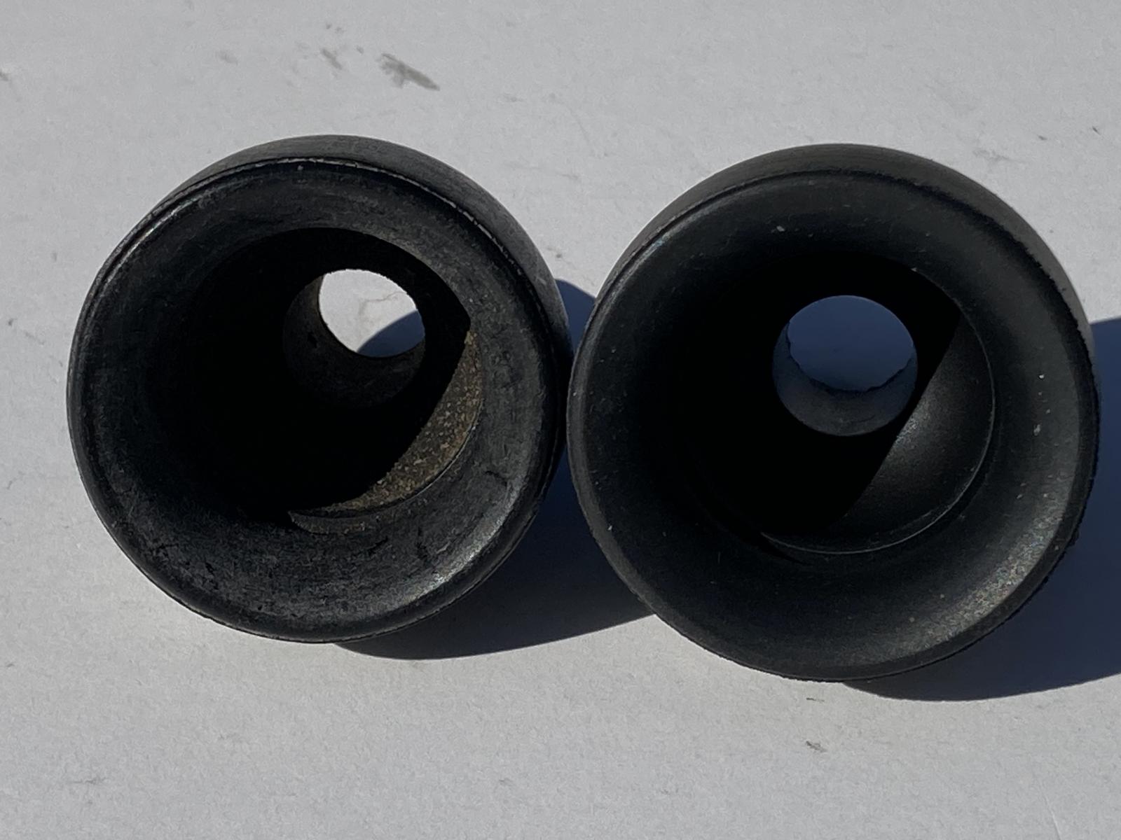

I dug through my parts bins and I found an original wiring loom boot. It appears to be NOS and in great condition. I ordered a Porsche rubber boot for the starter cable and it is the same boot! Here are some photos for comparison. The NOS boot is on the left and the new reproduction is on the right.
Here is the information for the one I bought from Pelican parts
