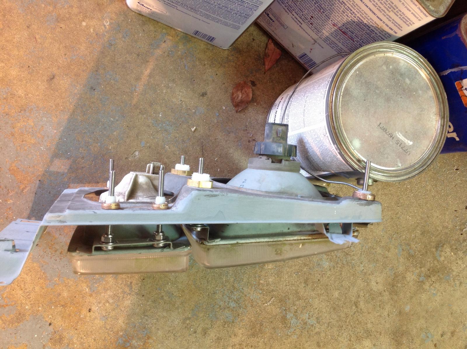

Here is my headlight adjuster fix. This is from my 86 build.
The final product ....... the screws were too long hence the various lengths this time.......
Entire procedure found here.........
https://www.thesamba.com/vw/forum/posting.php?mode=quote&p=6914933

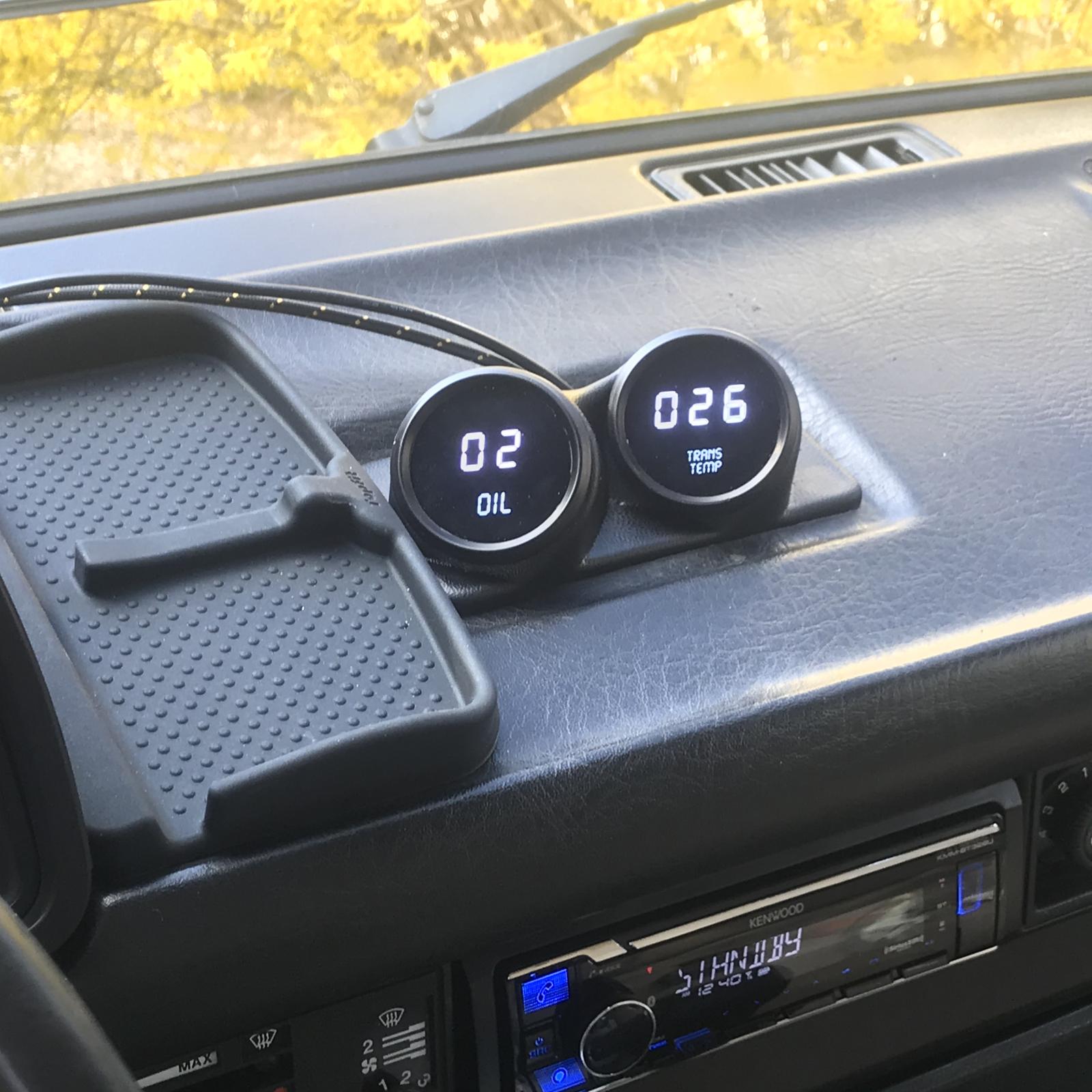

I installed my JEGS digital gauges. The Oil Pressure gauge is hooked up and works, the Auto Trans Temperature gauge is awaiting connection though it is powered.
I need to run the wire and I need to put a bung in the oil pan.
The digital gauge is SO NICE to have! No more guessing on oil pressure readings at the low squished end of a 100 lb scale!
First power up! Notice the USB cables to power the GPS and charge my phone coming out of the back of the gauge cluster. I just filed a small slot for them.
Cold Oil Pressure....... 10w40 Dino
After a reasonably long drive ...... hot idle, about 900 rpm ......
And you wonder why the Auto Trans temperature gauge doesn't work?
I didn't like the angle the gauges sat at.
I didn't want to mar the black finished surfaces so my bathroom chrome fixture wrench to the rescue!
Much more visually pleasing! Engine off, the gauge seems to like 02 psi.
The worst part of this gauge installation?
I had to remove the radio, it forgot EVERYTHING!
There goes an hour of my life setting the time
Setting the display colors
Recognizing my phone
Removing the demonstration mode
Setting speaker balance
Setting vehicle type
Setting the equalizer settings
Etc
Etc
Etc ........

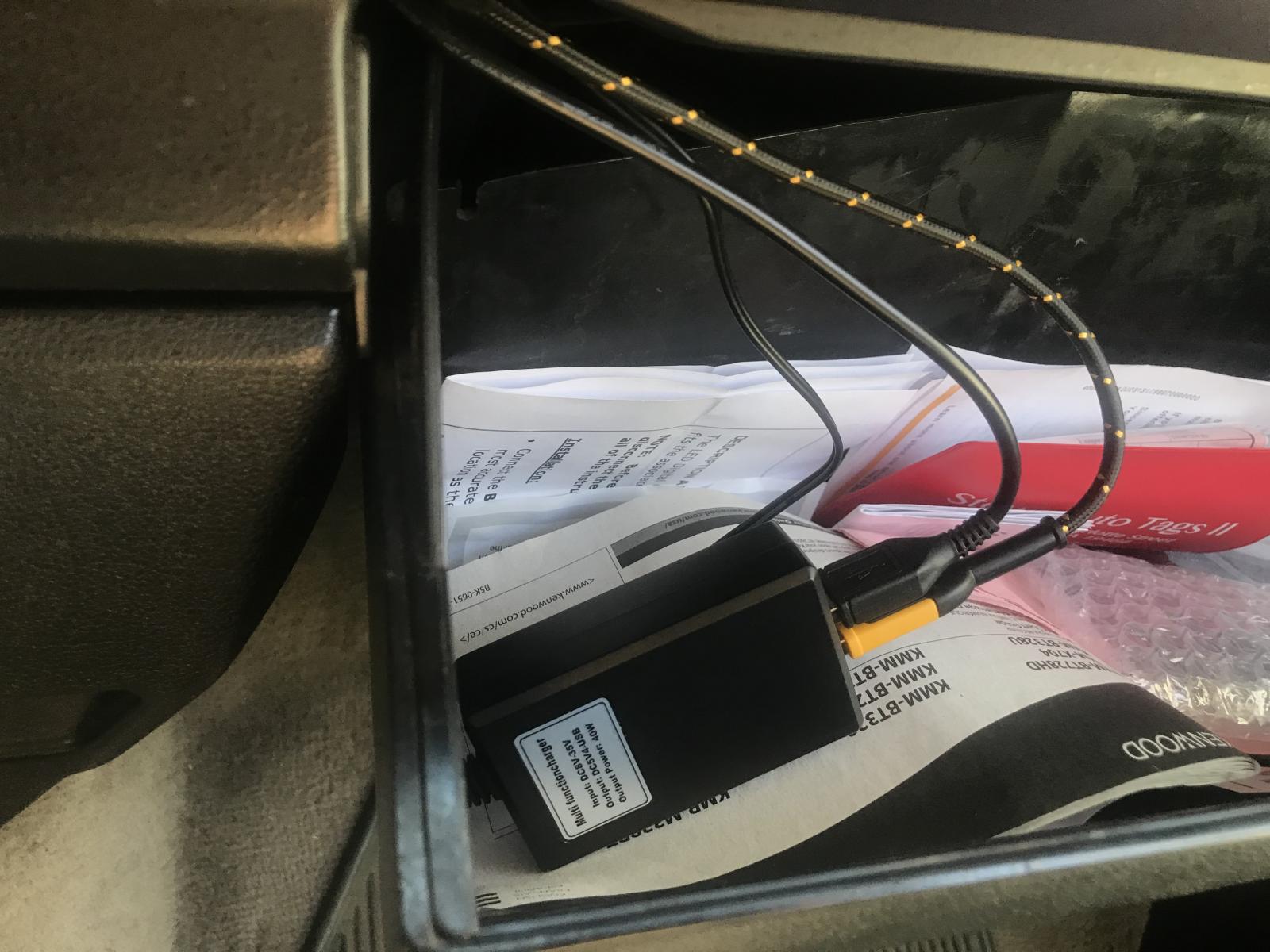

So yesterday I pulled the radio and properly installed my gauges and the gauge Pod.
Everything is back together, I programmed the radio again and started cleaning up and organizing in the garage.
In a little box I find my USB multi plug box!
Well...... what idiot forgot to wire this in while the dash was torn open?
Honestly, it really wasn't that difficult to tap into the ignition 12 volts and ground.
Now my wires are tucked away out of sight in the glove box.

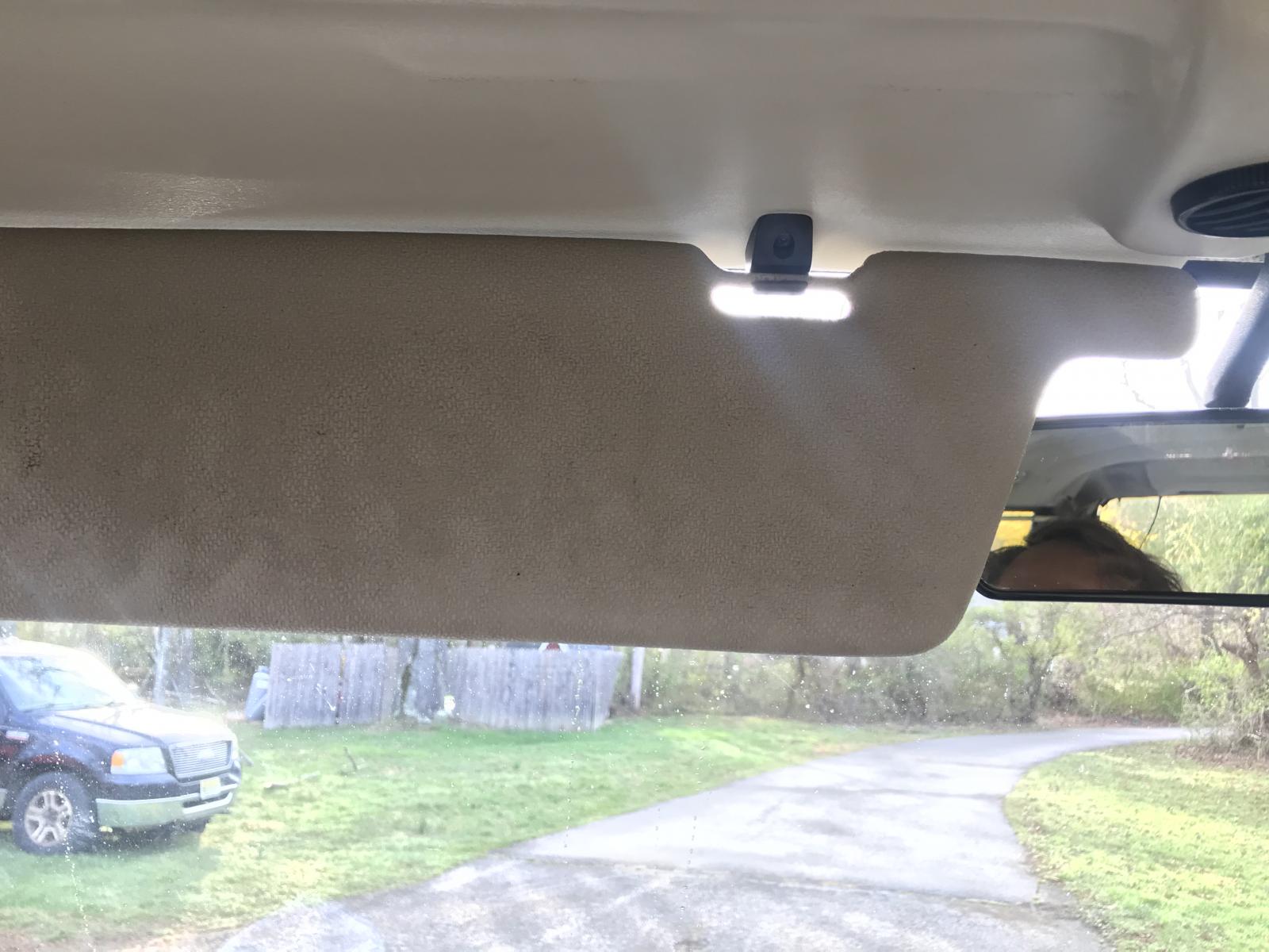

So what clever designer thought that it would be good to put a GIANT hole in the SunVisor?!
And then God goes and puts the Sun right there to blind you anyway!
