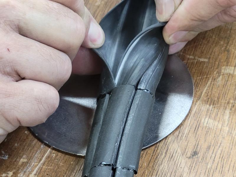

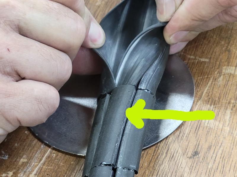

OK, done putting this off.
First, I think this is the frame for the right side?
Second, this is the channel that the frame fits into?
Here is a bit of my first attempt at putting the frame in.
Comments?
Max

Next question. Is this the slot for the "C" trim?
Max

PostPosted: Fri Jul 29, 2022 1:14 pm    Post subject: Re: Fastback Pop-out window seals Reply with quote
Should the ends of the frame wind up in the seal joints?
Max

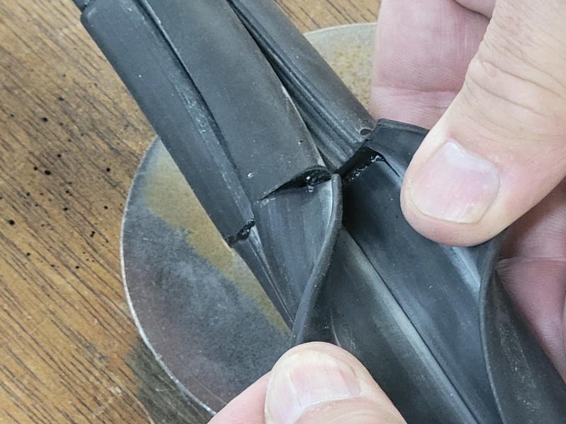

PostPosted: Sun Jul 31, 2022 12:54 pm    Post subject: Re: Fastback Pop-out window seals Reply with quote
Brent wrote:
Here's a shot of the U-channel that the frame goes into. Use some silicone spray and push it all the way in.
Brents pictures make it look like the end of the 2-inch section can be exposed in order to push the frame in.
Here's what mine looks like. Am I supposed to cut into the seal to expose the end of the 2-inch section?
Max

PostPosted: Mon Aug 01, 2022 5:36 pm    Post subject: Re: Fastback Pop-out window seals Reply with quote
OK, cutting the seal it is.
And sure enough, there's the U shaped channel.
Next ... find the correct end of the correct frame and slip it into the channel. Do that with both ends and put the frame into it's groove all the way around.
The window is inserted into the seal around the big end. Have to be careful with the tape because there's tint on the inside of the glass. I don't want the tape to pull the tint off.
I think I'll need to tape the rest of the way around before putting the trim in the seal and then roping it all into the car.
I think that's the order.
Max

PostPosted: Thu Aug 04, 2022 6:59 pm    Post subject: Re: Fastback Pop-out window seals Reply with quote
That worked OK.
The difference:
1) Carefully excavate the channel for the frame ends with a knife. I couldn't even see where that channel was without cutting.
2) Glue the glass into the forward part of the seal. This makes installing the trim easy-peasy.
However, the 3M adhesive is really tough to get off once it sets up. On the second window I'll clean up while it's still wet.
The left side window is ready to be roped in.
