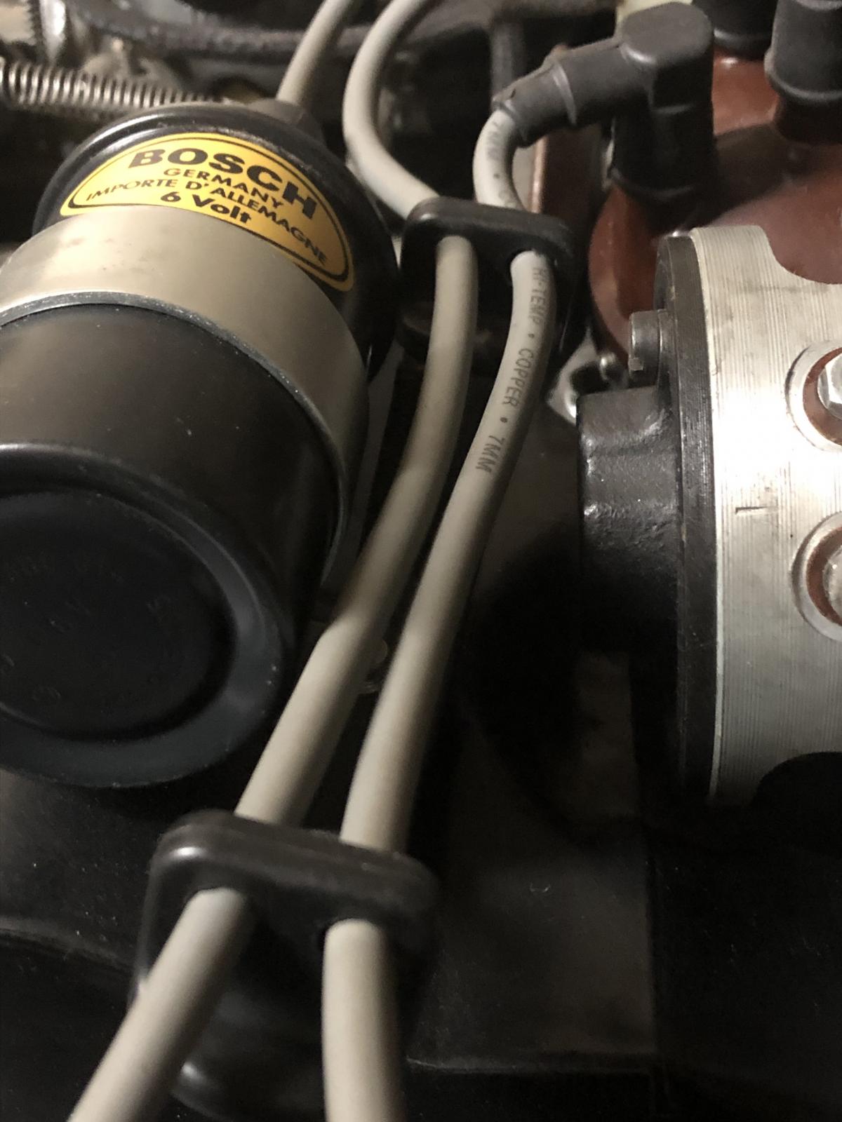

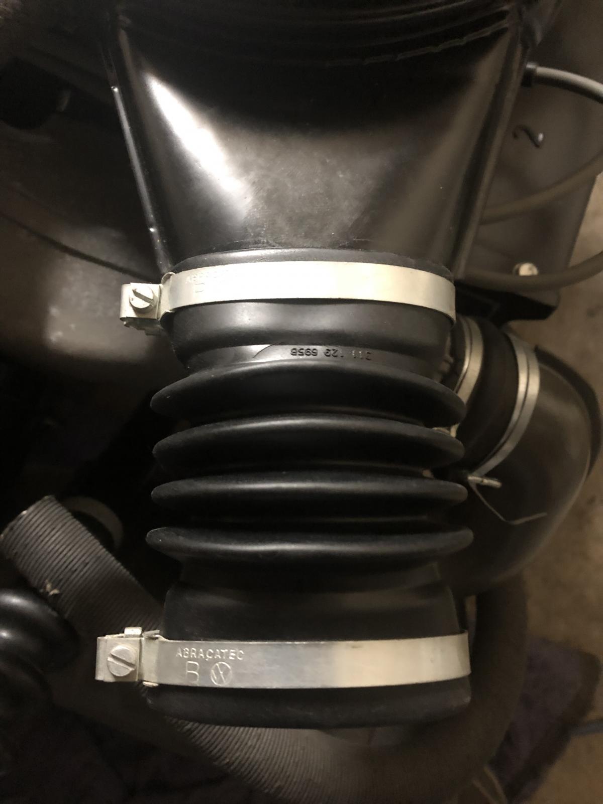

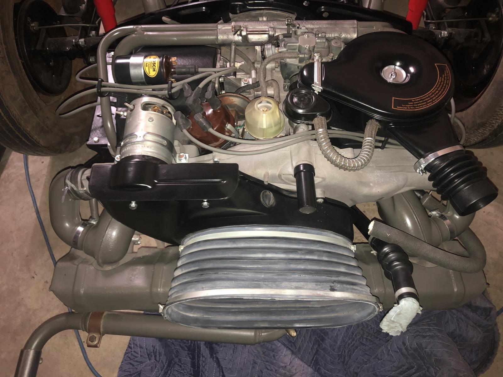

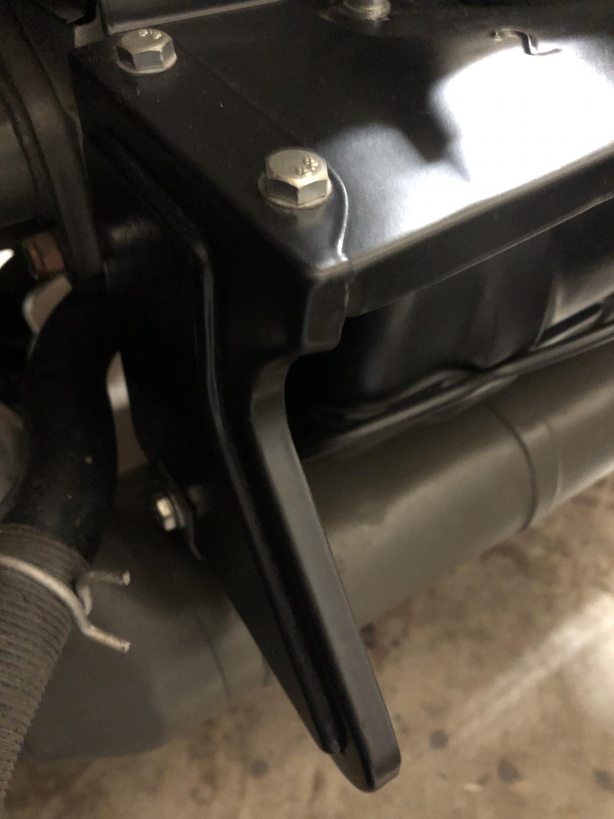

Engine Time😁
Here’s my Early 1962 Engine Looks
With so many RARE Early Unique Parts
Including the 61-62 BIG outher Fan with the 110mm belt
And the R6 BIG distributor
just a little upgrade with a 1600cc Long Block
Two Piece Oil Cooler with 1962 Unique One Piece Tin
BIG Cut Off Jet
NO FLAPS and you can see NO HOLES from the Rods
SUPER RARE Linkage with a PHN side-draft Carburetor
Early Engines came with these 211 Spark Plugs Holders
Not RARE but is a 4 Ribs Boot and NOT 2 Ribs
PreHeat Pipe
Two Piece Tin
Side-draft Thermostat
68 T34 1600 Automatic

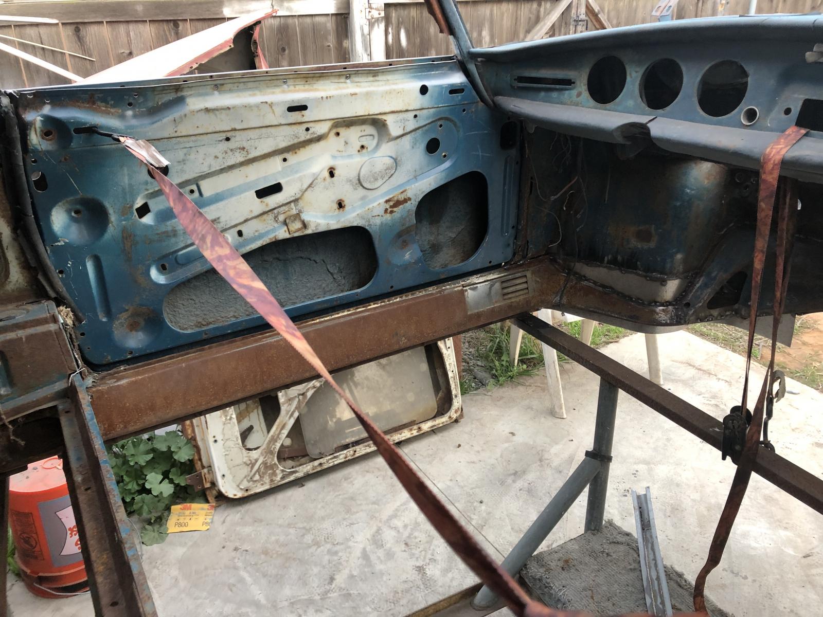

Patching Time

Gotta love how those big patches make small work of those holes. Laughing I find using big pieces makes short work of rust, kind of like doing full length floor pan sections, which you've already done. Cool The inside of that forward rocker/foot well support looks nice and solid too. Are you going to seal it in some sort of paint while you still have access to the inside? Looking up my friend, looking good. Cool

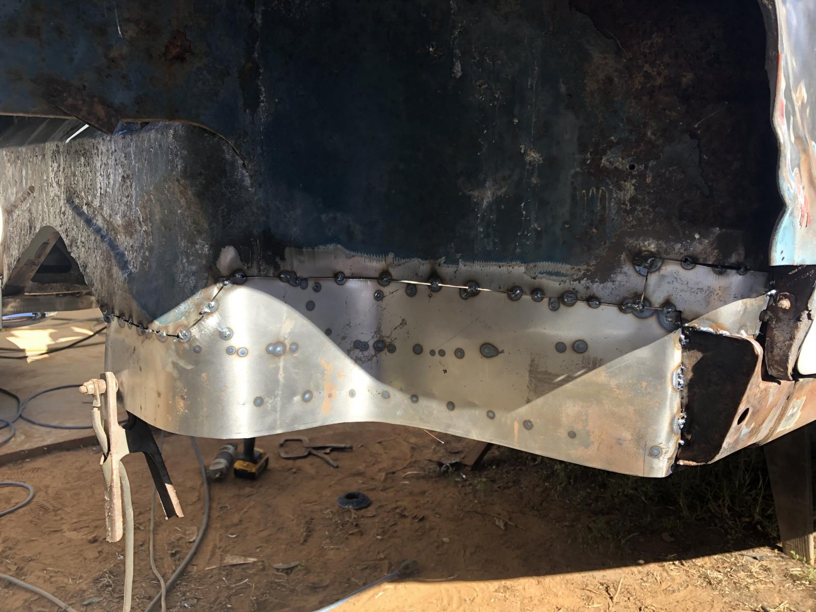

Patching Time Left Side 😁
And MORE patching to come😜

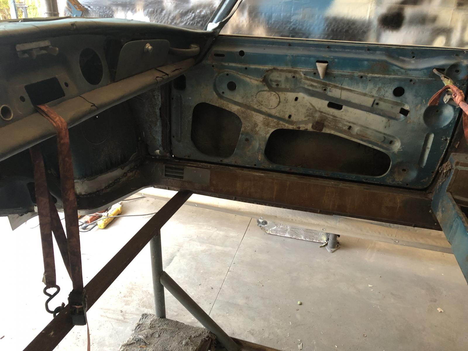

PostPosted: Sat Dec 03, 2022 5:57 pm    Post subject: Re: Pedro’s 1962 T34 Cabriolet Prototype Build Reply with quote
Reinforcement Phase 1
3 inch wide X 3/16 Flat Bar Welded L shape
To Bottom of Rocker and other End is Behind the B pillar Door
For Stiffness

notchboy
Joined: April 27, 2002
Posts: 22659
Location: Escondido CA
notchboy is offline
PostPosted: Sun Dec 04, 2022 10:42 am    Post subject: Re: Pedro’s 1962 T34 Cabriolet Prototype Build Reply with quote
This should be a runner by next week. Cool

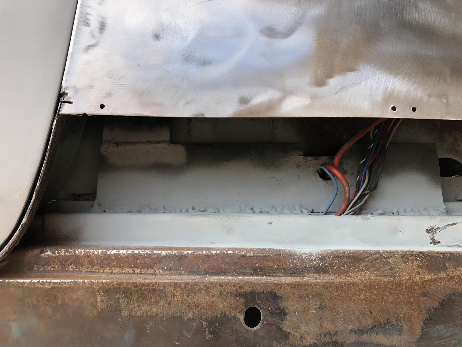

PostPosted: Sun Jan 15, 2023 7:56 pm    Post subject: Re: Pedro’s 1962 T34 Cabriolet Prototype Build Reply with quote
Rear Sección Fitted
When I separated the Pan
Basically that sección was GONE
The more I was digging I was finding MORE rust
Takes a Lot of Measurements different directions
To be accurate 😊

ibjack
Joined: February 06, 2002
Posts: 2115
Location: Imperial Beach CA
ibjack is offline
PostPosted: Sun Jan 15, 2023 10:53 pm    Post subject: Re: Pedro’s 1962 T34 Cabriolet Prototype Build Reply with quote
pedro sainz wrote:
Rear Sección Fitted
To be accurate 😊
replacing this piece was a work of magic. great progress amigo

pedro sainz wrote:
Rear Sección Fitted
To be accurate 😊
Yup, my 64 T-34 was gone there too. I replaced it with a piece I got from OFC Doug in Illinois. That same car gave up the rear engine surround to Lee Hedges.

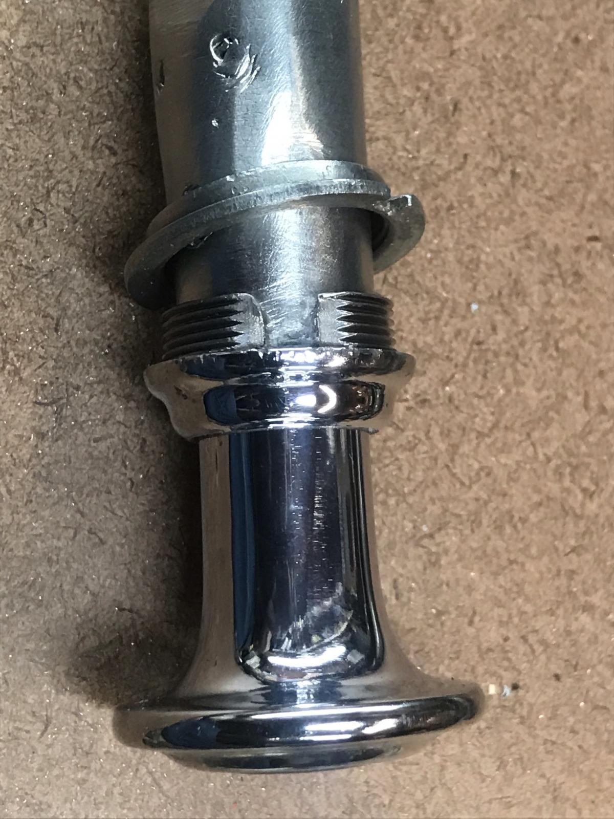

PostPosted: Tue Jan 17, 2023 9:37 pm    Post subject: Re: Pedro’s 1962 T34 Cabriolet Prototype Build Reply with quote
Here’s A COOL item
T34s Cabríos have a Hood Key Lock too
Similar of a T14 but NOT the SAME
This is install differently with thread and Nut
Since this a So Unique Part
Don’t expect will be Find either
So I fabricate one
From a NOS T14 hood lock I did some Shaving Shaping Threading and using also a BIG Early Type 34 button as Part and here’s my Final Product
