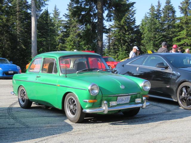

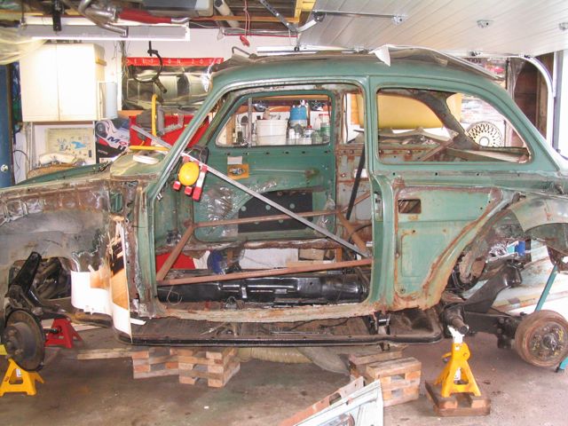

I have been working on the restoration of a 1965 notchback that I bought as a father-son project. The car turned out to be in much worse shape than we originally thought and so a different notchback was built for my son. Since I still had the original, I decided to restore it. I have shared some of the details with folks on this site and it was suggested that readers of this forum might be interested. So, here are a sequence of photos that document some of the work. I hope that you enjoy it.
The first look as I found it = I think that I will name her Lizzie- it is a 1965 sunroof notch
A 1500 single carbed motor
But, some rust
Lots of rust

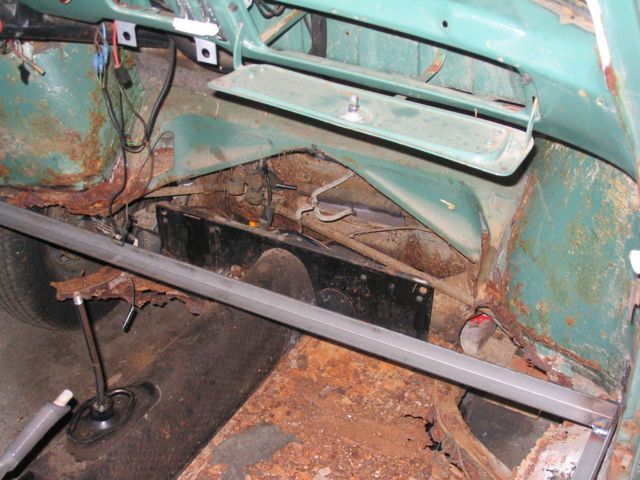

And some suspicious wiring

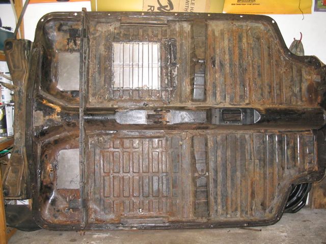

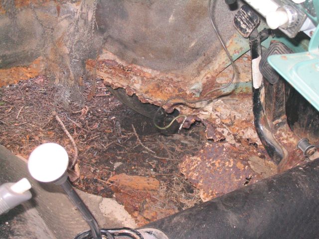

I decided to reinforce the shell before removing anything - see no floor on the driver's side

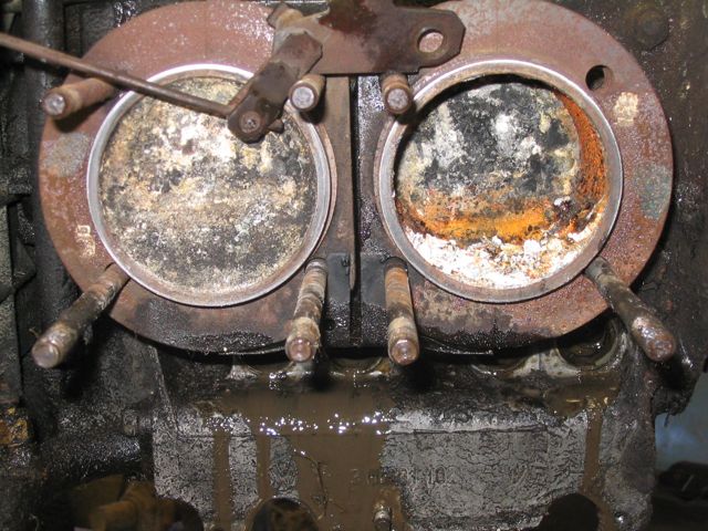

Pulled the engine
only to discover it was full of water
that dissolved the case
Sourced a pan from the DDB
did some patch work
added Por-15

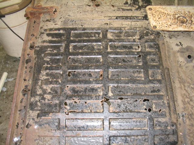

And went back to the body to look at rust - that's where the sunroof drains
I decided to cut off the bottom portion of the car
gone
and welded a donated section from a squareback into place
And took a break, feeling pretty good about this...

That engine case is nasty, I can see one of the studs is about to fall out..

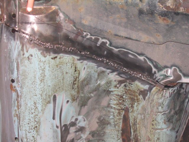

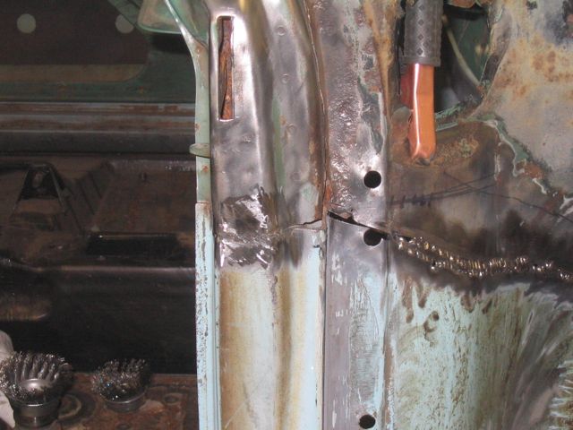

So, the story continues. Bob, thanks for letting me use a version of your thread title - it seemed appropriate. Now that the original upper body was tacked to the new lower body, I had to go around and weld, sometimes on difficult, complex curves. And while I tried to cut away all the rotten rusty metal, I had to remember that with this age of car the metal thickness varied, and so sometimes the metal was thin and I would burn through and other times it was easy to weld. For example, this is along the front inner fender area
the door post
Once the main welding was done I look at other areas and could not help but notice the front clip was in trouble...

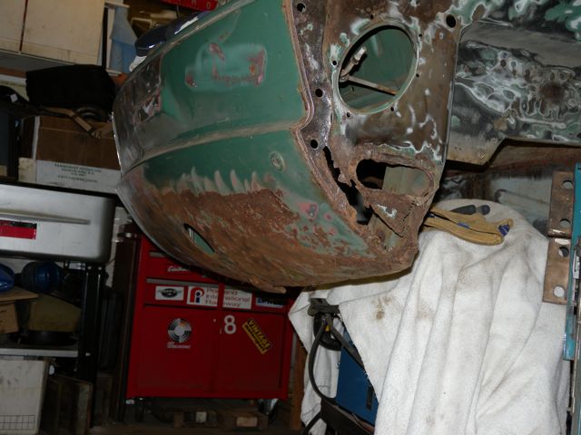

I drilled out the spot welds and removed it (what else could I do?).

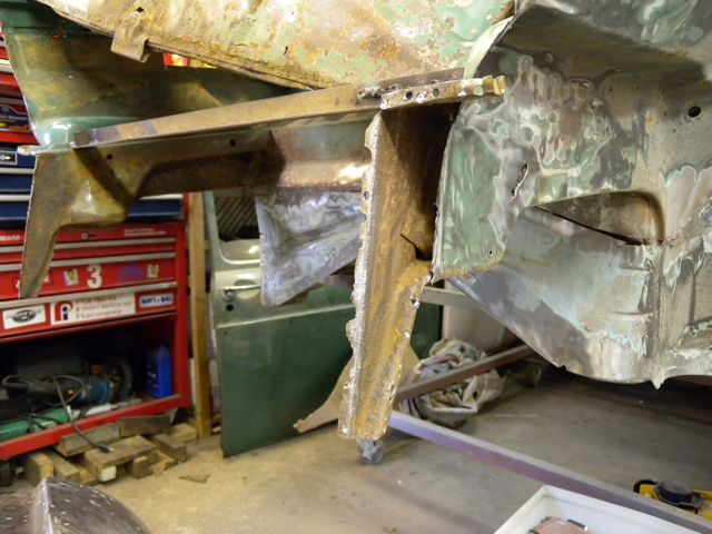

I found another nose section and welded it in place
Some fabrication was necessary for the rear inner fender wells.

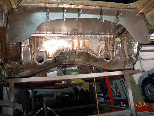

a new section behind the rear seat
and a new firewall (actually, I am not sure if we call this a firewall but they do in hotrods)
