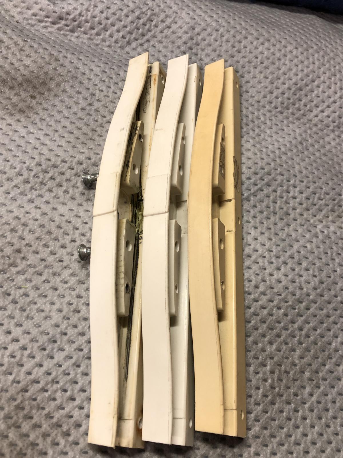

...and two slightly different top metal plates.
And both of yours have 2 tabs, compared to mine of which only 1 plate has 2 tabs.
It's also supposed to be for a 65 too.
I ended up using the one tab one on my car.
And I re-installed the original 2 tab in mine to make it work.

Here are some of the different lowers I ran into, all with a type 3 part number.
and this is some's attempt at tensioning the cables, I assume it worked as I removed it from a late working sunroof car.

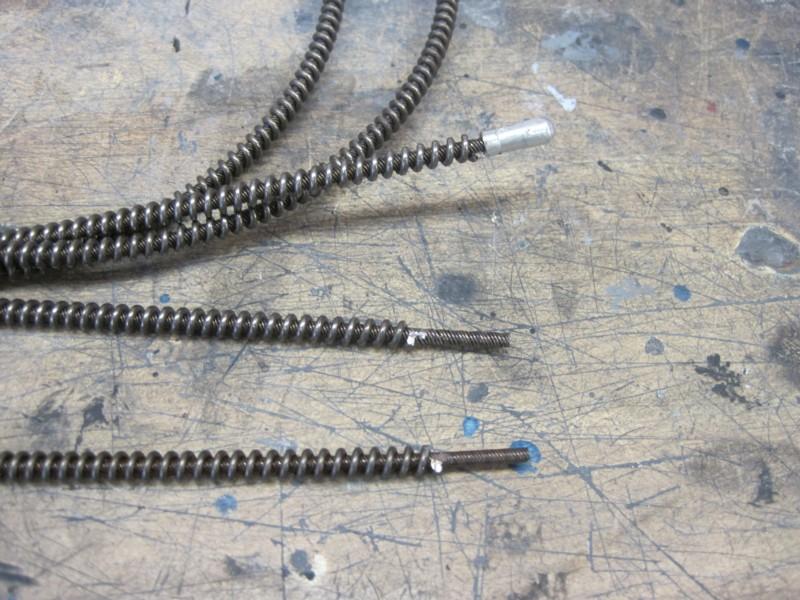

W1K1 wrote:
Just a heads up, have a local truck shop that does custom crimped control cables of all sizes, types, and ends. You may have someone in your neighborhood that does similar stuff for those oddball cable repairs instead of inferior repop parts.
The bus cable itself works just fine, but it's too long. The metal spiral around the outside IS what does the work, as it meshes with the drive gear. The metal tabs on the shim plate help the cable engage into the drive gear. What the inner cables job (that 1/2 inch where I removed the spiral), actually does, is pull/push the rear anchor point (the flipper) forward and backward. The spiral part does spin some too, but not as much as you'd think. I say that, as the inner spins with it.
As for having a truck shop or cable shop add an end, that would be great, but I got the cables on saturday, and installed them on sunday, and nobody around here was open on the weekend that does that sort of thing. Rolling Eyes Now that I know what was wrong with my sunroof set up, I could have the ends fixed correctly, and or maybe re-install my old cables.
Now that I know how the cable set up works, I might be able to replace my original cables too (been thinking about it). Not for sure it can be done, but I do think it's possible. The bus cables were originally from EIS parts, that the Bus Depot sells. I might try and contact them to see about just buying the cable itself, then it would be possible to "re-cable" your sunroof cables.
My son suggested trying some Rabbit/Jetta cables, since it uses a similar set up (might be closer to the same size too). But, I don't know who actually sells rabbit/Jetta parts, other than the Parts Place, but I never saw them listed in their catalog.

Well, I did get the air boxes sandblasted, primed, and painted last week. I also glued on some seals, and finally got them installed. While I had them apart, I added some truck bed to cap sealer foam to the flap pcs (like I did on the T-34). Hopefully that should keep them from leaking in the rain.
Once they got installed, it was time for the wiper motor assembly, since the air boxes are the 1st parts in, and the last parts out. The windshield squirter also got hosed and installed along with the middle heater outlet and it's tubing.

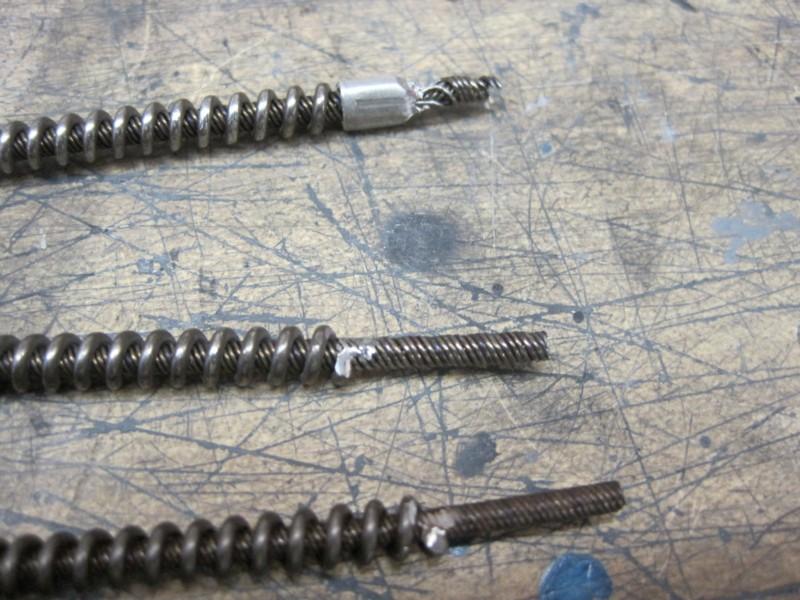

Any way, last saturday I worked on installing the sunroof. What I found once everything was back together, felt like the cables were worn out (I did see some worn flat spots too). So, I ordered up a pair of bus cables from the Bus Depot (in PA). These are for a 68 to 79 bus, and were reasonably priced. They are also 101 inches long (t-3's are 52 3/8ths inches long), so I had to cut them down (modify them for t-3 use).
Here's the first mod to them. The full length wouldn't fit in the pic. Wink
(step 1 cut to new length)
(here's the cut off pc with the shortened pcs)
(this shows the end on the bus cable, and my mod to be able to install some sort of end like they did)
showing the cable mod (step 2) I used the cut off pc as a sample for ideas.
What I used for the end.(step 3)
trimed and ready for install (step 4)
Ok, so they got installed, and I thought I would be good to go, EXCEPT, the left side was working fine, but the right side just sat there and didn't move. WTF?? So I pulled the center parts out (under the top center cover), and then found my old parts (65 vintage), so I could compare them. Here's 2 pics of what I found. Can you spot the difference?
It's the cable shim tab that's missing. Shocked Needless to say this is an ISP part, and I wondered why it looked used when I took it out of the bag (you can see the fresh rust on it where the cable rides). d'oh! Brick wall I'm guessing someone tried to use this part before me, found it wouldn't work, and returned it, then ISP re-sold it (to me). Rolling Eyes I swear to gawd that they are just sending out junk with no quality control. Evil or Very Mad
Once I installed my old shim plate, the sunroof started working correctly. Cool Hell, maybe my old cables would have still worked, had I gotten a GOOD part. Shocked Looks like I'll be looking thru Wolfsburg West's, and Airhead Parts's catalogs tonite, and see about getting another NEW shim plate.
As much as I need a couple of parts from ISP, I'm done with buying from them. Evil or Very Mad
