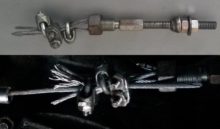

I am at 50,000 + miles on this set up. Same cable, same clamps, same wing nut. 2 different transaxle configurations. I do silver solder the ends of the cable so they do not frey and the silver gives the clamps something to "bite" into and not slip. This same set up will get driven across the US again and race the April NORRA 1000 this year.
I still carry a spare cable everywhere I go.
Update. Cable now has over 62,000 miles and the NORRA race on it. Do have to state that I use the Classic Bug Parts front Big Foot extender with he bushed roller tip to help save the front stock loop.

...I used the shortener that bends the cable over and a nut tightens up against it. That broke in 3 months...
Me too. Mine broke while in the parking lot of Lowe's home improvement store. So I had a store full of things like threaded rod, long nuts, and good strong but also flexible garage door opener cable. Did the fix right there in the parking lot. That was 1999 and this rig is still holding today.
Well, that rig finally broke. And again, it happen'd in a parking lot where I fix'd it with an upgraded rig. Not as elegant as what @saw2 came up with (earlier in this thread), but probably will last. Used an eye bolt this time, along with the smooth end loop guide that came with the little cable clamps, completely doing away with all parts of the old cable shortening kit:
