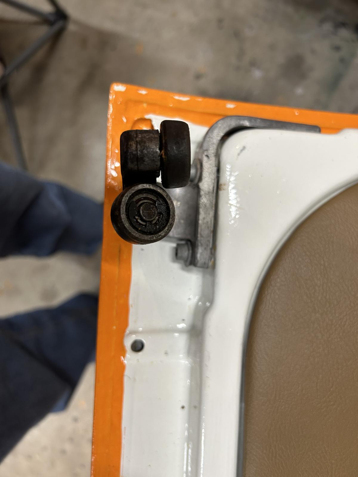

PostPosted: Sat Jan 06, 2024 11:43 am    Post subject: Re: Let the process of saving 2222069996 begin Reply with quote
Saw these on some Brazil busses. I like them. Bus Depot has them and they admit to low quality.... but $50 each is better than the $300 for the VW ones. Will be installing them today.
They will be much larger. I do like the look of the Old School mirrors, but these will be more functional, right?
You can see that the sliding door bracket cover is off in these pix. I was waiting on parts to repair the door. I basically locked it, so only I would be the one to open it. The bottom rollers were worn enough to allow them to pop out. With the cover off, I could re-install all the rollers much easier, even by myself, but that door is HEAVY.
All fixed up now.

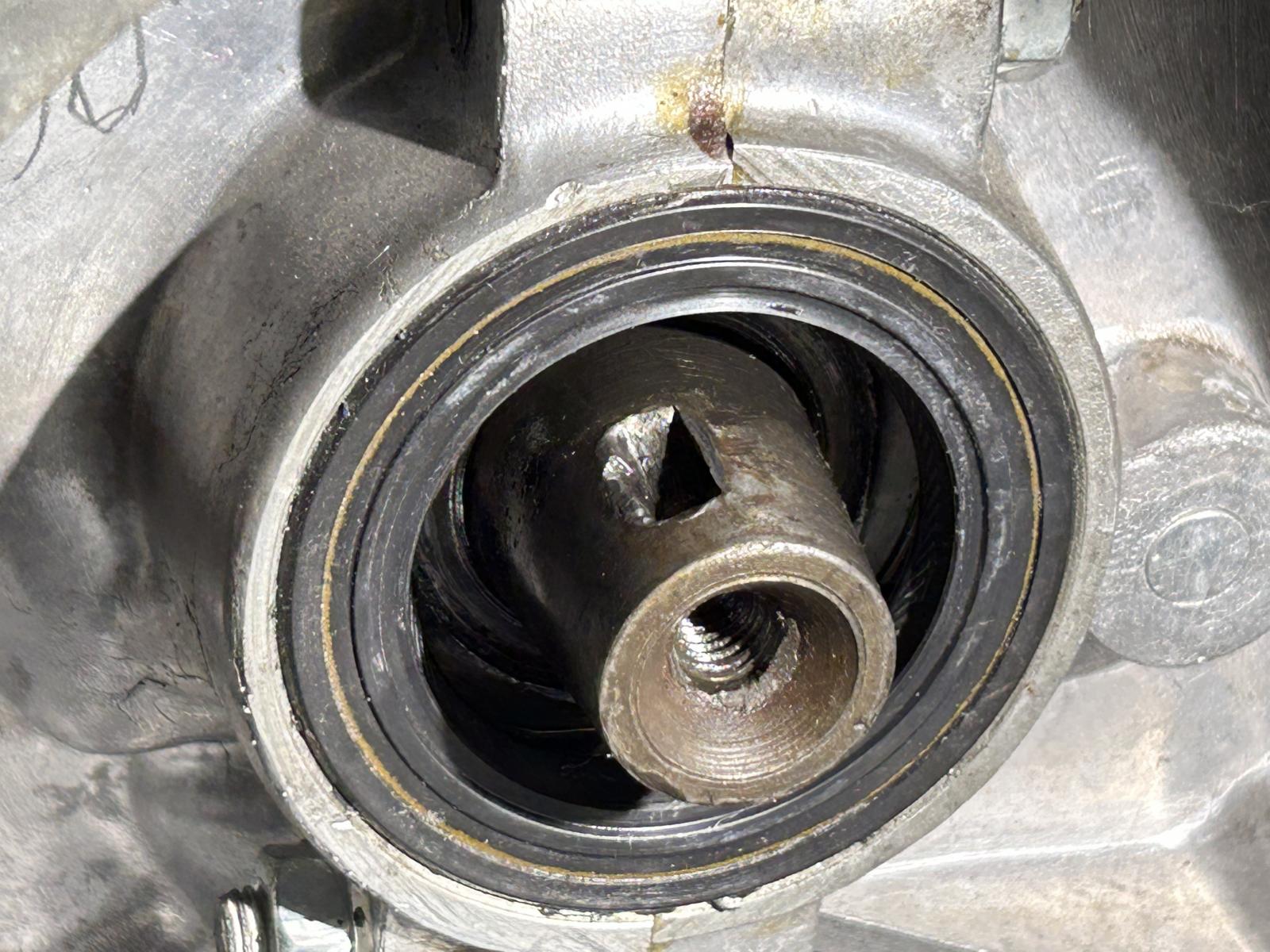

Next came SHIFTER. It is yet to be solved....
I had this NON-ALIGNMENT... wiggled the engine-trans assembly and got it to this point. Not sure I am gonna do better. But it is concerning, given the issues that follow.
I removed the bellows as the grub screw pinches it and makes it impossible to shift.... it is at least one thing that makes it impossible.
