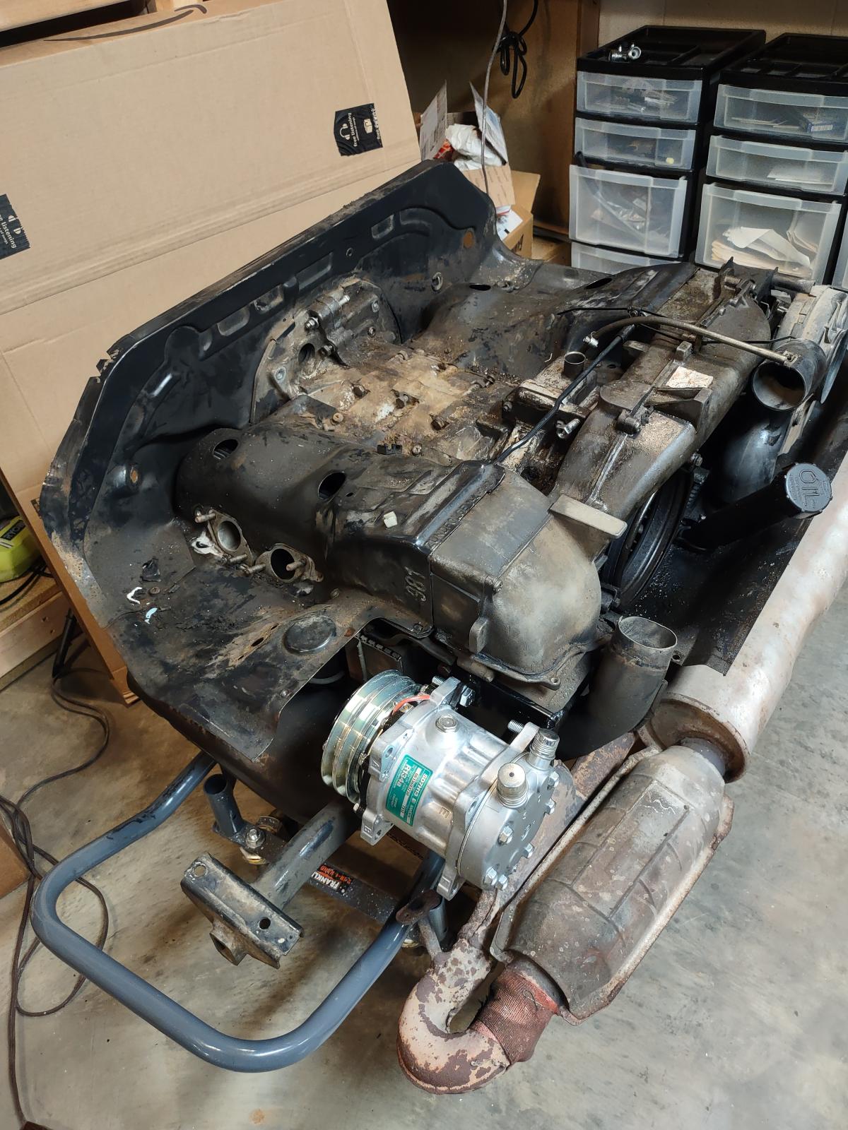

They sell flat aluminum stock at home Depot. About $10 for a 2x3 piece. Easy to cut and form. Won't rust. Drill and screw in place.
Consider a mount and compressor from Gilmore Enterprises. Here's what it looks like on mine.

PostPosted: Tue Jun 18, 2024 9:00 am    Post subject: Re: Air Cooled Vanagon with Factory Air Conditioner Reply with quote
Mine is all R134a. All aftermarket.
I think all you need to do is change the expansion valve. There are different fittings to connect gauges which should be changed with the compressor.
I'd also change the condenser to a new design parallel flow. You'll need a new receiver-dryer too.
The mount Gilmore makes is for a 79 bay window. The fan housing is different. I purchased some spacers and bolts to accommodate the Vanagon fan housing.
