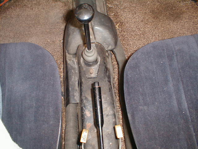

Here is a photo with captions of the BN4 heater switches courtesy of Captian Spalding...
Captain Spalding wrote:
Better than a thousand words:
I'm not sure where to get the switches. They are becoming more and more rare. Try the usual suspects: Samba classifieds, German Motor Works, Thing Shop, Kubelmann, etc. The timer switch will be easier, it's the thermostat cable that might take some hunting. Don't be discouraged though. When the BN4 works, it works GREAT!

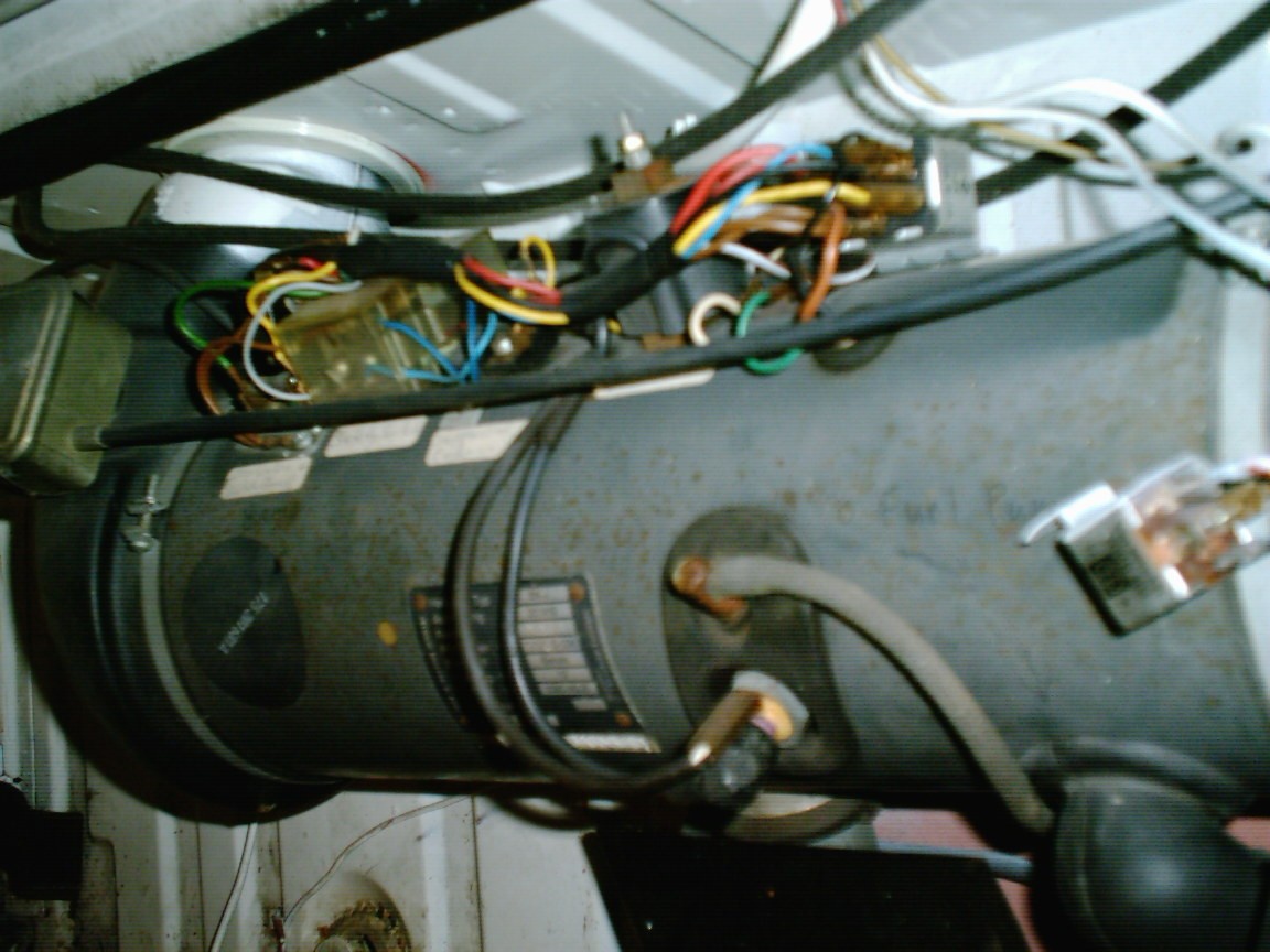

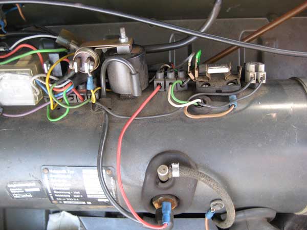

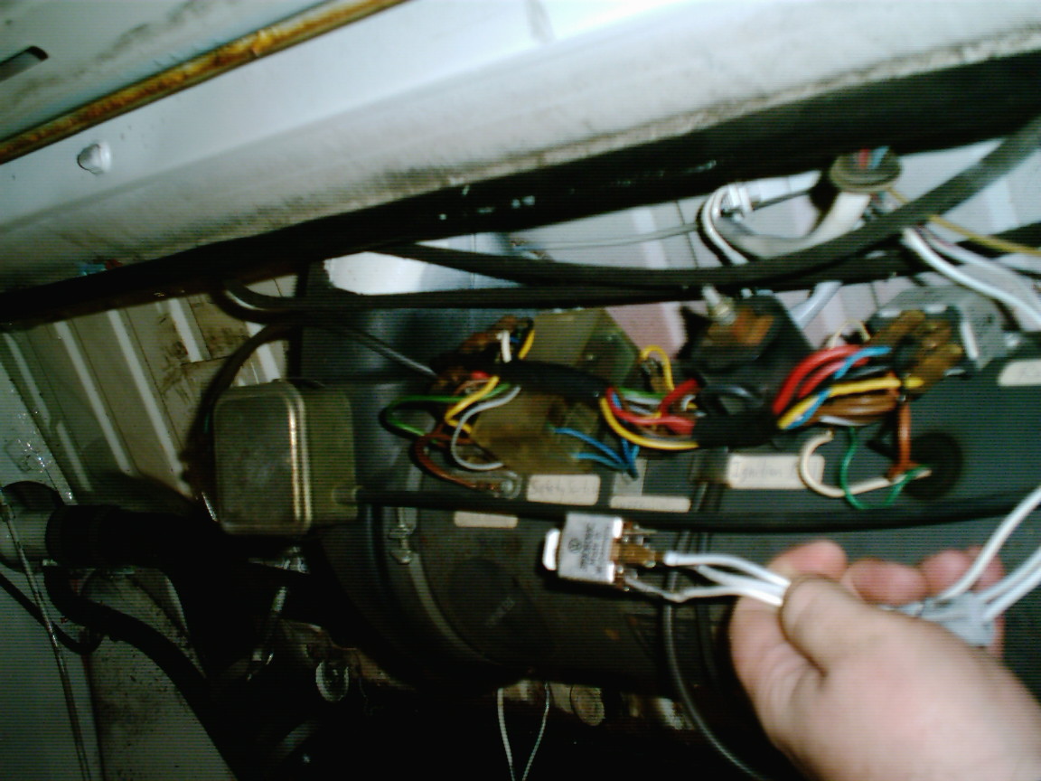

A few more detail photos of the BN4 gas heater from the Thing Gallery...
Note, if anyone can submit better (more in focus) photos of the wiring on the heater itself I will replace these...
Here are two photos showing two different Eberspächer heaters.
Top: Eberspächer BN 4
Bottom: Eberspächer B1 LC
Again, thanks to Captain Spalding for the photos.

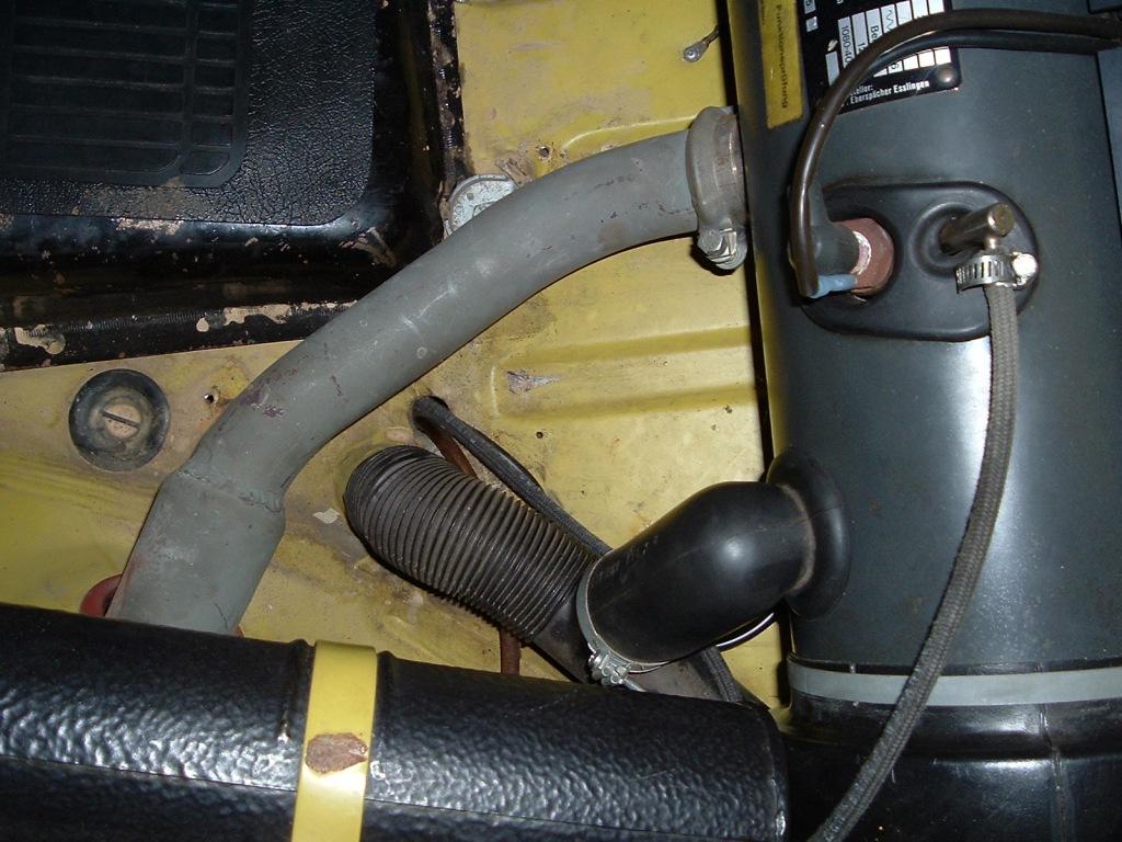

1974 Heating FAQs
Heater Boxes/ exchangers

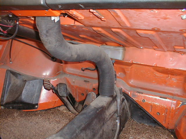

A topic dealing with the heater hoses that connect the fan shroud to the muffler...
http://www.thesamba.com/vw/forum/viewtopic.php?t=321077

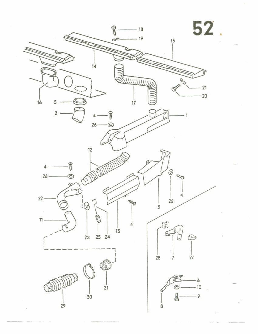

Diagram of the ductwork...
Photos of stock '74 duct work courtesy of emersonbiggins...

hi there, been thu most of the info on this thread, VERY helpful!!!
just one minor question....
i cant find any details regarding the wiring up fuse board end.... heres my problem.....
my military trekker has 2 fuse boards, curently theres only the big red from the starter motor doign anything on that 2nd fuse board, so off the big white plug for the heaters wires it goes into the fuse board but dosnt connect in the board where any power is....
ive got the big red one going to the first fuse on the right on the 2nd fuse board, this is the main live one, this has 2 fat red wires going off to power the normal 1st fuse board for all the other standard wiring lights etc....
then ive gotta connect the smaller black wire to the 3rd terminal along on the 2nd fuse board,... thats all fine but at the moment ive got nothing going in or out of that fuse board other than the main live...
this is how my 2nd fuse board looks, except now its got the far red going to the 1st fuse, where them big red's are going in etc...
has anyone got any info one this? im gonna go have a look for a colour wiring diagram for the military style trekker, because i went off of a civilian trekker wiring diagram for all the rest...
also does it matter which way round the fuel pump terminals are wired? im guessing if its incorrect it'll pump the wrong way?? there are no markings, on it..
the wires ive got are a brown and a green, as per drawing... ive just put em on at the mo, i can swap em...
Also, once i have this thing wired up, and ive connected the fuel line, whats the correct method of ignition??
im guessing i turn the green 'egg timer' knob on the dash, then wind it a little, then it should fire? what about the first time, ie should i try and bleed the fuel to the pump, or with it be fine pulling it thu the lines etc?? also ive got a 'choke' style knob, which i guess you pull for more heat?? can i pull this straight away???
So has anyone got any pics off the 2nd fuse board in situ with that dash panel flipped down, one pic showing where the wires are coming and going should help me out no end!!!
cheers for any info!
alex
alex
have the same problem right now... the big red was not in place and now I don't know where to connect it... :S
