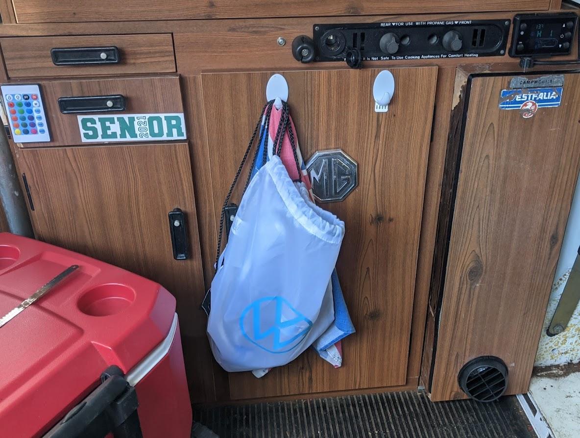

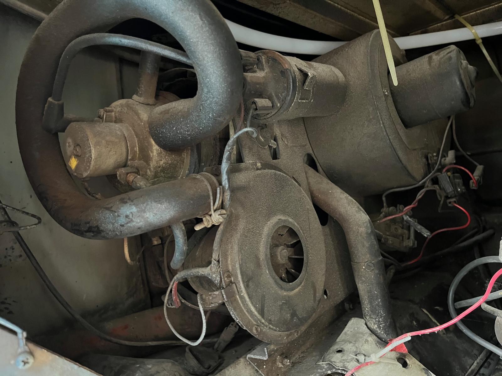

Well, the day has finally come. I've talked my wife out of camping in our RV and finally got her back in the bus (a regular occurrence pre-kids, but it's been nearly 4 years). When we slept in the bus (1968 tin-top Westy) it was chilly but manageable with enough blankets.
However, we're now going to be camping with our nearly-4 and 2 year old and temperature is a bit more of a concern. The plan is to put the 4 year old on the kids cot over the front seats, the 2 year old on the back bed, and my wife and I on a bed in the ARB awning tent. So the question is, what do people do for heat?
We have a small electric heater we could plug into our Goal Zero, but it doesn't last long due to the power draw. We also have a small propane heater, but obviously we'd not be able to leave that on unattended. The bus also has a heater unit in the engine compartment which I've always been too scared to mess with. It looks to be in good shape but I've never given it a go.

I’d be running that gas heater.

The gas heaters are great when they're working properly. You might as well see if you can make it work, but if it ends up being more work than it's worth, check out the diesel heaters like TheRustyRabbit mentioned. Theres a really long thread on them in the Vanagon forum:
https://www.thesamba.com/vw/forum/viewtopic.php?t=703569&highlight=chinese+diesel
I just installed one in my Bus and I'm blown away at how much heat it gives off. And best of all, they're under $200.

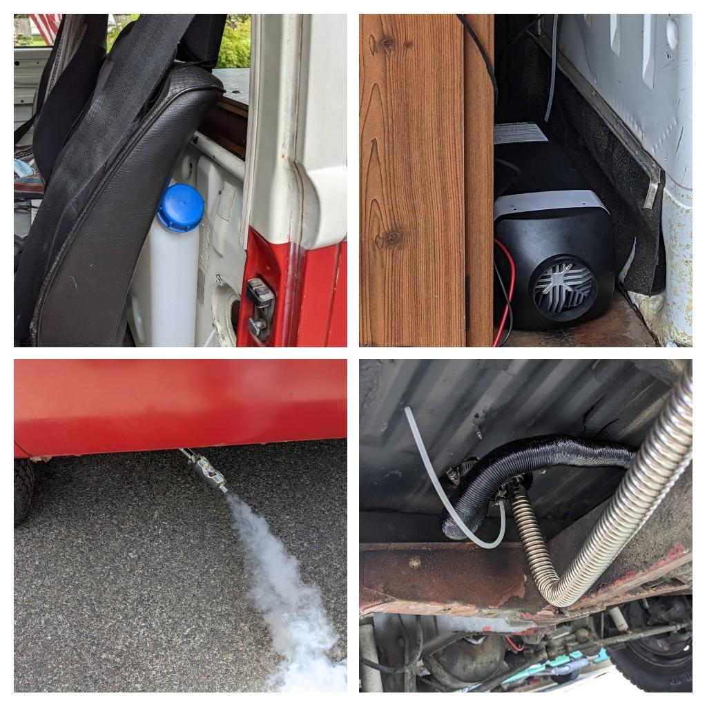

I'm running A 5KW Chinese diesel heater. We do day-long dog shows in 35-40 degree scenarios. We can maintain 70 degrees in our tintop for about $2 per day. It's a dry heat so no condensation on interior glass, as with a Mr. Buddy.
We love it.

I use a diesel heater but did not permanently mount it. I didn't want to drill holes in my bus. I built it in a Pelican style case and take it only when I need it in winter. In Norcal you don't need it year round as you know. Send me a message if you want pics of mine. Here is a youtube video that covers the basics and he even has 3d print files on thingiverse or you can buy the plastic parts from him on Etsy.

I have always used the factory gas BN4 heater in my early bays. Once they are working they seem to be more reliable than they get credit for. I am currently rebuilding a 1970 Westy and will be using one again. I have now completely run out of useable fuel pumps and regulators and fuel lines, so I will be exploring options to replace those. I live in the Yukon and I plan to be warm!

Op, get that heater inspected and fired up.

All the old-style heaters are wonderful for driving, but they don't do so well for camping, due primarily to the battery draw. Perhaps using that in conjunction with the Goal Zero battery thing would work to keep from drawing too much power. You'd still likely want to just use it to preheat the bus before going to bed, and then warm it up again before kiddos get out of bed in the morning.
Perhaps using the Goal Zero to run an electric blanket or two would be a better bet, due to putting heat right where it is needed.
The diesel heaters (and the name brands do also make actual gasoline versions--don't be fooled by the cheap versions stating "gasoline" in their ads-that is an error) are much more efficient electrically than the old style heaters.

That Southwind /Stewart Warner gas heater looks really nice. It will likely need a new fuel pump and I’d just replace the original style one with an electric one. The factory fuel lines used originally usually hold up well but if you plan on running it you’ll want to replace them. You’ll want a voltmeter as there may be some bad connections. It shouldn’t be too hard to get going. There also should be some on off switch somewhere you’ll want to find so you can adjust temp by pulling the switch out and turning it. The switch should be below the edge of the drivers seat next to the pull knob for the heater vent that comes from out I see the walk through

[quote="wagohn"]I'm running A 5KW Chinese diesel heater. We do day-long dog shows in 35-40 degree scenarios. We can maintain 70 degrees in our tintop for about $2 per day. It's a dry heat so no condensation on interior glass, as with a Mr. Buddy.
We love it.
Do these Diesel heaters pump out smoke like that all the time or just at start up?

The diesel heaters only smoke at startup really, and run really clean.
They have been a staple of the East Coast winter camping scene for years, and work very well.
One guy I know runs one in his little home built trailer, but has to keep the door open on 25 degree nights as the trailer gets too warm.
The only downside is the "tic...........tic..........tic......" of the fuel pump.
