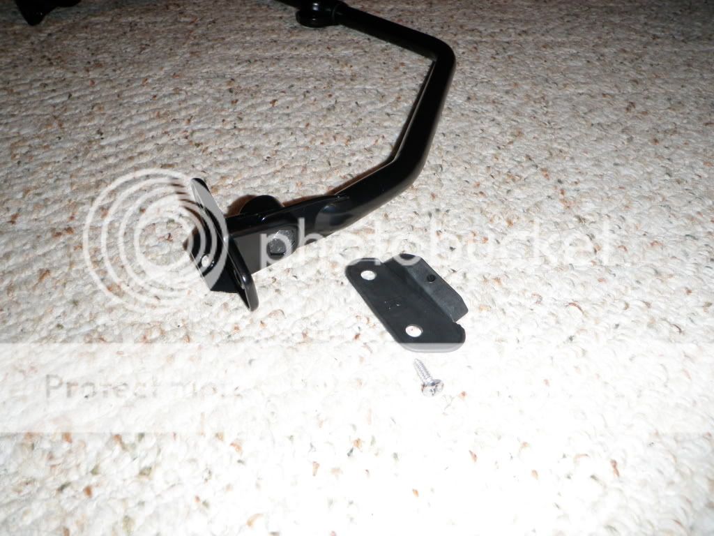

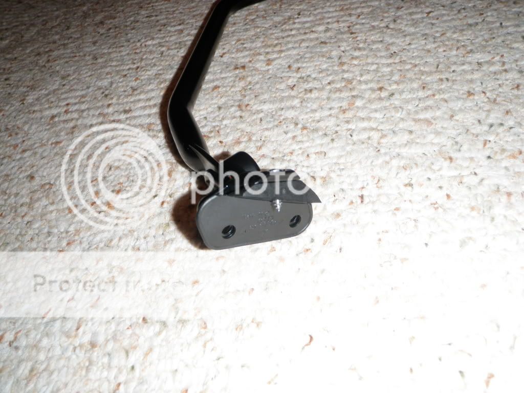

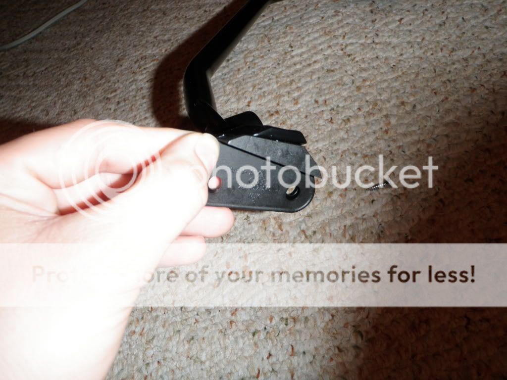

Though I have yet to get up to my van to try and install these mirrors Crying or Very sad (they showed up Tuesday at my apartment and my van currently lives at my parents house still Rolling Eyes ) Van Cafe sent some extra hardware and I figured out how the seal goes which I think is part of the bewilderment.
The top Hardware:
Kind of screwed together
Me holding the upper gasket in place
And a picture of the mirror because they look so awesome Laughing

thanks for the pics- what about the other 2 screw holes on the top mount ???....any idea what size screw to buy for them....

PostPosted: Fri Jun 24, 2011 7:54 pm    Post subject: Reply with quote
Well, Van Cafe sent 4 of those screws for the 2 parallel holes the perpendicular hole needs a slightly longer screw it just happened to hold the gasket in places I could get my fat fingers out of the pic Embarassed and it gave a good idea of the length of the screws they sent. The other screw would need to e a little longer to go through the mirror through the gasket and have some real hold into the metal of the door. Sunday when I attempt to install the mirrors I will try to get the last screw and try to get more pictures of the actual install, unless, others report leaving that screw out without issues.
