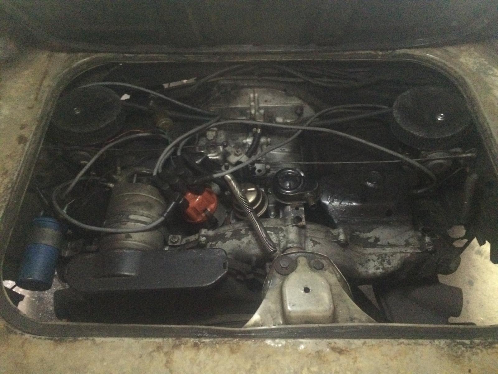

engine bay
I was able to get an even better deal on it because the dude said there was something wrong with the engine, and he didn't know what it was. He drove it around the block with me in the passenger seat, and you can tell there was barely any power at all. It struggled to go over 20mph in the neighborhood. I didn't want to risk driving it home, even though it was only 14 miles. So I had it towed home with the extra money I had left over. He said the last thing he worked on was the Ignition system, and then let it sit for a while.
I've done my share of research on the ignition system, and i can proudly say I've learned more about it in the past two weeks than I have since I've been interested in this car. First thing I checked on were the spark plugs. I found out cylinders 1 and 2 weren't giving off any sparks at all. I removed them and they were FILTHY.
This pic doesn't do them justice as I had cleaned it off a bit already. From left to right, cylinder 1,2,4. It looked like there was a bit of gap bridging on two of the spark plugs resulting in a dead cylinder
I cannot for the life of me reach deep enough to fit a spark plug socket to remove cylinder 3's plug. Not sure if I'm supposed to remove the carburetor to free up some space, or if i need a special tool. Any suggestions on how to get around that?
After I had replaced those 3 spark plugs, I can definitely feel the difference in power. I was able to drive the car around at 50mph comfortably (kind of).
My first drive around. Went to get some air in the tires.
I know I still need to set the points gap, maybe replace spark plug hoses, and all that jazz. I just haven't made much time to do so.

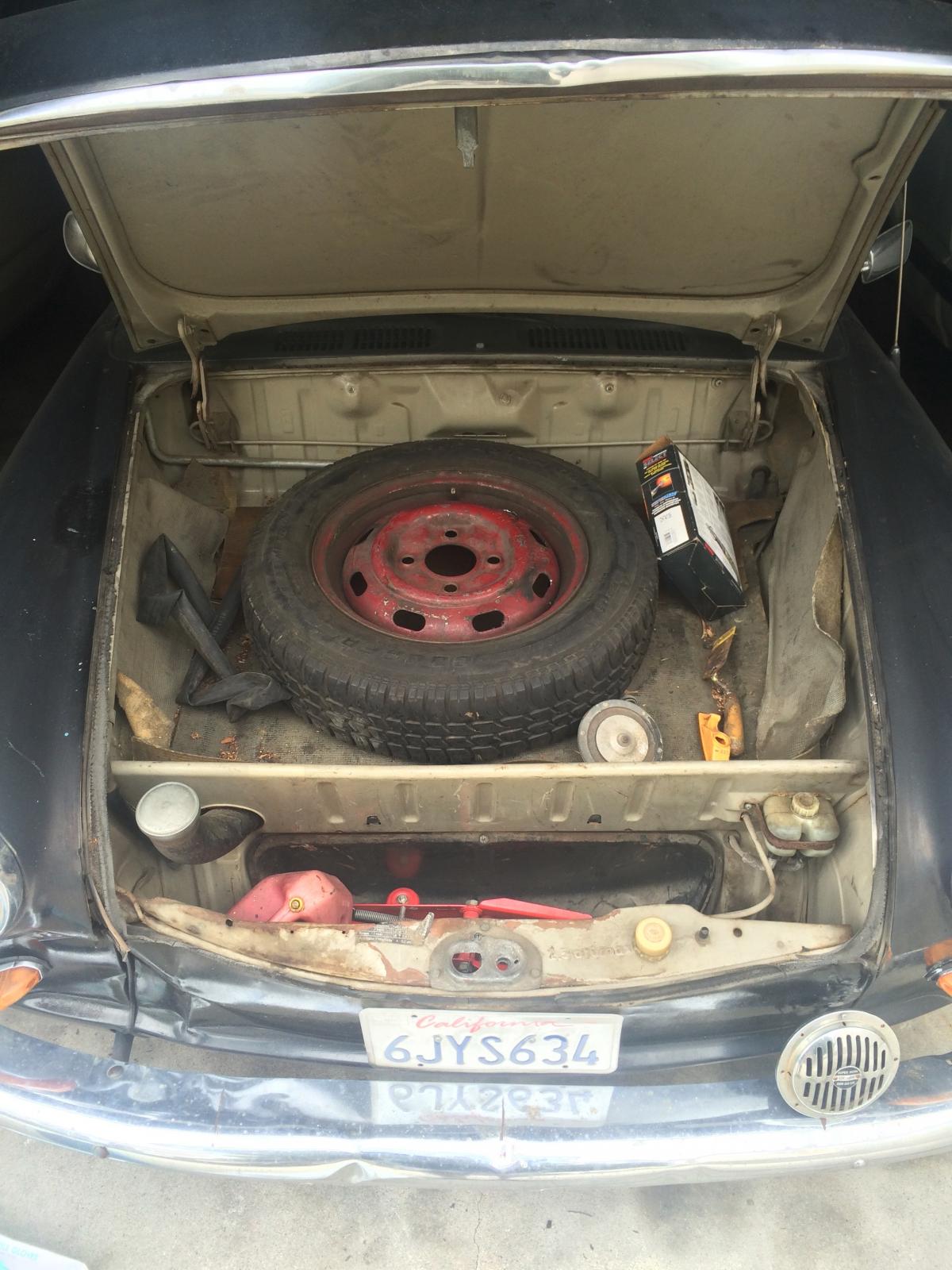

Next up was under the hood....or trunk... or whatever the proper name is for the front storage area.
Looked like it hadn't been opened in a while. things were just piled in there.
I kept the interior trim pieces in case I wanted to use as a stencil to make my own in the future
After carpet pieces were removed and slightly swept up...
...scrubbed...
...and washed
As I've previously mentioned there was some damage to the front apron. You can see the damage done to it on that last photo. I'm pretty sure this Squareback had previously been in an accident or two, and then covered up. The hood latch doesn't perfectly fir in the apron so the hood lever under the dash doesn't work. and the hood is slanted as see in these photos. The damage to the apron destroyed the serial placard so it sucks I cant see the original. Anyone here know where else I can find that information? I know of the serial numbers on the chassis under the rear seats. maybe theres other locations around the car for me to check? I'll take closer pics of the damage soon.

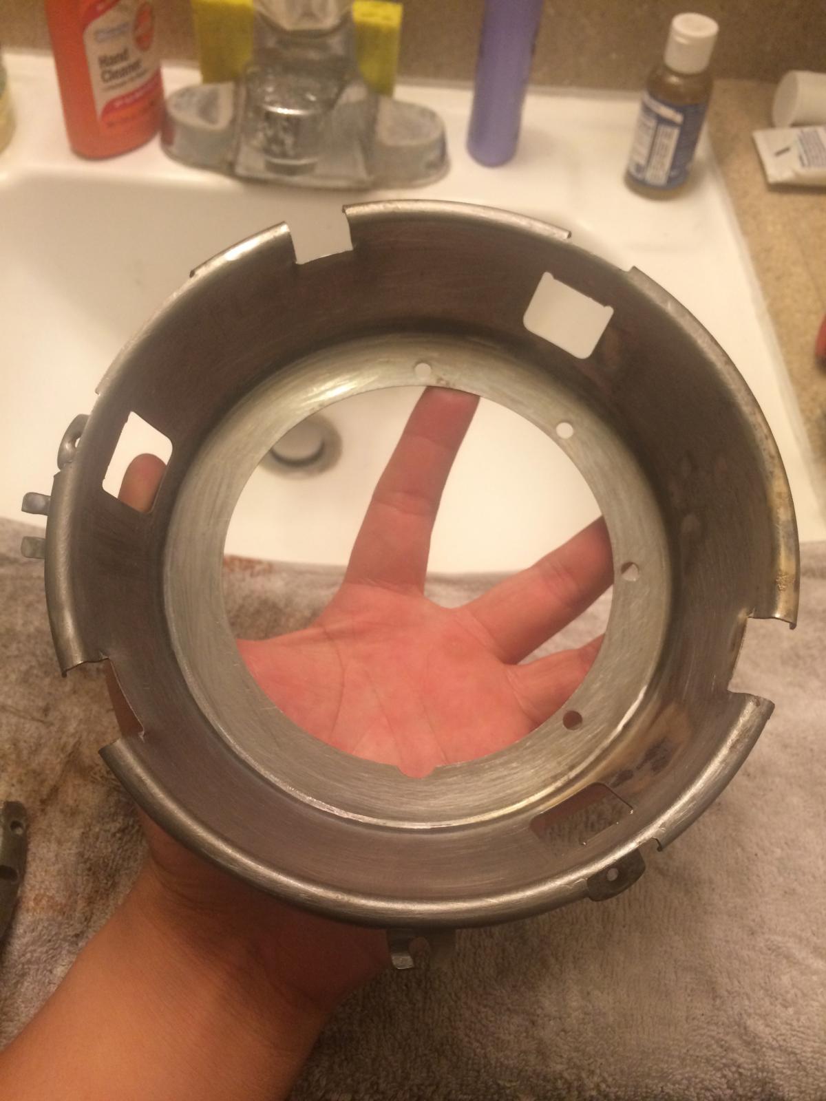

Worked on head lights this time. There wasn't really anything wrong with them, they functioned just fine. I just wanted them to look a little cleaner....(or so I thought)
right
Evidence of previous accident. Broken headlight glass behind headlight was left behind. The headlight that came out of this right side looked like it was supposed to be a left head light. So I actually have two left side headlights. They still work just fine, but it'll be weird trying to re-align the lights once I'm finished with them.
left

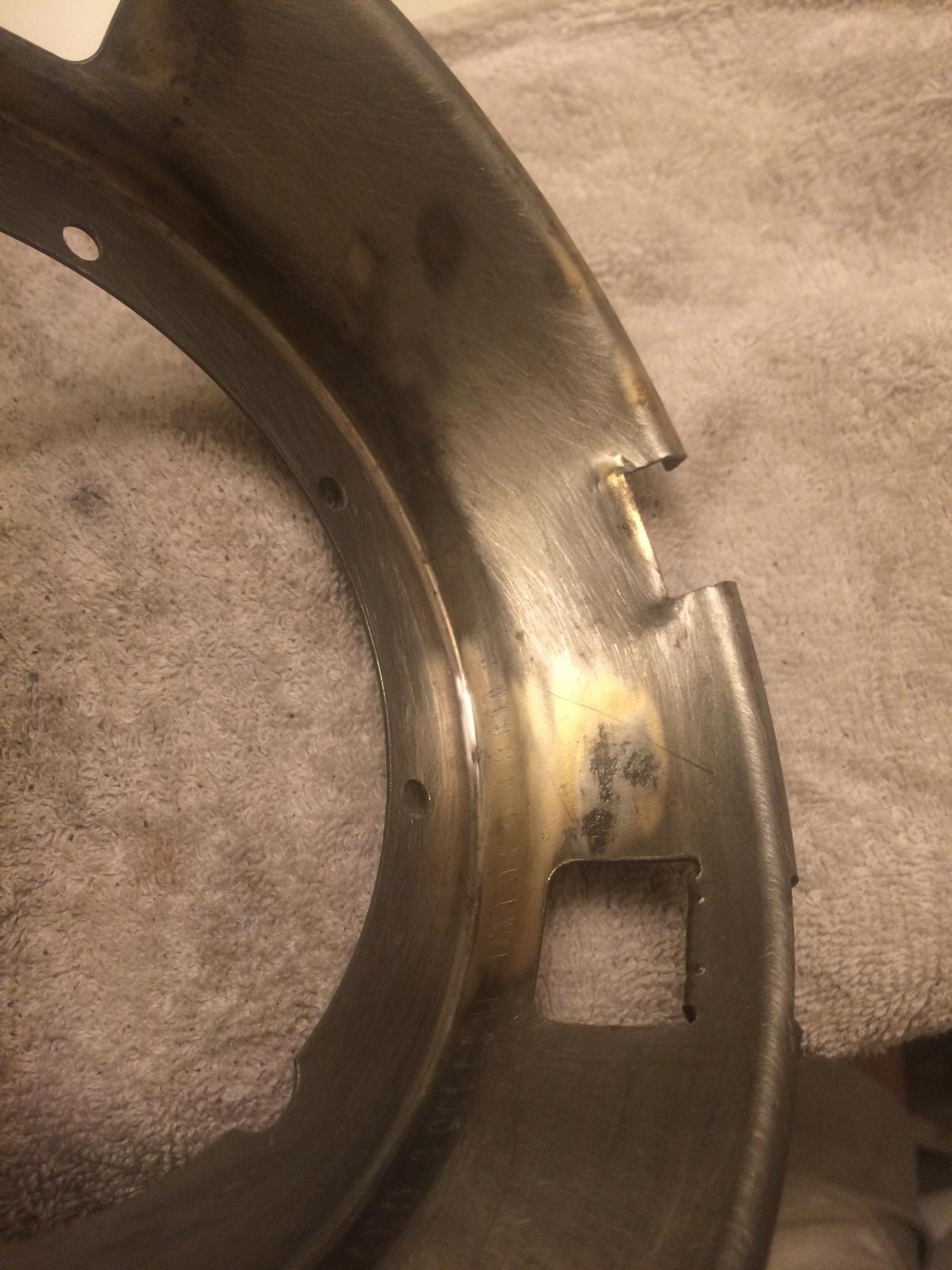

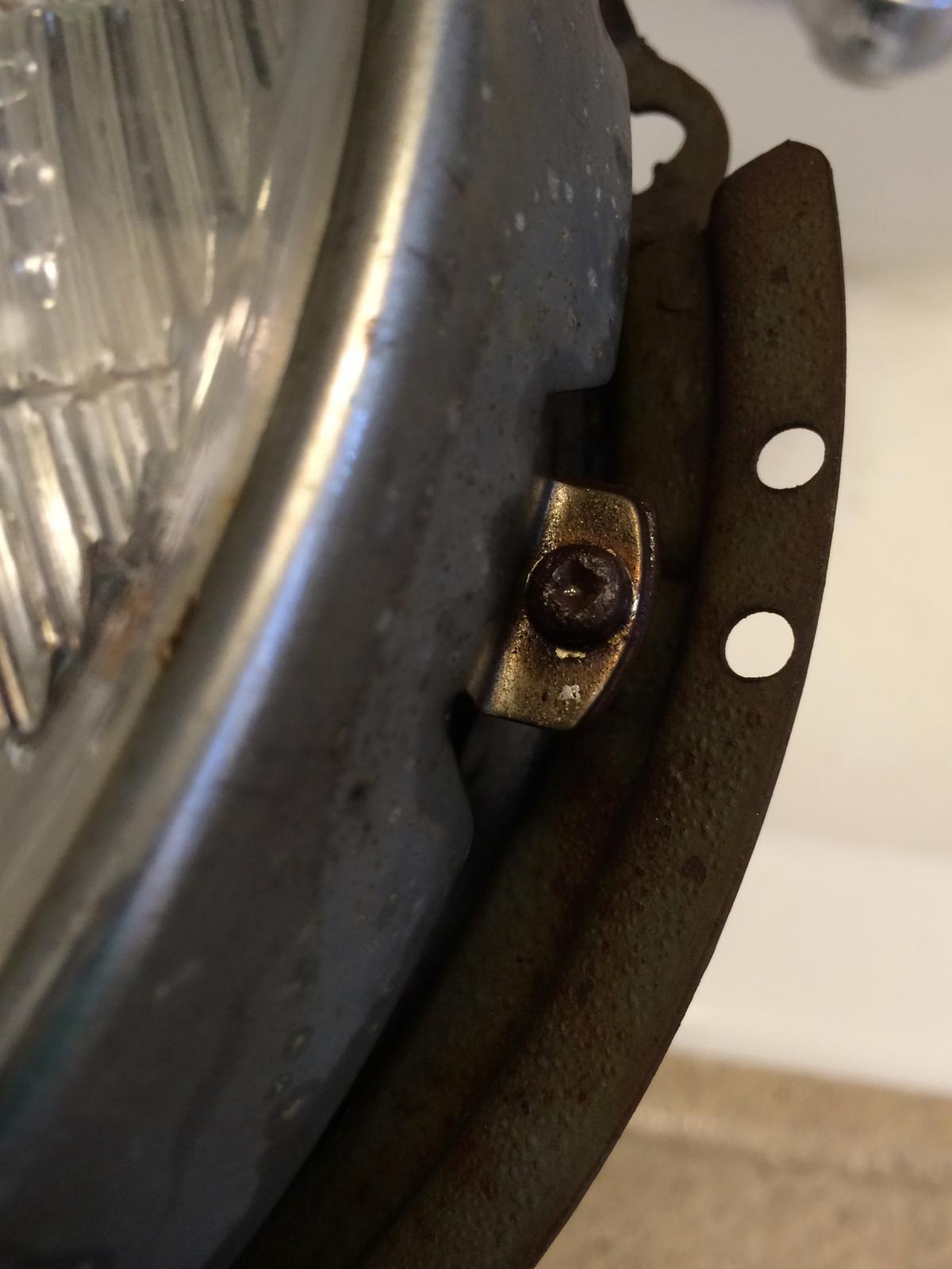

Started disassembly on the right side. I had trouble removing these screws, looks like previous owner tried opening it up while it was rusted without any for of lubrication, ruining the screws.
They were in such bad shape, I wasn't able to remove the screws. So I was left with no other option but to bust out my dremmel tool. Made a make-shift flat-head screw instead and used massive amounts of WD-40.

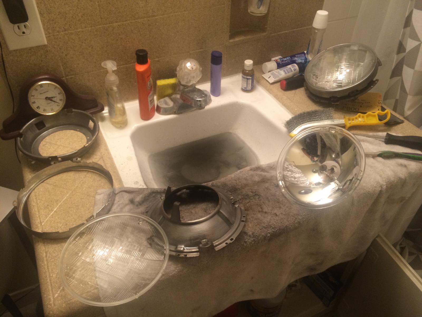

After taking it all apart, I started sanding down the housings. this is what it came out to
There were early signs of rust beginning to form under the paint, so I'm glad I was able to catch that before things got worse
used my dremmel tool with steel wire brush attachment to get down to bare metal

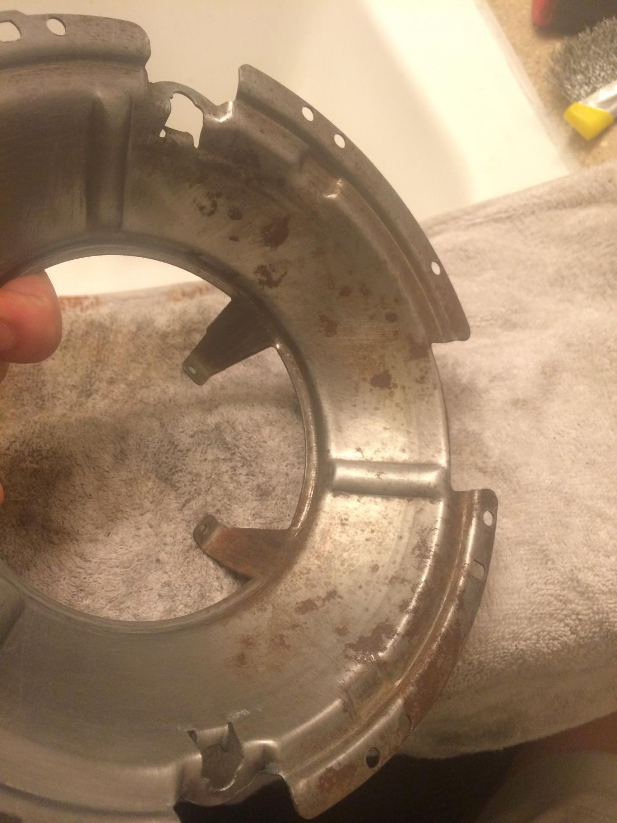

The rear plate had more signs of rust on it under the paint
the back of it was still in pretty good shape though. im planning on repainting these housings, so it sucks i had to remove all of it. here's some photos of the labeling
the small amount of workspace I have to deal with
I ended up taking apart the actual headlight glass. The seal between the glass lens and the other glass piece was completely worn off to the point where it would crack and break when small amounts of pressure were applied to them. Now I don't want to put the headlight back together until I can somehow find a new seal. Not sure if this is a special seal that has a particular part number, or if any generic brand can be used. If a specific part number can be provided, I would much rather choose that. If you know, please let me know where I may purchase a pair.

Looks like the fan shroud heater outlets may be uncapped, which will overheat the engine in short order.
I ended up taking apart the actual headlight glass. The seal between the glass lens and the other glass piece was completely worn off to the point where it would crack and break when small amounts of pressure were applied to them..
I hate to be an asshole (that's Tram's job) but those headlights were "sealed beams", which means they weren't supposed to come apart. Surprised Also, they are universal in placement (left or right sided), so they'll fit either side. The metal behind them is like that too, other than the possible placement of 1 spring.
The car doesn't look too bad, and I've rebuilt worse. I'd spend some time looking around the web site, as most of what you're looking to do has been done before in some form or another. Monte has done a great job on his own Square over the last couple of years. I remember when he drove it home (and the story that went with it), as he was still a "newbie" back then. Now, he can do all sorts of stuff, including paint. Cool But he's right, you should get a Blue Bentley manual, or at a minimum a brown one to go with your Haynes manual.
Thanks for the input. I'll have to check out where I can get one of those blue book things all of you guys have been mentioning.
As far as the headlight, I didn't purposely remove the seal in between the glasses. After I had removed the metal pieces from the backing, I placed the headlight face-down on my rug while I was cleaning the metal pieces. After about 30 minutes, I picked up the glass headlights from the rear, and the front part of it just fell to the floor. I'm just glad I didn't shatter it. When I picked up the seal, it just cracked all over the place w/o any force applied to it. Fortunately, it's happened only to one side. I haven't had the chance to work on the right headlight, but I will be sure to keep those in mind when working on it. As I've mentioned, all this is a learning experience for me. So, now I know. haha

Well, I'd plan on replacing that headlight for sure, as they're vacuum sealed when put together.

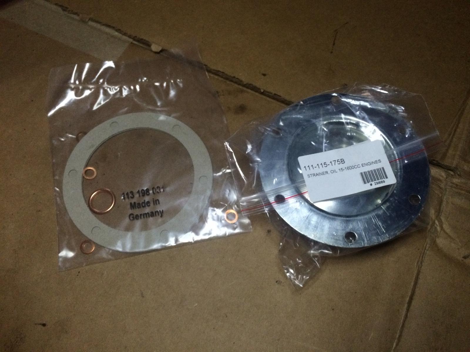

Changed the oil for the first time last night. I bought an oil change kit from IPC in Hawthorne. Small shop, but has lots of replacement parts and stuff.
Can someone verify if this is the original oil cover? The ones I've seen during my search on how to change oil, there has been a large bolt right in the center. This one only has the 6 small bolts around the circumference.
I've also read and heard from several sources that the mesh filters and seals can be cleaned and re-used with no problem. I ended up just replacing everything since I already had the parts available. I'll probably just clean the old ones up and keep them as extras.
Now this one really raises my concern. When I removed the 6 nuts from the oil cover plate thing, I found out that 4 of them matched, one of them was a generic nut, and the other one was a bolt. I'm sure this is not OEM, but do you guys think it will affect anything besides just how it looks? They were all removed using a 10mm socket.
You can see where the one bolt screw into and the rest have the bolts coming out of the oil pan here. My guess is someone had broken one of the bolts, and just had it re-drilled and tapped.
