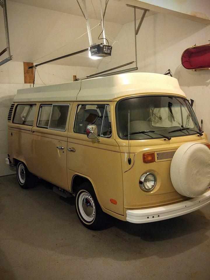

Heya,
Yup, I am the guy who snagged the Dakota Beige 1979 Riviera from West Coast Samba (the ad is actually still listed as SALE PENDING). I have been nosing around these forums for a little while, and it's high time i posted.
I actually just returned from a week in WA state climbing Mt. Baker and Mt. Silver Star, but made the bus purchase 2 weeks after I already left. So I could not drive it home and had to have it shipped. It arrived a bit late, but it's here safe and sound. My family and I (2 little ones) are already having a blast in it. We have several trips lined up soon.
There are some minor electrical issues (no emergency signal lights or turn signal light on the dash), saw a few missing relays, and currently figuring out the auxiliary battery setup as it looks like some janky wiring took place. It'll get shored up. Shore power, hook-ups, sink, stove, propane all work like a dream. It drives amazingly well, what a nice clutch...aah.
Noticed some oil dripping and I am having that checked out till I further my education in the air-cooled world. Under the oil pan and to the left and right have drips a' happenin', and it's pretty soaked. I welcome the challenges and the test to my patience. It's been fun already getting in there and looking around. Been reading the HTKYVWA front to back and just got a fresh Bentley Manual.
I have been a life-long lover of VW Buses and blessed to own my own bay. My earliest memories are of my mother driving us around in hers, no heat in the freezing NE weather, with an external propane tank sloshing around (with a pilot light) on the floor, just waiting to spill and catch fire. Ha! I remember just looking into the rear view mirror as a kid, and smiling at her.
I look forward to meetings folks and learning a ton.

PostPosted: Thu Jul 14, 2016 9:44 am    Post subject: Re: My 1979 Riviera Reply with quote
Congrats on the Rivi. Good times ahead.
Consider ripping out that not museum quality or VW front side marker and replacing that 68-72 silver rear marker to original style. That bus is pretty and should have the correct details. Cheers! Some links to the proper look.
Sometimes it's fun to hit the swap meets or Samba classifieds to find OEM stuff. (Not suggesting you buy from CIP1. Just examples)
http://www2.cip1.com/ProductDetails.asp?ProductCode=C16%2D221%2D363B%2DLR
http://www2.cip1.com/ProductDetails.asp?ProductCode=C16%2D221%2D119B%2DLR

@Xevin Thanks for those links. Awesome you could spot that from just one picture! Yeah, I will make that replacement sometime soon. We just noticed that the back rear light is out anyway.
I dropped the bus off locally. I am going to get the engine degreased on Monday as the oil leak seems to be getting worse. I am out of town all next week and getting a trusted mechanic to do this for me and we'll go from there. Withdrawals have begun...
