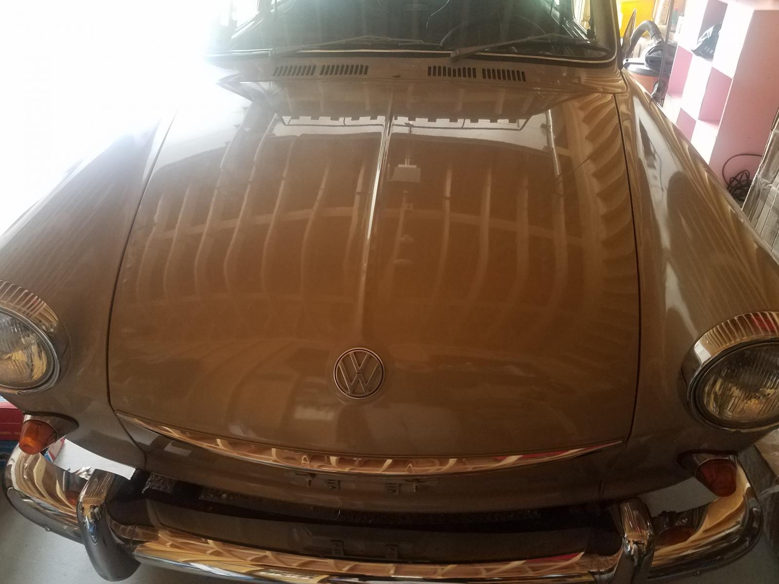

Hey all-
I just acquired this very original low mile fastback which is currently not running.
I have known the car and previous owner for some time and was very surprised to see he was selling it. I was not in the market for another car having bought my t34 earlier this year as well as replacing the tdi in my Doka. When the PO texted me and said he was thinking of selling I didn't even make an offer on the car thinking it would just be way out of reach for me at this time(plus not running FI was another factor)
The PO had battled the FI for over a year and had a mechanic familiar with 914 type 4 FI(supposedly). He and the mechanic had done quite a bit of work on the car fuel tank cleaned, vac lines , distributor rebuild , new injectors.. I do not recall the timeline of what was done by whom and when.
I fully intend to keep this car injected. Yes it would probably be easier for me to swap it to carburetors ,but I do not want to go that route at all. Even though I am very familiar with carbed type 3's and FI is a whole new realm for me.
I have to start with basics timing, basic ignition parts checks then move forward. Going to need to research a lot and bounce questions off the knowledgeable FI people on here
This car has not run in over a year (I believe) the PO warmed it up started backing down his driveway it stalled and has not run since. It cranks over but doesn't seem to even try to fire. Battery was tested and is nice and strong.
here are a few pix : I will put up more as I being to sort through things.
