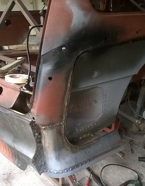

Hi everyone!
Thought about maybe i would introduce my project ...
66 squareback, lot's of mess to clean, also from previous welding. Not saying i am a good welder, just trying to do the best i can Rolling Eyes
So here it goes... How i bought it
oh yeah, thanks to imgur for hosting Wink
What i meant earlier Wink
After this i got it sand blasted and welded a support.
And so the journey begins ...
At this point, i was like f*ck this Rolling Eyes
This car was sold to me as "all that is left to be done is the main brake cylinder"
And as you all know, not much body panels available for type 3 so most of it is self fabricating...
Luckily i came across a wheel arch from a notch, but this needed also modification to fit a square, but in the end this is the result so far Laughing

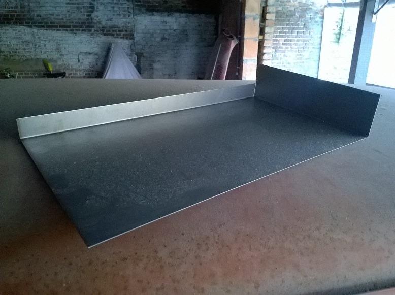

Today i continued the corner, got this piece plied at the local hardware store, luckily i have a nos driver side so i can take templates for measurements, if anyone is interested i can scan them...
Before finally welding this corner, need to fill up the screws on last picture with another corner... now that i still got the space...
