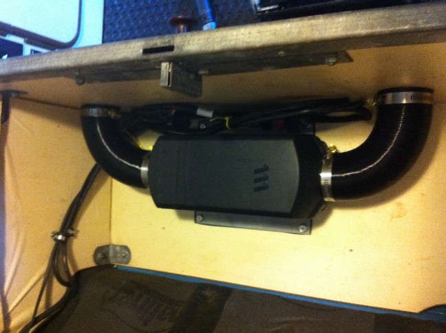

Here are a couple pictures of my D2 install. Our 82 did not have a rear heater core. It takes up about the same amount of space as the WBX rear heater core assembly. That storage is rarely accessed, so I installed our auxiliary battery and inverter next to the espar. The aluminum cover is to protect the unit as well as the other things that get stored in their.
Unit:
Cover:
For camping, you can't beat it if you have diesel fuel available.

Maybe a dumb question but do you experience any type of smells?
MarkWard
Joined: February 09, 2005
Posts: 18637
MarkWard is offline
PostPosted: Wed Apr 04, 2018 8:10 am    Post subject: Re: Rear heater heat output/BTU Reply with quote
Me? Nope, intake and exhaust are outside the van's passenger compartment. A blower circulates air over the "hot" part of the unit and that is what heats the compartment. After a few camping trips I did add a muffler. I have a couple other photos of the install.
My nose may not be that sensitive. I hear folks complain that cooking in the van stinks it up. We cook all our meals and have a 80 pound dog and everything smells normal to me. So, I may not be the best person to ask.
