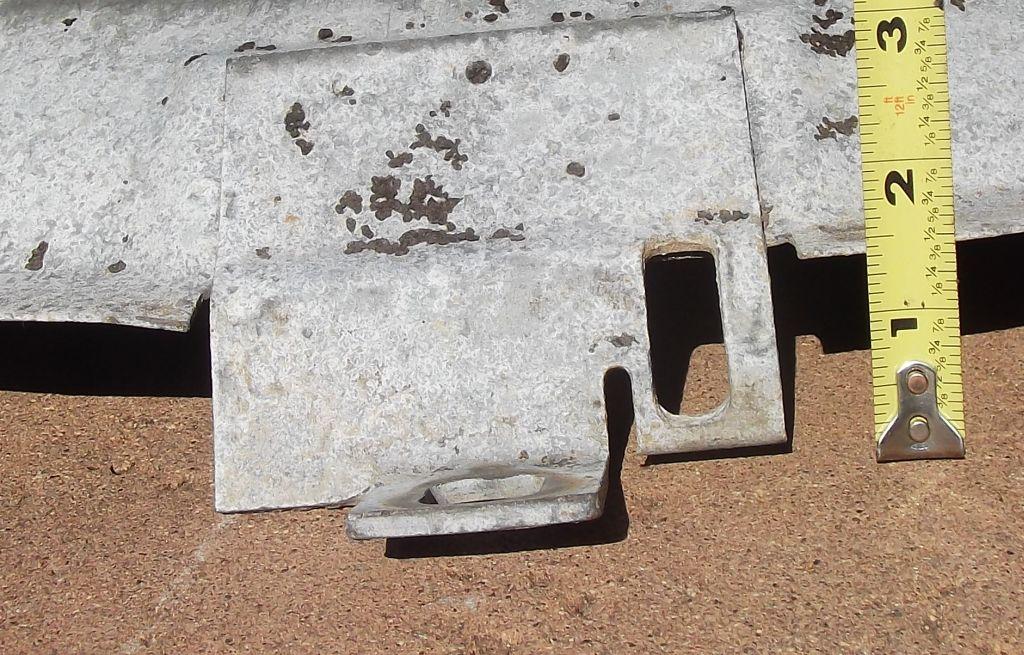

This shows the taller tang for the 205 tire version.
Mark
