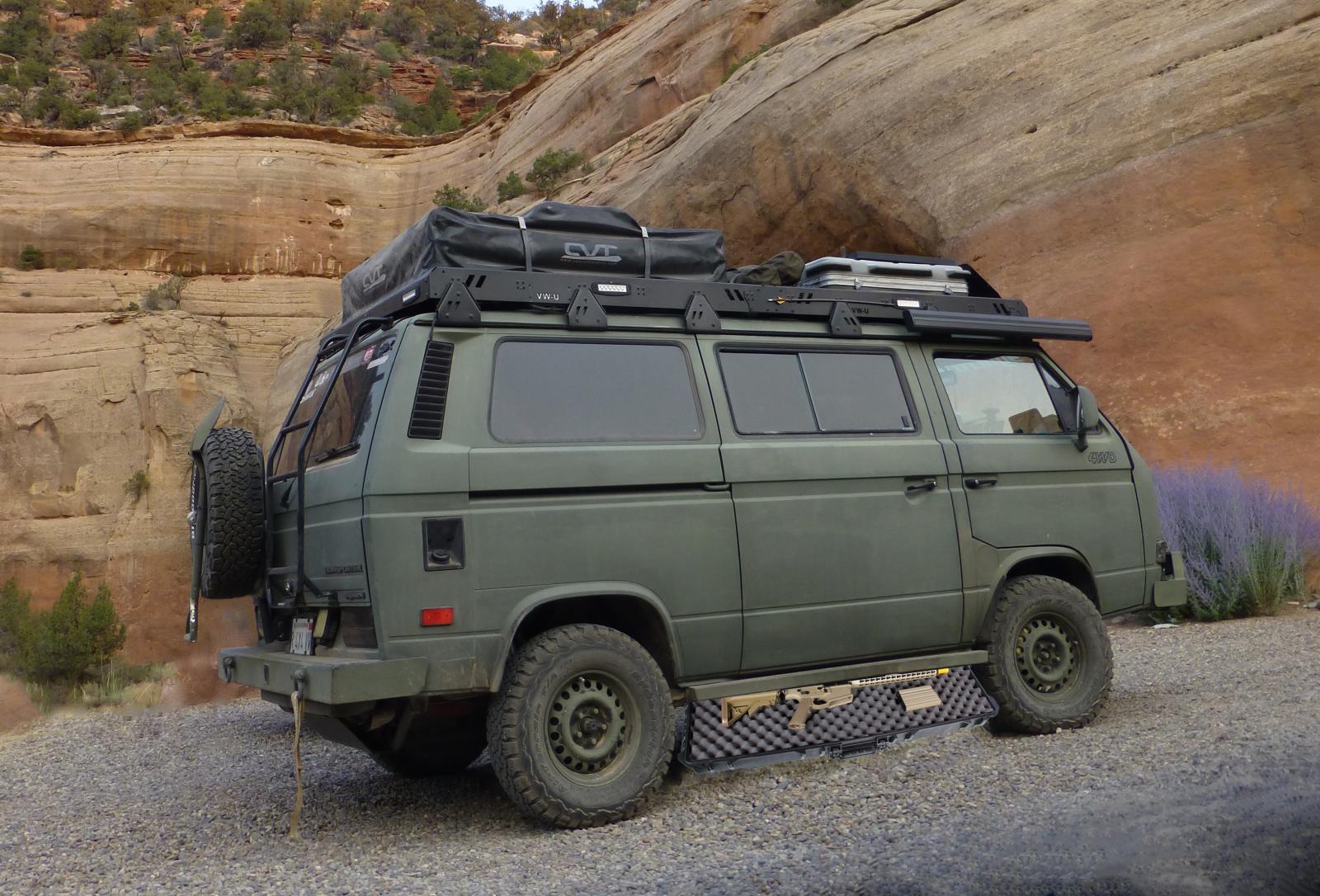

If so, I'm kind of liking the idea of a rifle-sized pelican case. I imagine fastening the lid of the case to the floor of the van with bolts with the hinges facing the center of the van. As long as the sturdy clasps were accessible, they could be undone and the bottom of the case would swing down to get at the contents. Contents would shift a bit as the case swung down, but sounds workable.
Something like this photoshop mock-up:

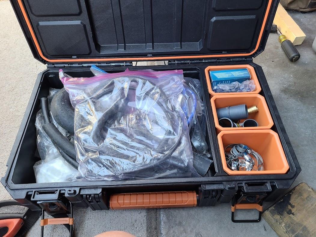

Thought I'd update this thread with another storage box idea.
My last, temporary storage box didn't do so well. Perhaps I should have taken the hint the last time I had to duct tape it back together.
But I liked the dimensions. This RIGID 22" tool box was $31 at HD. It's allegedly water-resistant, meaning you can't totally submerge it but it should be fine with road spray. It has a silicone seal around the rim and clamps down tight.
Various hoses, clamps, splices, cap, rotor, wires, fuel pump, CV joint & boot, v-belt pulleys. all the sensitive stuff in plastic bags.
It has a spring-loaded handle on the front so it's easy to pull out of the clamshell, too.
It doesn't use up all the space, but it should work for my needs.
Joe T.
