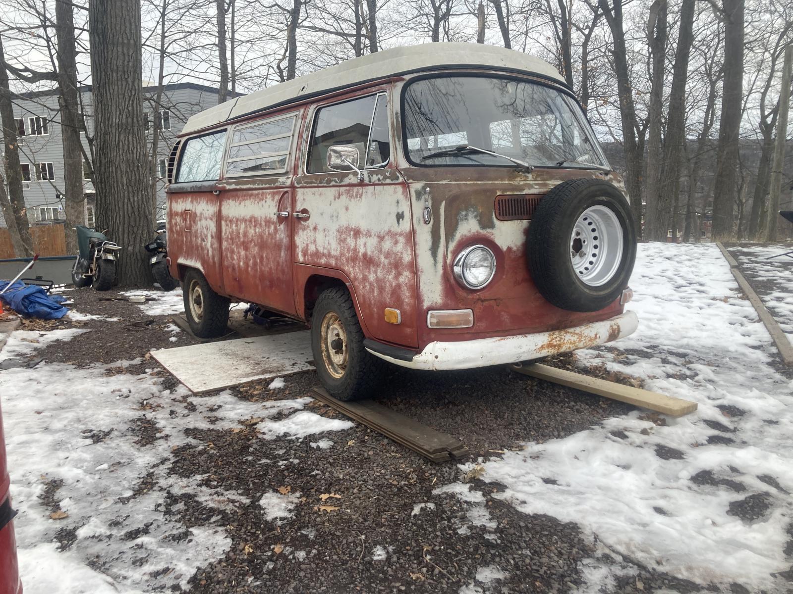

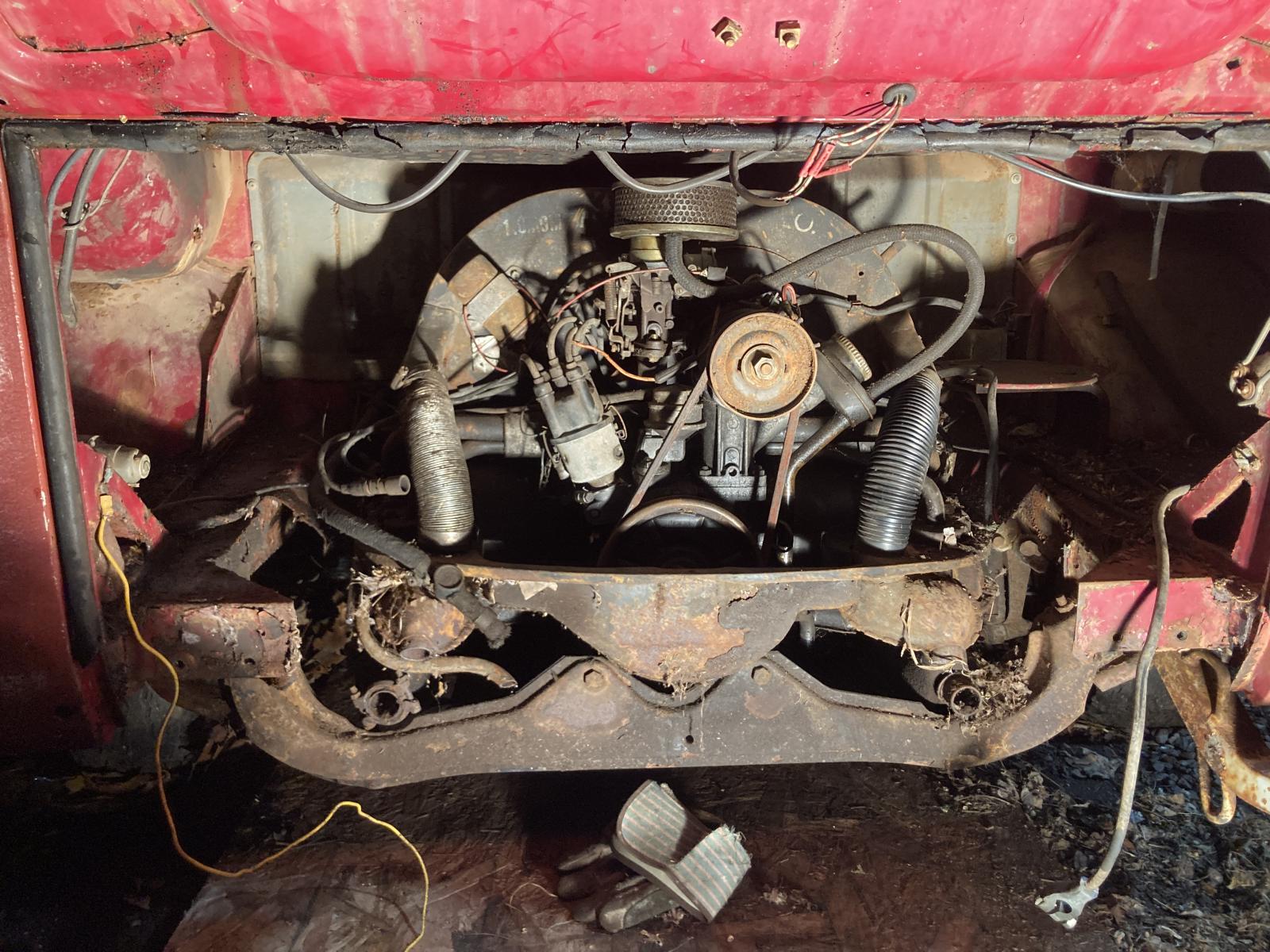

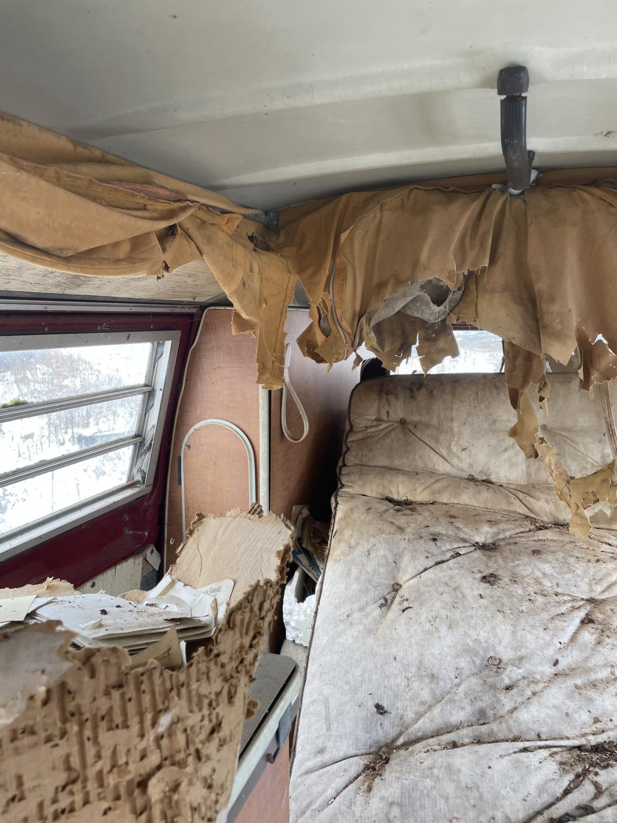

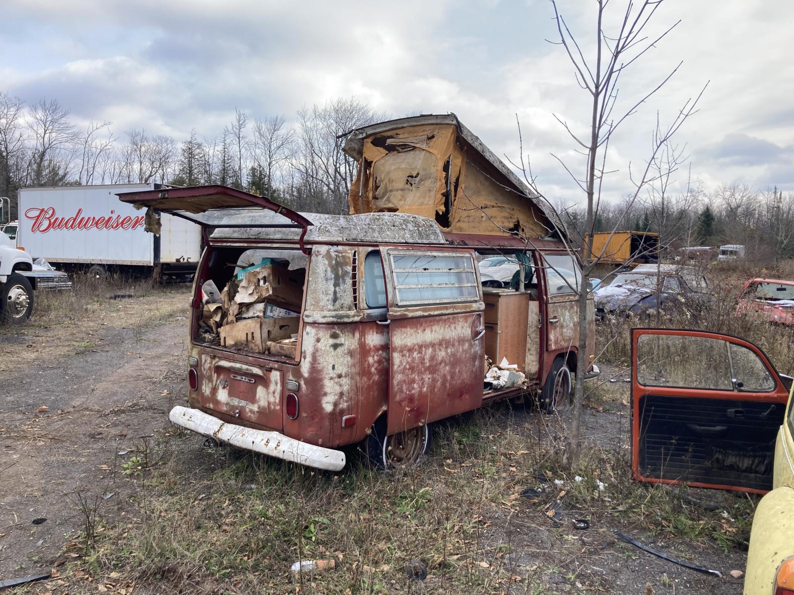

I found yet another Westfalia…
A few weeks ago I was doing some homework and a friend calls me up and asks, “have you been to Ed’s salvage yard recently?” I hadn’t been and had honestly forgotten the place. After I realized which place it was, it’s only a mile from school. Then he said there were 20 old VWs out there. I was immediately intrigued. He said there were two busses and a bunch of bugs and the one bus was actually pretty nice. He sends me a few pictures and its original paint with a nice patina. I leave doing homework and head out there to check it out with my friend and it looked decent. The years said they’d sell it but they’d let me know on a price and give me a call in a few days. A few days go by and they say make an offer. Pond story short I picked it up for cheap and got bumpers, the engine, transmission and some other parts thrown in from the other 1971 sunroof bus in the yard. They even delivered it for free

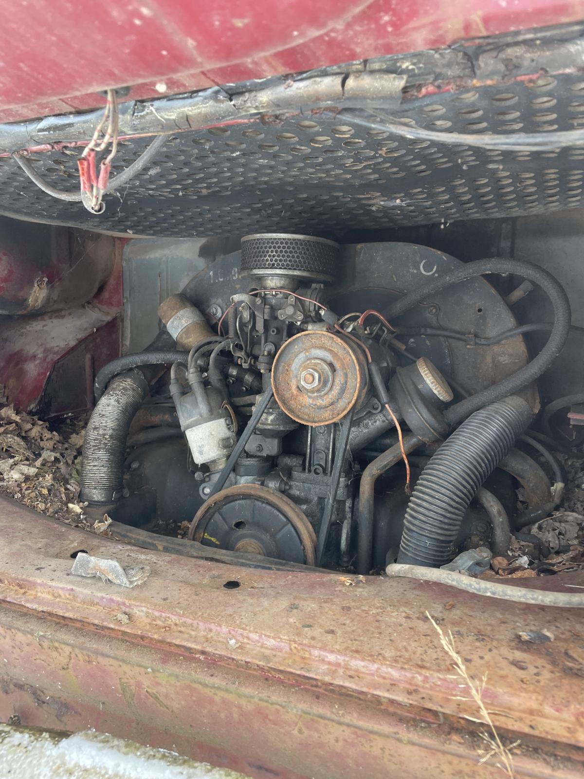

It was covered in moss and full of junk but it was very complete and not too rusty. The engine turned 350 degree, but not the whole way over, but it looked nice, more on that later…
After I power washed the bus it started looking real nice
We used my friends Subaru to pull the engine and haul it home from the other bus

That’s some dope patina!!’
Definitely don’t paint it. Clean it up with CLR mixed 50/50 with water and scrub it with a green scouring pad. Then coat it with Sweet Patina.

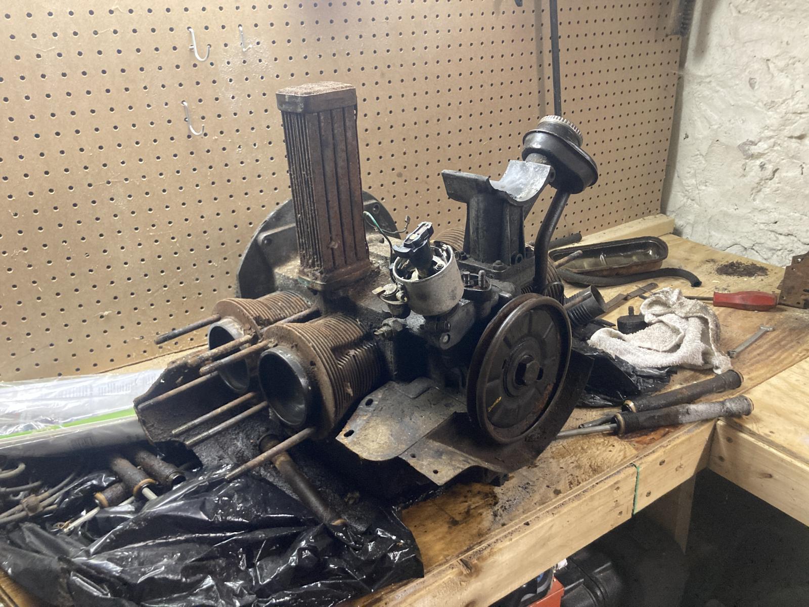

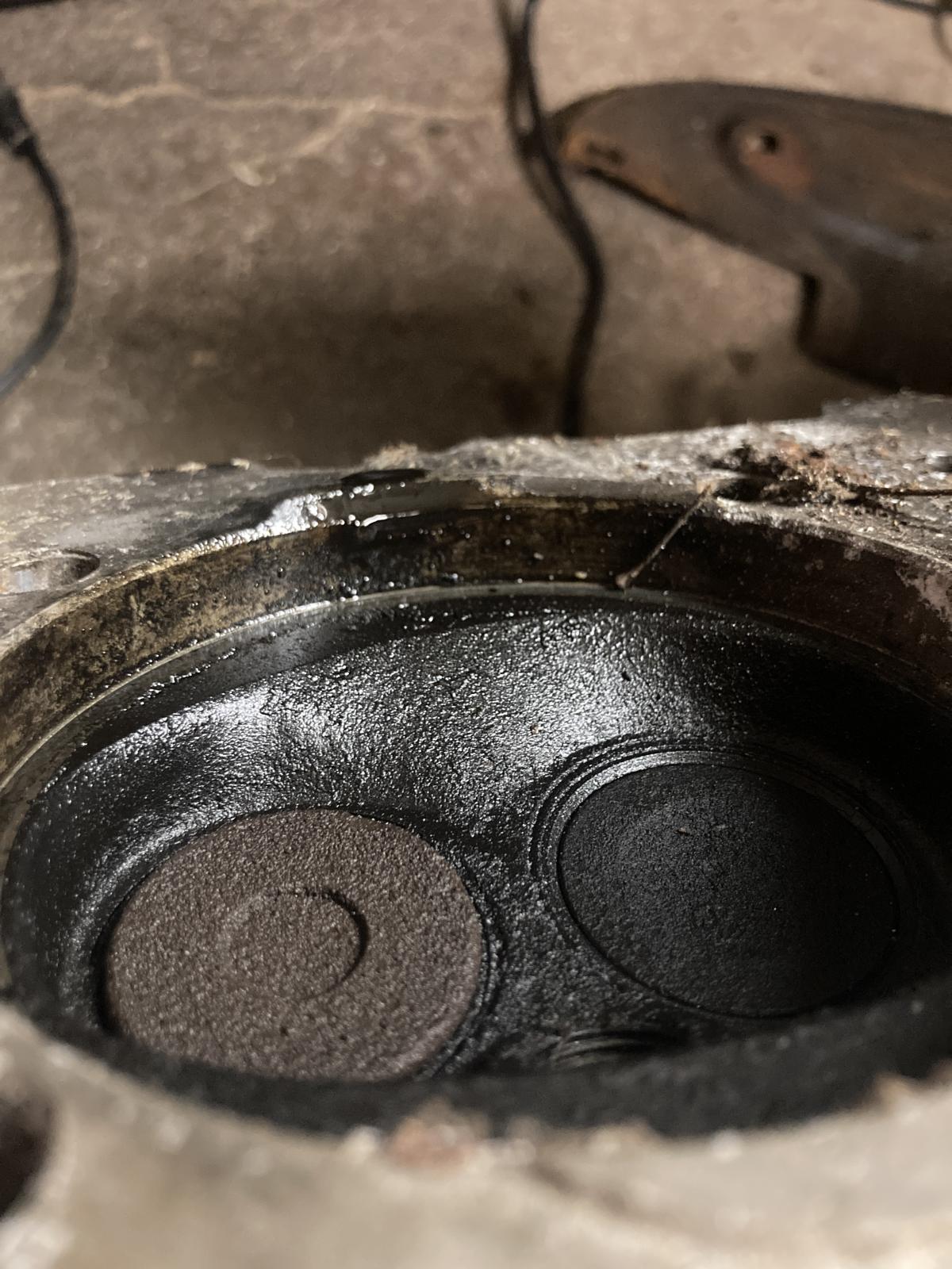

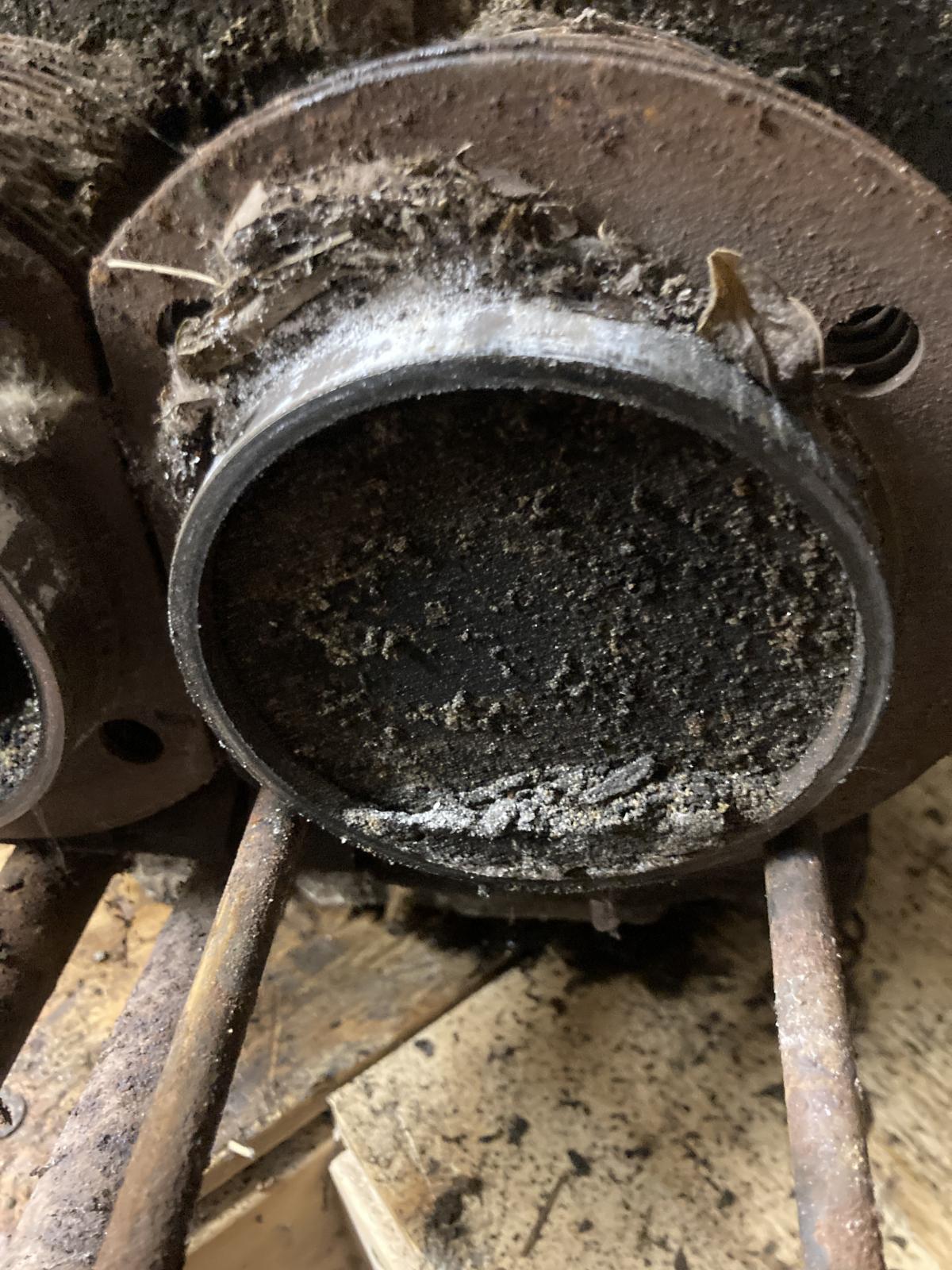

So progess moves slow on it since I got school and other stuff going on but we got a warm day so I decided to yank the engine with the help of some friends and start to tear it down. We take it into the basement of the house I’m living in and start to tear it down. I figured there was just dirt in the cylinder preventing it from turning over. Turned out to be true but in the process I found one of the worst engines I’ve seen. To start, I discovered the engine had 1/8-1/4 inches of end play, that’s no good at all. When I pulled the engine, it was missing one of the four bolts holding it to the transmission and one out of the three holding the engine hanger on and few of them used washers. The whole engine was a mishmash of parts and fasteners. The carb was a mix and missing screws.
Then I get the heads off, the cylinder are badly worn down, and worse, the valves aren’t even all the same size Shocked the one intake valve looks like it’s from a 1200 and almost falls through the seat it’s so small. All the head bolts were over torqued and seemed have pressed the cylinder into the head. Once the cylinders were off my friend moved the crank it you could see the main bearing moving back and fourth. The crank also could move up and down it was so bad and it had started grinding into the bell housing. The flywheel also just looked all dented up.
Then the engine in my friend’s Subaru from the other bus is locked up so hopefully that will work out or I can find another good engine.
Edit: here’s the smaller valve, the seat isn’t sunk, it’s just too small of a valve

Thanks rich!
I’ve been looking for a nice OG patina bus for a while and wanted an earlier one so I was stoked when this turned up a mile from where I was living.
I definitely do that! At most I’ll replace rockers and blend in the paint there but it’s getting left patina, probably repair and repaint the fiberglass top

For a bit more of the story on the bus, a lot the cars in the junkyard, and all the old VWs came from an estate they were cleaning out and he was into foreign cars, I think he had 30-50 cars the junkyard got. The bus was full of crap as seen in previous pictures. I threw out three contractor sized garbage bags so far and have more to go. As I cleaned it out, there was a bunch of old magazines, letters, etc from the 90-91 all left in the bus to the PO. Some pretty cool old magazines and old letter wrote to or from him. A bunch of the stuff was in different languages. It turned out he was a professor at the university Im going to and had a son that went there. He had a pretty interesting back story, here’s one blurb I found on him
On another note, I decide to name it Fitz as a tribute to the wreck of the Edmund Fitz Gerald since it happened on Lake Superior and I got the bus at about the same time as the anniversary of the wreck. Also because it’s been a fitz to deal with.

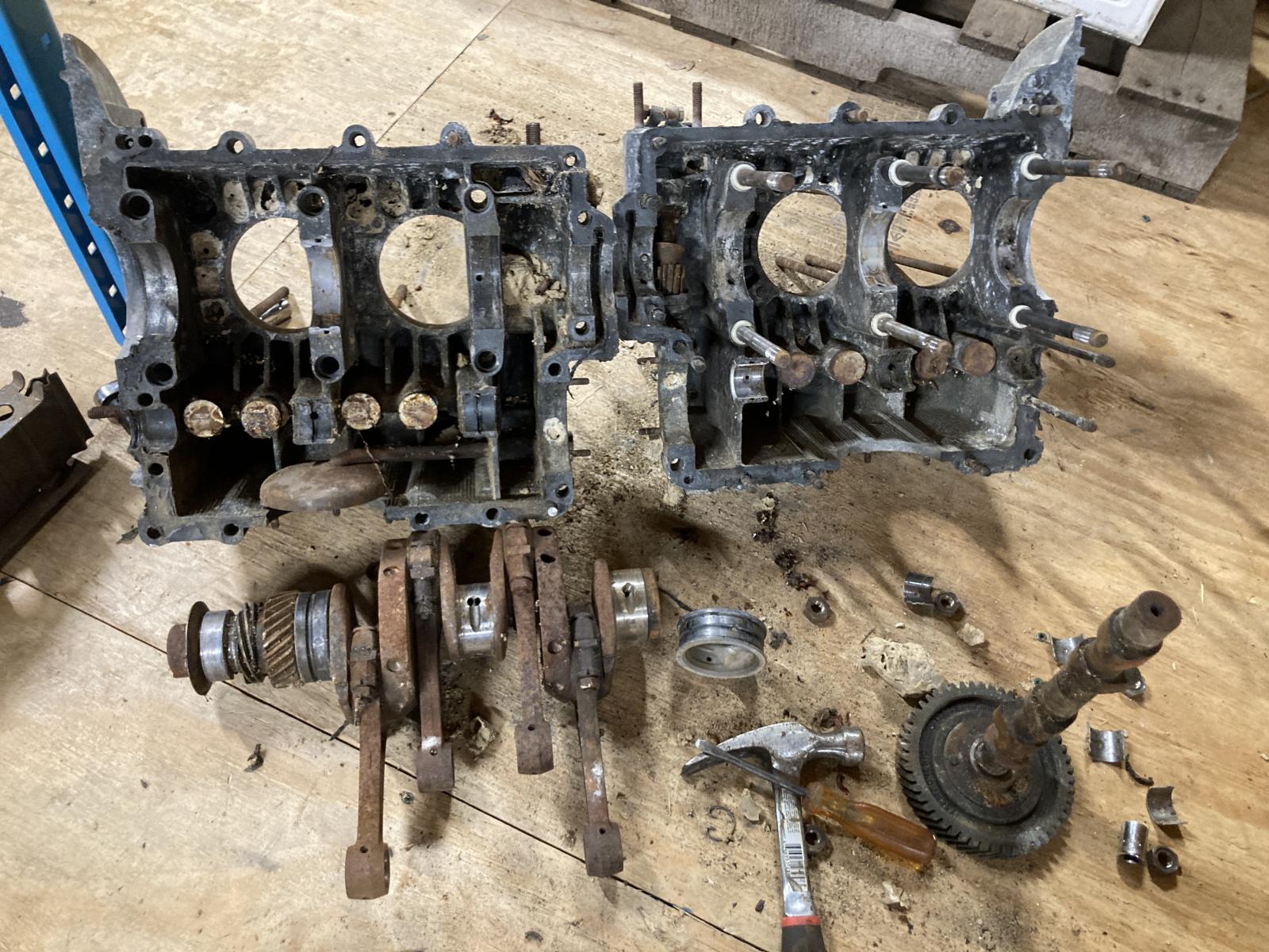

Thanks! The only parts I’m missing for it are the front emblem, spice rack, radio/radio delete, the rear bed, a battery, and the upper hammock. It even has the yellow vinyl spare tire cover. I was super excited to get it, needs a bit of metal work but I love the patina and color of it.
I made a good discovery today, actually someone else’s screw up worked out well for me Laughing
So this summer when I was in SC on an internship, I chopped up a bus that had a bunch of parts in it and one was the remains of a 40hp engine. Heads were there but it was torn apart, but the case looked decent from the outside, but it was disgusting and full of crap and the crank and rods were rusty.
Fast forward to yesterday and I decide to open it up for grins to see its condition. I had to take a few pistons off that were left on it and it was an 85mm, it didn’t yet click with me. It was a VW reman case and the heads were reman too. I opened it up in all its crustyness and the case had a fresh line bore, there was still assembly grease on the lifters, it was a never ran nice rebuild Shocked What’s this have to do with anything? I hit me today that 85.5mm pistons or jugs shouldn’t fit a 40hp case, I grabbed one off the shelf and it didn’t fit. I then realized someone rebuilt it and had put a 69mm crank and rods in it and stopped rebuilding it when it wouldn’t fit together Laughing
The crank and rods are crusty but look freshly machined and had new bearing never even run. The rods still turn on the crank so I’m hoping it a polishing and cleaning and this bus has a fresh crank, camshaft, rods and bearings

While I’m still back down state from the bus, I’m getting everything for an engine together. I started cleaning up the 1600 parts that came out of the 40hp case. The rods all weighed out at about that same weight after I cleaned them up. I started cleaning up the crank too. The rod journals are beautiful since the Very Happy assembly lube kept them from rusting, the main journals have a little rust that needs to be cleaned up, but it’s definitely a fresh machining. Here’s the starting pile of crust
I started cleaning up the camshaft but the edges had some pitting. I’m not sure if the camshaft will be usable. Thoughts?
I cleaned up the cases earlier today, I pulled the galley plugs on the bug case since mud wasp built nest in them Mad A self tapping screw and washers always work good on pulling the plugs.

PostPosted: Wed Nov 22, 2023 9:54 pm    Post subject: Re: 1971 Westfalia “Fitz” saved from the scrapper Reply with quote
That camshaft is going to be a definite "nope"
It will eat up your lifters faster than a fat kid eating cake at thanksgiving.
I'm willing to take a gamble on quite a few things inside the VW motor, but cams and lifters are too risky to play roulette with.

Thanks scrivyscriv, I kinda figured. I may have another decent camshaft laying around, or I’ll actually but a new one.
I’ve been debating a stock camshaft or do something with a mild grind. If I go stock I’ll probably get a camshaft from VWNOS and save the hassle of bad quality.

If that pitting is off the contact area you can run that. It’s close though. How about some Prussian blue and a clearance test ?

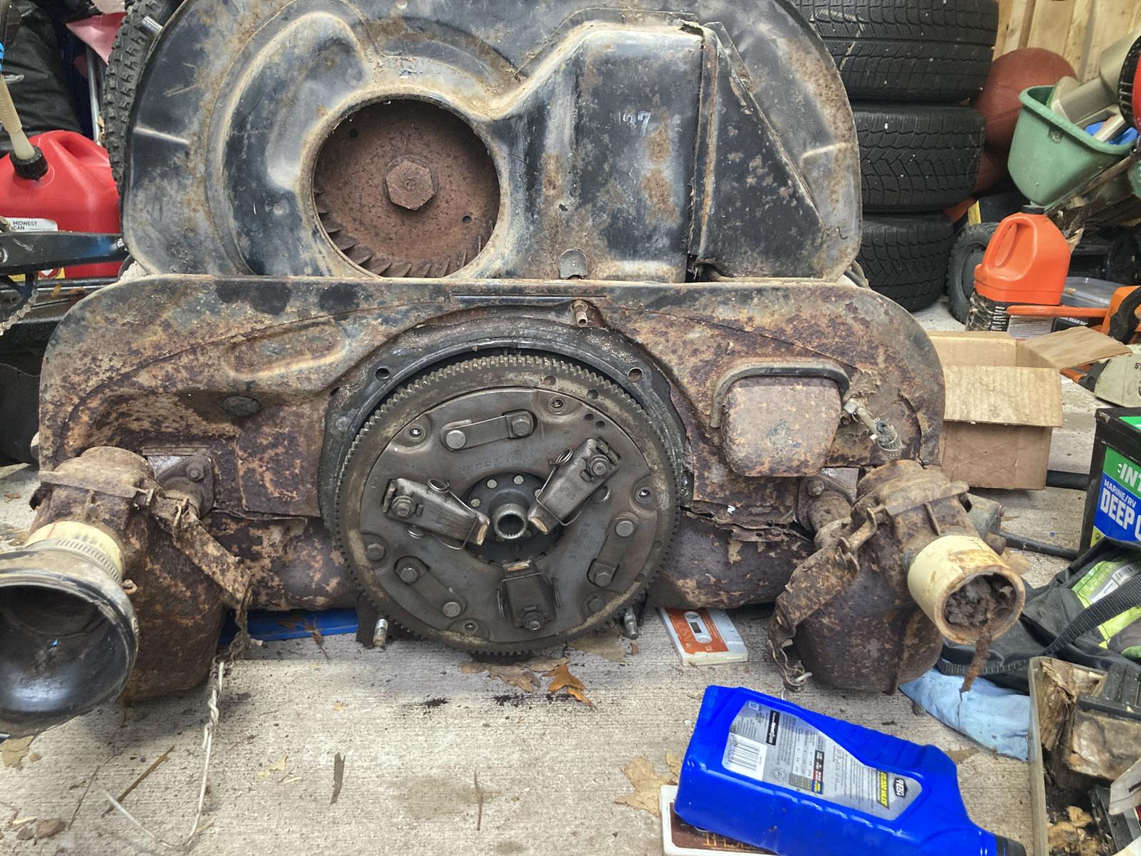

I got back up to school and brought a bunch of parts up for it. I brought the off road tires from my yellow bus up and put them on so I’d have more room under it.
I had decided to see if I could get the glandnut off the spare 71 bus engine that was seized up. I started putting force into it and the engine broke free and starting turning over. I decided to bring it inside and start a tear down to see if it was decent. Turned out there was a little bit of sludge in it. There was a bunch of junk in the cylinders. I took the P&C off and it turned over nice with “no” end play. It looks recently rebuilt mileage wise. I think I’m going to get it moving by just throwing this engine together.
